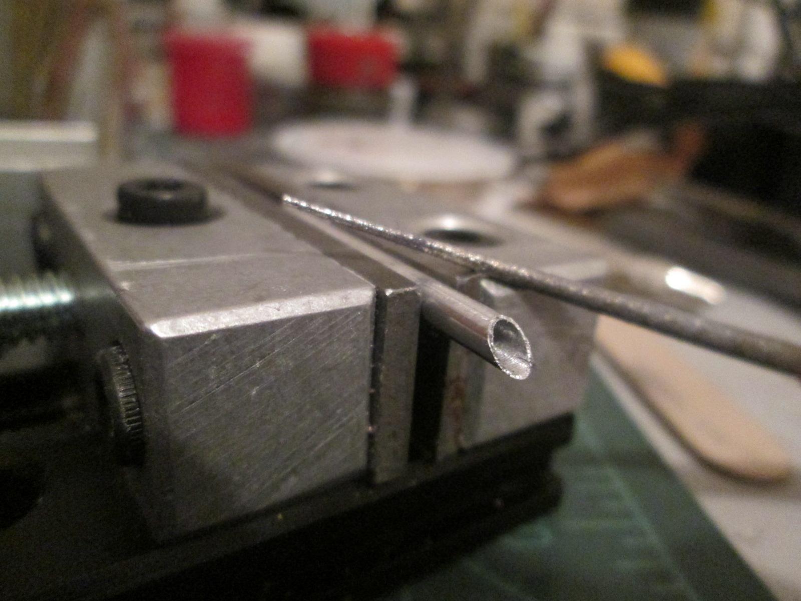

Lost one of the flattened exhaust tips supplied with the kit. My car had beveled round tips so I made some.

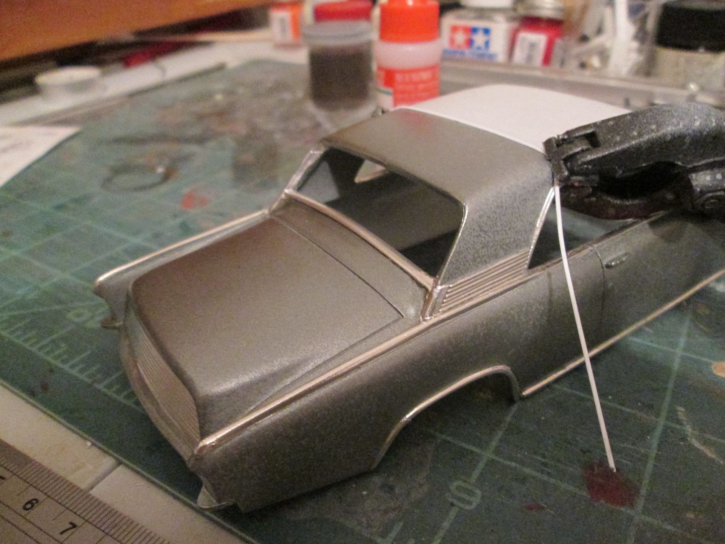

Added a "chrome" strip to the roof to edge the vinyl. Completed the BMF. I feel like I applied around two hundred square feet of it. Next is the clear. I don't know whether I'll brush some pledge on "à la Harry" or whether I'll attempt to airbrush it or just go with the rattle can clear.

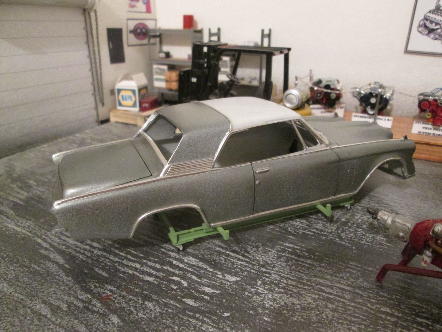

The car is sitting in the engine shop, waiting for clearcoating.

Made a futile attempt at a vinyl roof. Will have to start again with better masking tape.

Added the minuscule PE emblems. On the home stretch now......unless i strip it and repaint it.
