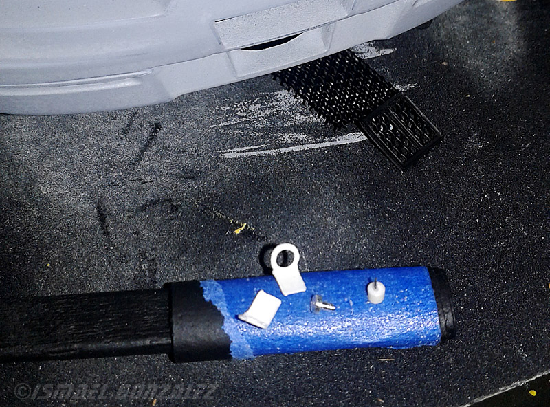

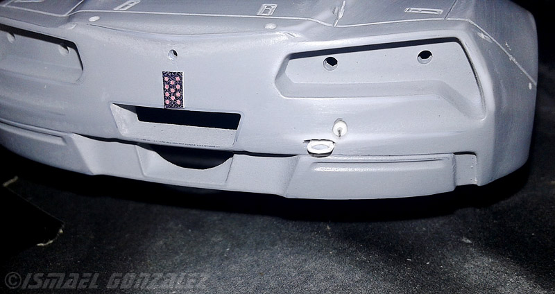

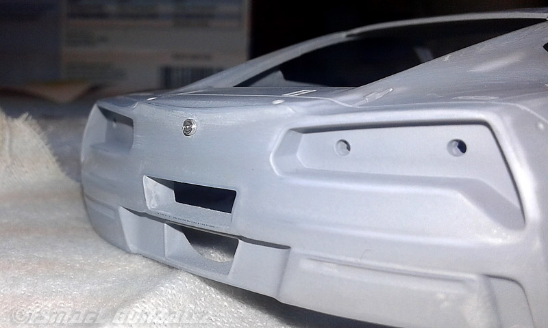

ismaelg Posted February 1, 2017 Author Posted February 1, 2017 (edited) Hello, Thanks everybody! David, so sorry to hear about the mishap! I hope it turns out good! Jim, I've heard about the cammo decals but I've never seen them. At one point I considered painting that but it was too much work. Here is a bit more progress. More tiny little parts! This is what I like the most about this hobby. Doing the tiny details that nobody can see or care but I know they are there. But this time you don't have to guess... Front tow hook. It still needs a little tweak at the base. Mandatory safety lights, rear tow hook and air jack connector. These are the last body modifications. Yeah right, I said that 20 body mods ago No seriously, I think these are the last. Thanks, Edited February 1, 2017 by ismaelg

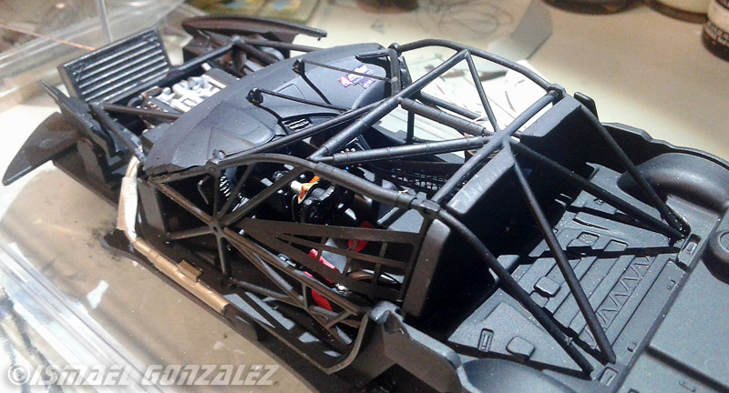

ismaelg Posted February 5, 2017 Author Posted February 5, 2017 (edited) Hello, After surgery we are now back on track. The body is sitting now where I wanted, but this is far from over. Let's see what other surprises lay ahead..... By the way, both screens had display shots added but you just can't see them from any angle. Thanks, Edited February 5, 2017 by ismaelg

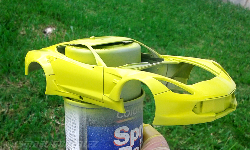

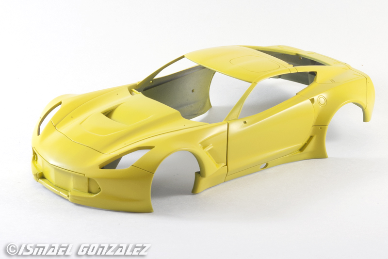

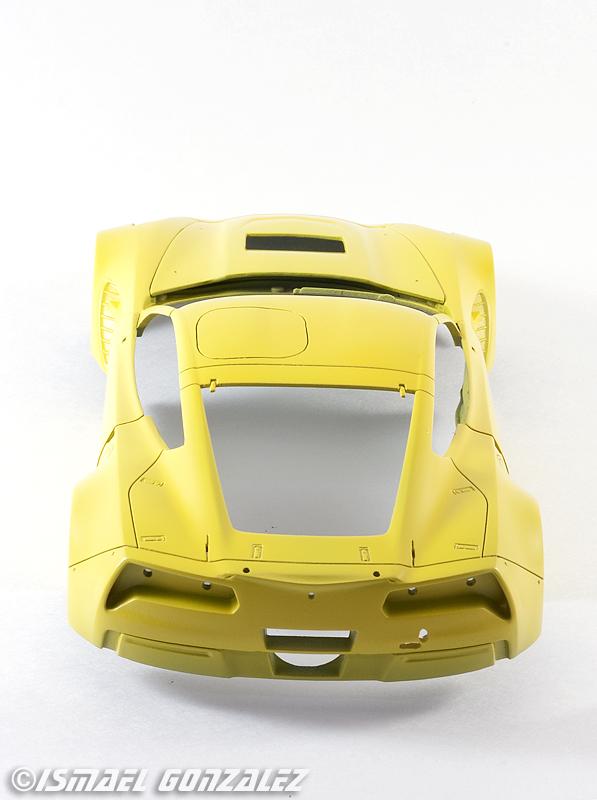

ismaelg Posted February 5, 2017 Author Posted February 5, 2017 COLOR!!!!! Hello again, This is the first burst of color on the body! This is only after a mist coat and a light coat. Still pending 1 or 2 wet coats to check on progress. Gravity Colors Corvette Racing Yellow lacquer As expected, the paint flowed beautifully. With all the fit issues I've had, I was loosing interest in this project, but the color just won me back! Thanks,

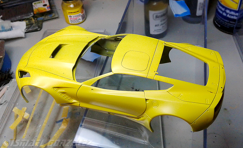

ismaelg Posted February 7, 2017 Author Posted February 7, 2017 Hello, "Corvette Racing Yellow" replaced Velocity Yellow in 2016. It is very similar, but a hint lighter and maybe a bit more "pale" (for lack of a better word) than Velocity Yellow. Velocity Yellow replaced Millennium yellow in 2006. Gravity Colors Corvette Racing yellow lacquer. About 3 wet coats. Sorry for the crappy pictures but these were in a hurry as it was starting to rain. Will let it take a beauty nap before continuing. Next step: masking and painting the black areas. Thanks,

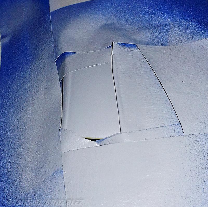

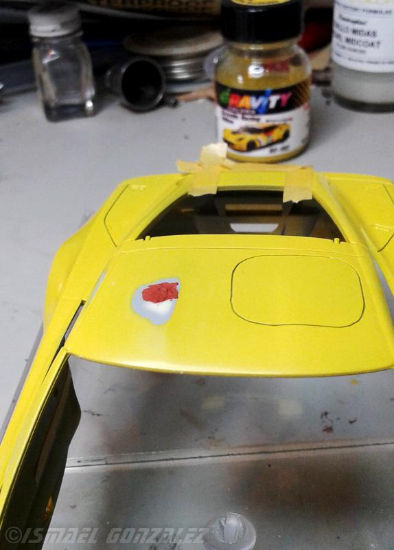

ismaelg Posted February 20, 2017 Author Posted February 20, 2017 (edited) Hello, More on this stupid model. This has to be the WORST Revell Corvette kit. EVER! It's getting into Palmer models territory! Well, maybe not, but I just lost the love. It is now just a personal challenge I want to get over with. The stupid model has a roof dome. In the real car it is for an IMSA mandated In-Car Camera. I noticed it was in the wrong location, but to avoid messing up with it, I decided simply to extend the black painted roof stripe a bit to the sides to cover it. Well, it turns out it is (was) way too much farther and the roof stripe would have to cover almost the entire roof. So after the body was painted.... AARRGGHHH!!! I can't live with that glaring mistake. So we are progressing by going backwards.... Why in the world did Revell put that there? It has NEVER EVER been there. Here is what the IMSA rules say: 10.8. In-Car Camera 10.8.1. Cars may be required to carry In-Car-Cameras (ICC). a. Entrants must cooperate with the official broadcaster in the installation of the camera, including the provision of power for the equipment. i. May require a battery pack. b. Closed-cockpit Cars must mount an actual ICC, or the ICC replacement dummy unit, on their roof, and must: i. Be mounted opposite side of centerline of the Car from the Driver ii. 12.5” rearward of the trailing edge of the windshield iii. 4.5” off the centerline of the roof iv. Or as approved by IMSA I don't expect model companies to know or even read the entire regulation manual, but at least take measurements from the real car. Wasn't this supposed to be fun? Stupid model..... Thanks, Edited February 20, 2017 by ismaelg

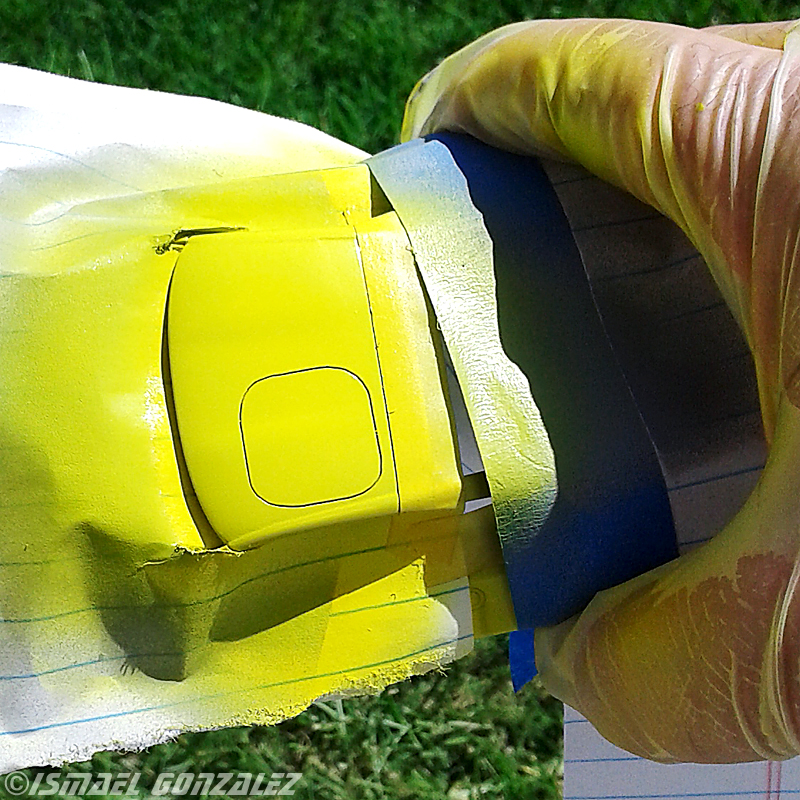

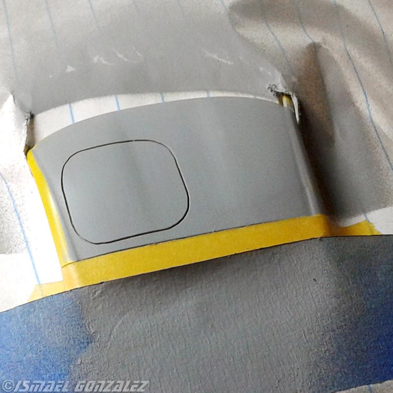

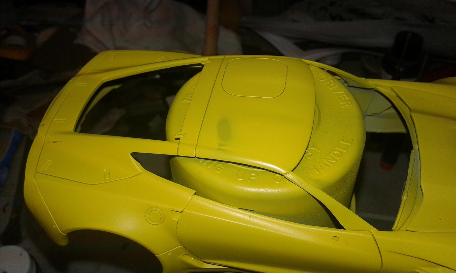

ismaelg Posted February 25, 2017 Author Posted February 25, 2017 Hello, Back to square 1. Well, maybe square 2. The yellow band is actually Tamiya tape, not paint. After this, the whole car will be painted again to even the color. Stupid model Thanks,

ismaelg Posted February 26, 2017 Author Posted February 26, 2017 Hello, Took the masking off and it is looking better than I expected. I need to put a few more coats to the whole car to ensure uniform coverage. Hard to see in the pic but some areas are still a hint darker than others. Thanks,

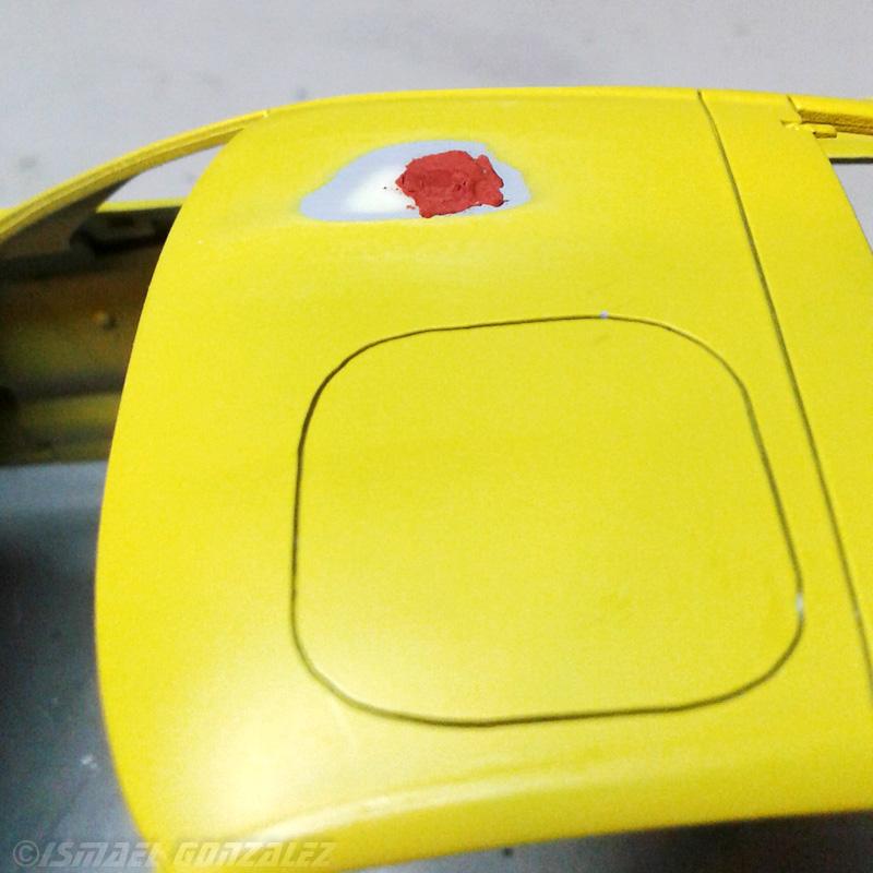

ismaelg Posted September 13, 2017 Author Posted September 13, 2017 (edited) Hello? Anybody here? Hi! After 7 months, I finally got some workbench minutes. Why I keep fighting this stupid model is beyond me. Maybe I don't want to be beaten by a chunk of plastic. So Anyways, the repairs on the roof were not that smooth. The only way to fix it was sanding down to the primer and leave a huge ugly primer spot. This is how it looks after 2 or 3 light paint coats. So after careful sanding and prep I started applying light coats. I lost count but there are more than 10-12 coats here. It is getting there. I'll let it dry. I plan to do maybe a final color coat on the whole car before masking for painting the black. The more I work on it, the farther the finish line looks... Stupid model Thanks, Edited September 13, 2017 by ismaelg

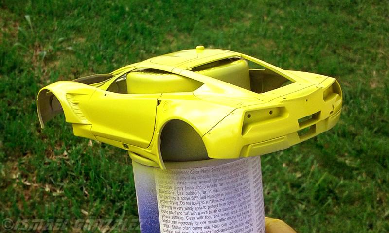

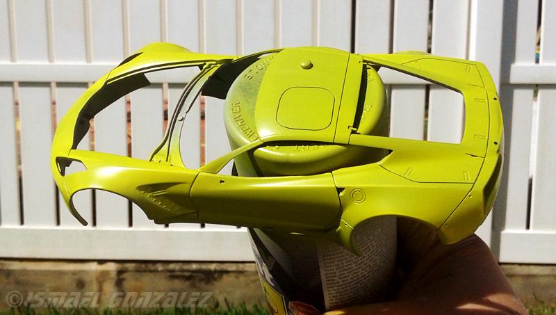

ismaelg Posted September 15, 2017 Author Posted September 15, 2017 Hello! What I hope was the last color coat. I'm mad at this stupid model, but airbrushing lacquer is sooooo satisfying..... ? Thanks, I'll let it dry for a few days before masking and painting the black areas.
