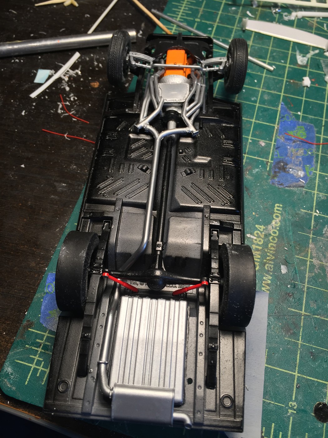

This is the beginning of a '65 A-990 car.
The rear tires shown are supplied with the Moebius Melrose Missile kit. They seem to scale out to 9 inches which would not be accurate for one of these cars, but they do look good! I'm debating whether or not I should leave them or go with a skinnier pair.

Just noticed the flash on the headers and I also left the lettering on the floor! Doh!
Edited by 6bblbird
Walt, those tires look great on that, "legal" or accurate or not.
As far as 7" slicks go, the only place I've found them is in original old kits. I'm hoarding a precious few sets of them for "special" builds in the future. And accurate or not, they actually look too small on a model but that's a completely subjective judgment on my part.
