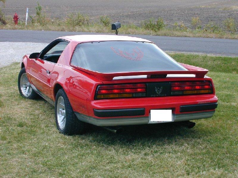

So I have a lot of kits to build or am in the process of... However, I just bought this one from my local h.s. I've always wanted this kit because it's quite close to my 87 formula. The only difference I can see is the nose cone and the rear wing. I had the wrap around but it was a taller wing than the 92. Anyone have any experience with the kit? Fitment wise and such? It looks like it's got decent detail to it. Makes me wanna get the vette done...
Here is my take on it:
It went together pretty well. I made no major adjustments on it. To back date it to a `87, the front and rear bumper as well as the rear spoiler will need to be changed. If you need the older style wheels, you can get them from the `85 Trans Am kit. I have been planning to do an older formula, but never got around to it.
I think the old Monogram 87'GTA/85'Trans Am might have the correct rear wing,don't know of a source for the nose cone,you may have to do some scratch building.
Thanks guys! Hawk I actually saw your build on that formula earlier today! It came out so nice! I actually found it through Google search when I typed in 92 firebird as image search! My 1:1 firechicken actually hade these wheels on it with the goodyear gator backs and it was tuned port just like the model but mine had the bumper ettes not the updated nose. And mine was the top with an auto trans
