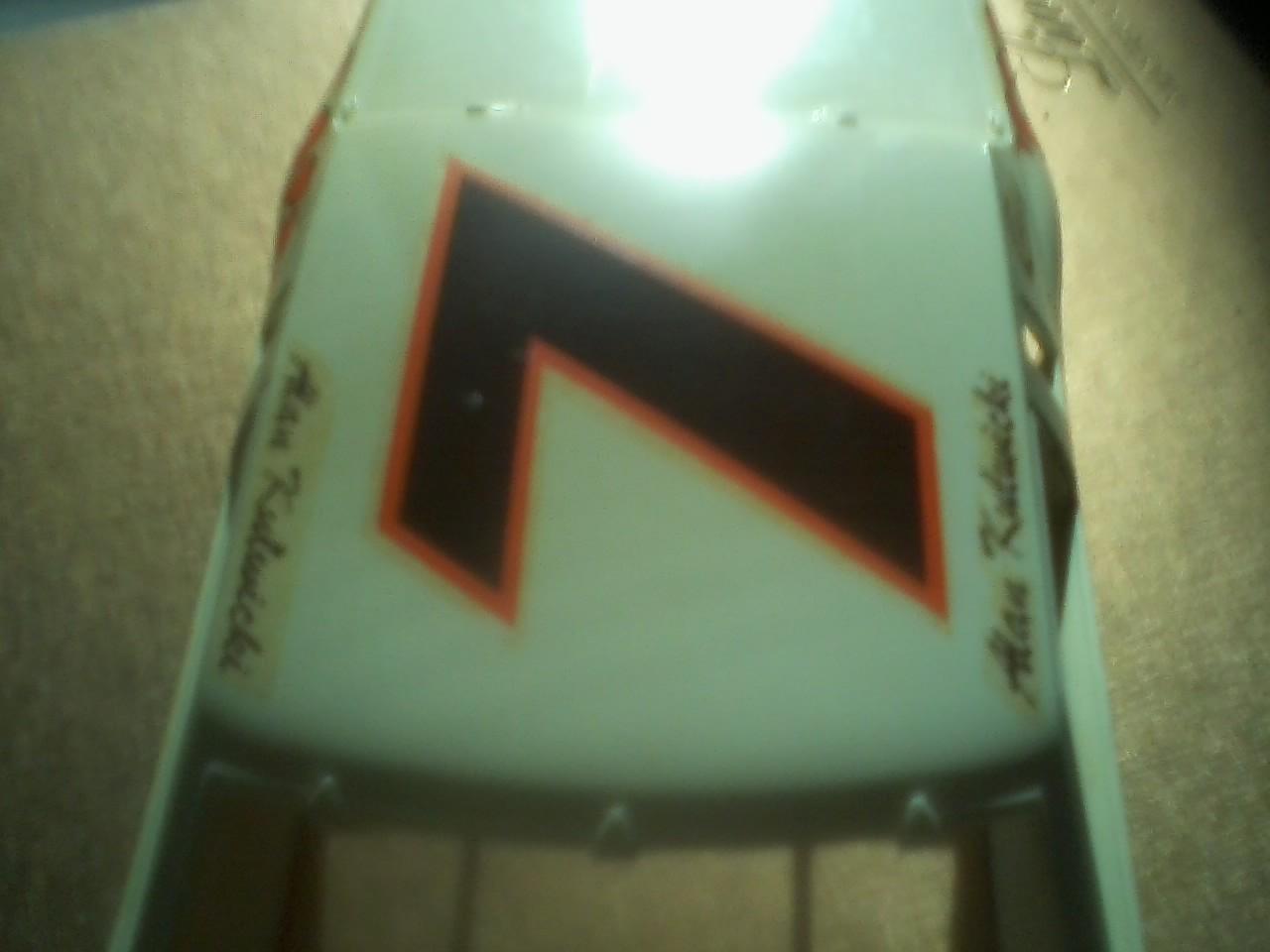

I have had a project on the back burner about 6 months. Well, I pulled it out the other day, and the decals have turned yellow (kit is white, so it stands out) They were fine when put away.     Luckily the body is not clear coated yet.
Has anybody experienced this and have a solution?
I had a kit packed away for a long time and a large decal looked foggy. You could see the entire decal on the kit (this one was not white) Well, I used Microsol or Microset on that one. Sat and bushed over and over, soaked it good, worked the edges with the brush and it cleared up. Thinking of trying the same on this kit.
Thoughts? Suggestions?
Thanks in advance

HOLY SMOKES!!!!  I put some bleach in a little bowl, dipped my finger in and rubbed the decal lightly. Kept dipping to keep it wet, rinsed with cold water, dabbed dry with a paper towel and the yellowing is almost gone. Needed to do it a bit longer
I will try to get a pic, but my camera sucks
Right side I rubbed for a few minutes, left I did not. There is a difference. Will do it more and update
Edited by Sledsel

What you are experiencing is old glue.  When I see the entire area under the decal turning yellow, I flood the decal with water and then brush away the yellowed glue as it comes out from underneath the decal.  Dip a paint brush in water and apply very generously over the decal.  I have paint brushes that I only use for decal setting solutions and I use one of these brushes for this.  You may have to soak the decal a few times.  This will usually flush out the glue. Once you get all or as much of the glue out as you can, blot the decal dry with a paper towel.  You have to take some care as you can wash out all of the glue and the decal will not stick.  My experience has been by blotting the decal dry, you preserve enough of the glue under the decal so it will stick.  I always clear coat a car in which this happens so there is another bonding agent for the decal.

So far so good, gonna mess with it more later.
IMG 1425
