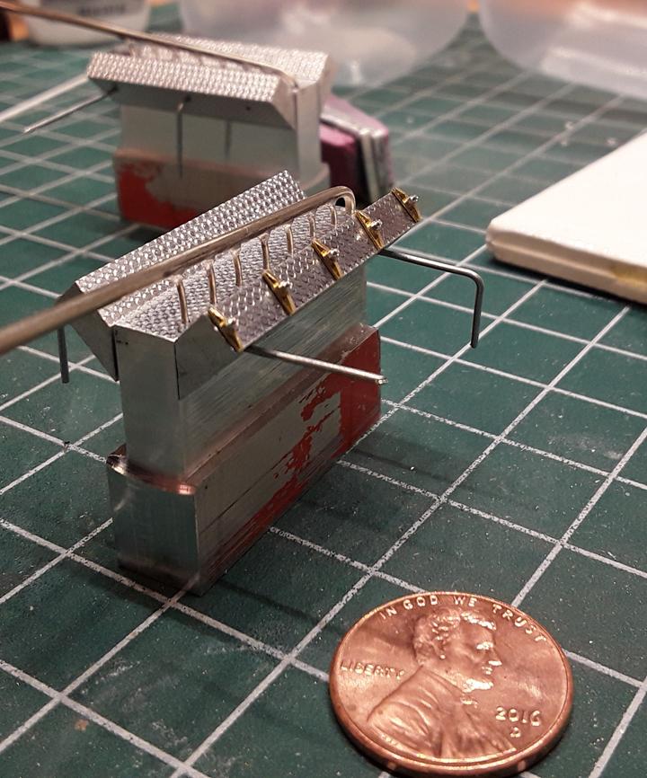

Pete J. Posted April 8, 2017 Author Posted April 8, 2017 Ok, after some massaging, this is what the clips will look like when they are glued in place. I had to file them with a needle file to final shape and length. This is a test fit to make sure the holes in the valve covers are properly centers. It is really a small detail.

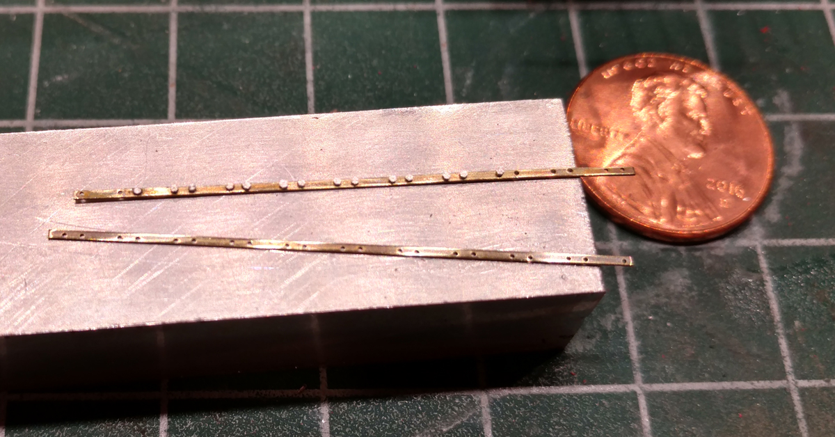

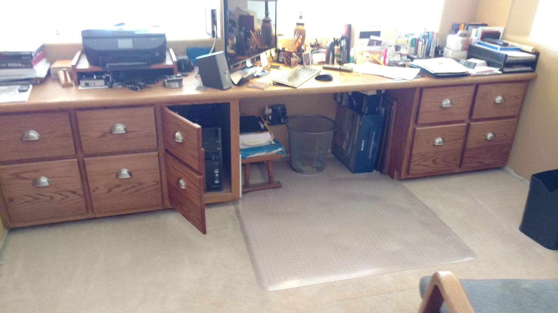

Pete J. Posted September 7, 2017 Author Posted September 7, 2017 Ok, back on the bench again making little bitty parts. These are the seals that run the length of the valve covers. They are used where two pieces of sheet metal join on the real car. The brass strips are .030" wide and the holes are made with #79 wire gauge bits. The bolts are from RB Motion, and yes, I could make them but as Robert makes such wonderful parts at a reasonable price(well that is a mater of perspective) why would I spend my time making them. For those who were wondering where i have been for months, here is a photo of my other project. I have been working with wood for 40 years and still tackle large projects like this built in desk. Thanks for looking.

Pete J. Posted September 7, 2017 Author Posted September 7, 2017 Tim, Thank you. It is good to be back on the bench. You and Randy's posts kept me interested though the wood project. It is quite a stretch for me to see what you do. Thanks for being here and showing the way! I have two more strips to do so I will shoot the "in progress" part tonight or tomorrow. As to the desk, it is exactly the same challenges as model building. You are just working in a different material. The mental gymnastics are the same. Oh, and bigger tools. Much bigger tools.

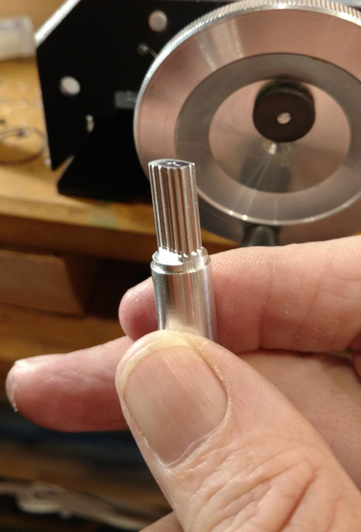

Pete J. Posted September 21, 2017 Author Posted September 21, 2017 Started work on the superchargers. This is the second crack at it. Not good enough yet and I have to make two of them. Still learning a lot about using a four jaw chuck and rotary table to make the piece and get the grooves evenly spaced. Back to the bench!

Pete J. Posted September 23, 2017 Author Posted September 23, 2017 Thanks Tim! I will do that. The four jaw is really taking some thinking time to make it work the way I want too. A lot of time roaming the internet and YouTube. I am getting closer, but it is going to take some work.
