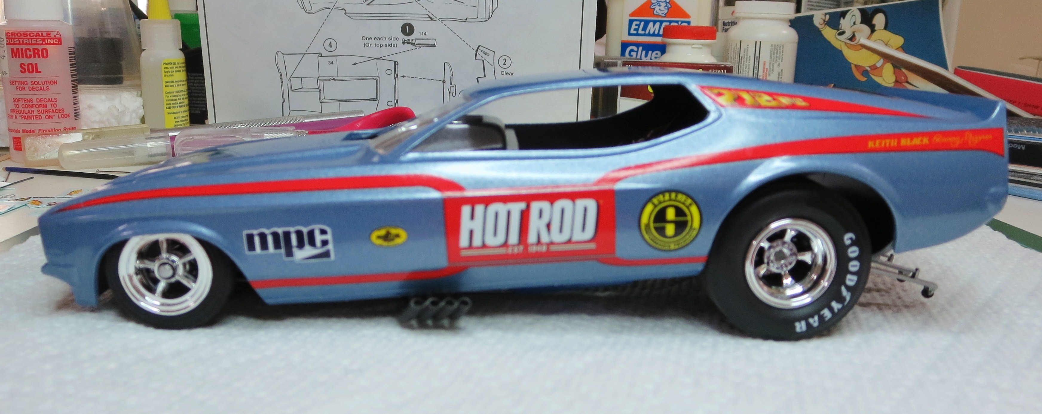

Speedfreak Posted May 25, 2017 Posted May 25, 2017 (edited) Hello everyone, it's been a while since I've posted anything so here goes. Tricky car in some ways but doable: Any questions, or , comments are welcome! Thanks for being here! Edited May 25, 2017 by Speedfreak just wanted

Speedfreak Posted May 26, 2017 Author Posted May 26, 2017 Thanks you guys, it just kind of feel together, (sure it did ) it was sitting in the dust bin after having started it a couple of years ago, I wanted to work on something with lots of decals and this fit the bill. The paint is Dupli-Color (can't remember name) with Tamiya Clear Pearl (thanks Ace!) over it. I didn't like color when first painted, (thought it looked too pedestrian for a FC) but once decals started going on started to like it, now like it. Thanks for all the compliments and comments!

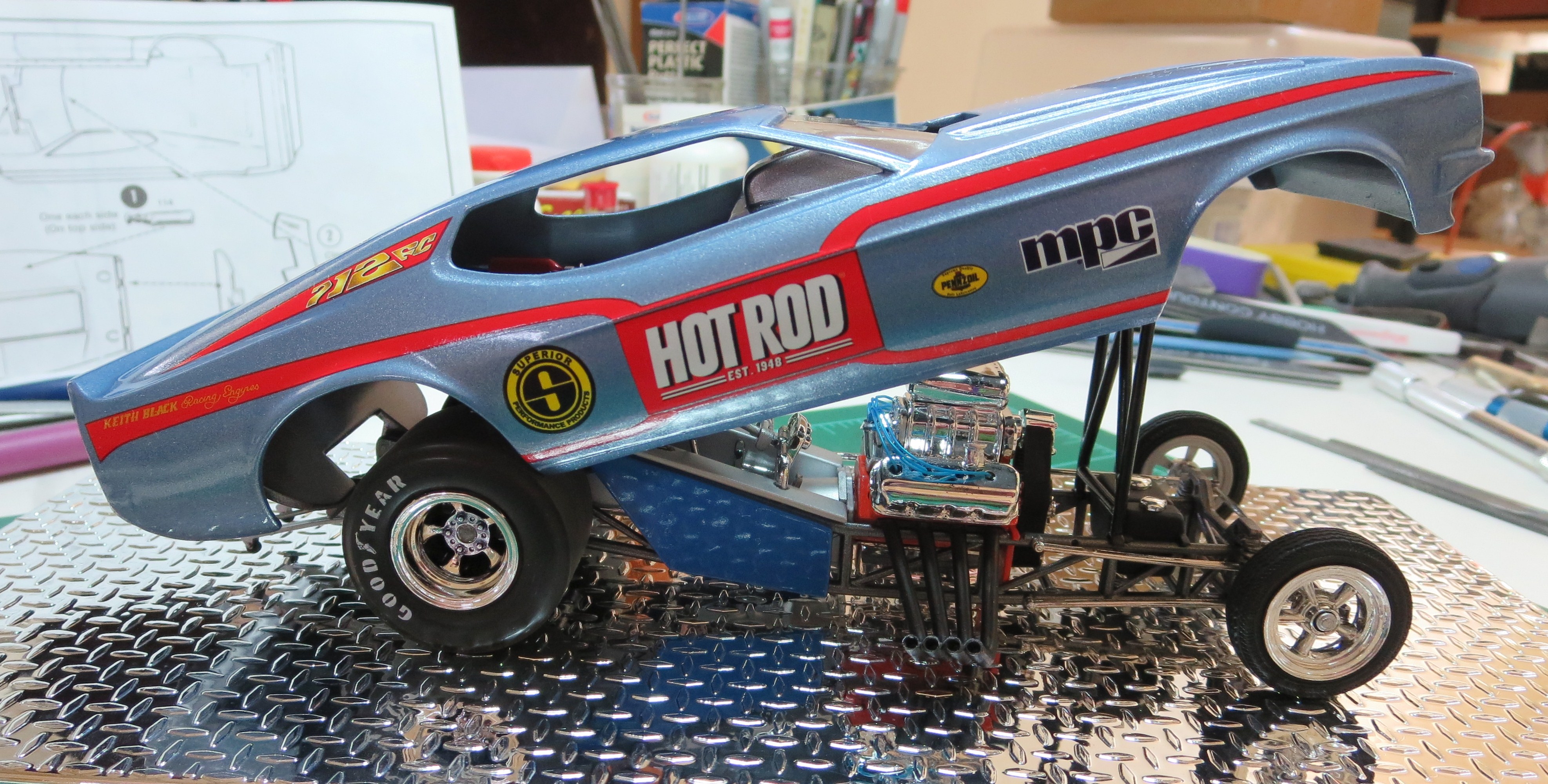

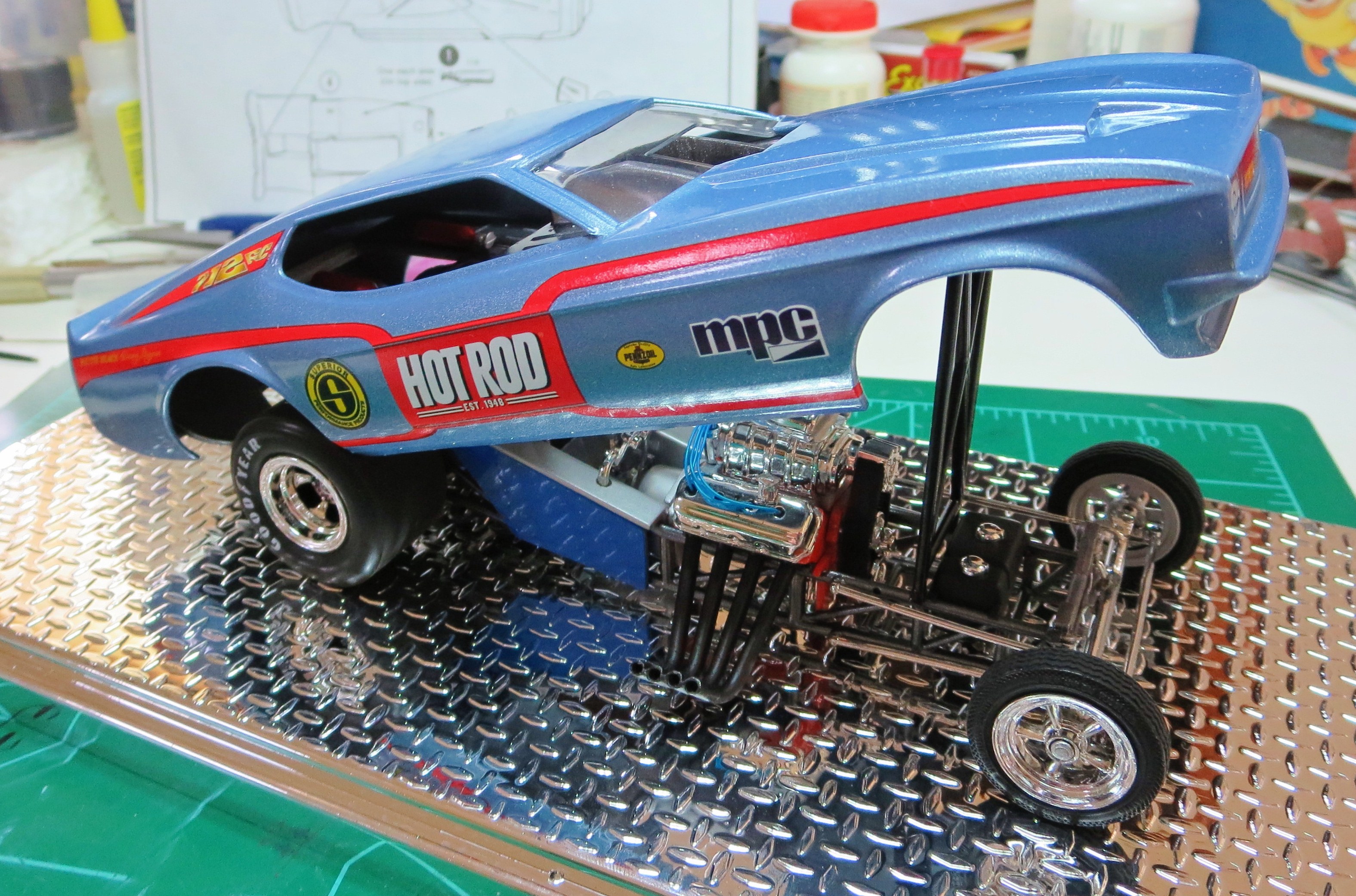

Speedfreak Posted May 31, 2017 Author Posted May 31, 2017 Thanks John and Dave, appreciate your comments. James, the problems start with the body itself, watch for warpage on the A-pillars and the whole rear section (trunk area) on one of the bodies (had to get second one from Round2) was warped at an angle so the inner shell would not line-up. then there was work getting the engine to sit flat and true (if you look closely you can still see space between the block and flywheel case on mine) I pinned the headers so they would stay lined up. The next (and maybe worst) problem was the wheelie bars, they are flimsy and not straight, I had to straighten them (as best I could) and then pin them (there are no notches or anything else for placement on axle housing) and because they are so flimsy and long and thin it was impossible to 'hold' them in place for adhesive, so I pinned them to the axle housing. Oh ya, other area was 'inner shield ' , or whatever that is called, had to be opened up around blower so the body would come down all the way, last but maybe not least was the piece that connects to inner shield and frame that body swivels on, that was a bit tricky getting lined up. In the end it was a great experience for me, I'm glad I stuck with it, and thanks to this forum for giving me the skills to address the problems I encountered.
