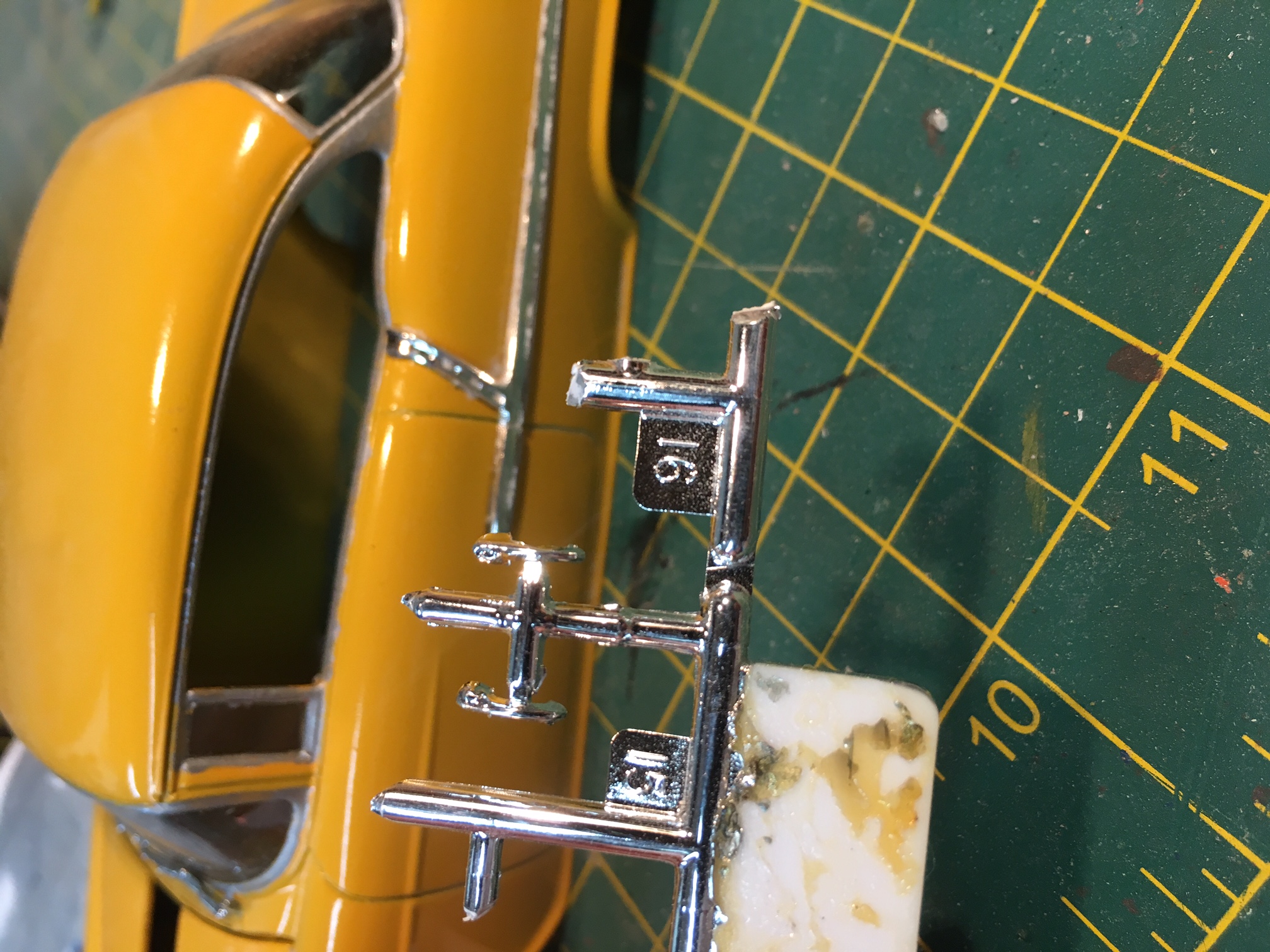

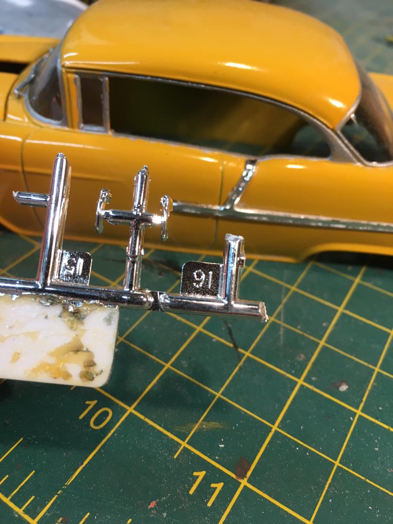

ratdoggy Posted June 4, 2017 Posted June 4, 2017 Doing a '55 Chevy there is no exact "dimple" to show where the outer handle mounts. Also what is the best way (without making a gluey mess) of attaching it? Scratching my head here
maltsr Posted June 4, 2017 Posted June 4, 2017 Drill a small hole in the door and back of the handle. If you wish, cover the door with a piece of masking tape to protect the paintwork. Glue a piece of wire into the handle and carefully glue into place on door with a drop of superglue. Hope this helps!
ratdoggy Posted June 4, 2017 Author Posted June 4, 2017 Thanks that's a good idea...Now how do I get both handles in the correct spots on the doors? A template of some sort?
Ace-Garageguy Posted June 4, 2017 Posted June 4, 2017 Pinning, as suggested, is without a doubt the way to go.The best way to get them even IS to make a little template, as you mention. It can be a simple piece of cardstock...doesn't have to be fancy...just something that aligns with the back edge of the door and another line on the door, like the chrome, etc. Just flip it over to do the opposite side.It's always better to decide on doing this and drill your holes before painting, too.If you pin them, I strongly recommend white PVA glue, as it is water soluble and can't possibly mar the paint or chrome. You hardly need any sticking power to hold a pinned part in place, and PVA will easily do the job.
