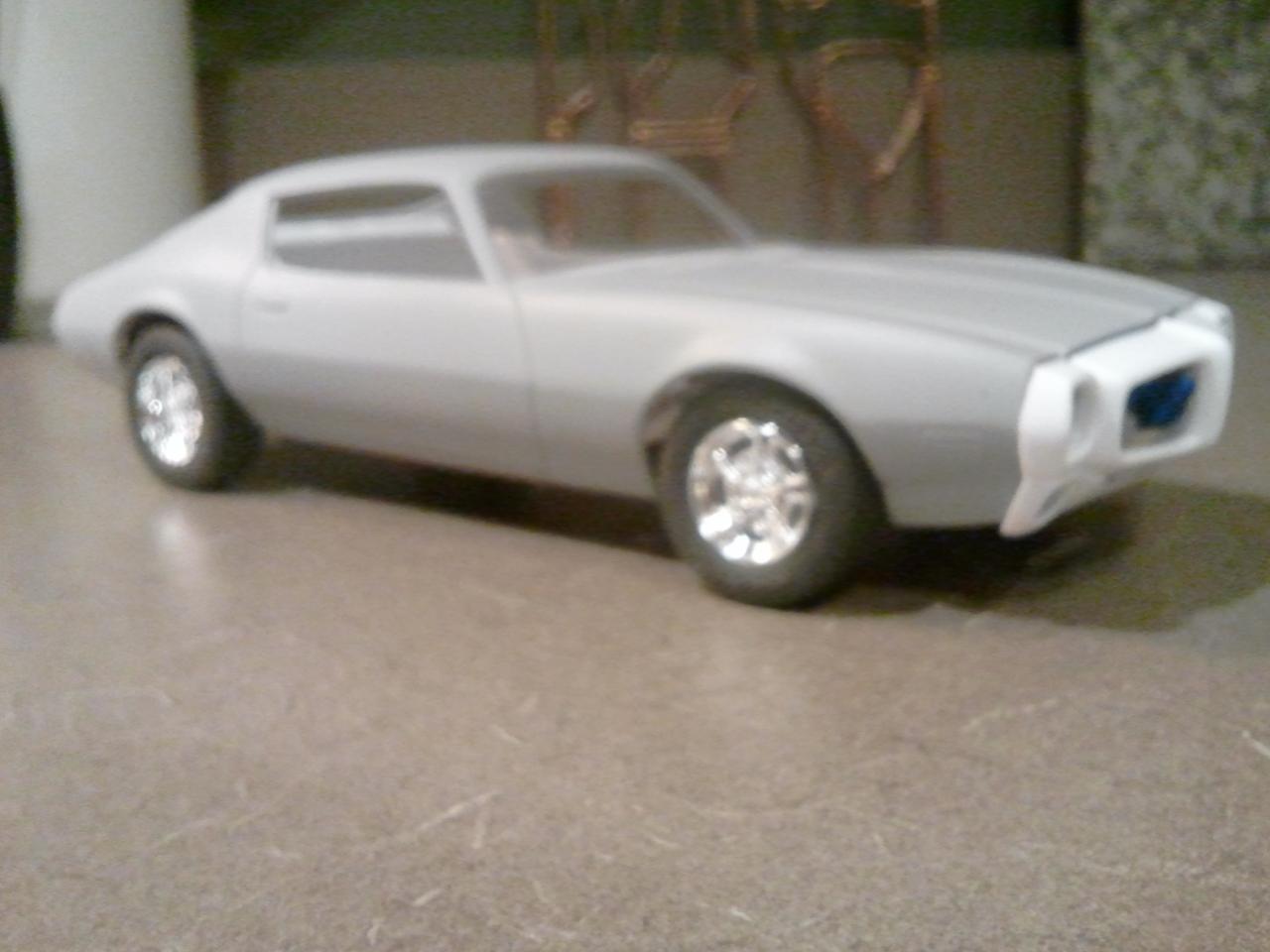

IHSS Posted July 13, 2017 Posted July 13, 2017 Its not to hard to convert a T/A to a Formula. I haven't done a 79 but I have done two Monogram 70 T/A's and I'm currently working on converting a Monogram 79 Z28 into a base Camaro. After I finish the Camaro I'm going to attempt a 78 Formula from the Monogram 78 T/a kit.I did the green one first It's not a true Formula but it gave me the confidence to make a true Formula. Give it a try. The worst that can happen is you'll have to sand every thing of and start over. Find one at a car show or cruise in. Take a lot of good pics with your cell phone and plan it out. Use masking tape to lay out the base area and then use sheet styrene to build it up to where it looks right and then slowly carve out the details. I even made the silver one a ram air version with air cleaner.http://www.modelcarsmag.com/forums/topic/72809-70-73-pontiac-trans-amformulaespiritfirebird/ I couldn't get pics of the silver one I did but found an old link with some pics of it. Her's a couple pics of the silver one in the conversion process
astroracer Posted July 14, 2017 Posted July 14, 2017 The front fascia change in '77 also changed the hoods at the front. The hoods became flatter, losing the curvy sections at the outer, front corners that you see in Jeff's pics. They also lost the circulation vents at the base of the windshield. You "could" use an earlier then '77 hood but you would have more work to do to get it to match the later fascia.Mark
