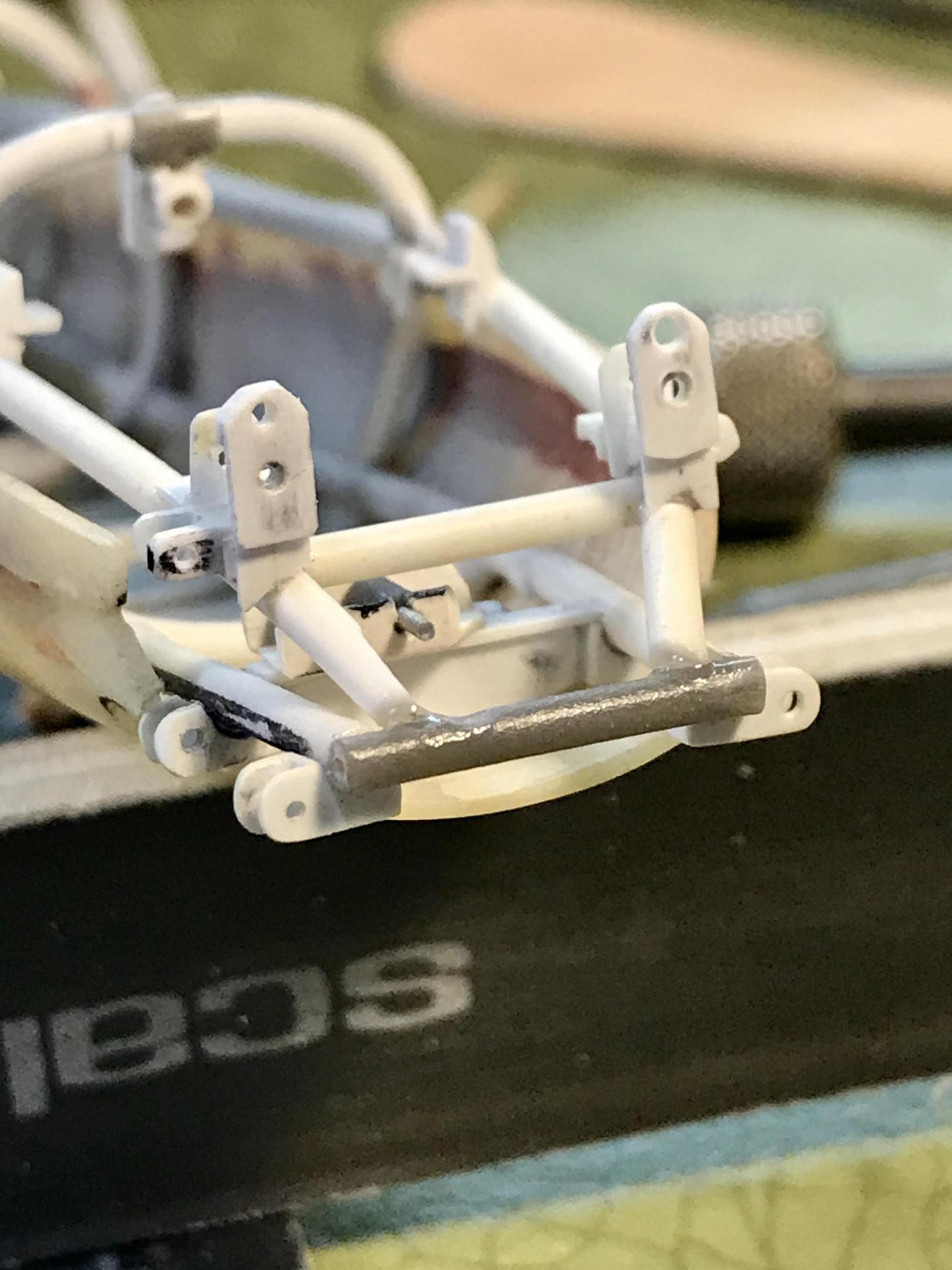

The section of the frame that sites the leaf spring gets two tabs that site the sway bar on top of the spring - liquid glued
Have to start by correcting an error that I made two years ago
plugging a bolt hole in one of the rear uprights -
and then drilling a new hole - the new hole hopefully not crooked...      the new hole does the trick - as the plastic tube Guide now passes through the upright parallel to the trailing suspension arm ... the susp arms are white metal - from the herb seeks kit ... as per the front susp ...

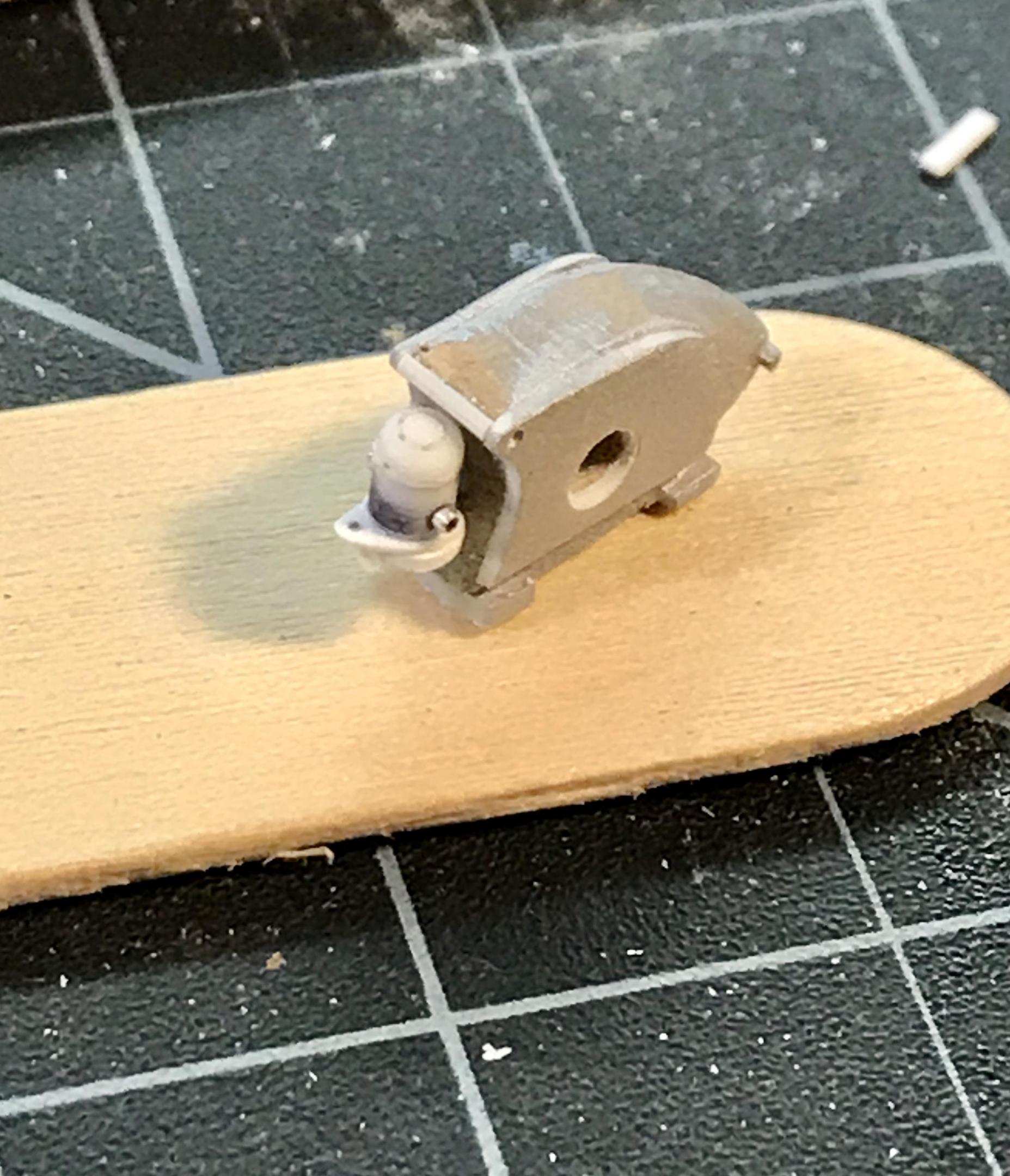

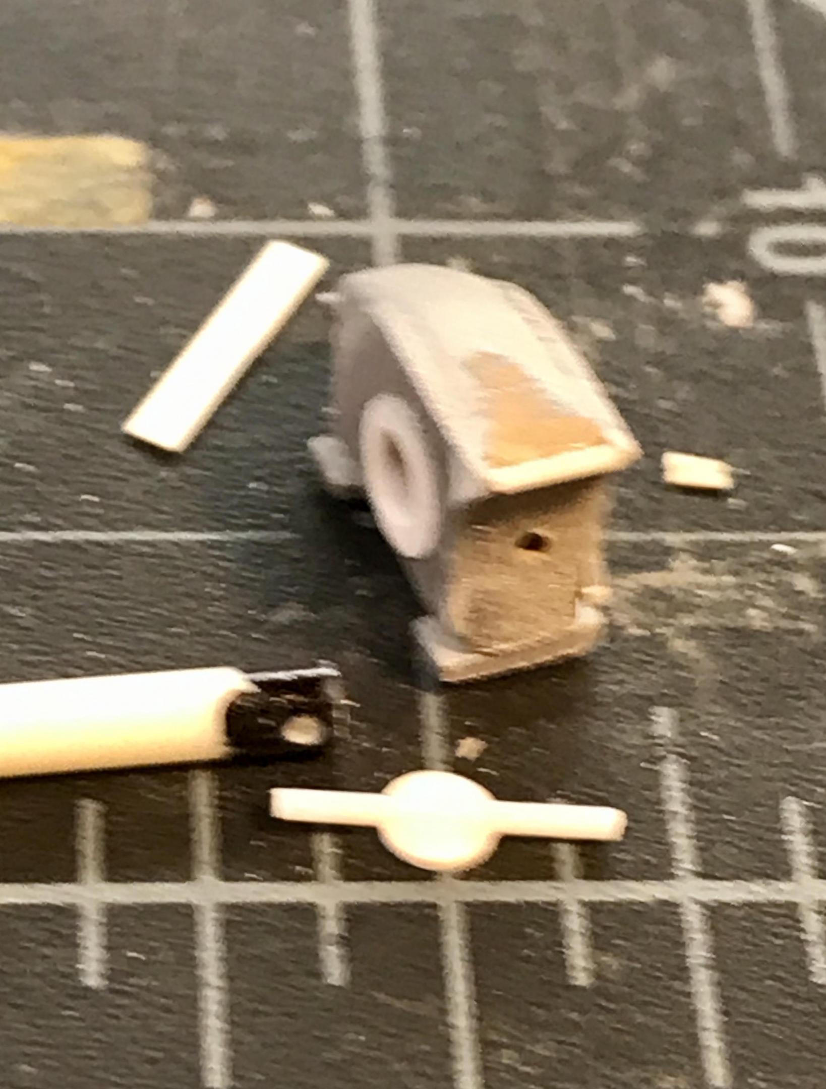

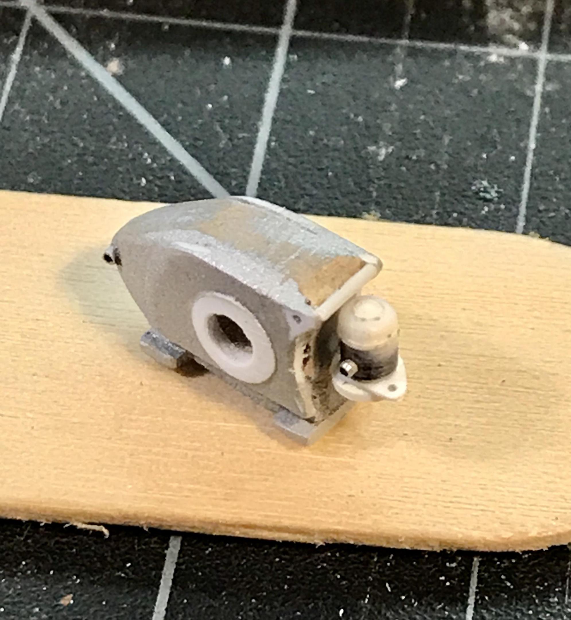

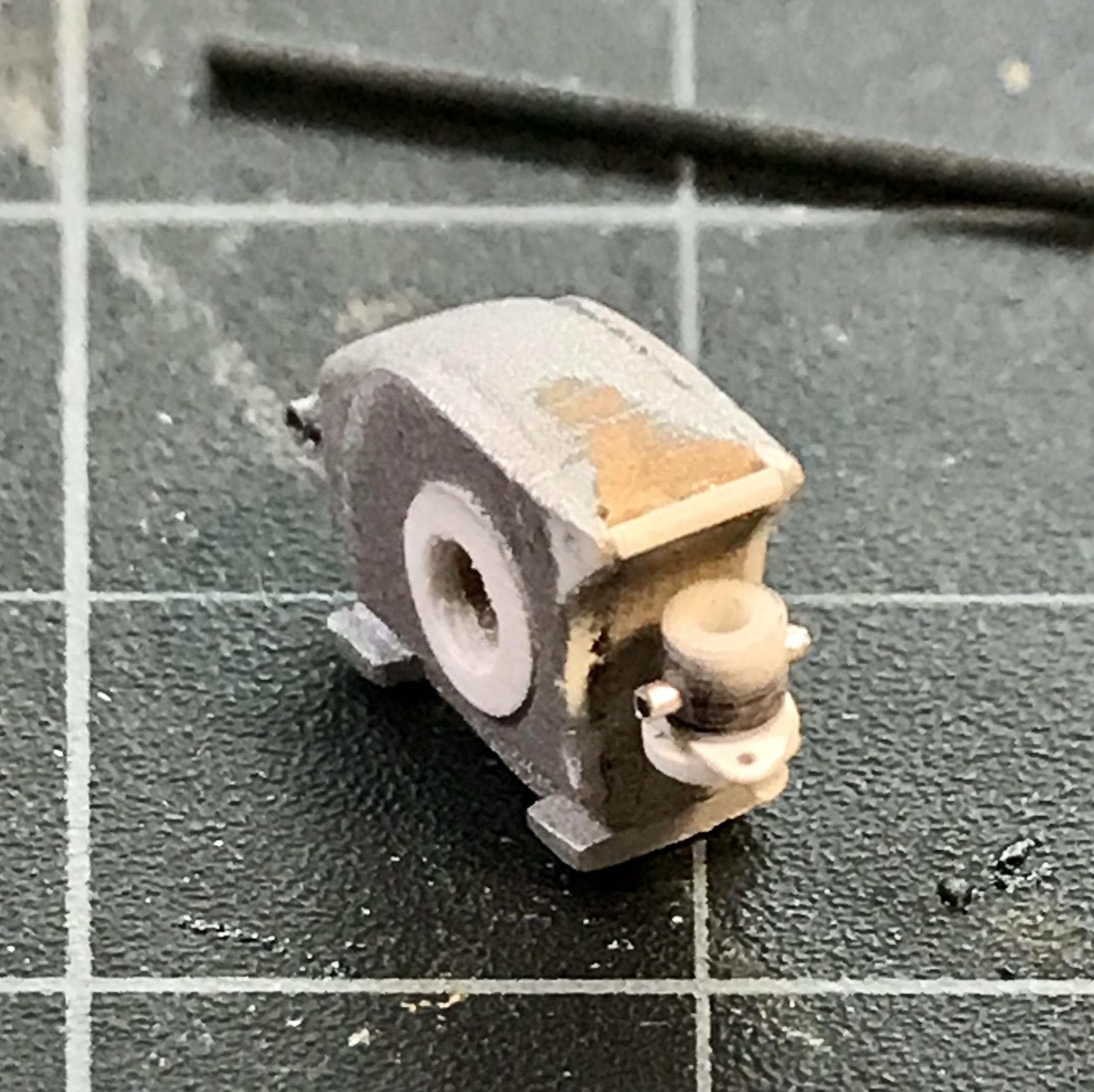

the fuel pump is mechanical and is driven off of the back of the transaxle.  Yes - the fuel line leaves the tank, passes the engine, goes all the way back to the pump,
and then Returns to the carb.  Made from .093 evergreen tube,  sm dia alu tube, and some discs punched from .010 and
.015 evergreen strip.  The oil tank that I made way back on page 2(?) from renshape will sit right behind the pump

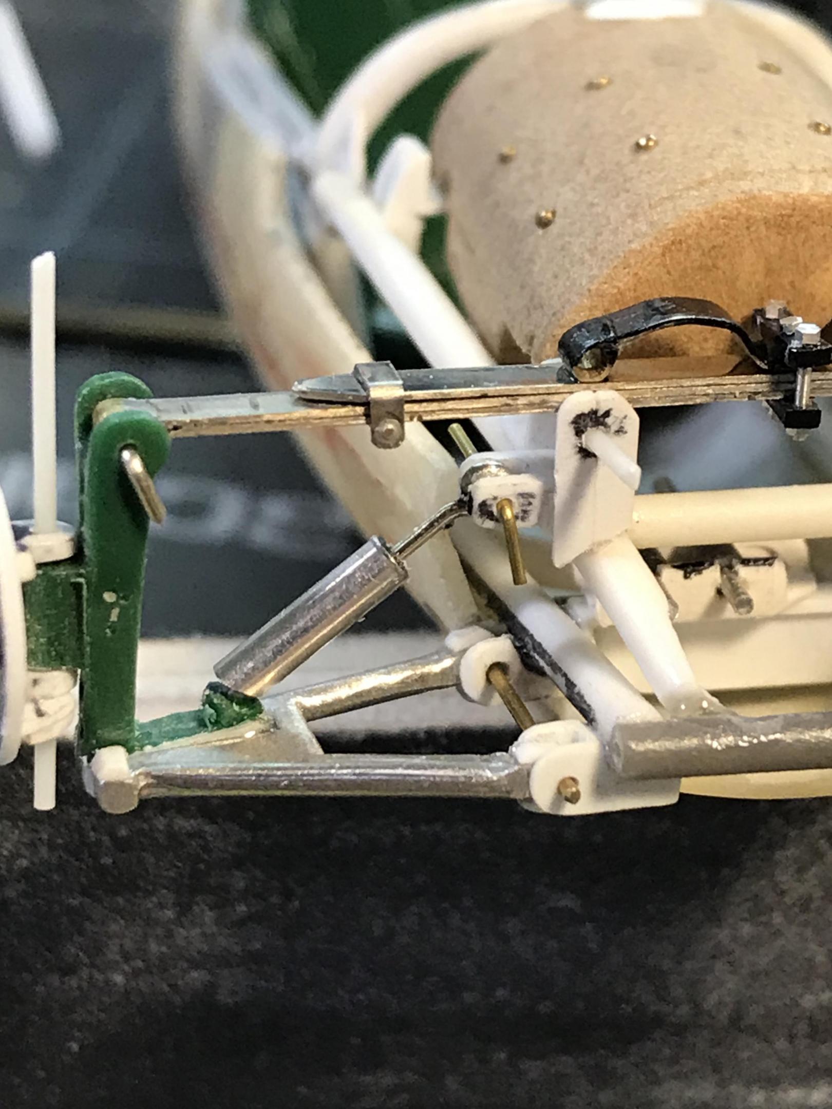

2 things   The susp arms wh metal castings retain the sink marks fr the merit injection moldings  .  So I punched out a couple of .010 filler discs and glued them into the recesses
thing 2. The susp arms have shock mounts welded onto the forward members.  So I made the mounts from two pieces of evergreen square bar - filed, drilled for bolt holes, sanded, then glued to the arms ...
Time to make the rear shocks ...
made from a short length of alu tube -  16th - with plastic plugs at either end - drilled for .019 nickel rod for the shock mount eyes and the plunger ...
No worry. The plunger length will be adjusted during assembly - the eyes are made as per the eyes for the shift linkage ... the shocks will be finished in black ... has anyone tried the oil based sharpies yet ??
