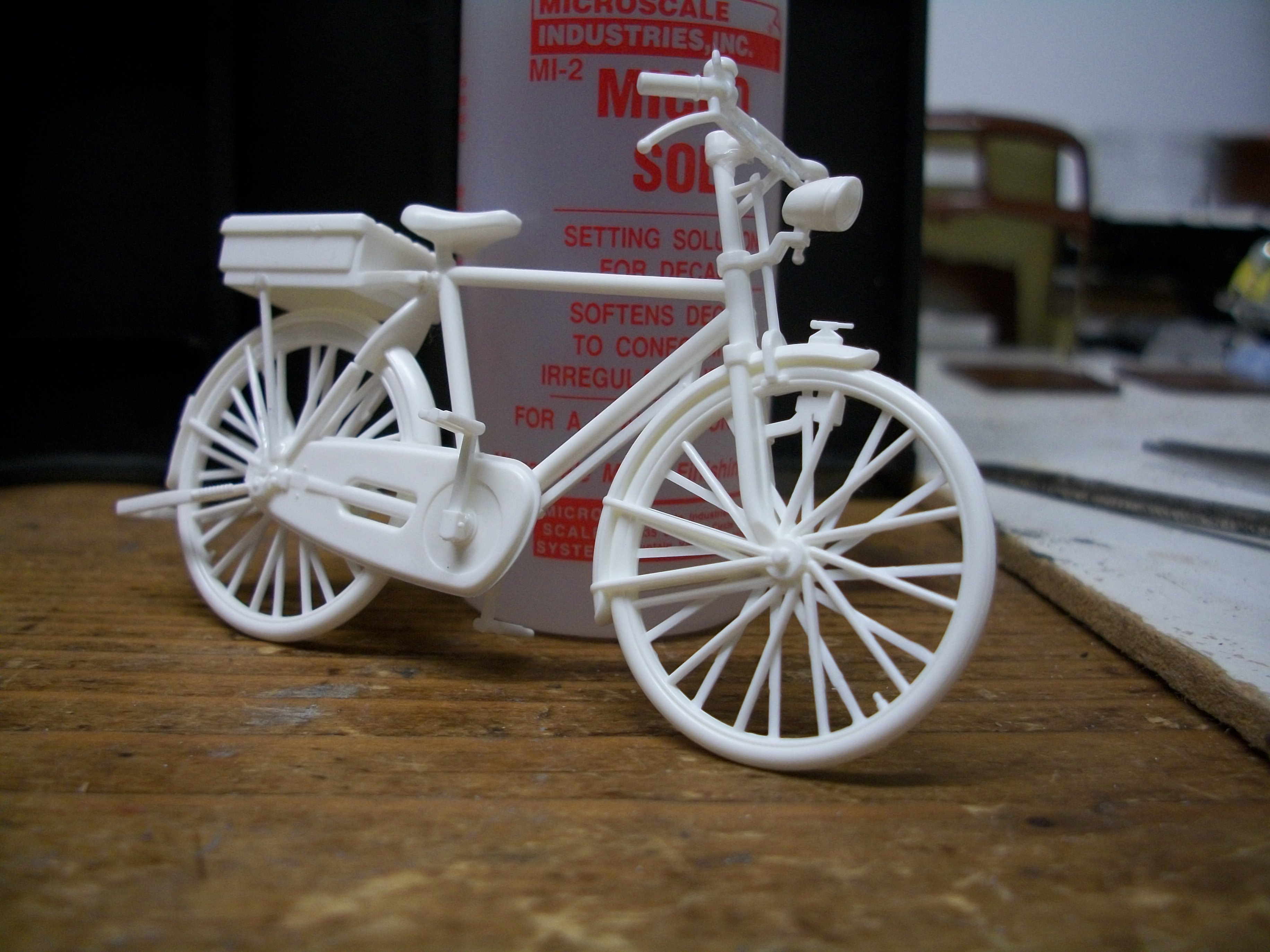

At the moment I am building a 1953 Bedford OLBD LWB Dropside lorry by Emhar, and also building a man's Vintage Bicycle which is from the Fujimi Garage Set Tools No.3 for dioramas. The Fujimi bicycle kit has 12 parts, compared to the Tamiya Vespa motor scooter which has 8 parts.  Among the parts in the garage set I have found two stoves, a kettle, a fire extinguisher and one or two odd shaped parts that could come in useful. The fire extinguisher is described as a ' Digestive Organ ' according to the Fujimi kit instructions...... ?

I had been weighing up the Fujimi kit for a few months really, because the bicycle was the only item I needed from that product. What made me decide to order the kit was when an MCM member posted on a topic that this vintage bicycle was actually very good. I think if I paint it very carefully, and use some Molotow Liquid Chrome Pen over the gloss painted surface, this should turn out to be a realistic looking bicycle for the diorama photography.

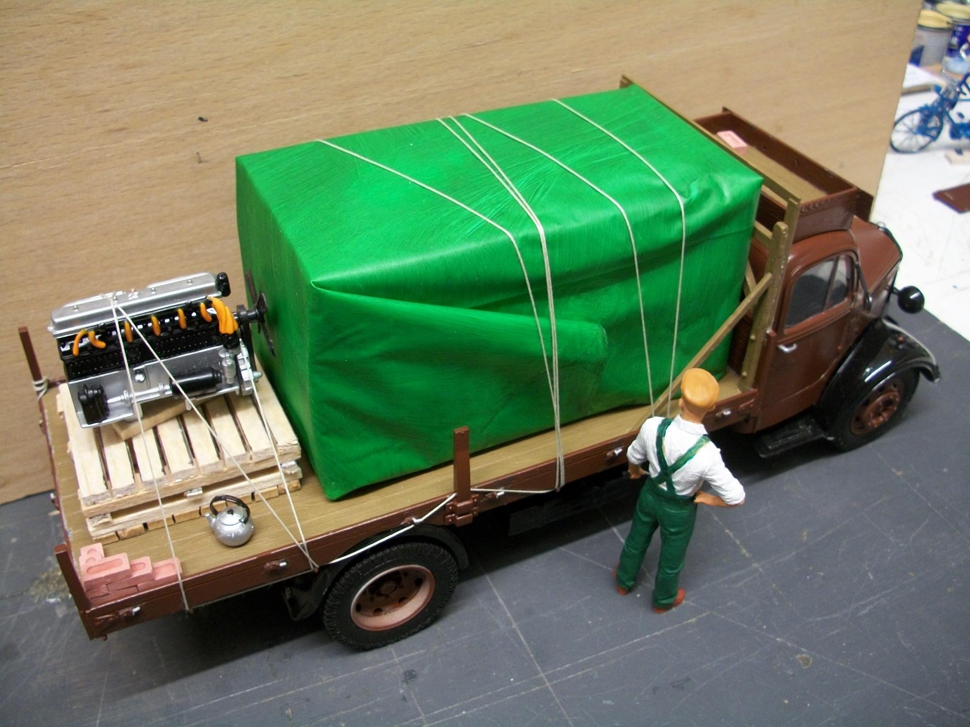

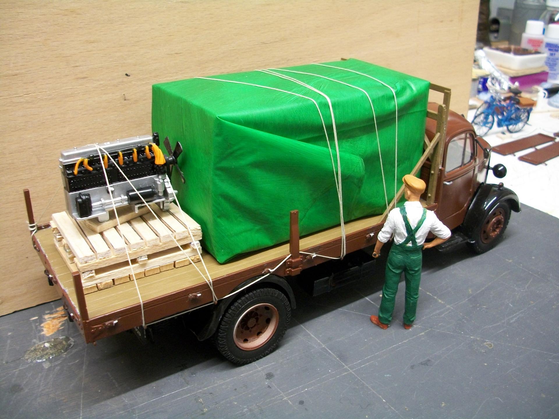

Here is the 1953 Bedford OLBD dropside lorry, which is now completed, and I have scratch built a green tarpaulin, a wooden pallet and some ropes to go with the vehicle. These photos show only the initial stages of setting up the idea to see if it works, so the roping and sheeting is not correct yet, and the really interesting photography will come along later when the Bedford gets to the diorama setting. PC Dixon is having a quiet word with the Mr Watson, the lorry driver about his dubious roping and sheeting, and the Police constable is not happy with the insecure load. Furthermore, he is equally concerned about the kettle and the bricks, not to mention the ladder.
The tarpaulin is green garden refuse sack material in PVC, with Sap Green acrylic paint applied with a dry toothbrush. The pallet is constructed from balsa wood and the ropes are 1:24 scale rigging for model ships. The rope size is correct at 0.5 mm to represent 1/24th of 12 mm rope in full size.

Well spotted Gary..... there are two bicycles in this diorama now, the most recent being the gent's Fujimi bicycle from the garage tools set, and the other one is a 3D printed lady's bicycle from Shapeways.
