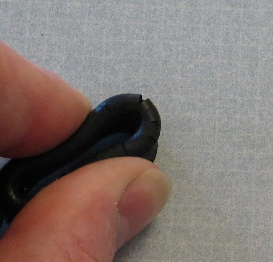

Brendan Posted June 24, 2008 Posted June 24, 2008 Please forgive me but I seem to remember wher not too long ago in another magazine wherein the "letters colum where a reader wrote in with a similar dilemma . The article editor wrote in the magazine where vynil compounds were changed since the 1960's kits had been produced, yes I will agree with that statement as I have a bag of those tires. Now personally I have not noticed what you're seeing. Ed Shaver Yes, they did change the formula but the tire is still made of vinyl. Vinyl has a tendency to shrink over time and that's what the main problem is... Sometimes they'll melt and shrivel up into a ball of oily mess. Or like the pictures I have below, they'll shrink on the rim and start to crack. I've had rims actually get crushed by the tire shrinking. Even with the newer kits, it will happen. One just has to be aware of this. The pictures below are of a tire that was on a kit no more than 5 years old. The rim is metal so that's the reason it hasn't been crushed yet. I'm squeezing the tire to show the crack a little better in the photograph.
