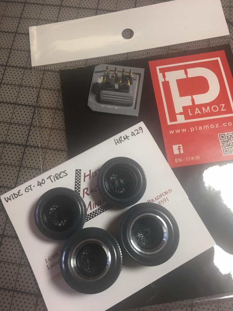

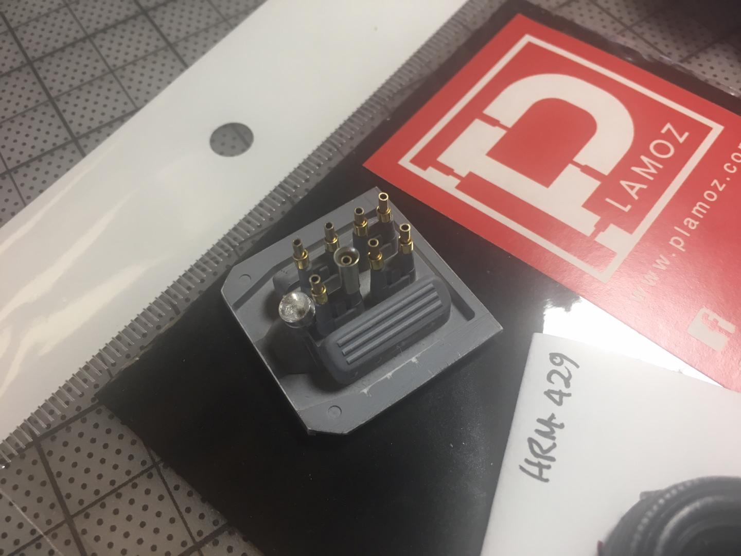

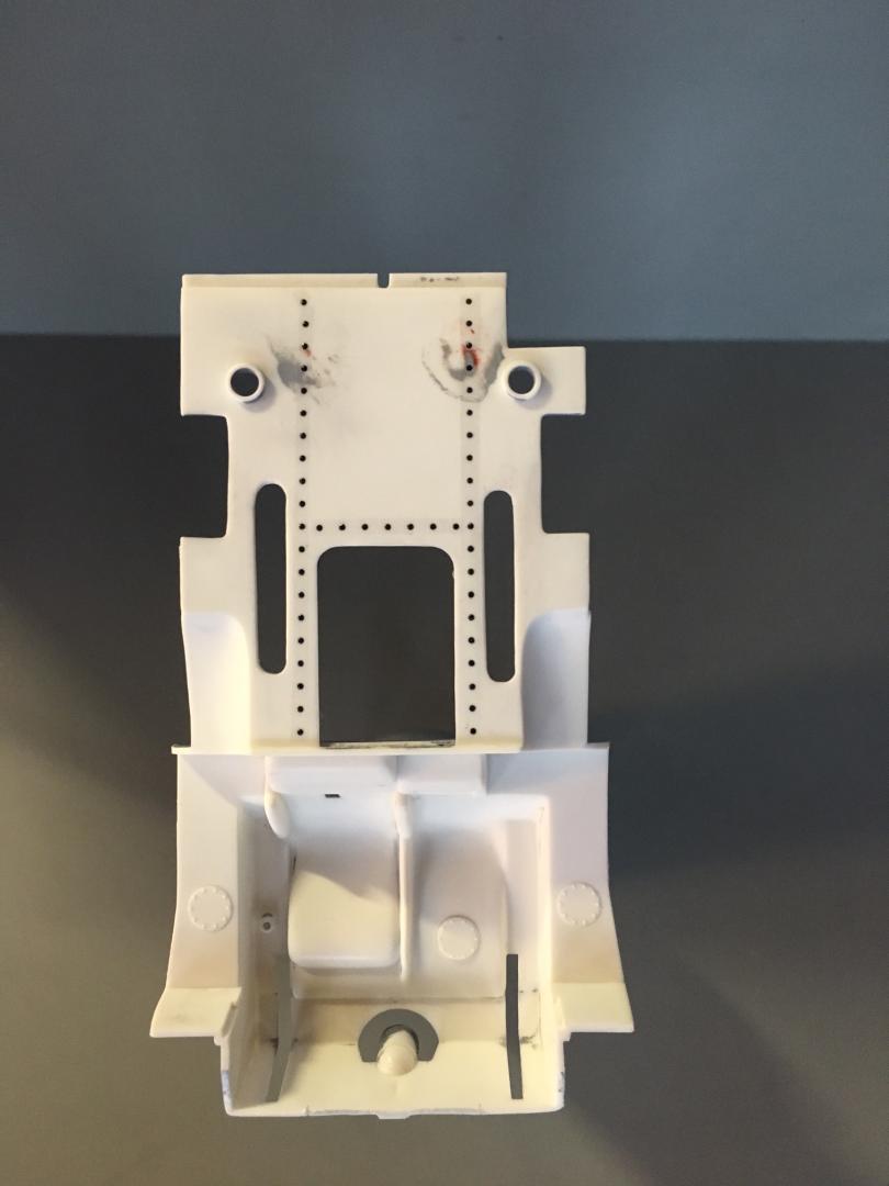

aurfalien Posted November 5, 2017 Posted November 5, 2017 Hi, I feel comfortable enough starting on Eds Monogram Chaparral 2 Coupe kit which was a 2D Daytona. I plan to shoot the chassis in Alclad Aluminum and the body in a bright shiny white. To me Ed was an angel of sorts so I will make it as bright a white as possible and ideas on this are welcome as I'm unsure how to achieve a truly bright white. I test fit a carb stack and distributor and cut out areas for a brass mesh. The tires are awesome HRM GT40 and I'm using the Plamoz stuff for seat covers. The wheels are from one of my failed Chappy projects.

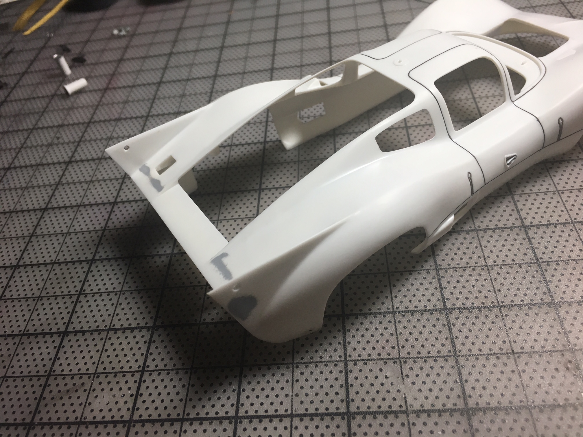

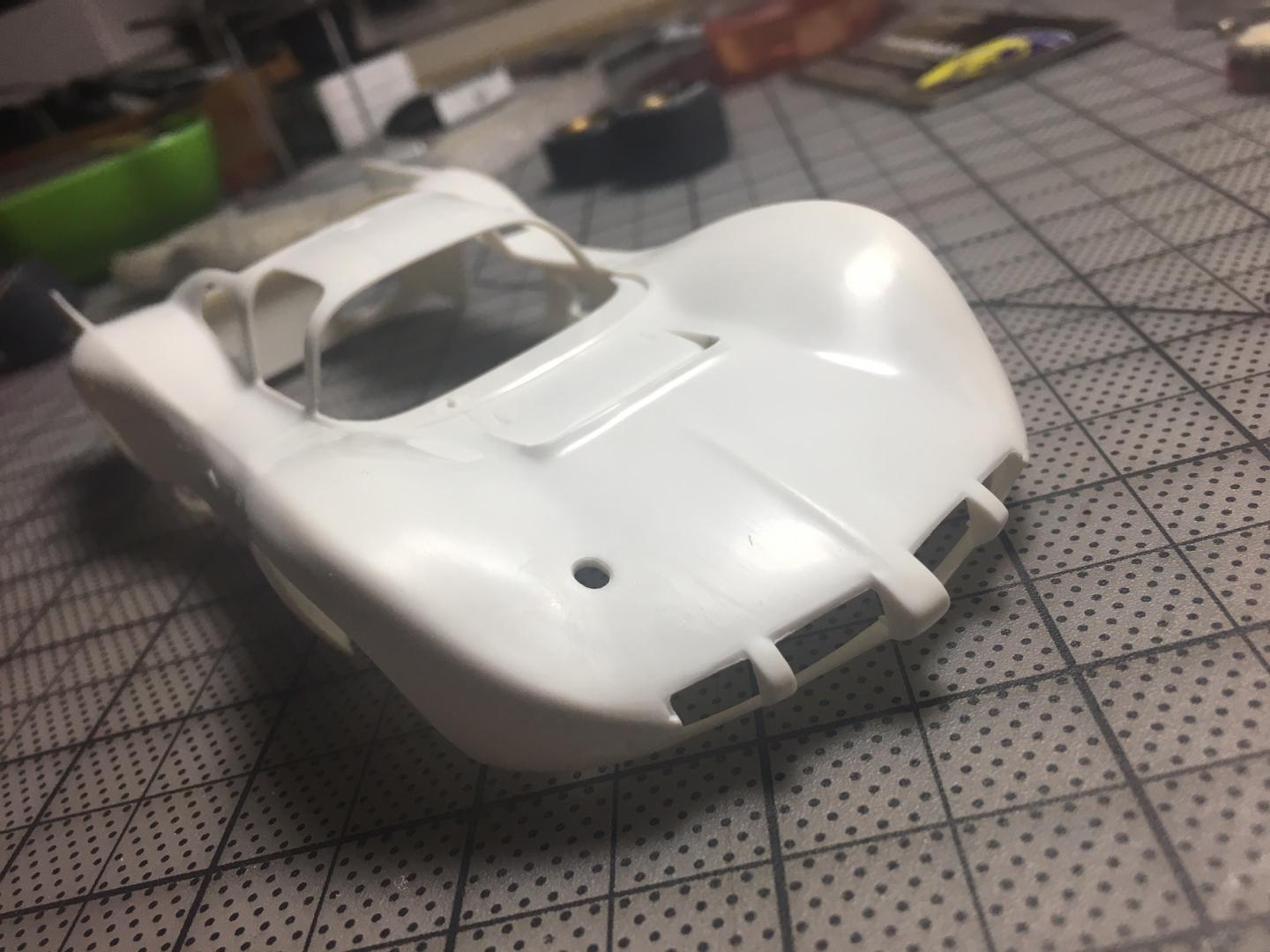

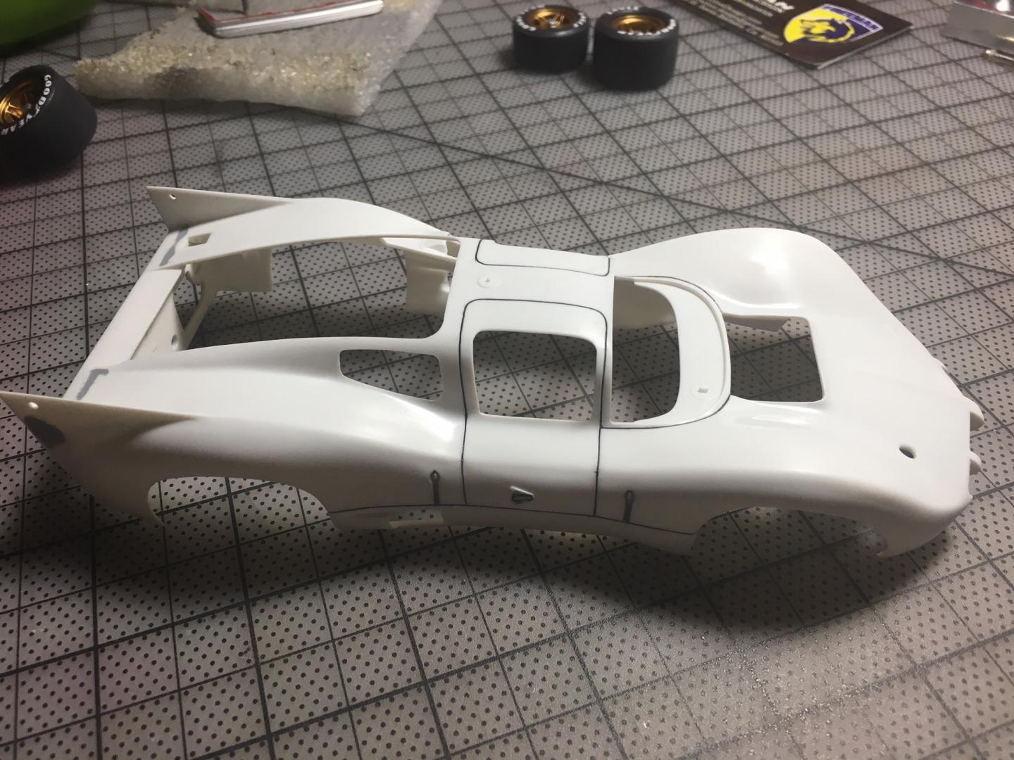

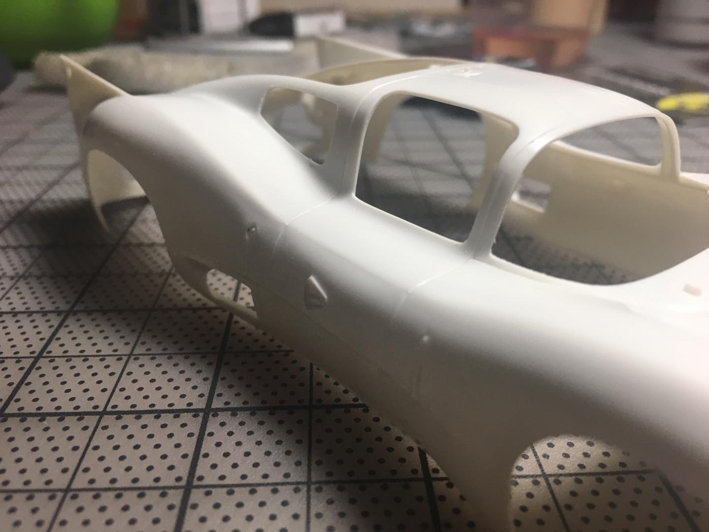

aurfalien Posted November 6, 2017 Author Posted November 6, 2017 Hi and than you sir. I sanded the heck out of the body, every square CM seemingly had some issues. I also managed to cut out some spaces for mesh etc...

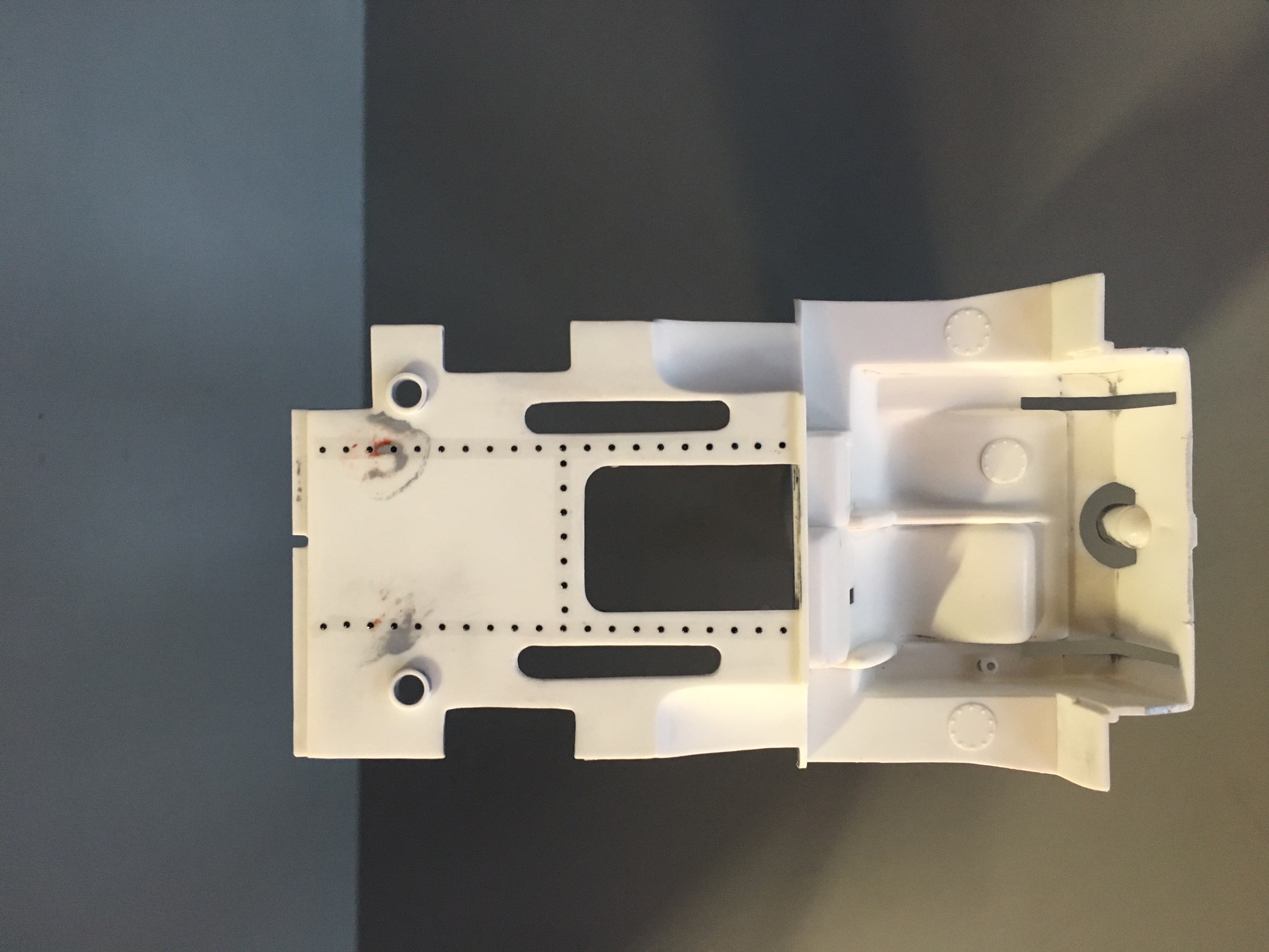

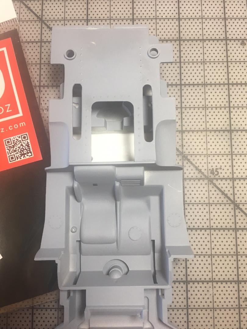

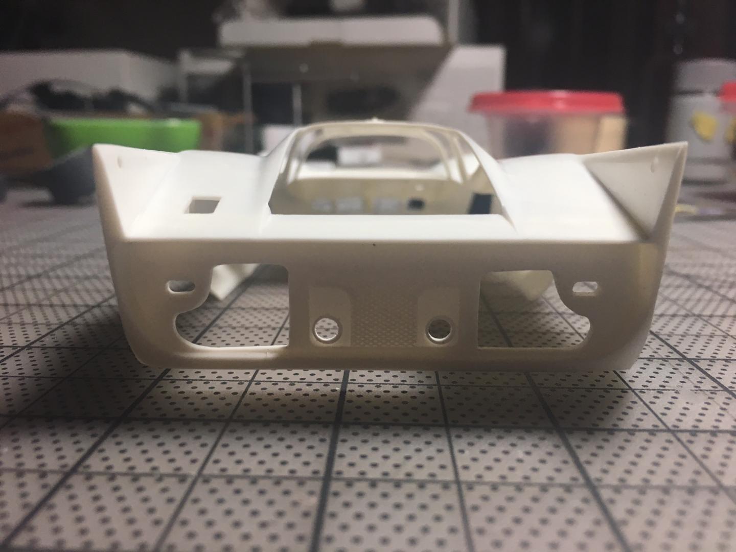

aurfalien Posted November 8, 2017 Author Posted November 8, 2017 (edited) Hi, I filled in some sink marks/irregularities and darkened the panel lines. I'll forgo grey primer and go directly with the white primer as I've one of those lighted magnified dork head bands which work amazingly well. It help helps me catch a lot of stuff. PS BTW the Monogram Chappy has a very very nicely molded body. Sure a decent amount of clean up is needed but hey its an old kit. But man, what a sexy beast Chaparrals were and Monogram did a great job with there Daytona version. The wheels/tirws, in typical fashion of domestic kits, are horrid but that's easy to fix. Edited November 8, 2017 by aurfalien
FabbricaP Posted November 8, 2017 Posted November 8, 2017 Great work so far. The stacks look amazing are they from the kit or aftermarket? Just one suggestion if I may- I strongly recommended that you give the body a coat of grey primer before the white primer. The grey compound filled-in areas will likely show up through a white paint coat if only white primer is used.
aurfalien Posted November 8, 2017 Author Posted November 8, 2017 Great work so far. The stacks look amazing are they from the kit or aftermarket? Just one suggestion if I may- I strongly recommended that you give the body a coat of grey primer before the white primer. The grey compound filled-in areas will likely show up through a white paint coat if only white primer is used. Hi,Good idea, I will go grey first then.I built up inner stacks/venturies so that the stack from ScaleProdution will fit straight and true. The top of the engine is from a failed Fujimi Chaparral project.Thanks again for the nudge in the right direction.* Randy Ditton@Model Builders Warehouse carries ScaleProduction warez so I'd order the stacks from him.

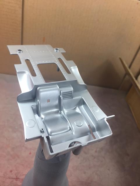

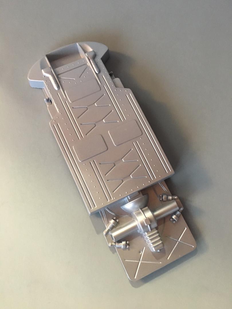

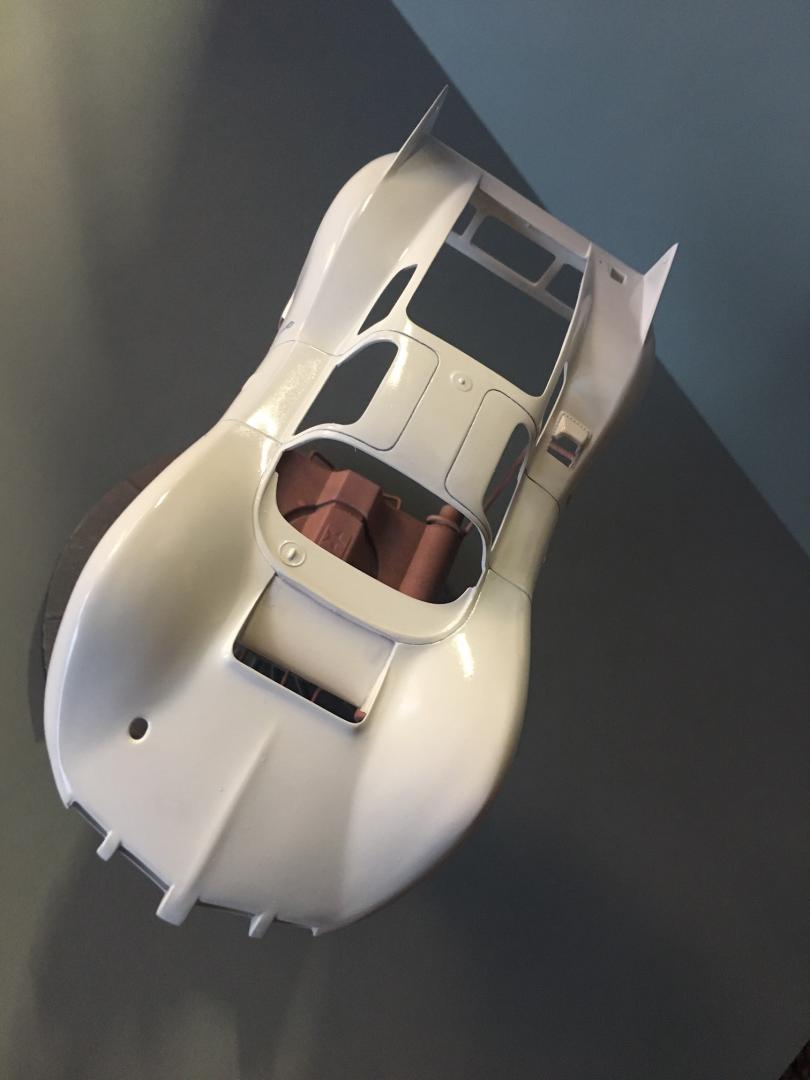

aurfalien Posted November 13, 2017 Author Posted November 13, 2017 (edited) Hi, Been a bizzy and productive veeekend! I had to strip the chassis as I switched to lacquer which has a way diff work flow then acrylic, also redid the rivet decals a bit better. I'll paint the chassis same color as the tub. The body is pretty much final, giving it a few days to cure before deciding on additional coats. However I'm thinking 2-3 more coats. I sanded off the wiper from the windshield and am waiting for a PE set to arrive, also applied silver rivet decals around the side windows. Edited November 13, 2017 by aurfalien

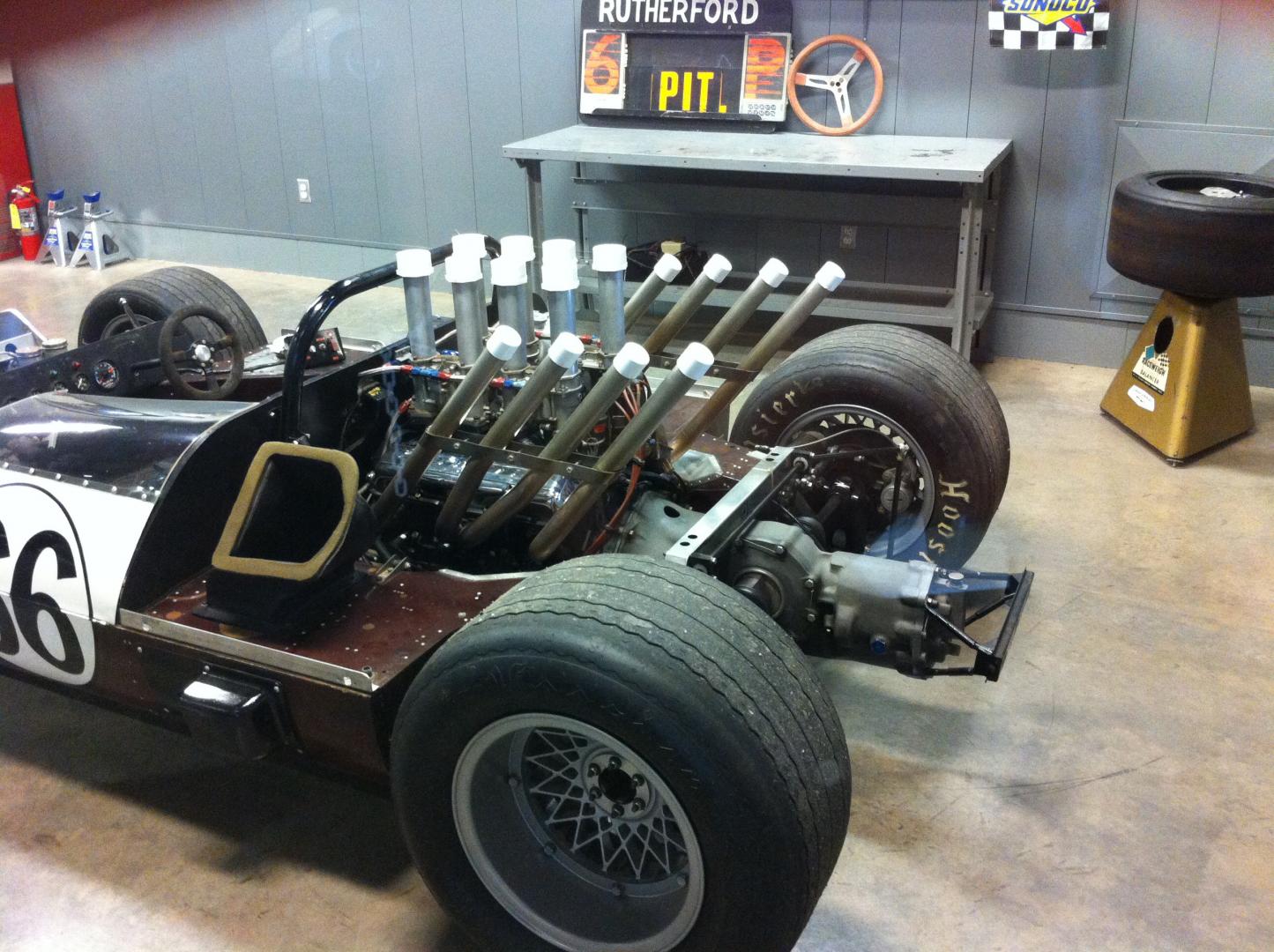

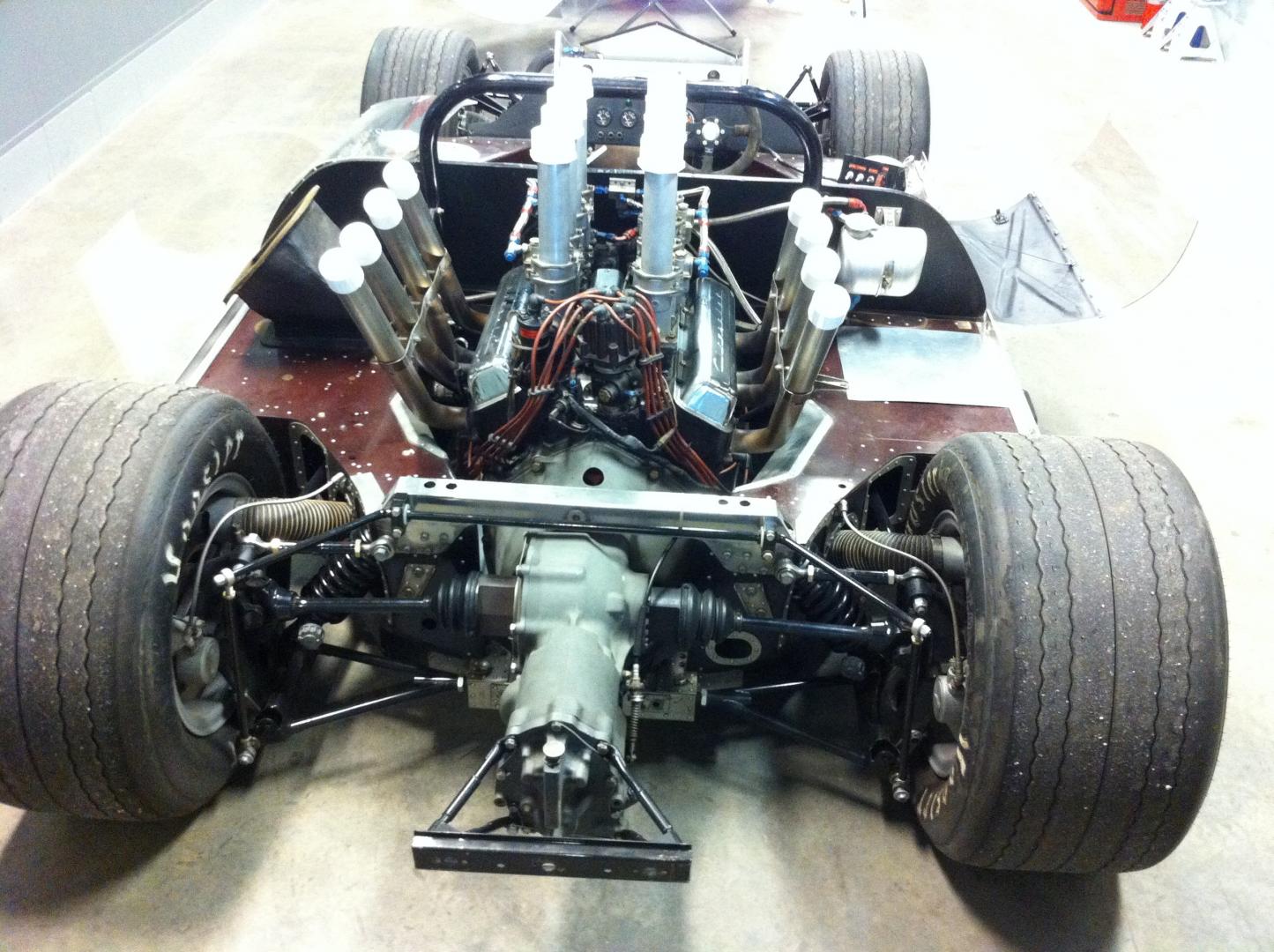

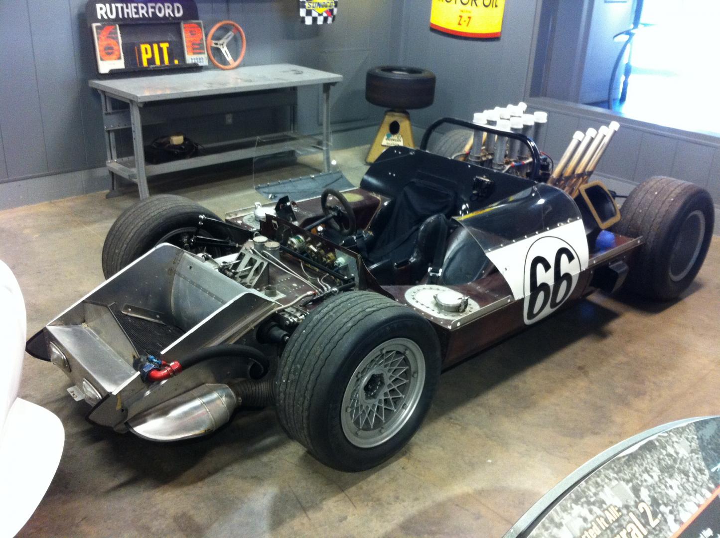

El Caballo Posted November 13, 2017 Posted November 13, 2017 I have a ton of Chaparral Museum pictures, can't remember if I posted them here or not. Anyway, just about the only thing for me to see in Midland, TX.
aurfalien Posted November 13, 2017 Author Posted November 13, 2017 I have a ton of Chaparral Museum pictures, can't remember if I posted them here or not. Anyway, just about the only thing for me to see in Midland, TX.Hi,Would you happen to have any of the Daytona as modeled by Monogram?
El Caballo Posted November 14, 2017 Posted November 14, 2017 That car was not at the museum, otherwise I would have a picture of it. But, here are some pics you may be able to use for details. I do have a bunch of pics of the other cars I could post if you think it may help you.

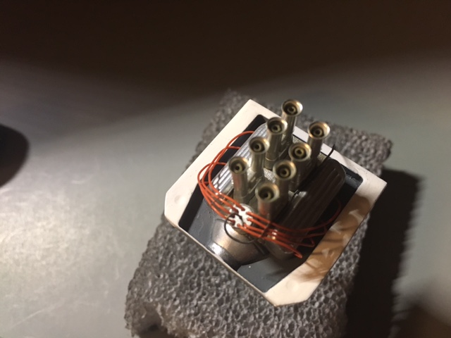

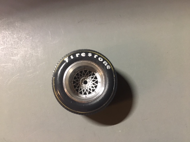

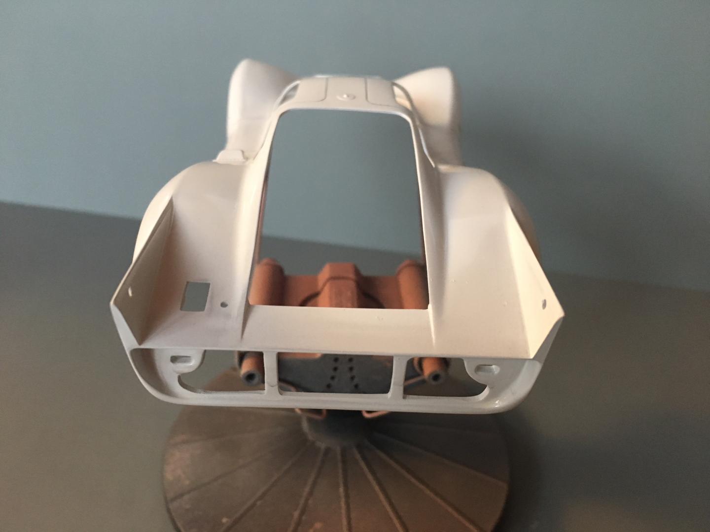

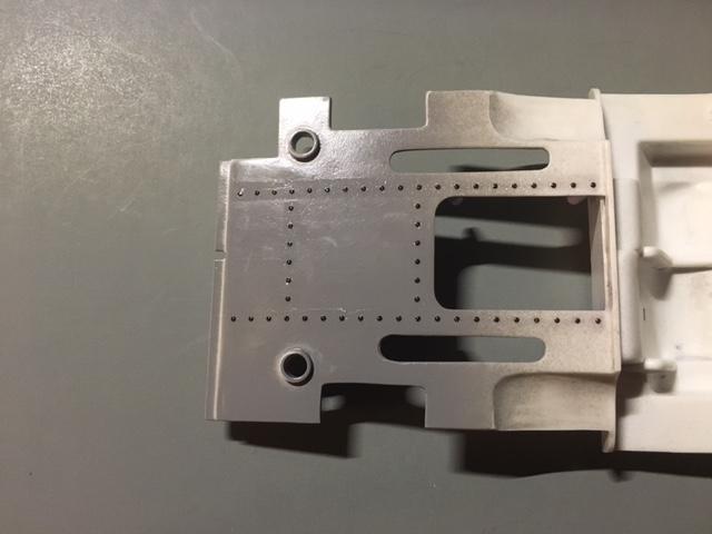

aurfalien Posted November 20, 2017 Author Posted November 20, 2017 (edited) Hi, Got the engine all wired up etc... I'm going to get some fine tip gold pen to finish up the tires as the decals were not large enough to fit. I had to strip the chassis as the top coat showed sink holes that I coudn't see via primer. So I sanded and sanded and have some filler/primer on there now. I coated with Future to see if a shiny surface would reveal flaws as a flat surface seems to hide them. Even though the body looks pretty good, I'm waiting to apply another top coat however I've ordered the Donn Yost DVD and will wait until it shows. I've screwed up far too many builds and need some help so I'm excited about the DVD. Edited November 20, 2017 by aurfalien
aurfalien Posted November 26, 2017 Author Posted November 26, 2017 Hi, Got final paint on chassis and body. Will wait a few days before I even touch them.
aurfalien Posted November 27, 2017 Author Posted November 27, 2017 Hi and thank you sir. This build has taught me the deep value of surface prep. As I came to find out that my paint woes with regards to the chassis and Alclad were due to an orange peeled surface of the styrene. My young eye so to speak did not catch this at first, or second, or third etc...

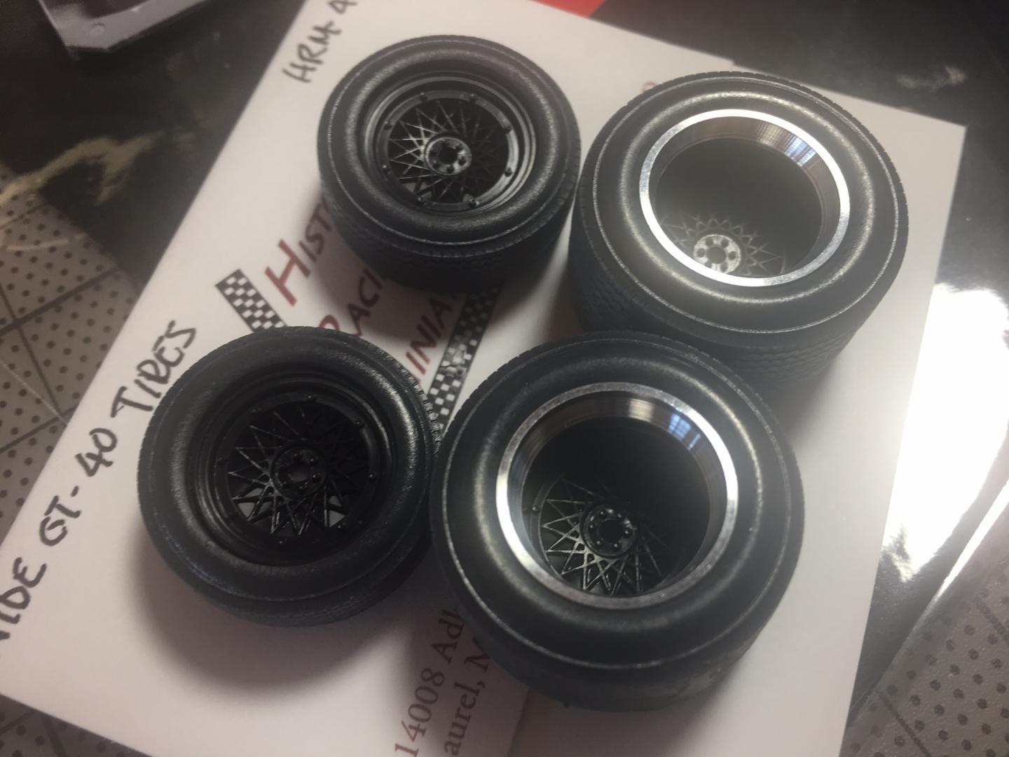

Randy D Posted November 28, 2017 Posted November 28, 2017 Hi Brian, The build is looking great so far my friend!!! Chassis and body are sweeeeet and I love the motor top plate. Are those Indy Cal decals on the tires? Randy
aurfalien Posted November 28, 2017 Author Posted November 28, 2017 On 11/27/2017 at 3:12 AM, vintagercr said: Nice detail On 11/27/2017 at 7:29 AM, Kemszi said: Looks good! 15 hours ago, Randy D said: Hi Brian, The build is looking great so far my friend!!! Chassis and body are sweeeeet and I love the motor top plate. Are those Indy Cal decals on the tires? Randy Hi and thank you sirs. They are indeed Indaycals which are superb.
65slotcar Posted November 30, 2017 Posted November 30, 2017 nice work so far, wheels look great with aluminum insert and tire logo
