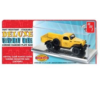

crowe-t Posted December 8, 2017 Posted December 8, 2017 I'd like to permanently mount a car in a display case, like the one in the attached picture. What would be best, to glue it down or somehow tie it down? If I use glue will epoxy work on the kit's rubber tires? Any advice will be appreciated.
Ace-Garageguy Posted December 8, 2017 Posted December 8, 2017 A lot of clear cases come with small holes in the "floor" that are intended to be used for tying models down. Fine wire is the material of choice, looped around the axles or frame, and allows the model to be removed relatively easily should the desire arise.
espo Posted December 8, 2017 Posted December 8, 2017 I would not recommend gluing the tires to the base. There might come a day you want to display some other model or just remove the model for cleaning. The models I've seen "mounted" usually are tied in someway to the base. Unless you plan to ship the model to someone or plan on it getting knocked around I'd just leave it in the case, and be sure the tires don't allow the model to roll around.
crowe-t Posted December 8, 2017 Author Posted December 8, 2017 I will be shipping a model and I also want the model to be 'permanently' attached. I'll tie it down with wire. Has anyone used the AMT Deluxe Display base? Does it have holes or will I need to drill them?
espo Posted December 9, 2017 Posted December 9, 2017 Since you're going to ship your model I would also suggest protecting the model inside the cover also. I would use a very soft towel or something on that order that would not scratch the paint surface. The cover could be attached with a rubber band or some tape. Then place the case in a larger box with some foam particles from UPS or Office Depot I think sells them.

Bucky Posted December 9, 2017 Posted December 9, 2017 The AMT cases come with vinyl covered wires to use for attaching the model. Also, there are holes embossed from the bottom. There are plenty to choose from, depending on which mounting points you choose. I always try to use the four corners where the wheels are mounted to the frame.
kitbash1 Posted December 13, 2017 Posted December 13, 2017 I put a drop of clear silicon caulking on the bottom of the wheels and let it sit overnight to dry. That way if I need to remove the model from the base, I can run an Olaf type knife blade under the wheel to cut the silicon.
