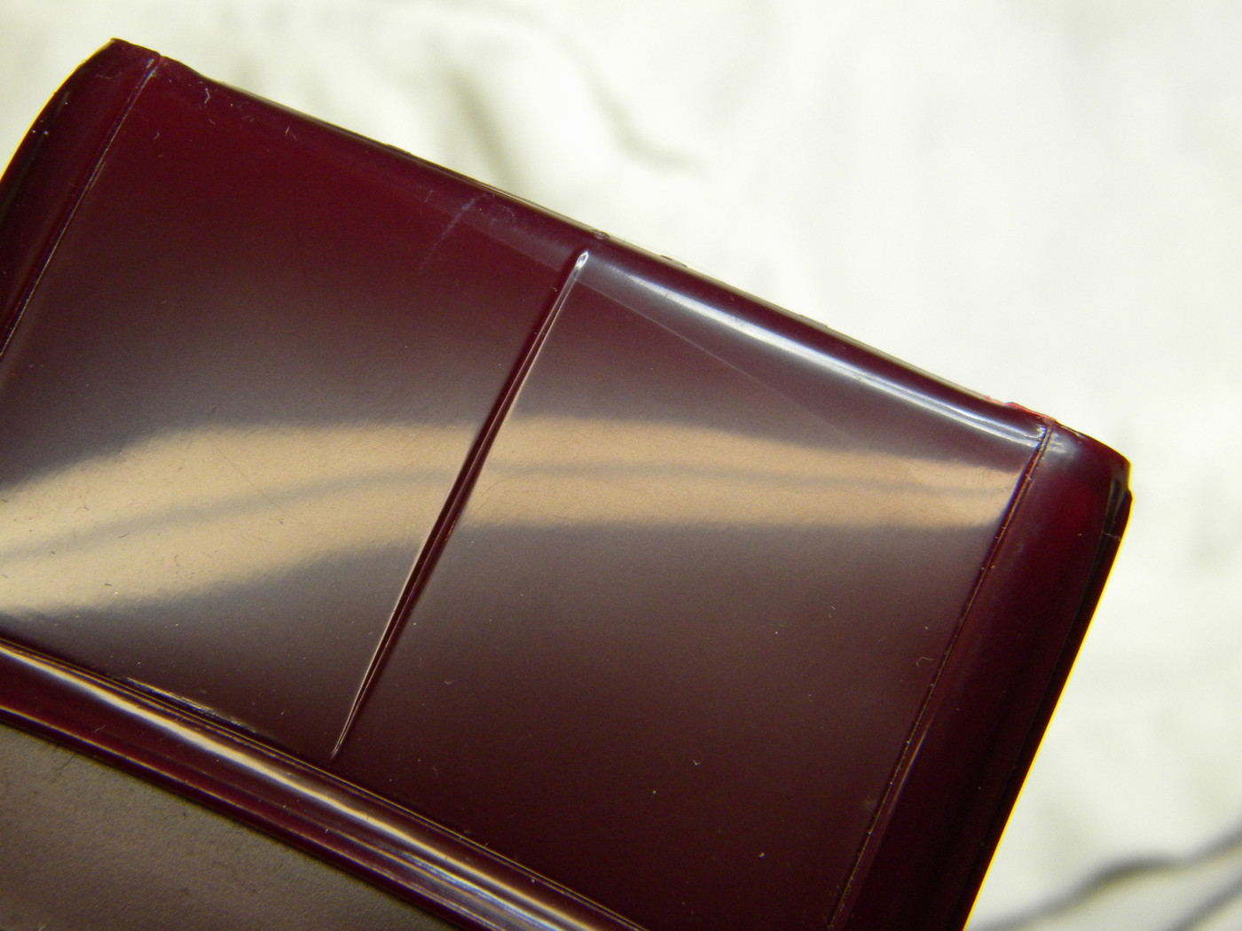

StevenGuthmiller Posted February 17, 2018 Posted February 17, 2018 Just a word of warning. Before you attempt to polish bare plastic on a particular kit, check it over well to be sure that there are no "swirls" in the color that can very often occur during the molding process. These will not come out no matter how much you polish. Steve

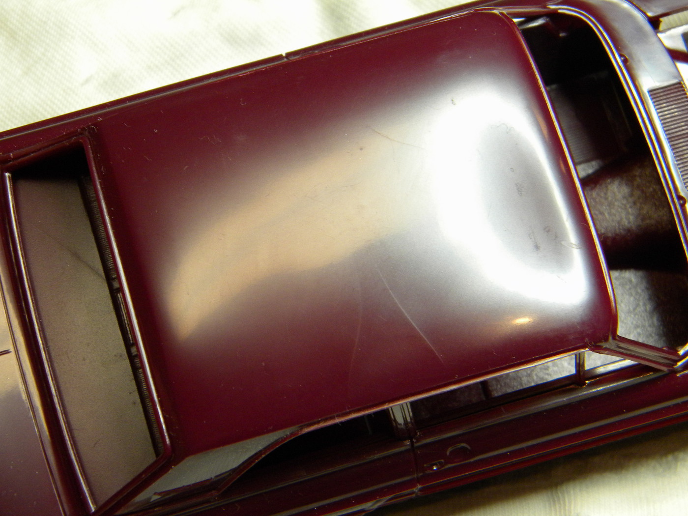

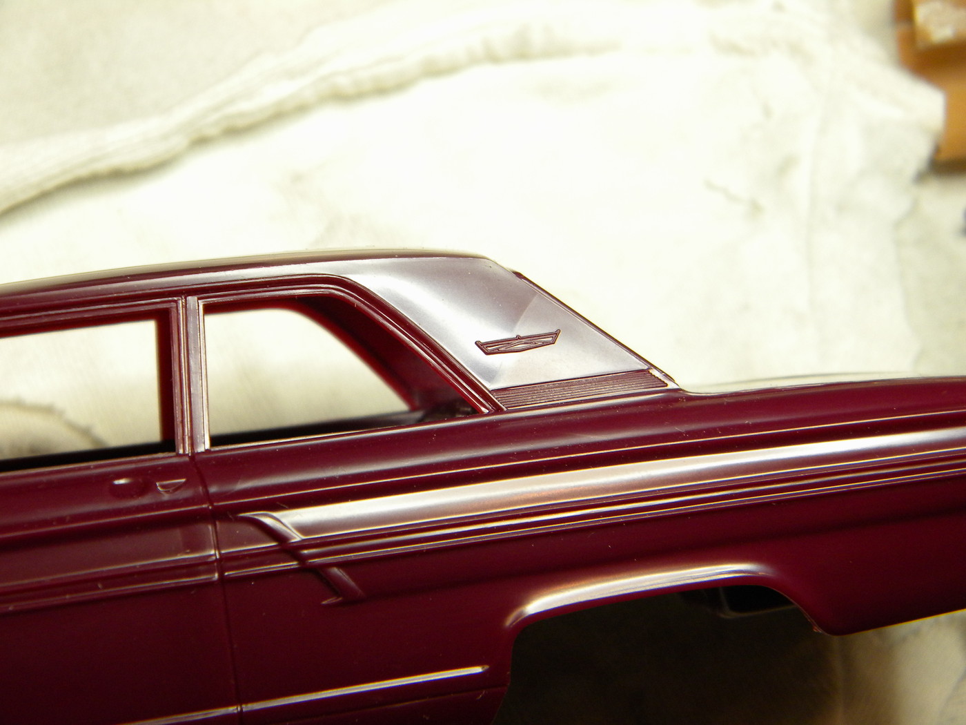

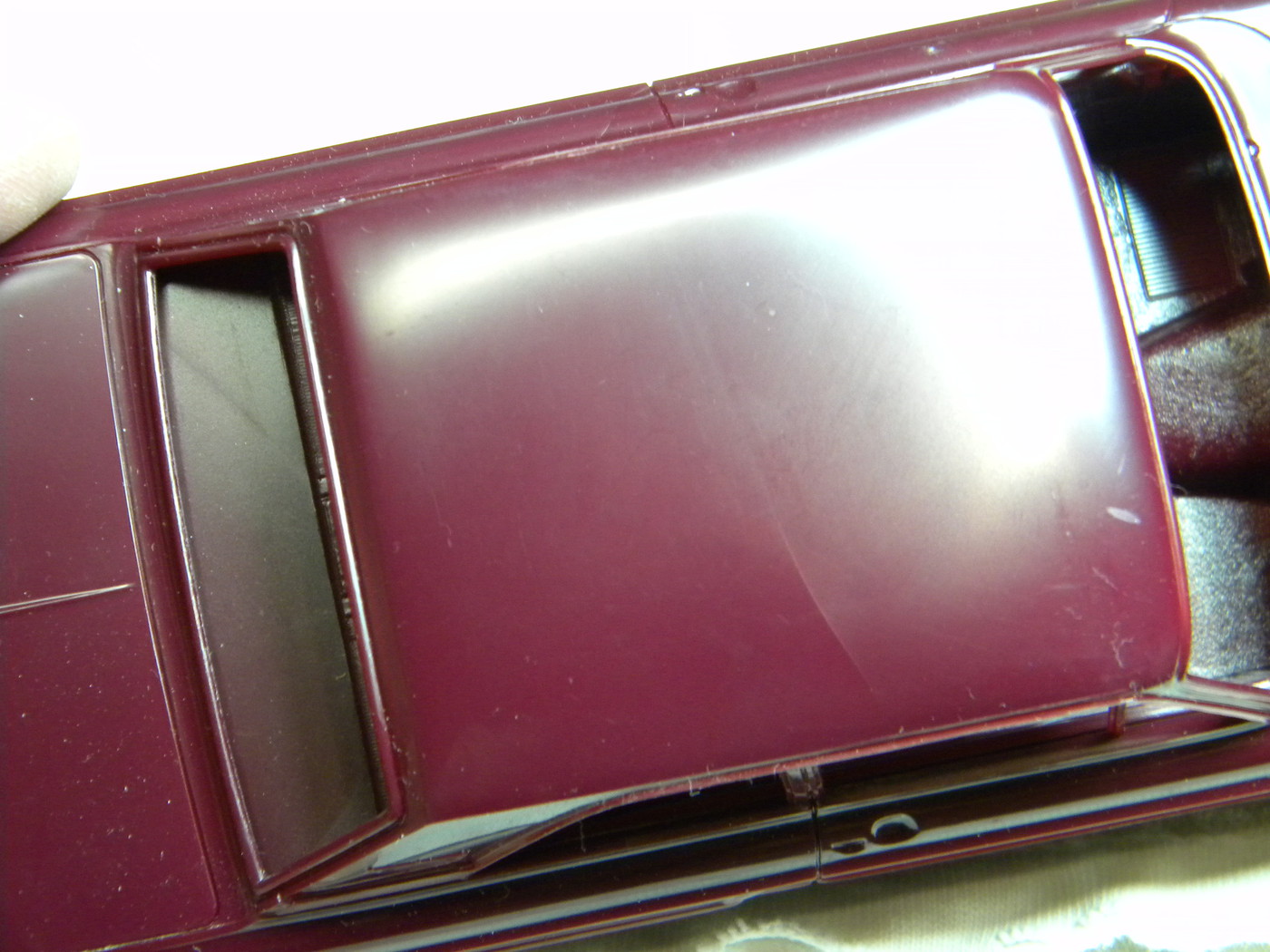

StevenGuthmiller Posted February 18, 2018 Posted February 18, 2018 1 hour ago, Snake45 said: Metallic plastic is just about the only place I ever see swirls. I can't recall ever seeing them on any solid plastic I've polished. At least nothing that bothered me at all, much less kept me from doing it. I see it all of the time. It usually will manifest it's self as a line running across a large panel area like a hood or roof. Just as an example, this Revell '64 T-Bolt has several of them Molded in non-metallic maroon, there is a large "Y" shaped one running through the center of the roof, another diagonally through the drivers side c-pillar, & one running the entire width of the trailing edge of the trunk lid. There's also a small one running through the rear of the drivers side door. Some of these might polish out, but I wouldn't bet on it. This is the first kit that I checked for this anomaly. Steve
