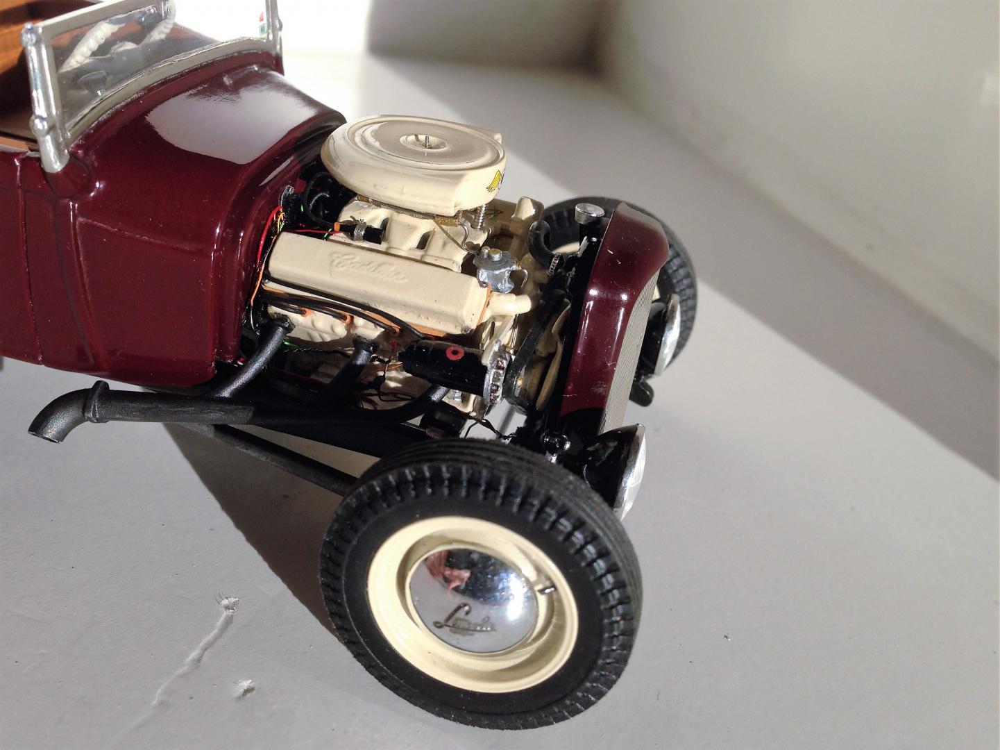

good point about the grill shell against the frame. I will shave and sand that area to get the radiator and grill shell to fit better. In reality, the radiator should be inside the shell rather than outside of it anyway. I need to do some work there. Not sure what you mean about filing all mounting surfaces. I'm still tweaking the fan pulley to get the fan to sit back a little, otherwise the fan clears. barely.

I think I have resolved my grill/radiator issue. The 32 grill shell from the Rat Roaster kit allows the radiator to sit inside rather than stuck onto the shell. It looks more like the real thing and moves the radiator forward just enough for fan clearance. I made a radiator mounting tab by cutting an angled piece of styrene and filing the back of the radiator so it will fit flush. I still have to drill mounting holes and install small posts to finish the radiator assembly. Side Note: A fellow modeler sent me a Monogram 32 hood. Turns out I will not need it. It's a tad longer but the same width at the cowl and grill. Something to keep in mind for future projects.

I'm finally getting into some paint with this thing. There's more chrome on this engine than in my last 3 projects combined. I fabricated a generator bracket and removed the molded fan belt and made one out of tape. I capped off the manual fuel pump with a finned breather cap from the Revell 40 street rod kit. The carb breathers are from the AMT 34 coupe. I was surprised at how well the Molotow chrome matched the kit chrome. Next step is plug wires and fuel lines.
The Olds Engine is done, wired and fuel lines installed. Frame has been painted, rear end installed and the front portion of the exhaust system has been chromed and installed. It's going together pretty good after paint, however, a few locating pins have snapped causing me to consider using metal pins for future builds.
