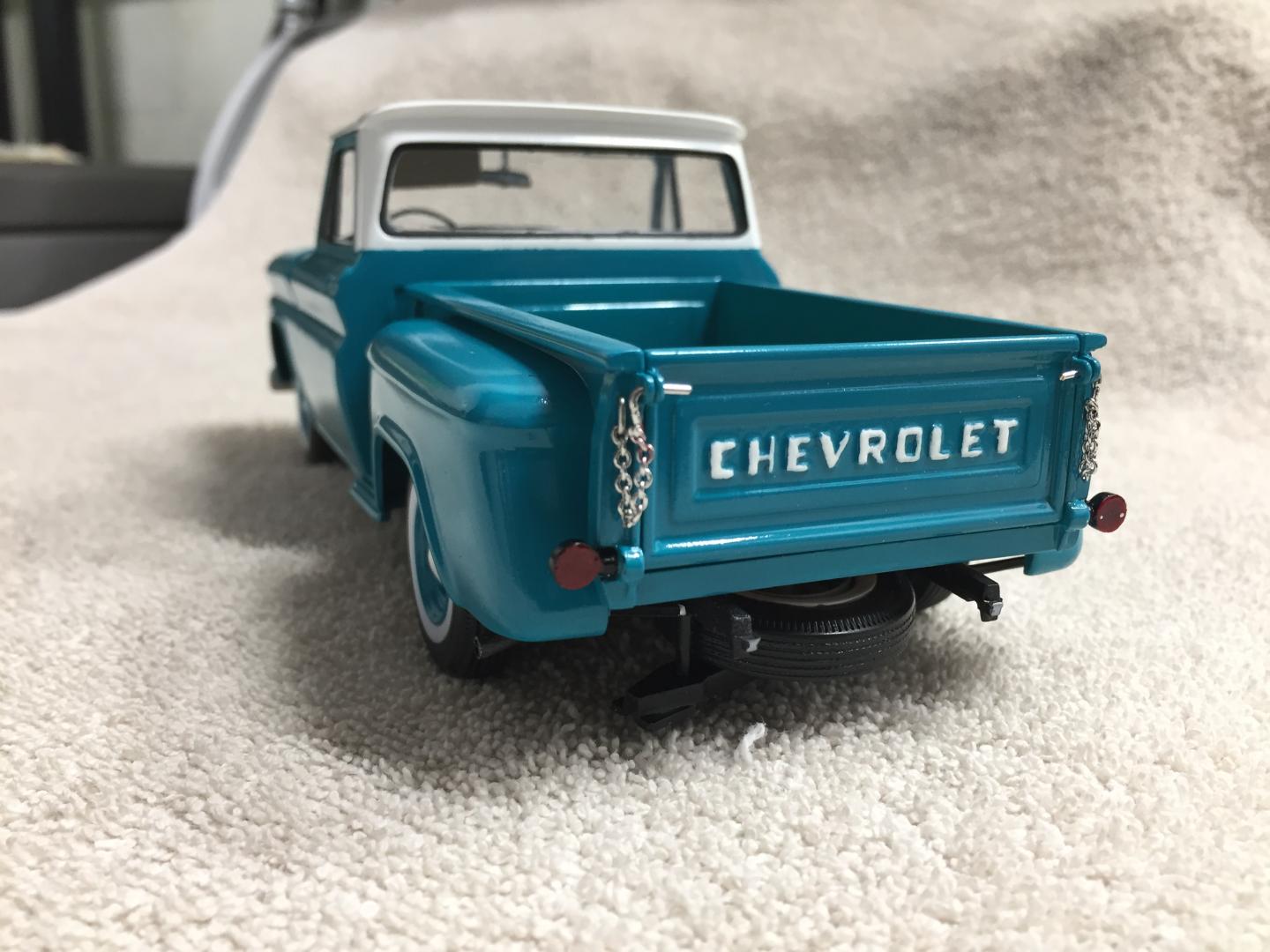

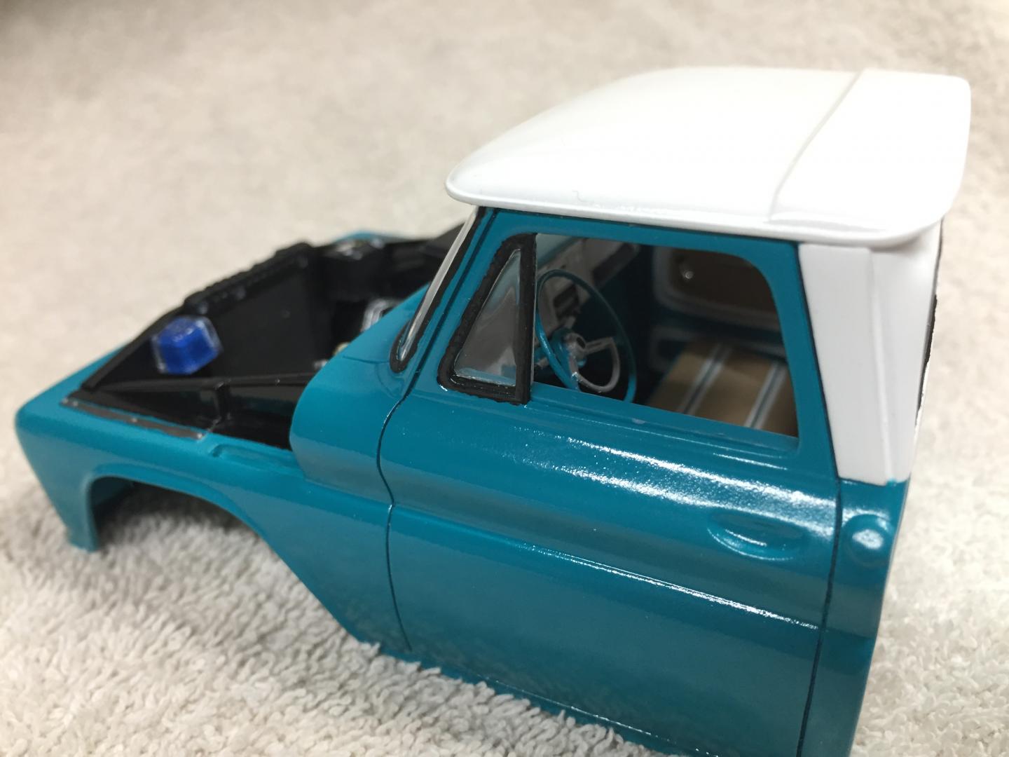

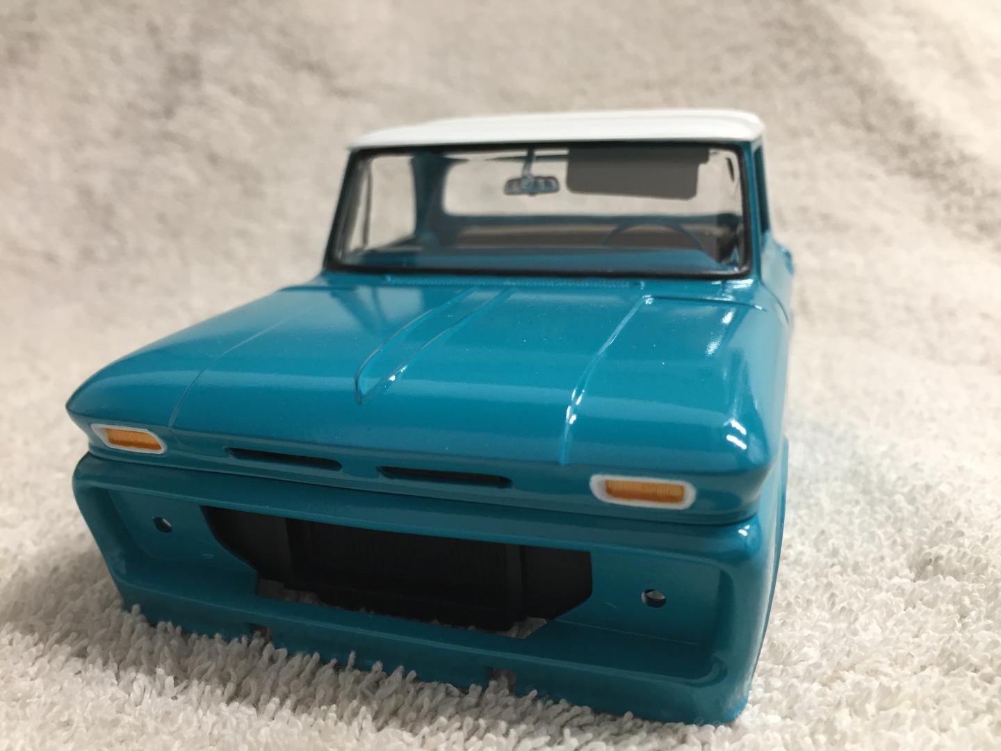

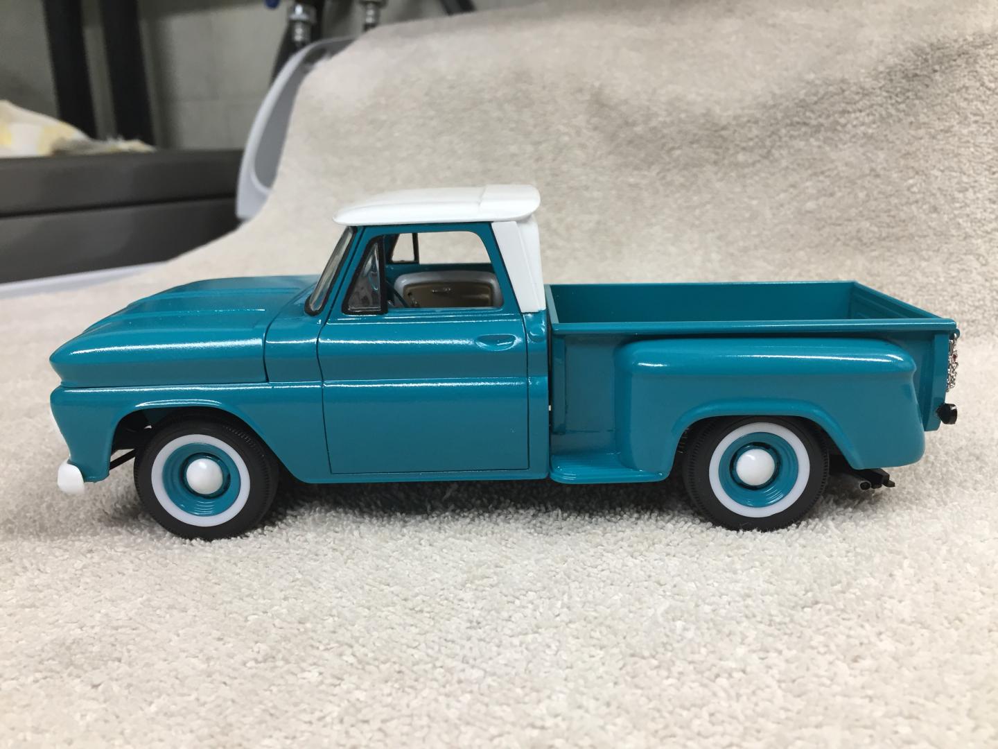

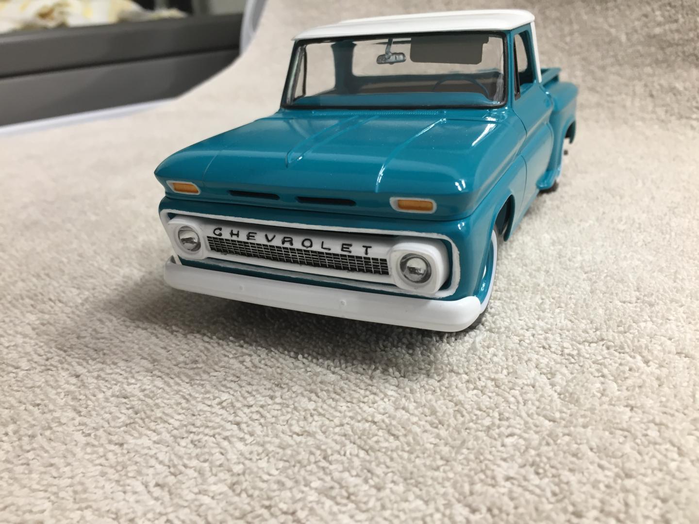

I got the glass and the interior installed. The windshield gave me a bit of grief, it doesn't really have a sweet spot that it sits in nicely so I have a slight gap at the top on the passenger side. Luckily the cab overhang hides it pretty well. I used regular cement, as I don't think the clear parts cement I have would hold it in place. Also managed to get the bed decal in and tailgate on.
Thanks, they are ear-ring making parts from michaels.
I also fixed the trailer hitch. I didn't like the little  nub of plastic they give you for a ball, so I chucked a finishing nail in my drill and shaped it a bit with a file. A touch of molotow and it looks better.

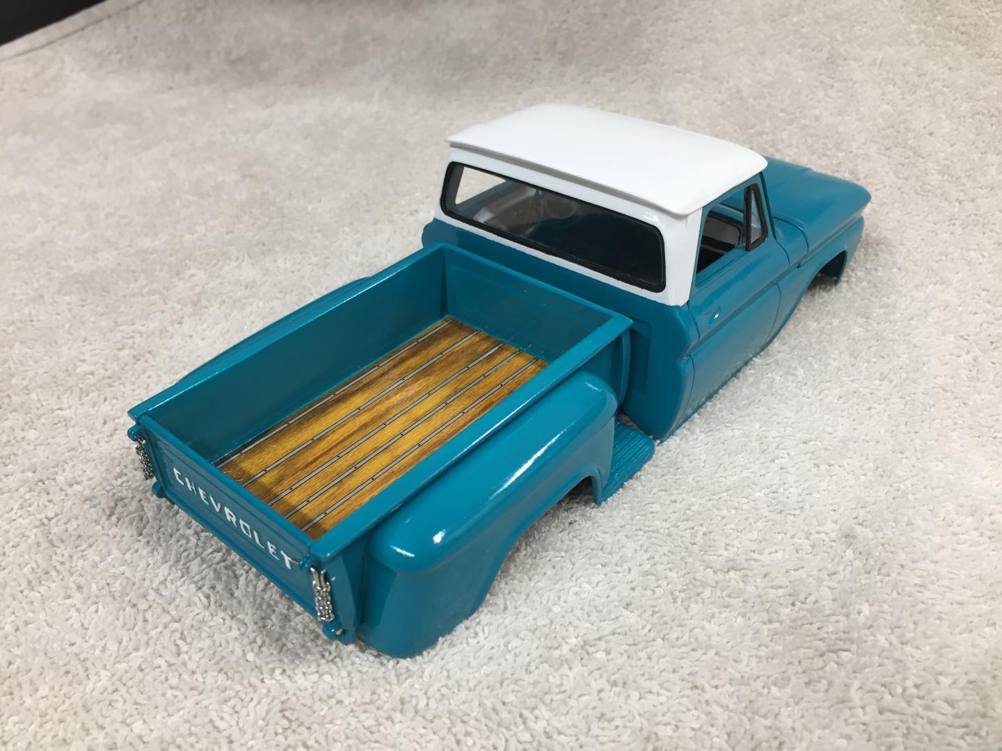

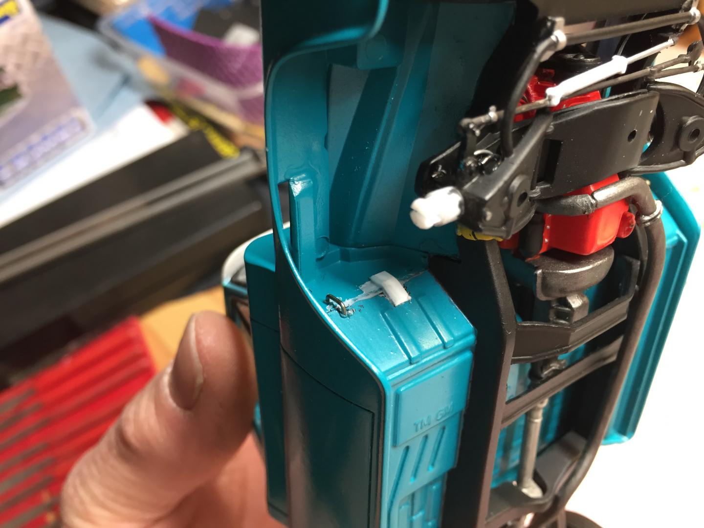

I had some trouble attaching the frame to the body. The floor pan did not want to meet up with the firewall nicely. I had to really squeeze it to get them to meet. Next time EVERYTHING gets a dry fit before any painting goes on.:unsure: I melted a couple of the prototype tailgate u-clips I had in place temporarily to hold it till the glue dried and then added a couple little straps to beef up the joint.

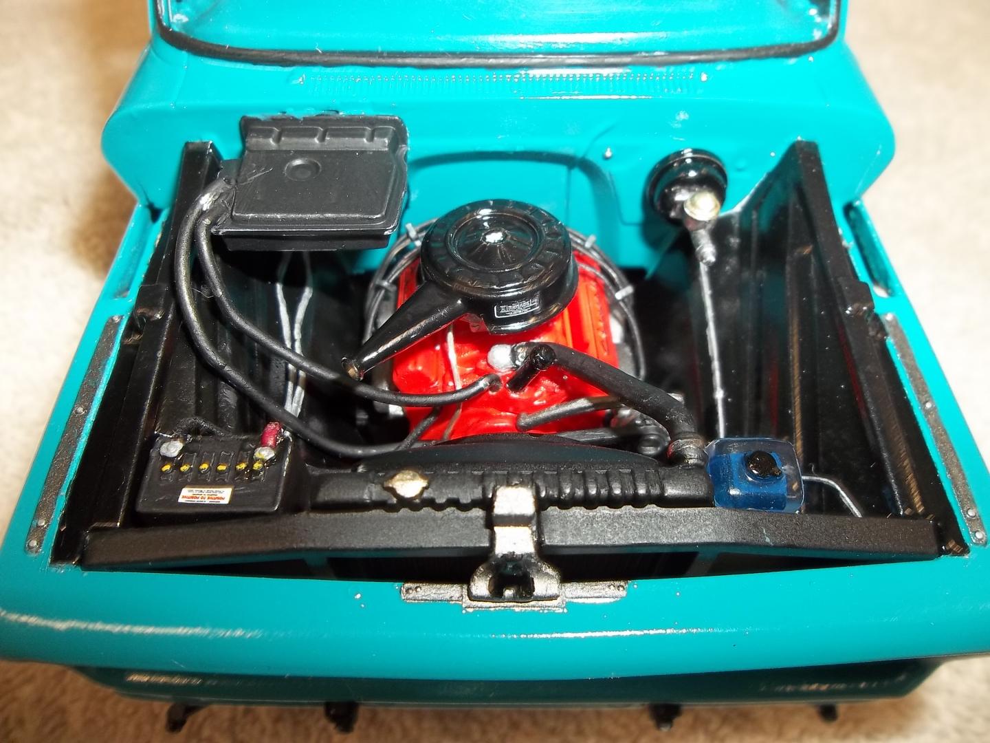

The engine bay is done. Battery cables came from an old cell-phone charging cable. Heater hoses are mechanics wire, hard to work with, but holds it's shape once formed!

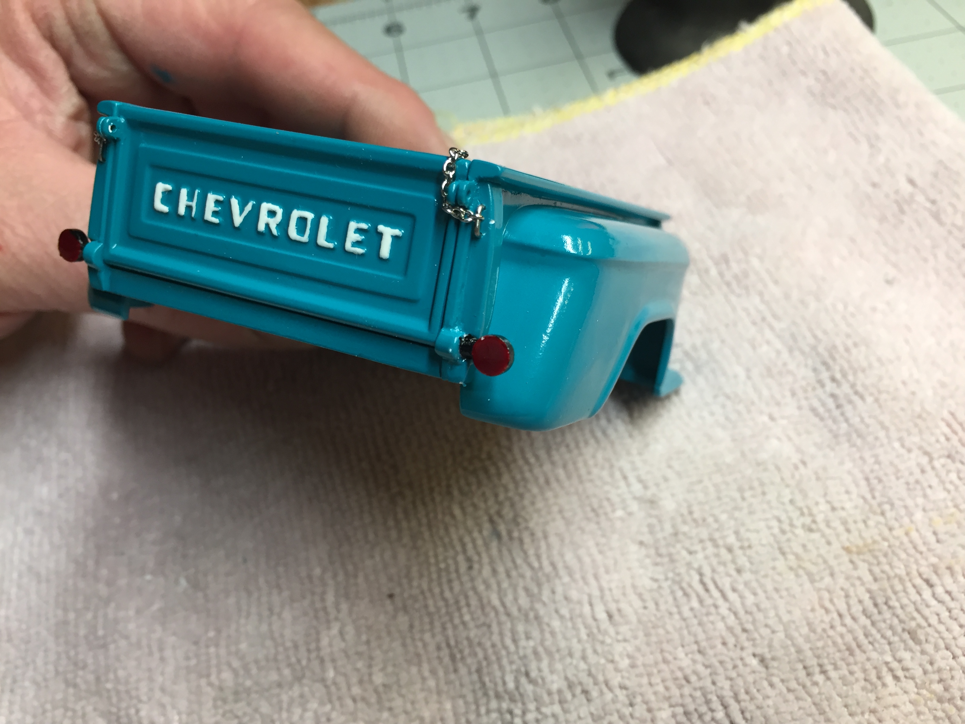

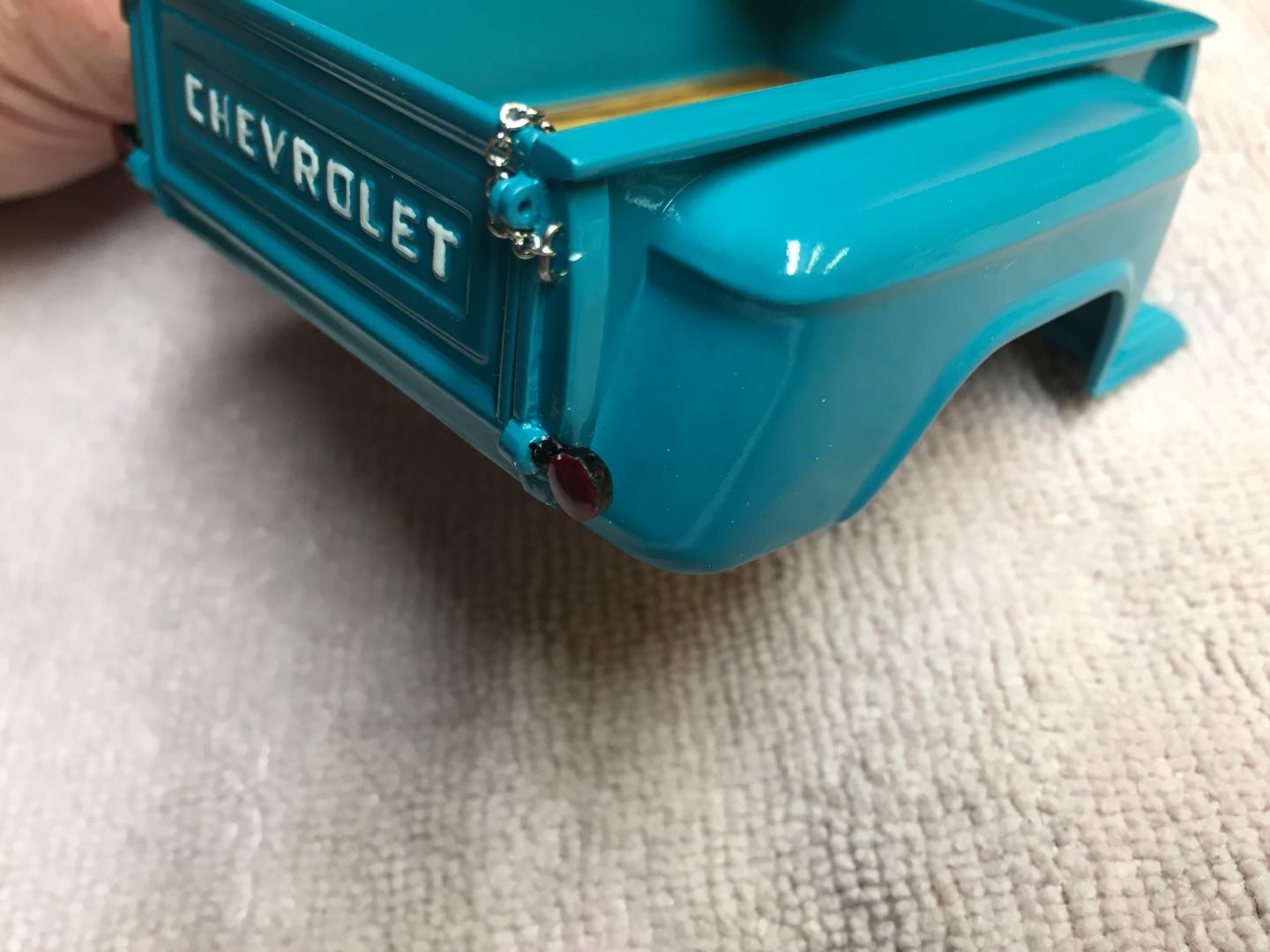

The kit tail light buckets were just a little tiny to cover the tailgate hinge pins so I wound up making new tail-light buckets out of styrene rod (couldn't find a chunk of sprue quite large enough). I ditched the kit lens since they were way too thick I thought. I counter sunk the new buckets slightly and dabbed in some Model Master stop light red metallic.

I'm getting close now. Still need to attach the delicate cab goodies, wipers, emblems, mirrors, headlights. Also the rear bumper and trailer hitch. Both of the rear bumper gussets snapped almost clean off, so I want to wait until the front bumper glue dries completely before attaching the rear. I am undecided on the hub caps. I would like the white if they were the cake-pan style, but white doesn't suit the domed ones very well?
Edit: I think this kit could benefit from an extra set of box mounts at the very back. There is a lot of frame flex when the model is handled after assembly.
Edited by NOBLNG
Add

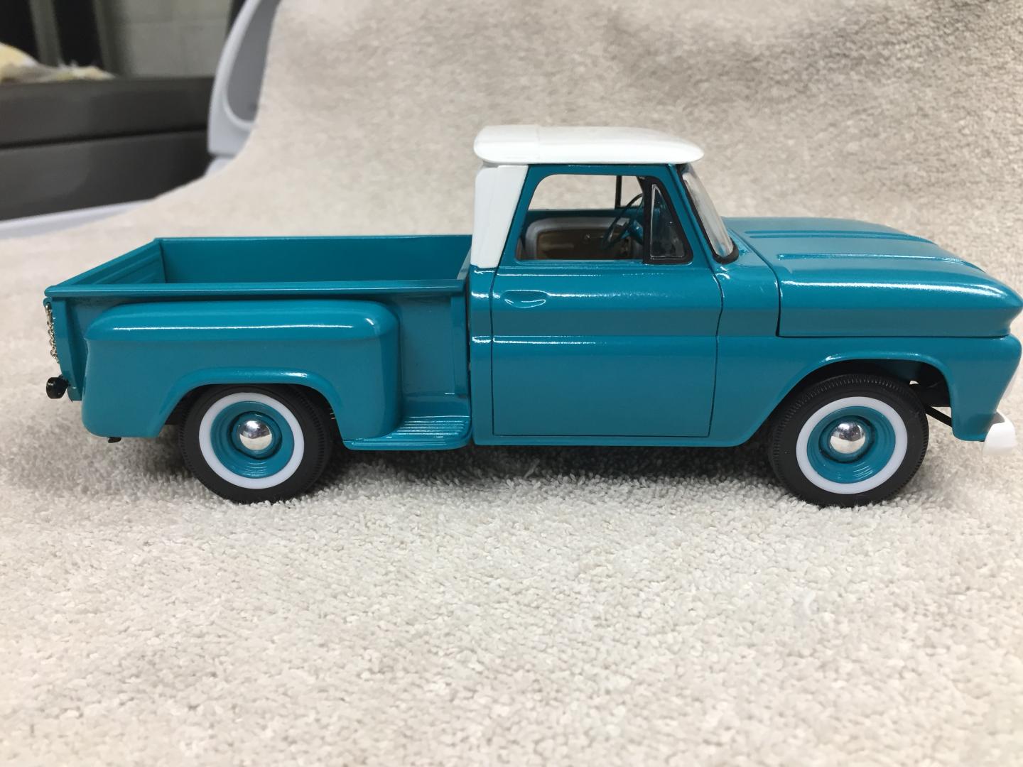

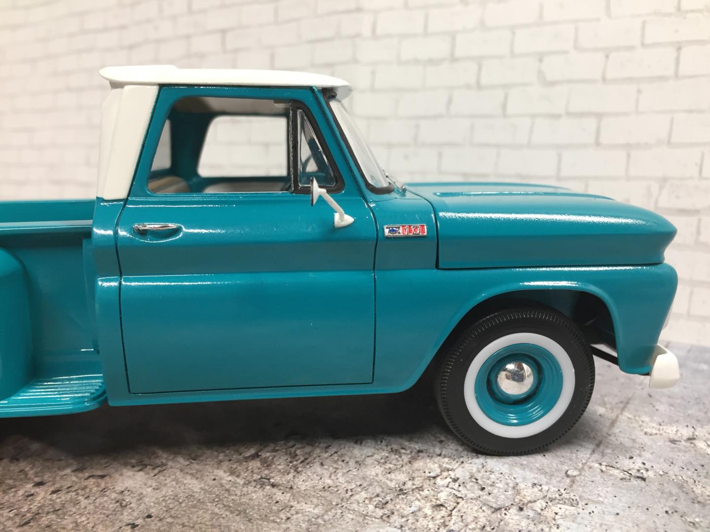

This one is pretty much done. I have not glued the hubcaps yet, as I want to try making a new set closer to factory. I sanded the side emblems down quite a bit since they were about 1-1/4" thick in scale.
This is sure turning out nice. The Hub Caps you are looking for may be in the new '66 Chevy Suburban kit.
