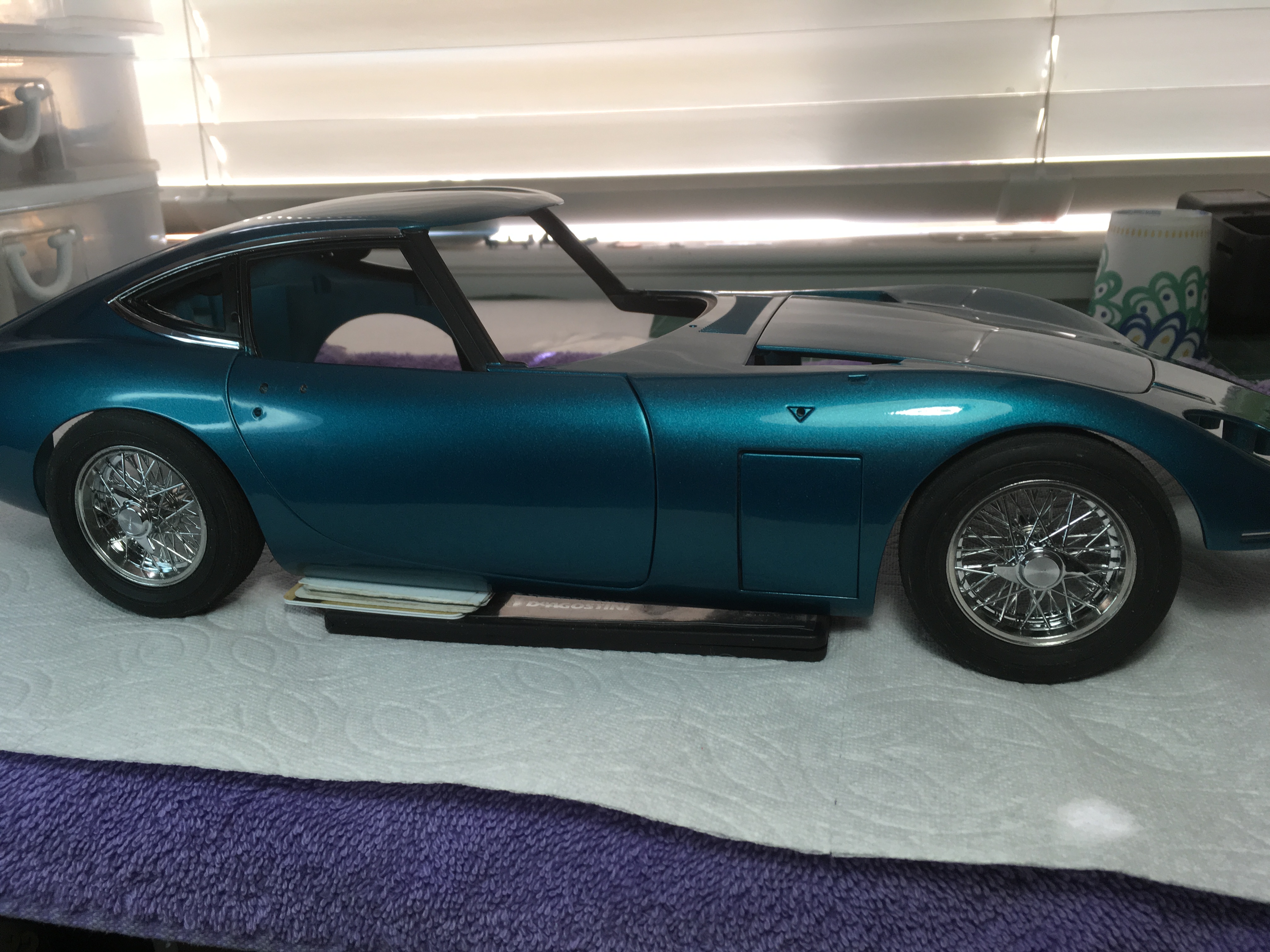

Brudda Posted April 24, 2018 Posted April 24, 2018 A 1/10 scale Toyota. 2000 GT. I will be changing the color. Going to be a fun build.

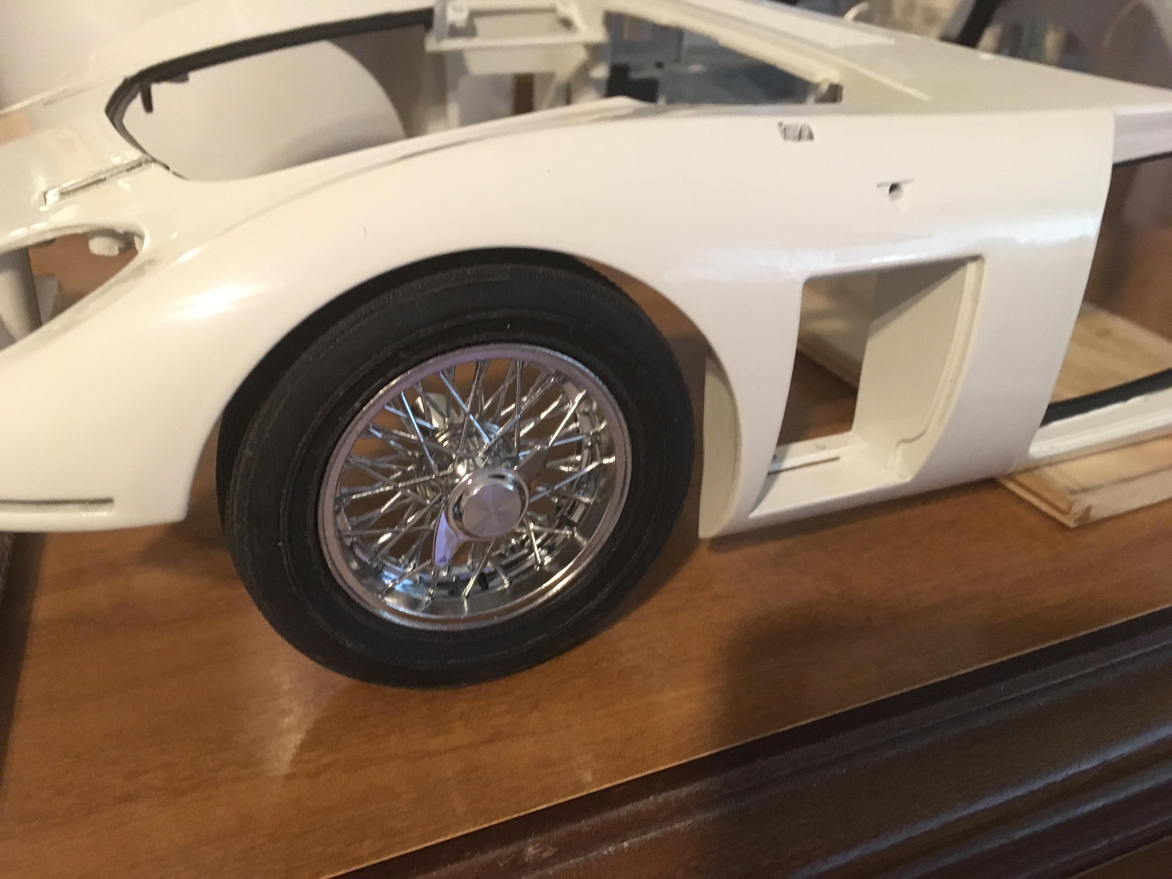

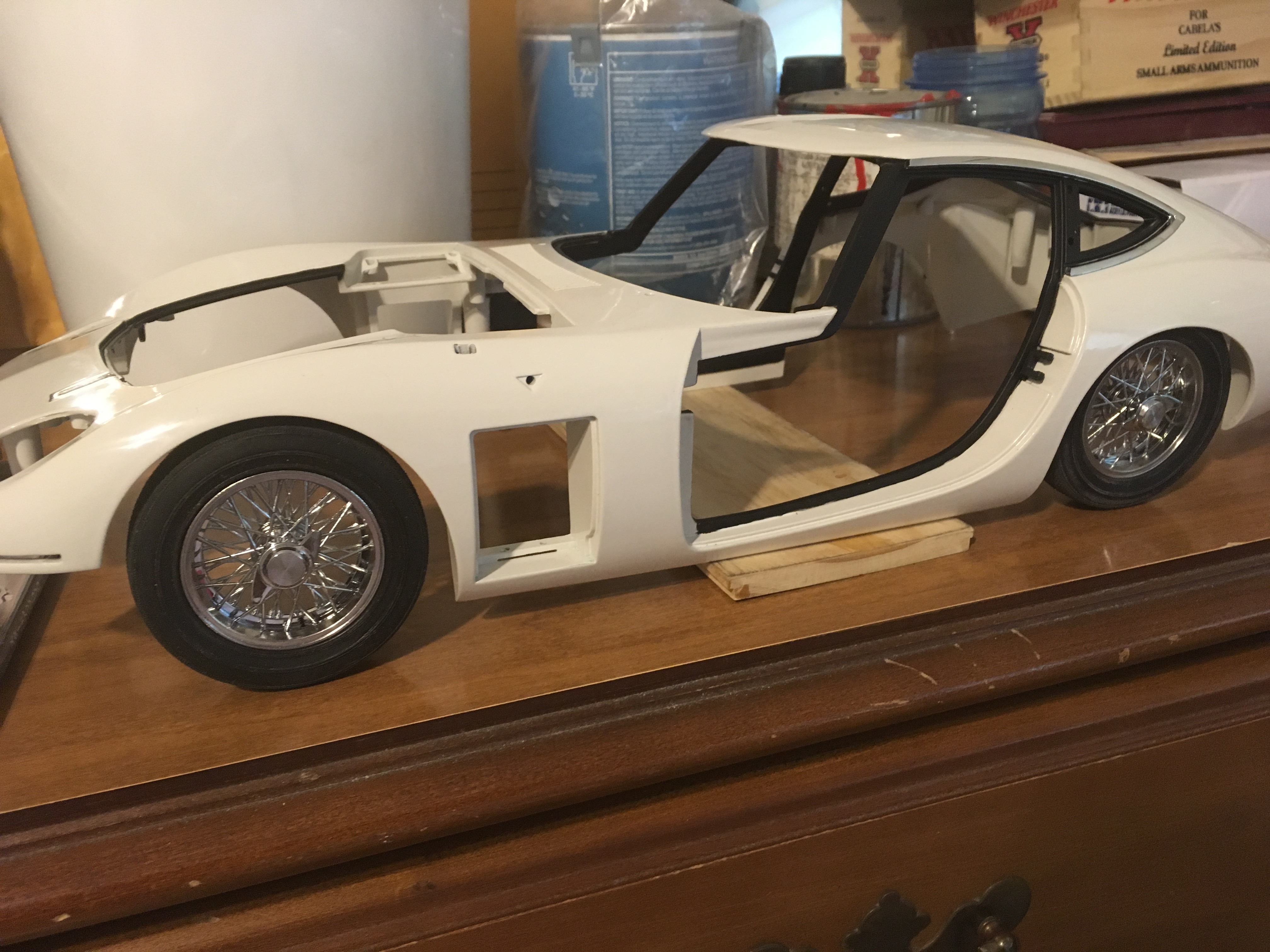

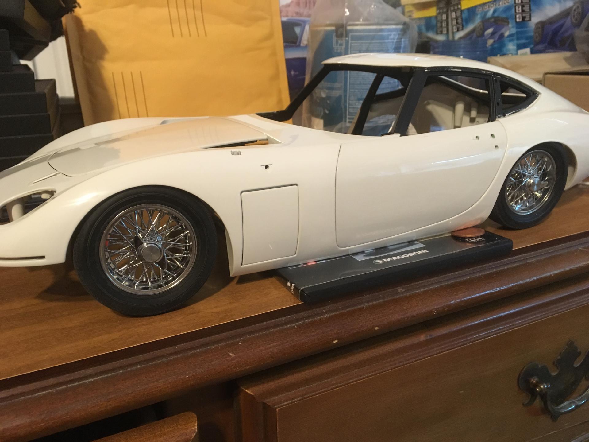

Brudda Posted April 30, 2018 Author Posted April 30, 2018 Fitting the parts. Taking off the chrome. Going to be a simple project. The wire wheels were a $200 option. Wanted them because the first 2000 GTs were wire wheels. Hope you like.

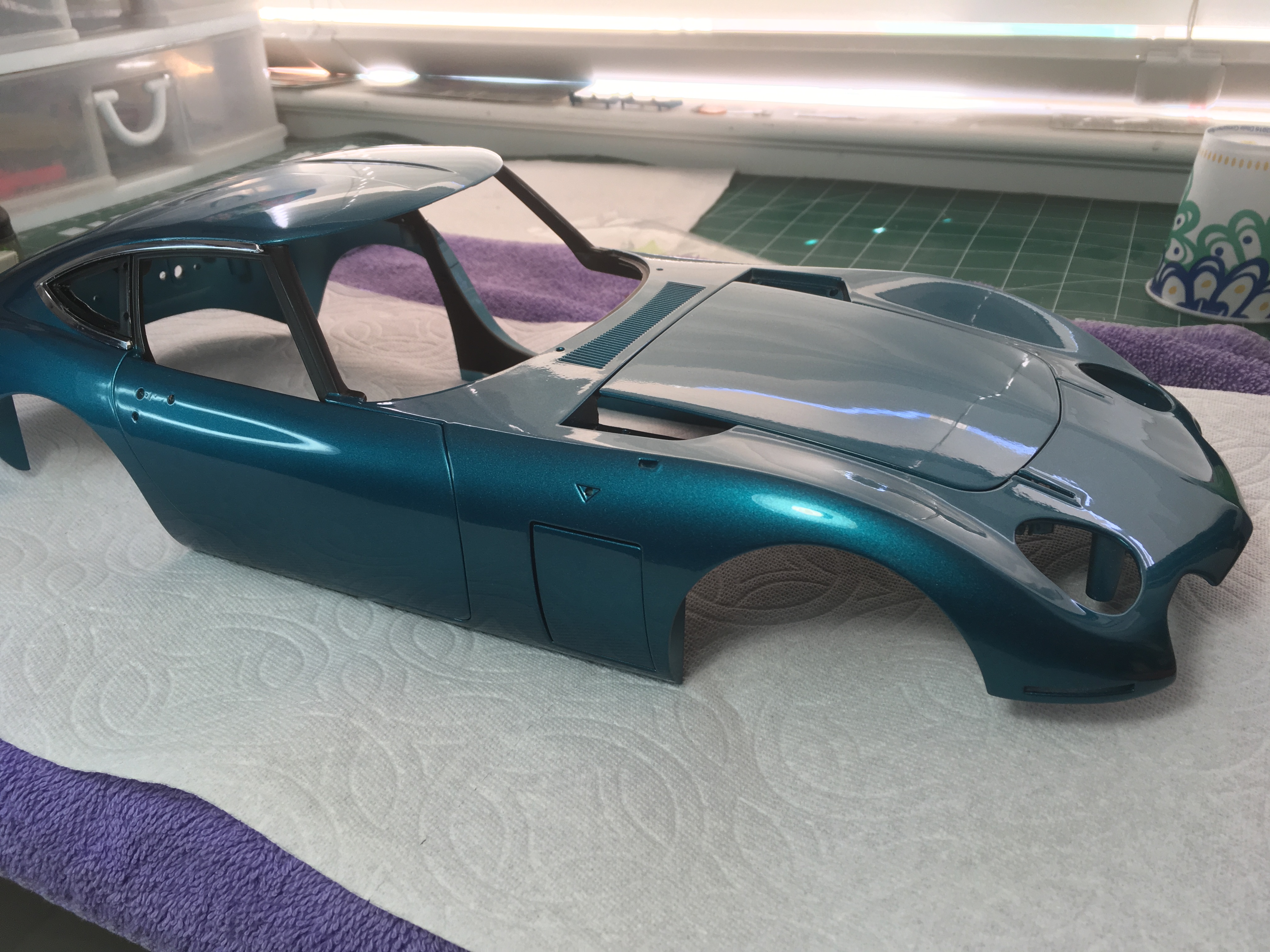

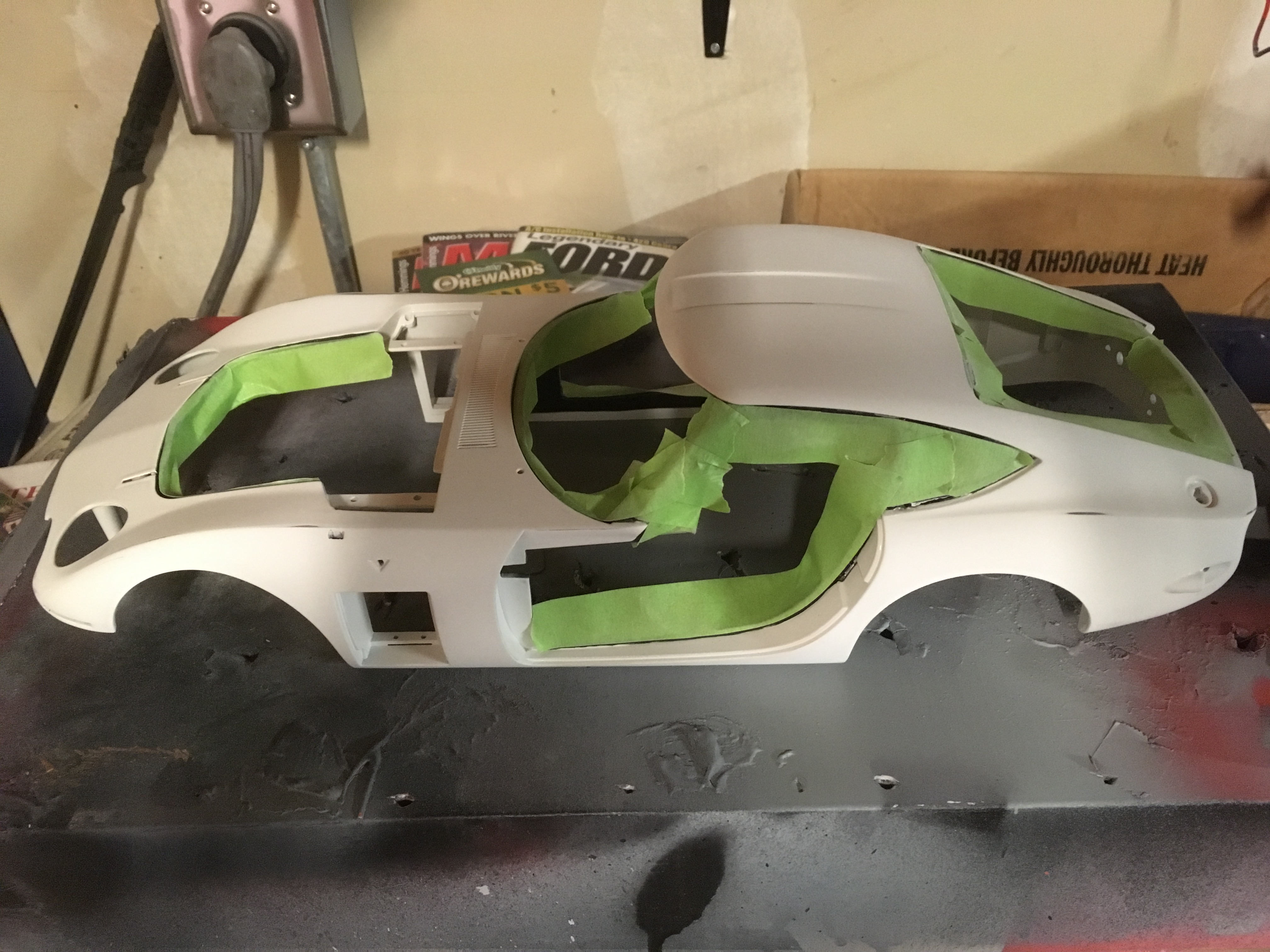

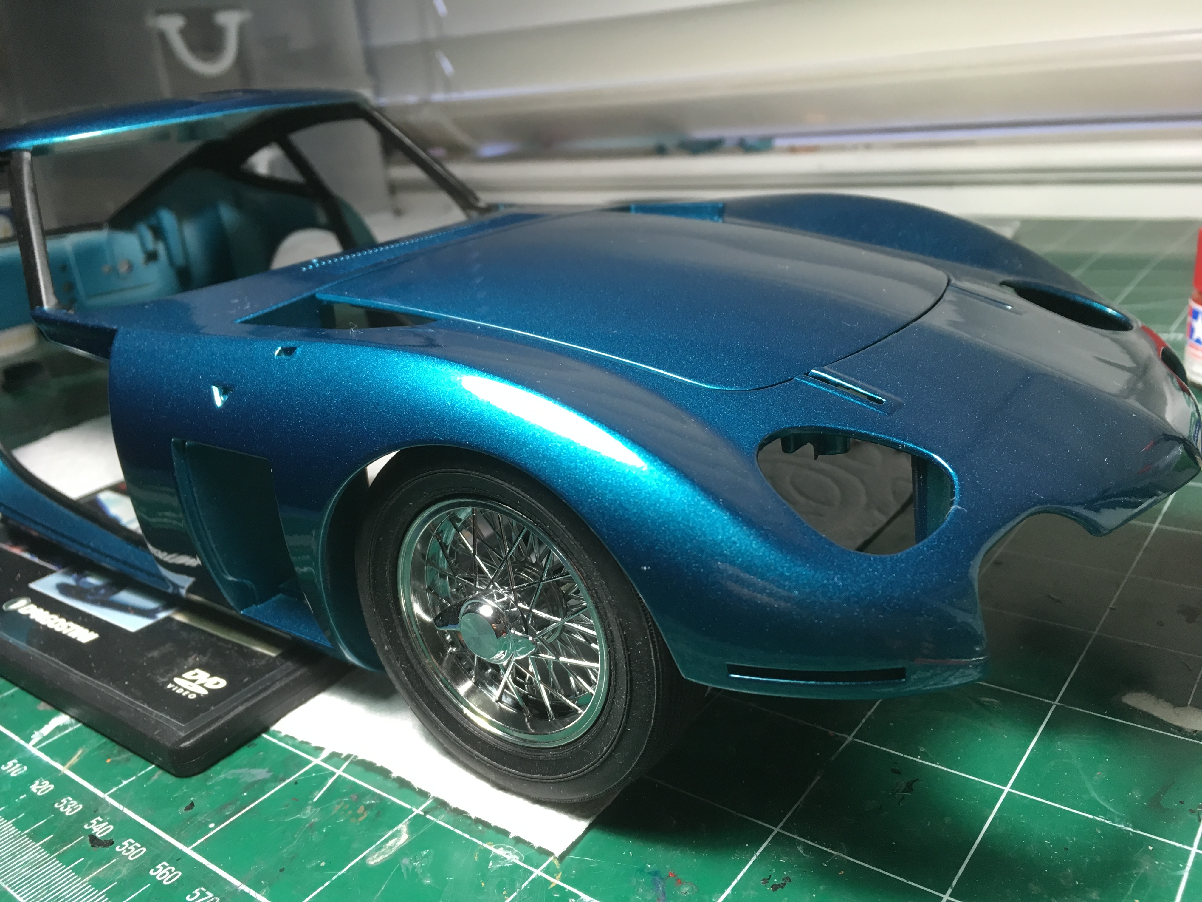

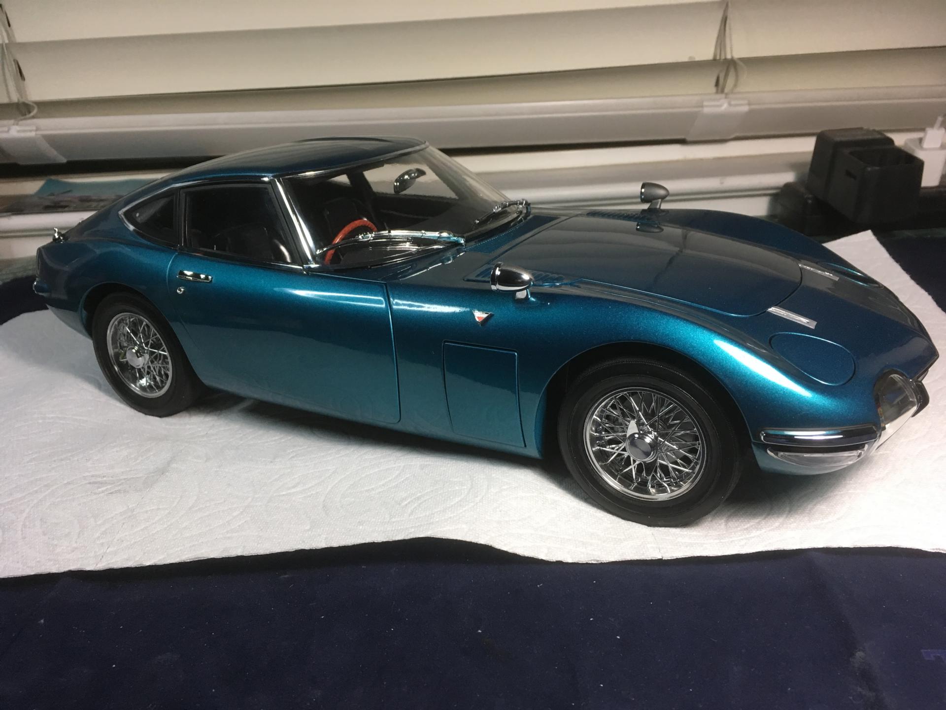

Brudda Posted June 14, 2018 Author Posted June 14, 2018 Sanding the body. Going to paint soon. Twilight turquoise

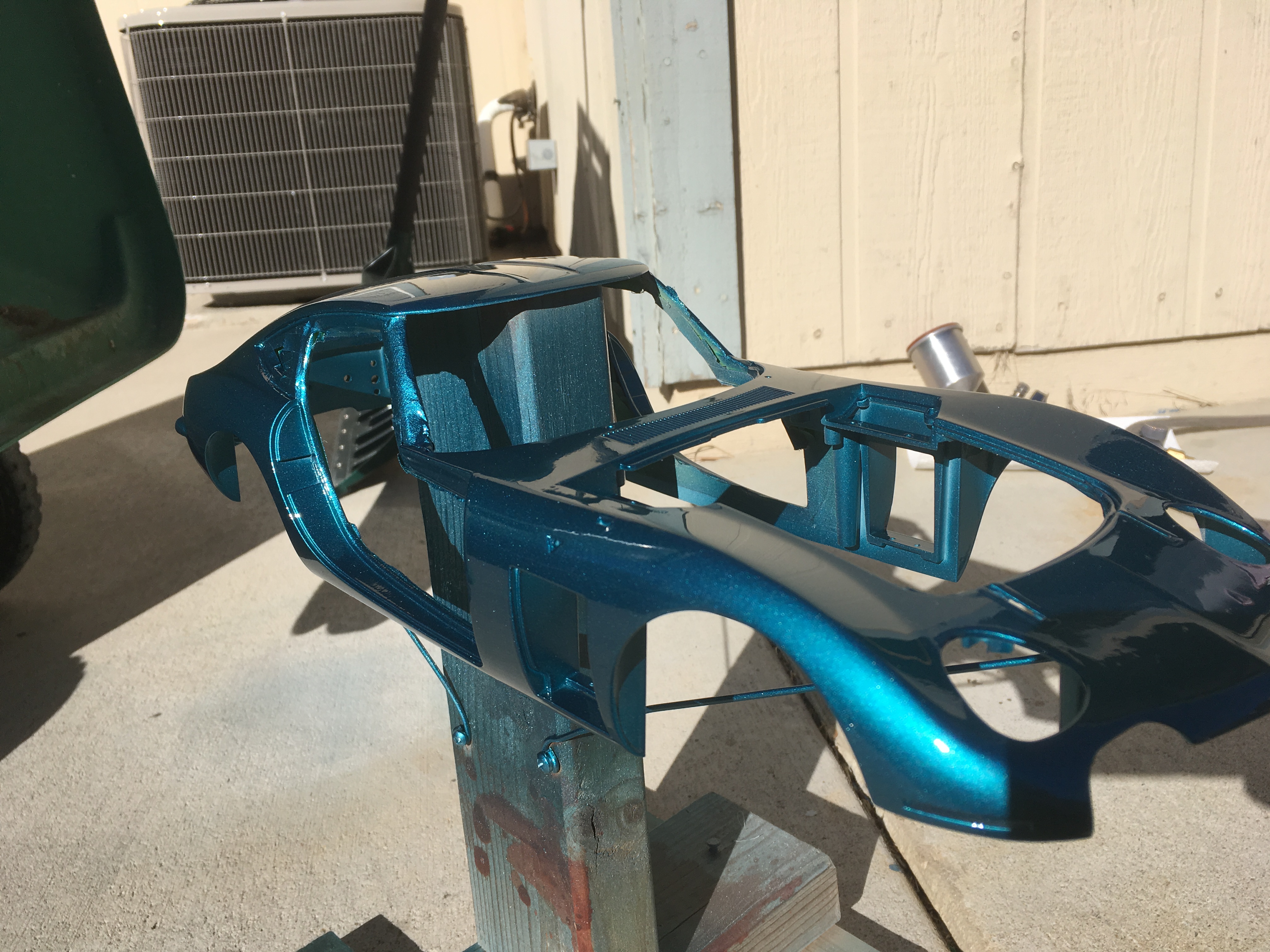

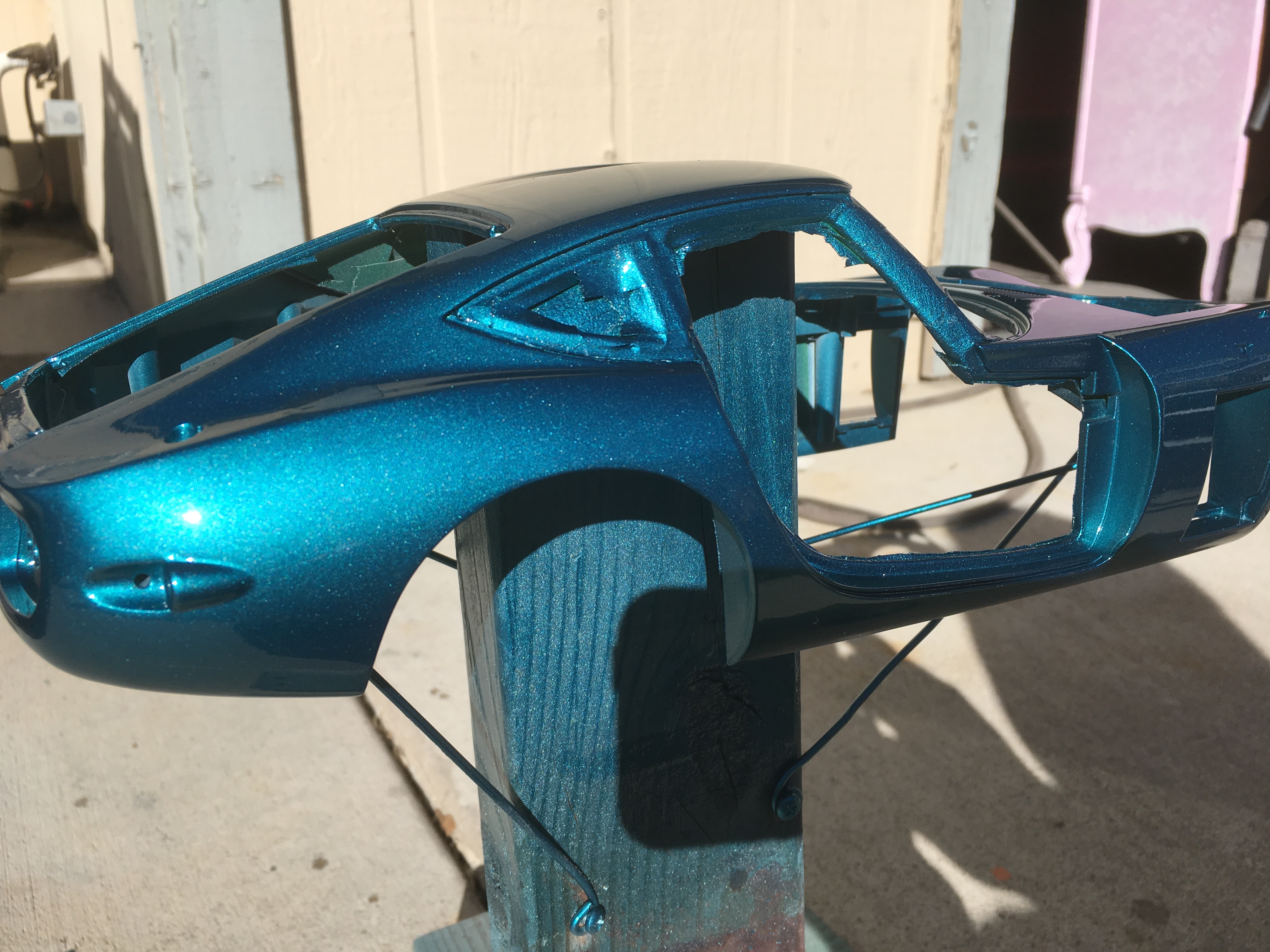

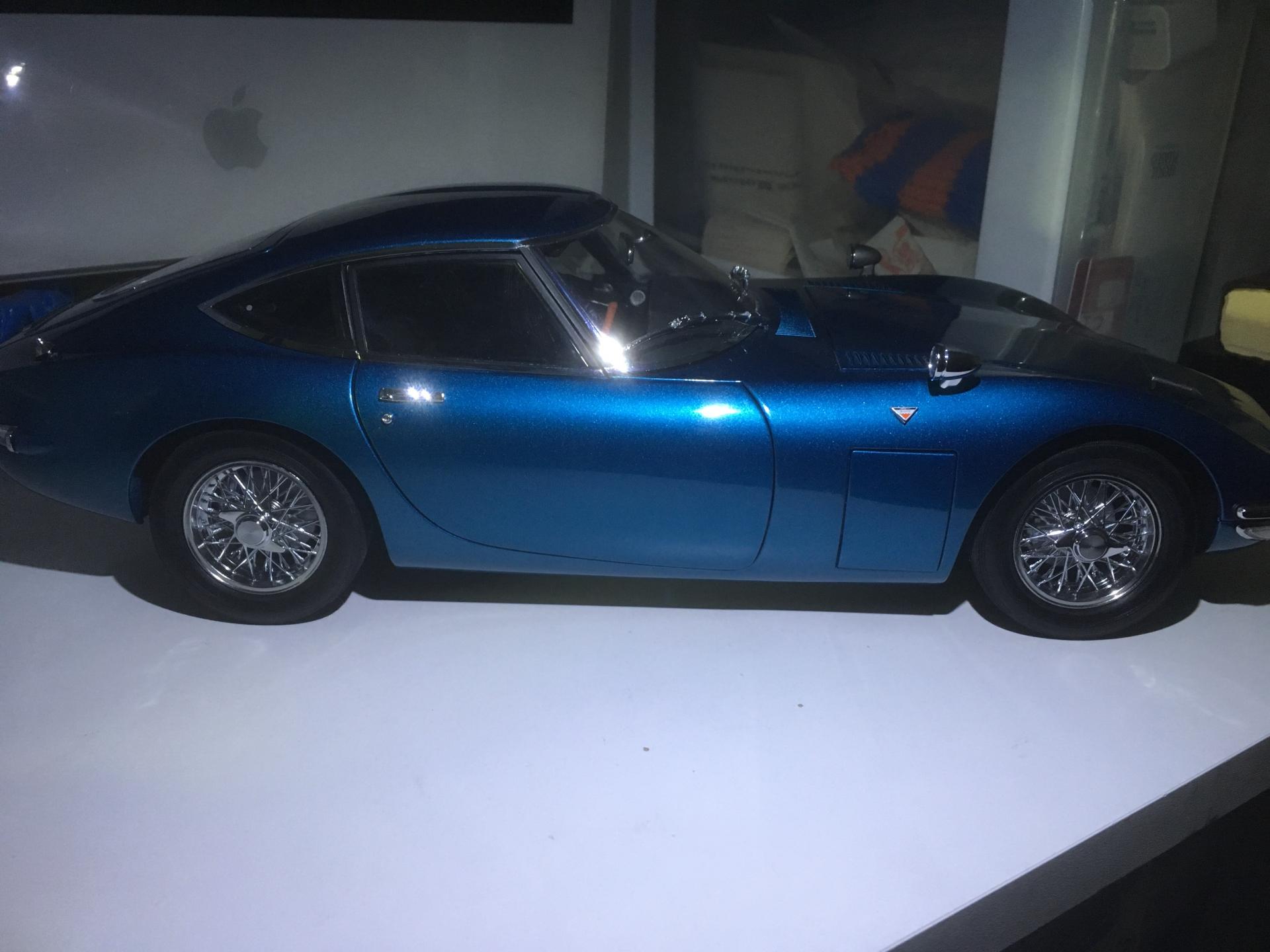

Brudda Posted June 23, 2018 Author Posted June 23, 2018 Toyota is painted. Going to be fun. Hope you like

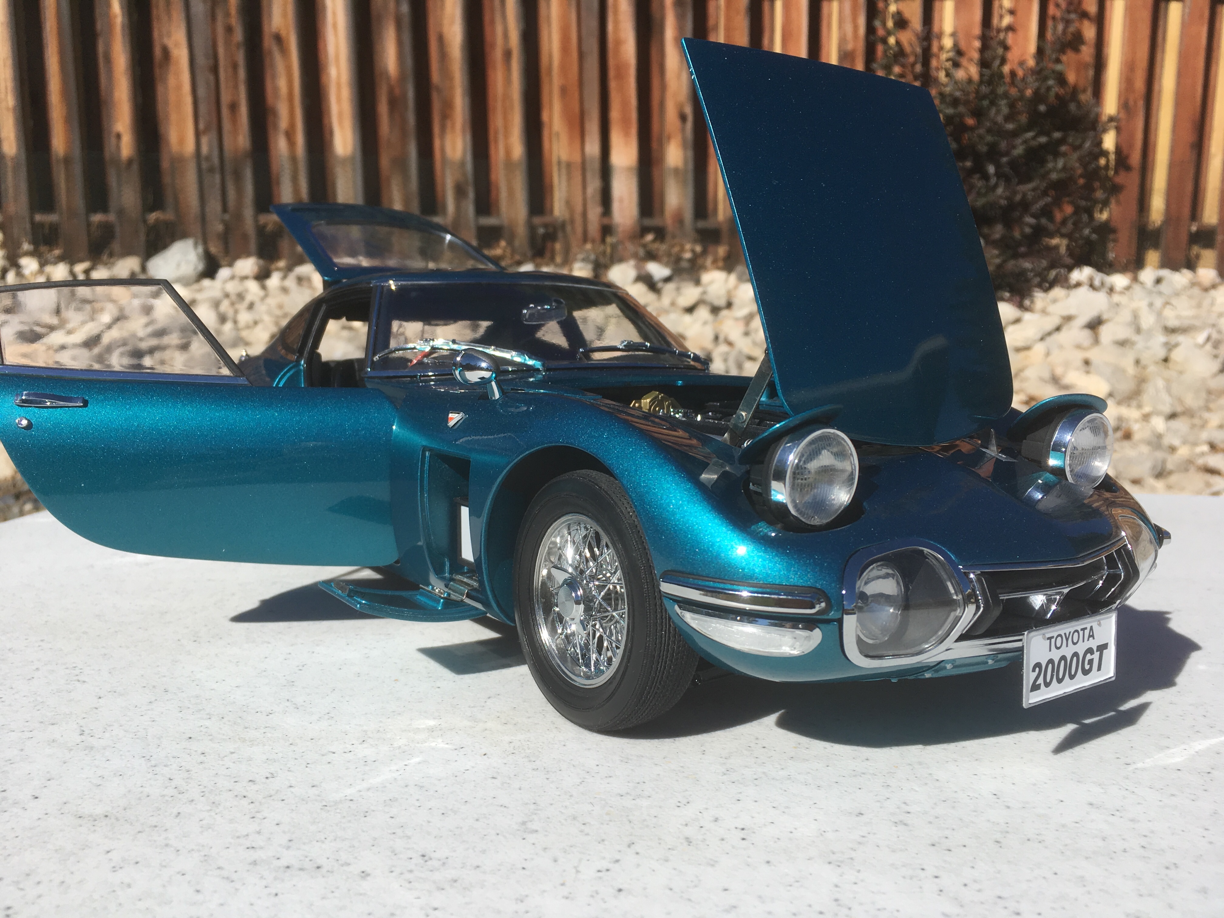

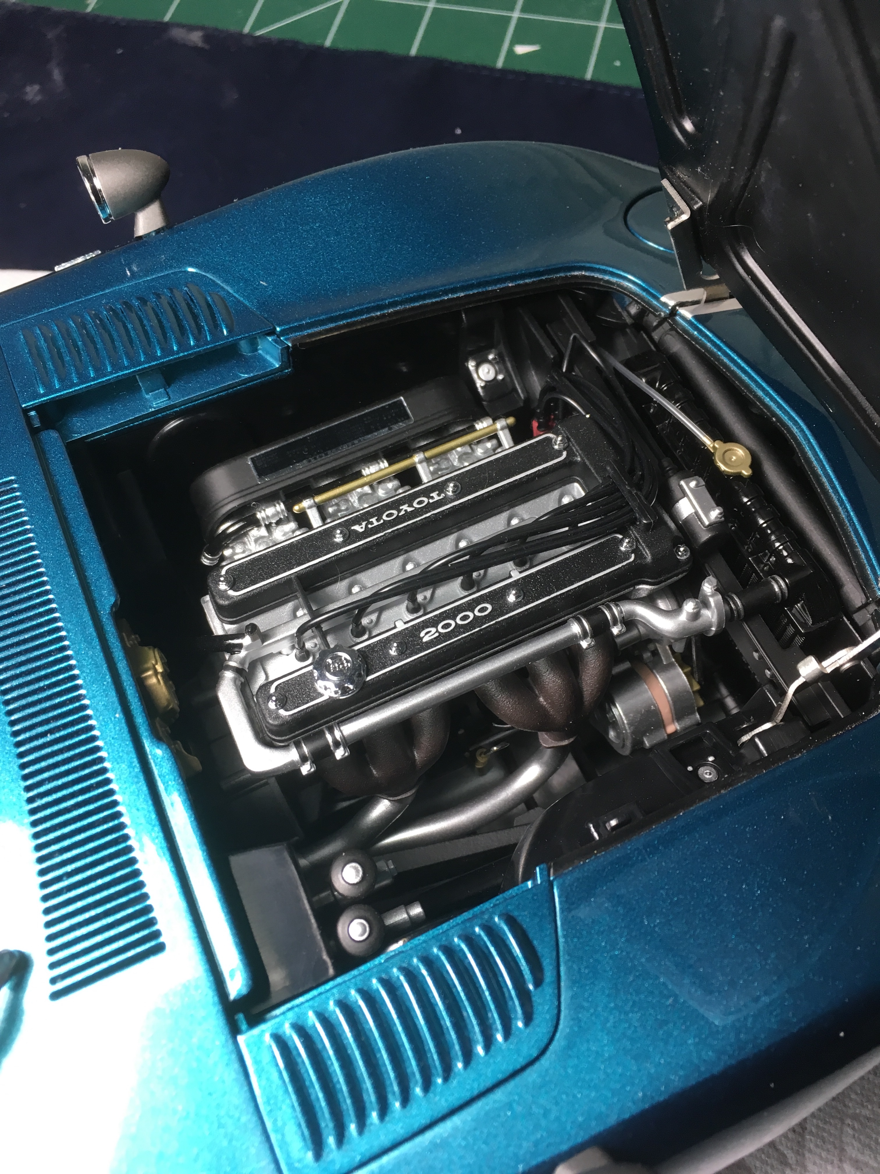

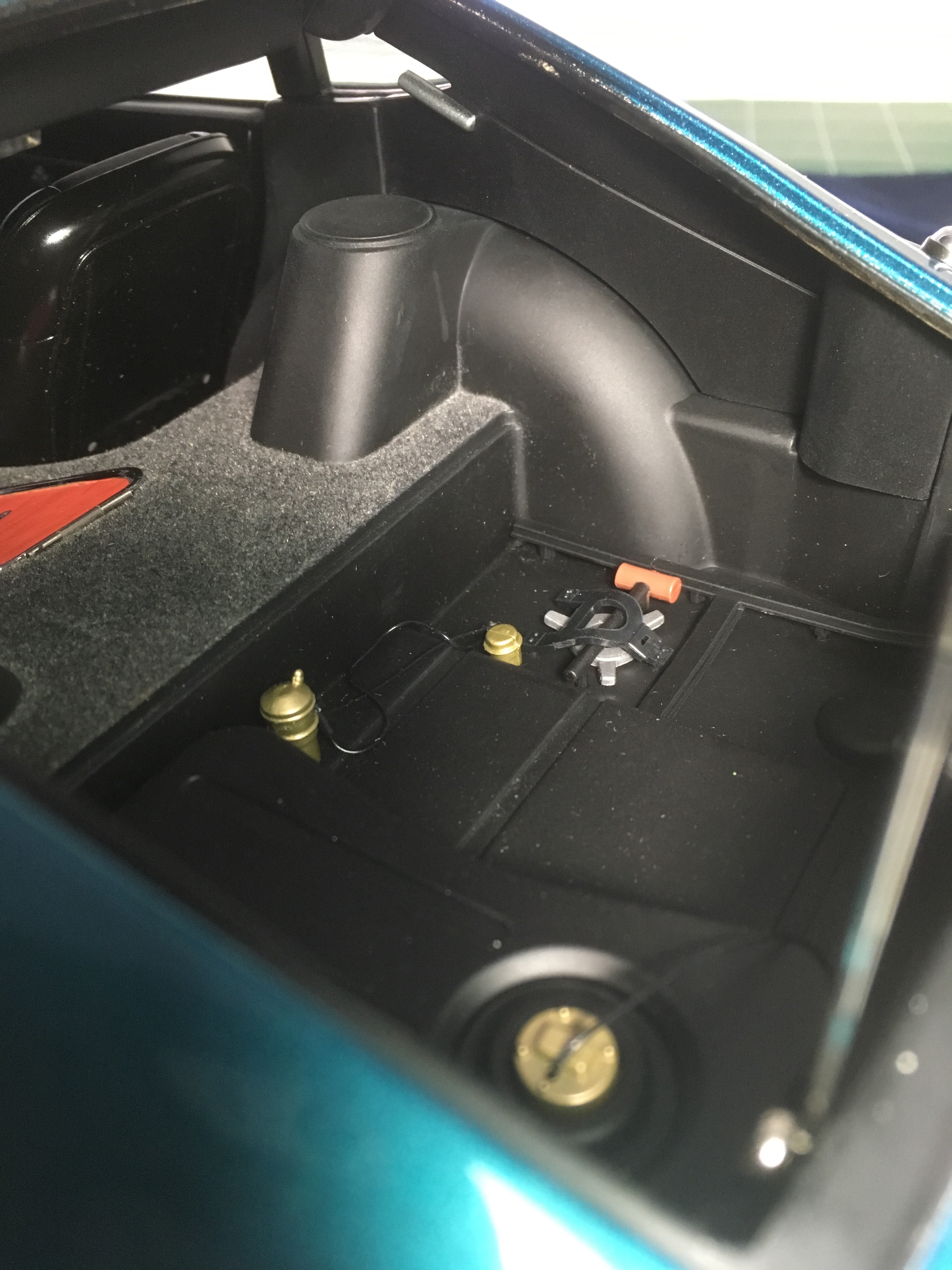

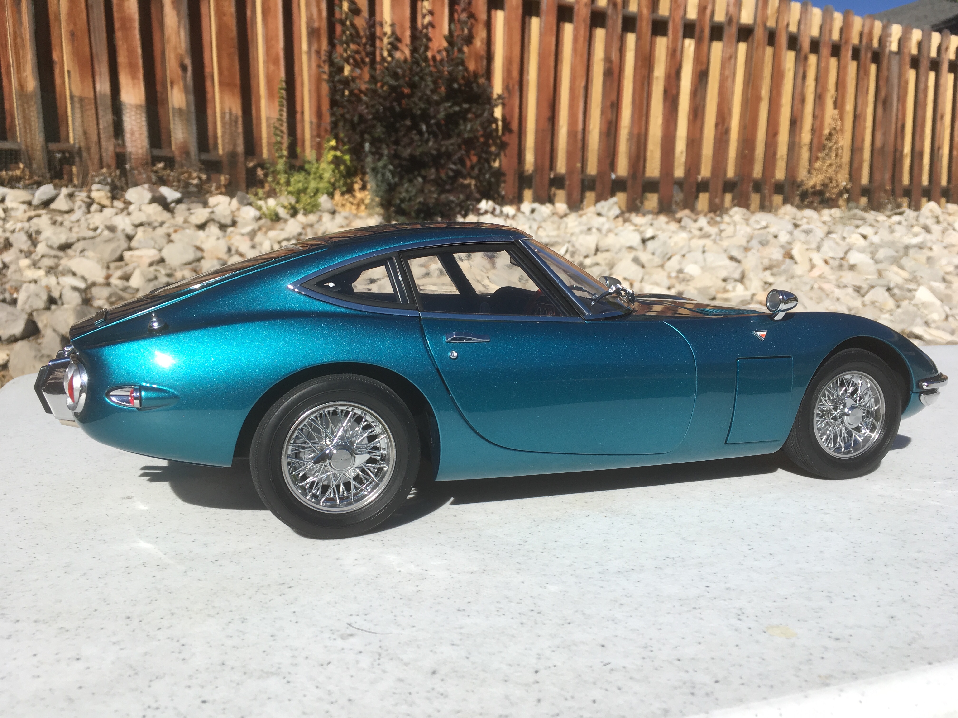

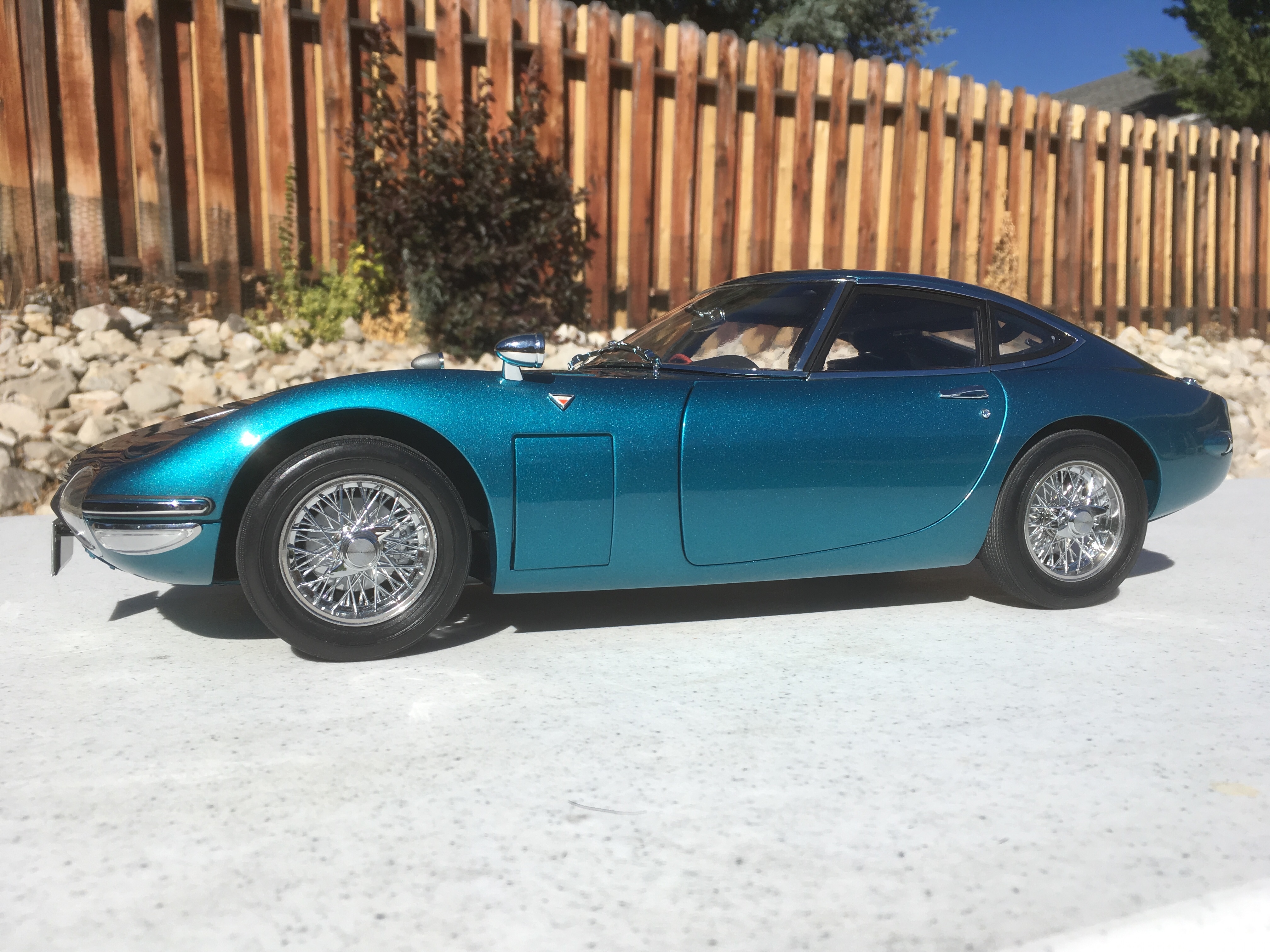

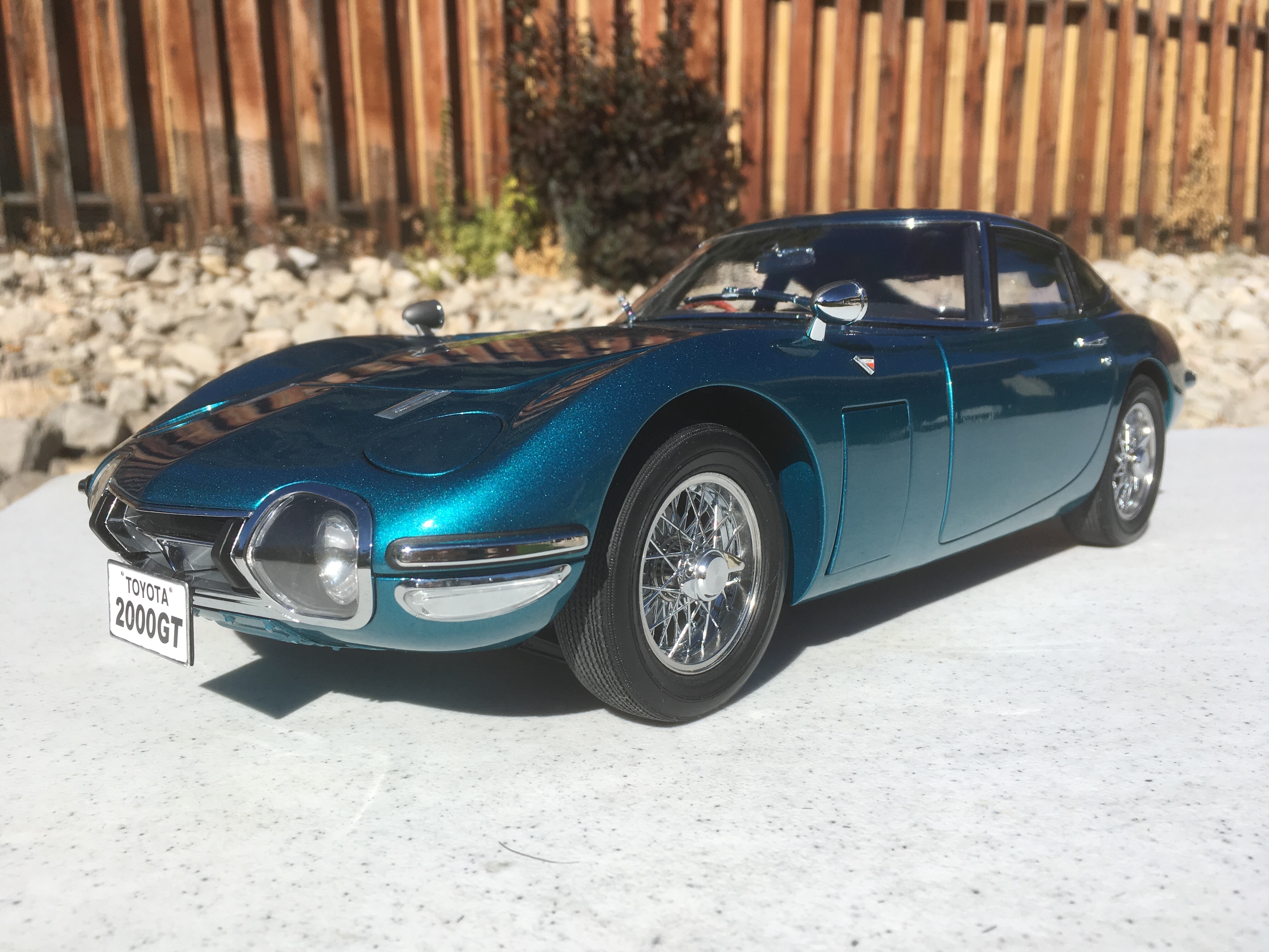

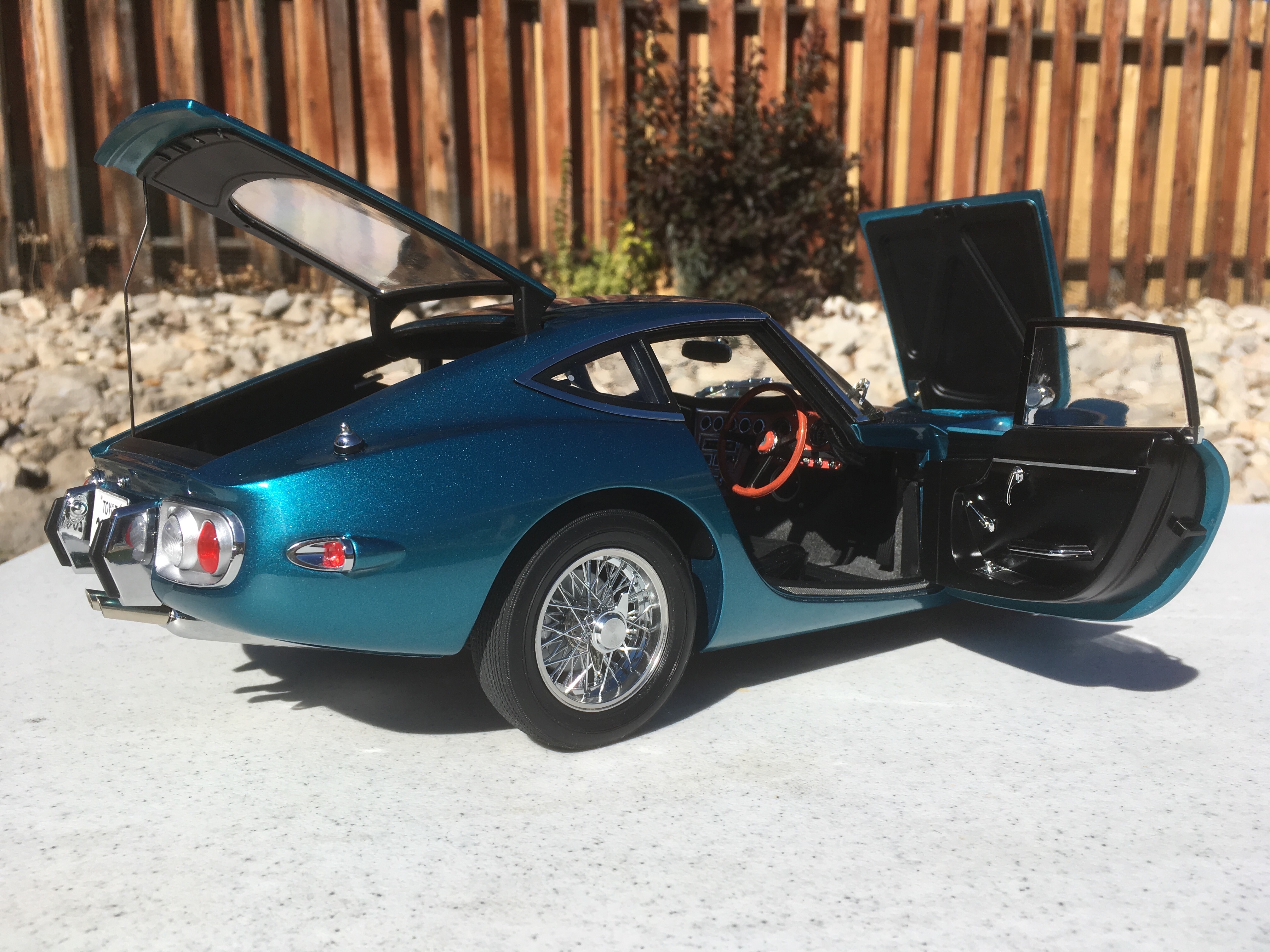

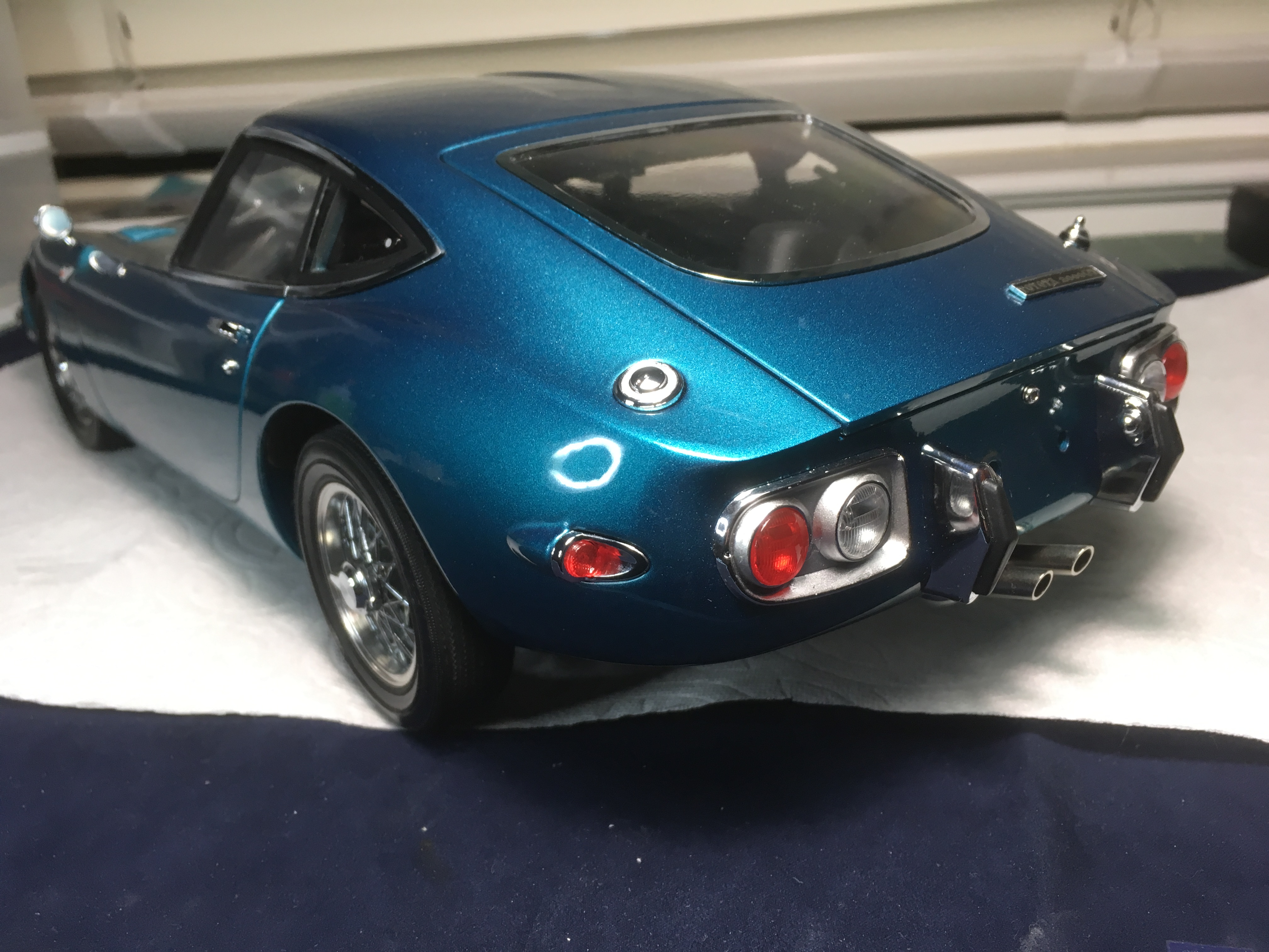

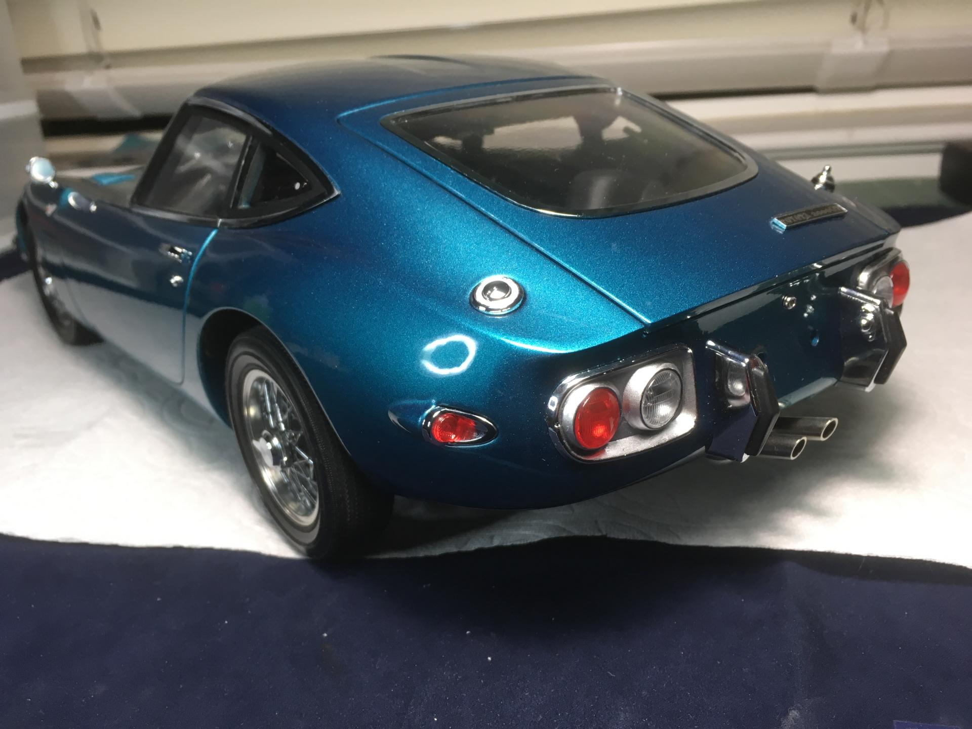

Brudda Posted July 2, 2018 Author Posted July 2, 2018 It’s finished! I’m sorry but I tried to load in prosses pics but it would not let me. It’s a DeAgostini 1/10 scale Toyota 2000 GT. Was white but changed the color to twilight turquoise. Hope you like

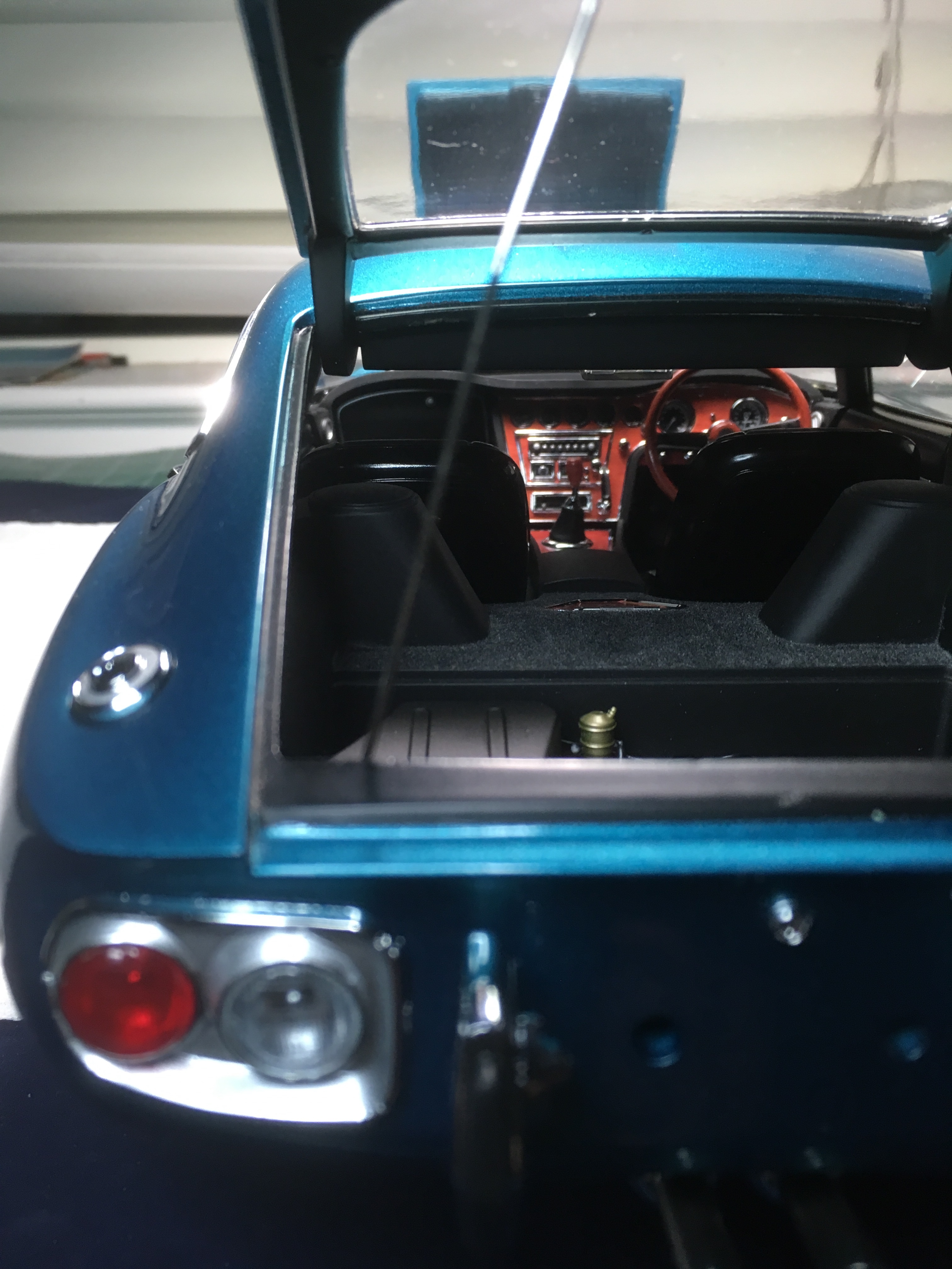

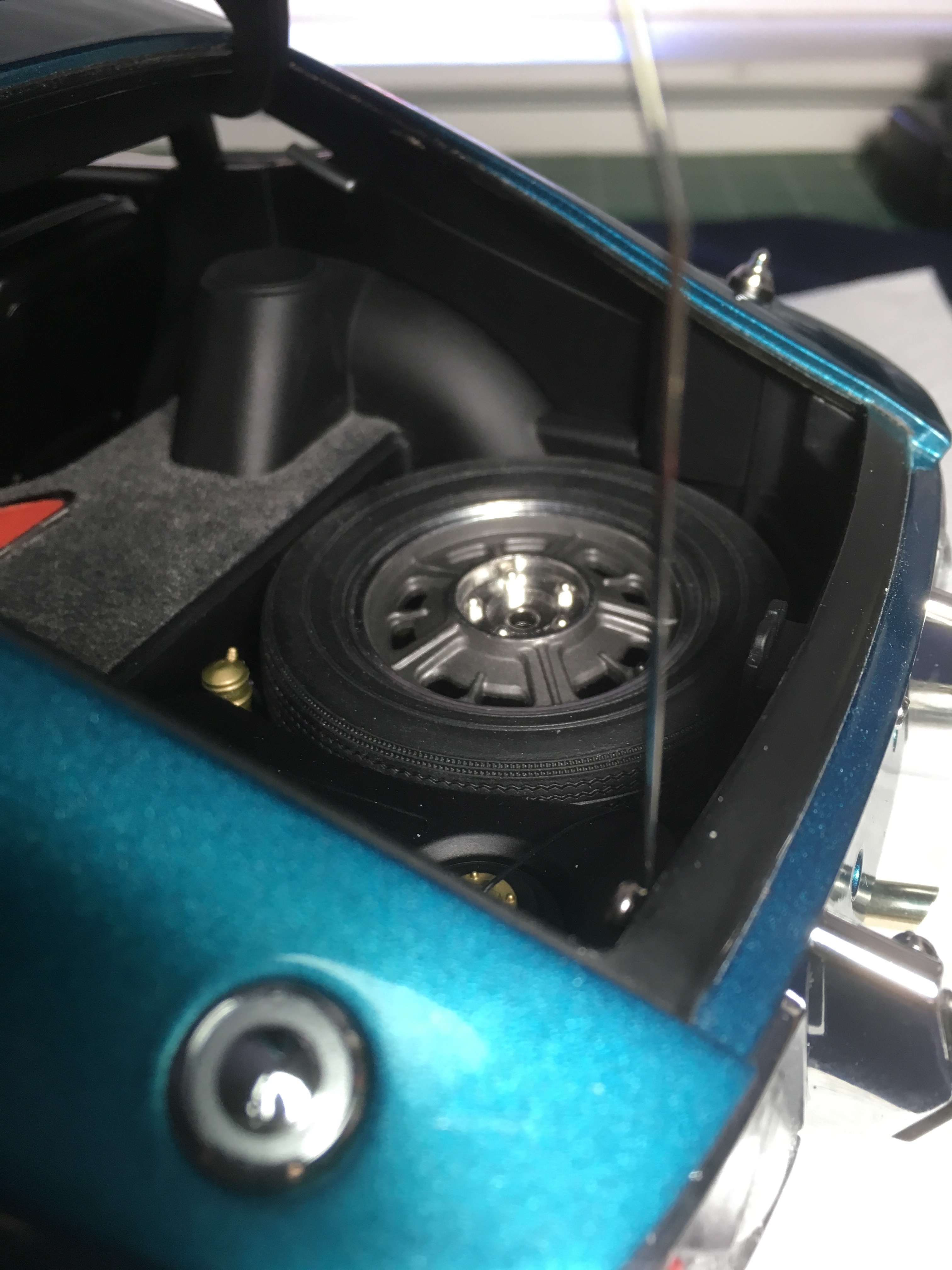

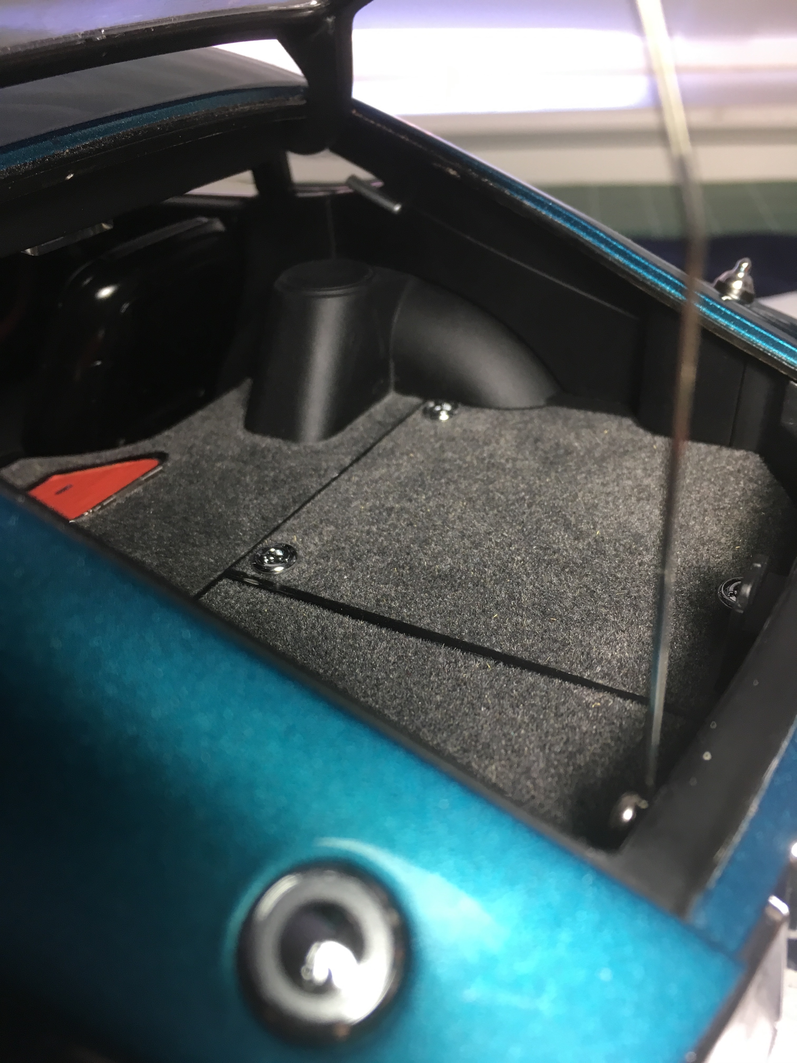

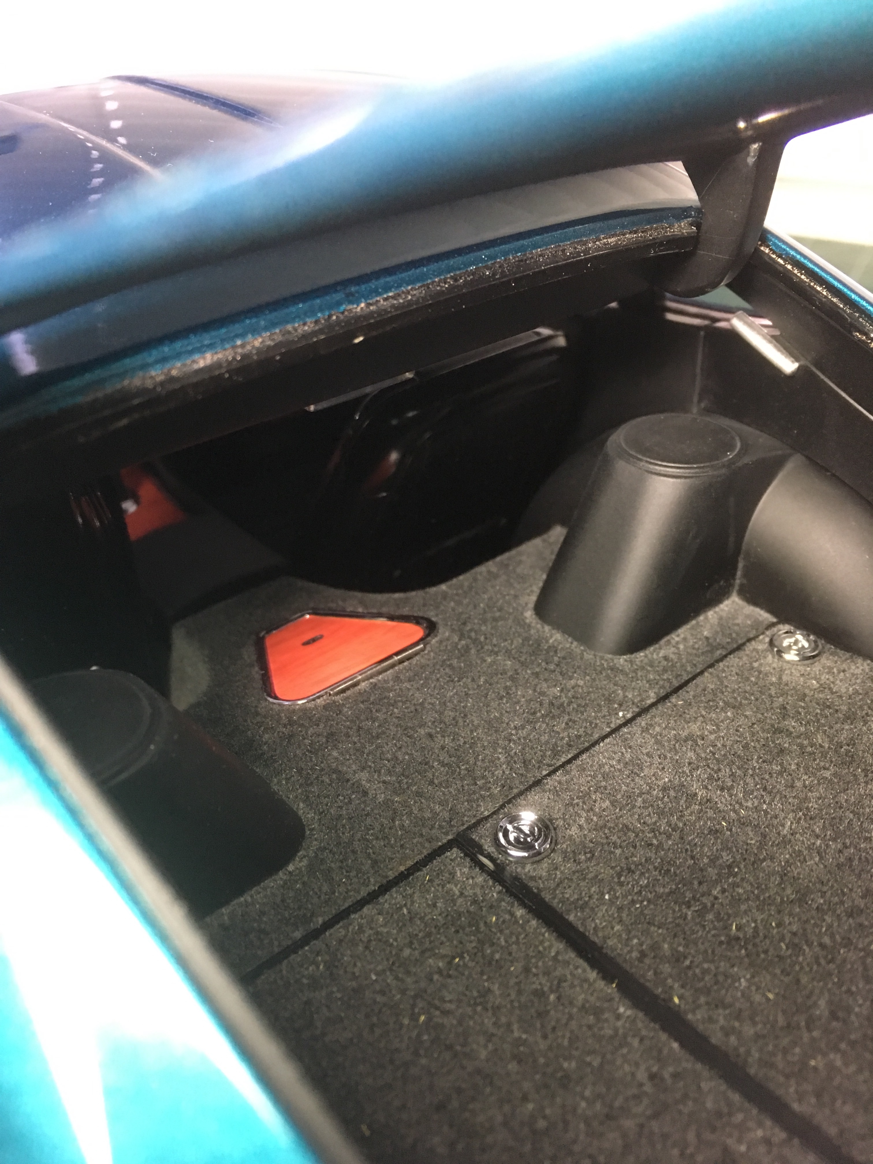

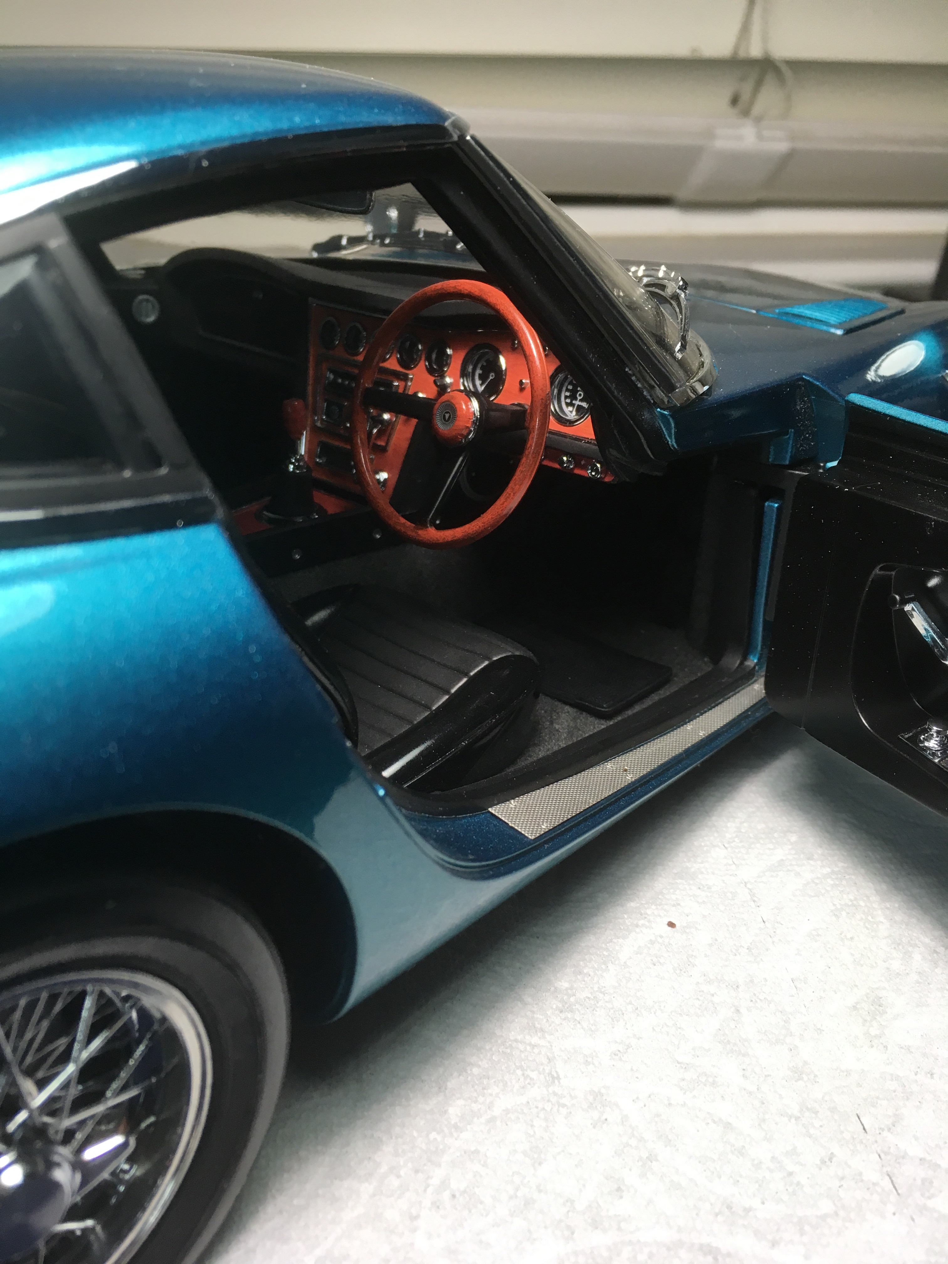

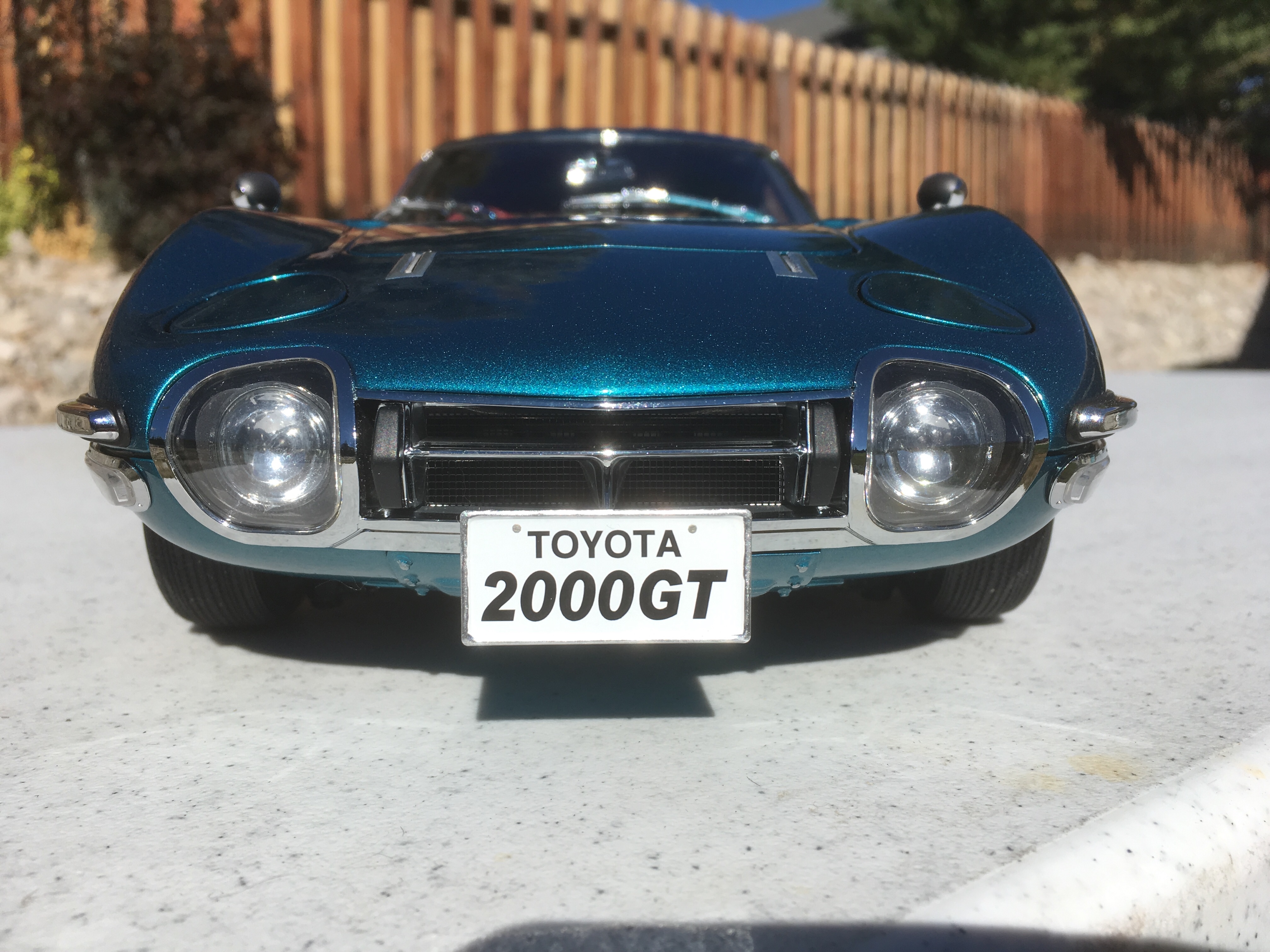

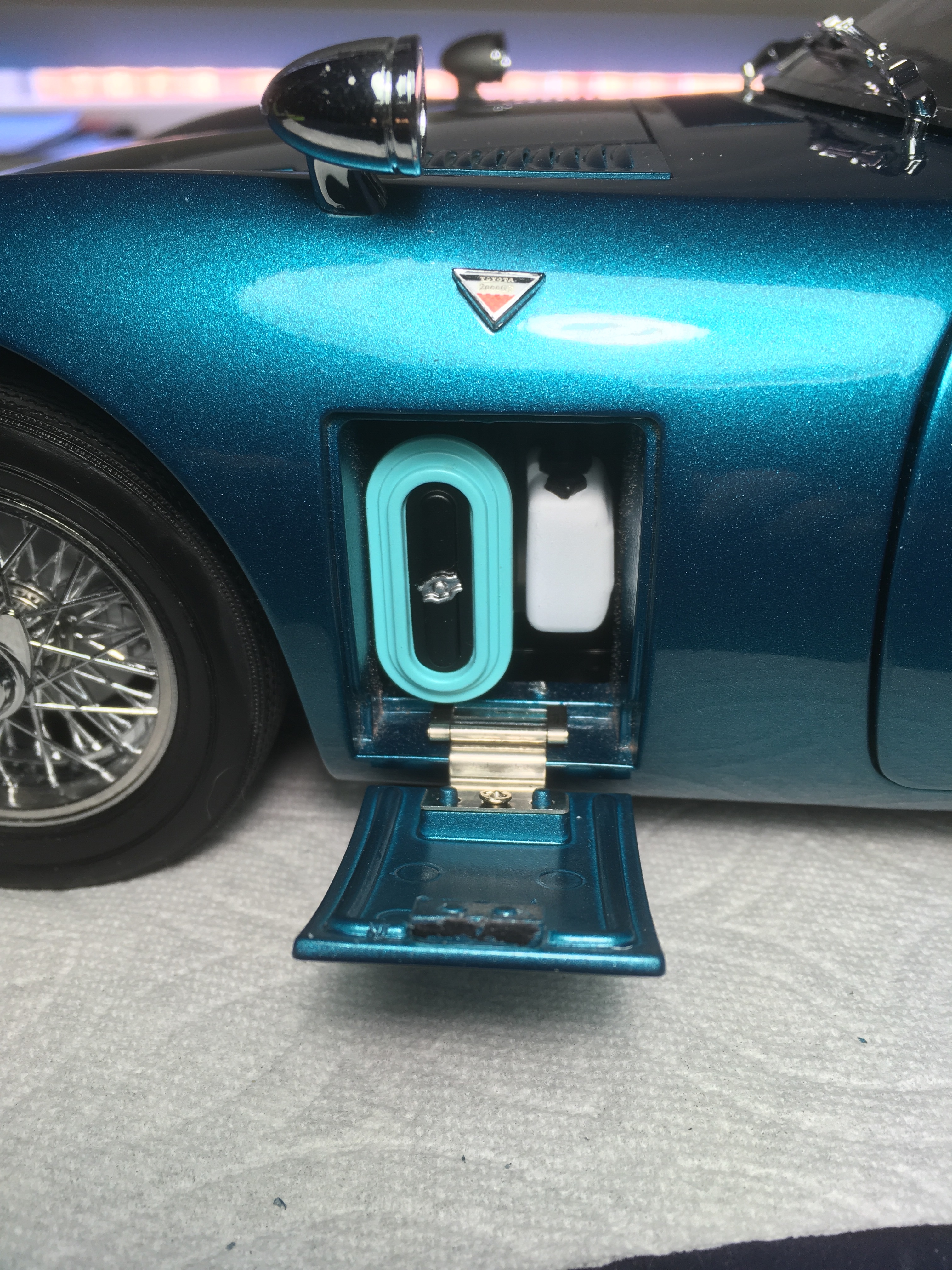

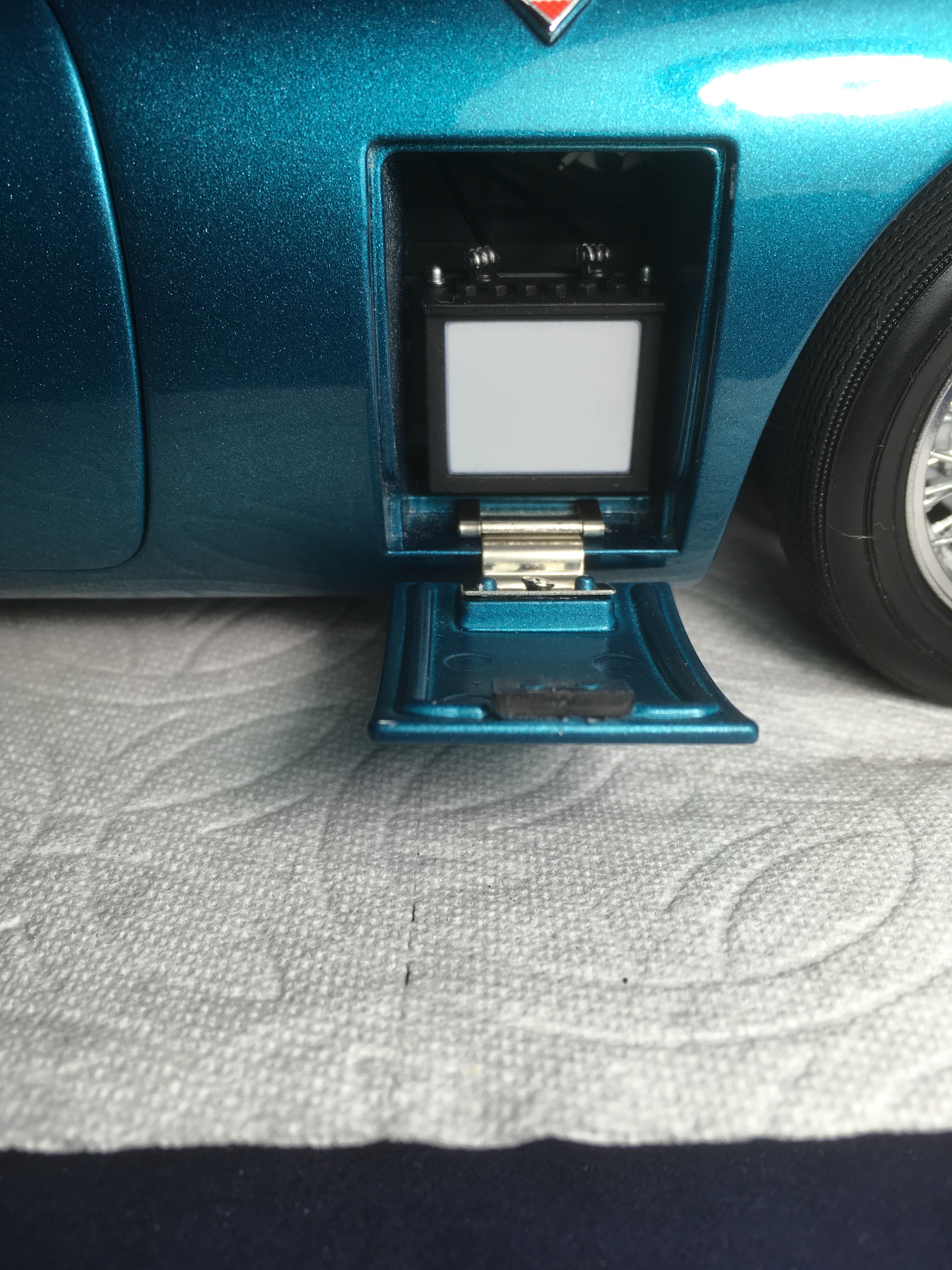

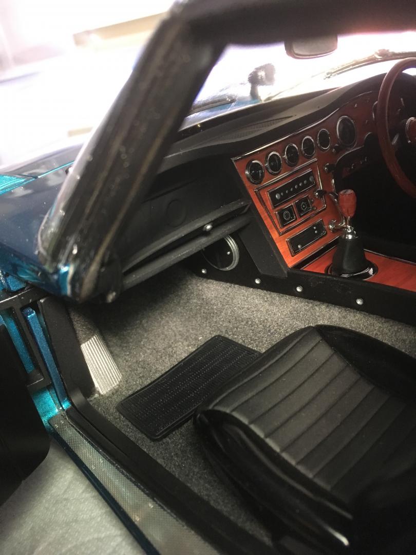

Brudda Posted July 3, 2018 Author Posted July 3, 2018 More pics!!! My daughter figured it out. Hope you like. 1

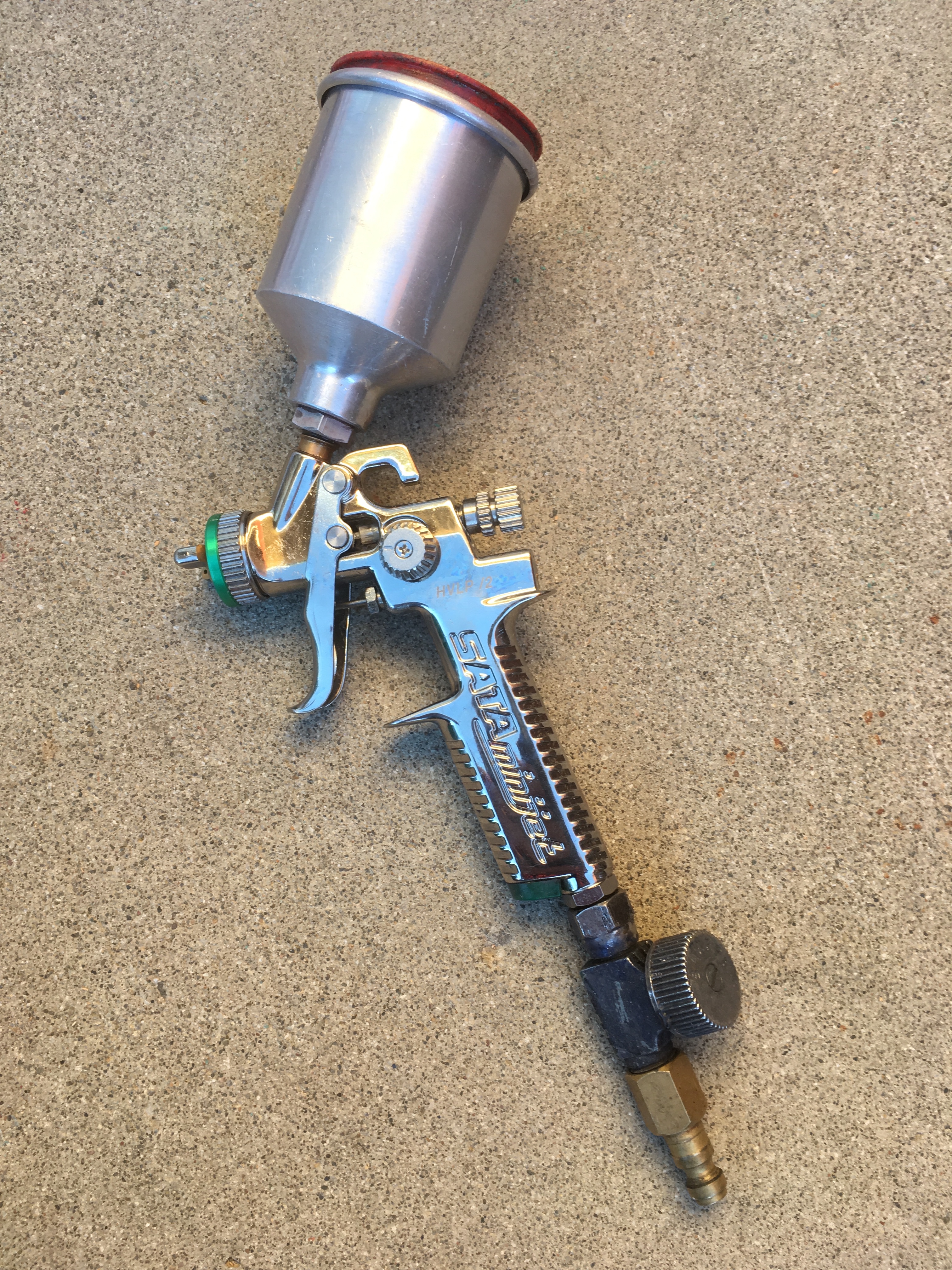

Rat Roaster Posted July 3, 2018 Posted July 3, 2018 The new paint color is 100 times more interesting than white. Someone told me once that people who choose white for their cars/trucks are indecisive so they go with the most generic color. So tell us about the paint, please. Looks like base coat/clear coat, yes? Didja shoot it in a real spray booth? You sanded the color coat before the last application of color? It came out real nice.
Brudda Posted July 3, 2018 Author Posted July 3, 2018 Thank you for the great comments. The color is twilight turquoise. It is a factory Toyota color. Automotive water based paint. With sherwin Williams urethane clear. HPC15 clear. Mix it 4:1:1. 4 parts clear, one part harder, one part reducer. Shoot it thru a sata mini jet spray gun. .8 tip hope this helps.
Brudda Posted July 3, 2018 Author Posted July 3, 2018 Also no spray booth. Very early in the morning at 6am. On the side of the house. I hang the parts in a shed to dry. The paint drys to the touch in 3 minute so dust does not settle in it. If a little dust gets in the paint I sand the spot with 2000 sand paper then rub it out with 3m rubbing compound. Polish and then wax it. With this paint you can do this in 2 hours. It’s automotive so it has to be fast. Hope this helps.

Brudda Posted August 27, 2018 Author Posted August 27, 2018 Thank you NYLIBUD. The model is very well engineered. The parts are individually wrapped. The chrome is the best I have ever seen. Parts are so good that you do not need glue on many of the parts. Windshield was the coolest install , it snaps in place, no glue. They try to take out the mistakes with great engineering. The instructions are the best ever. Like a shake and bake. Until you get to the suspension and have to tap the holes for the screws. Only modification I made wa to enlarge the door hindge holes to float the door for alignment. Car comes with a very nice paint in solar white but I could not leave it alone. I painted it twilight turquoise. Added a little blue pearl for a richer look. The model is very expensive. I know the deagostini rep and received the model for free. When it was done I promised a interview and pictures of the build for advertisement. I might be getting the 1/8 scale of the Porsche Carrera. It is painted white but I will change the color. They said at a discount but at have price it is still $1200. The Toyota is 1/10 scale and runs approx $1100. They are expensive but I lucked out with Mark and he was very generous. A great guy. Best model I have ever built. It is very exciting because it’s a rare subject. Have it under lights every night and stare at it before I go to bed.
