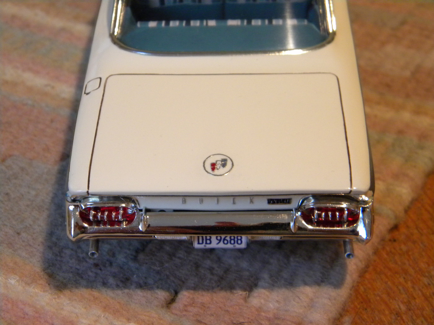

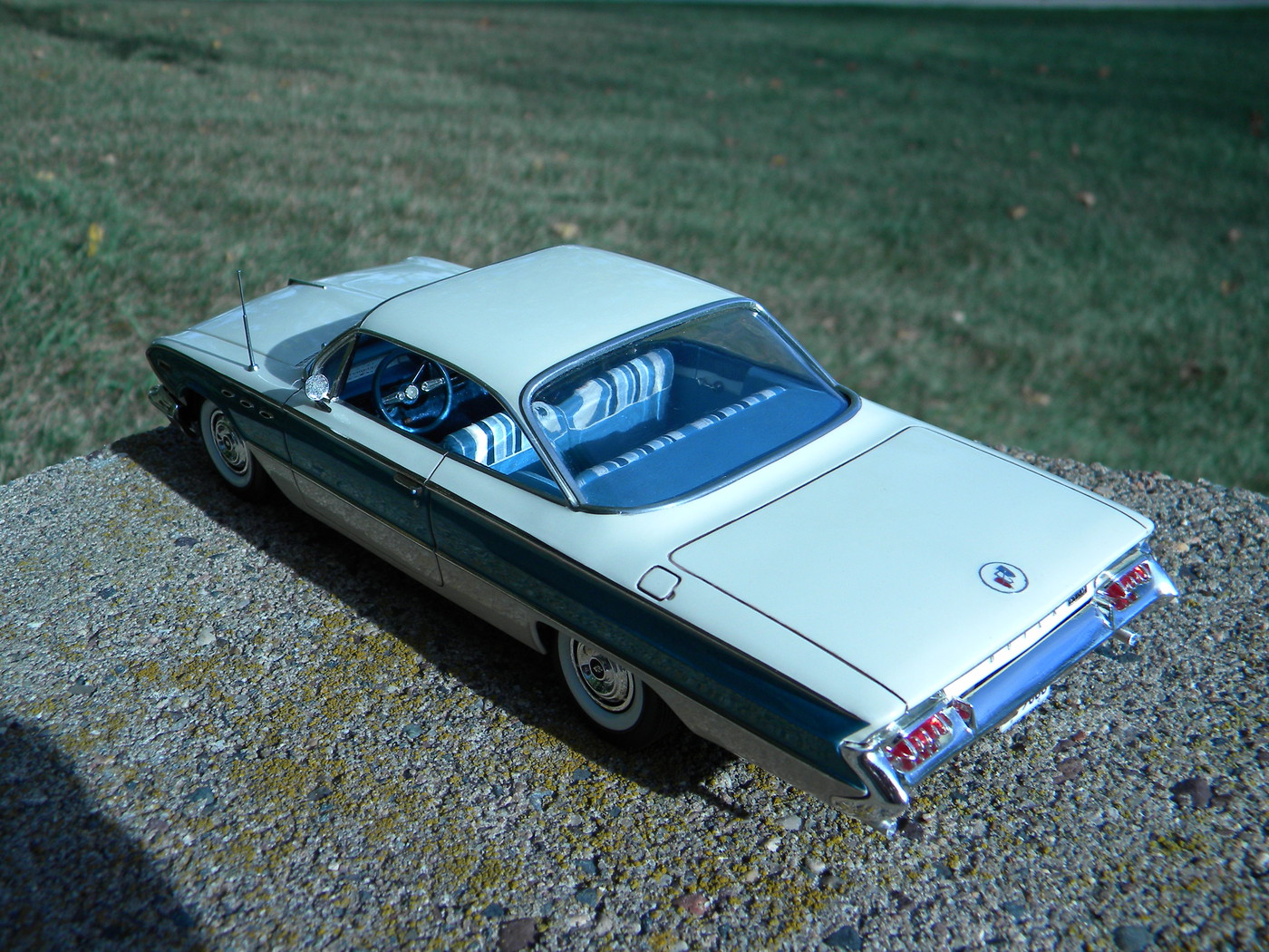

Here are a couple of photos of what to expect when you are finished.

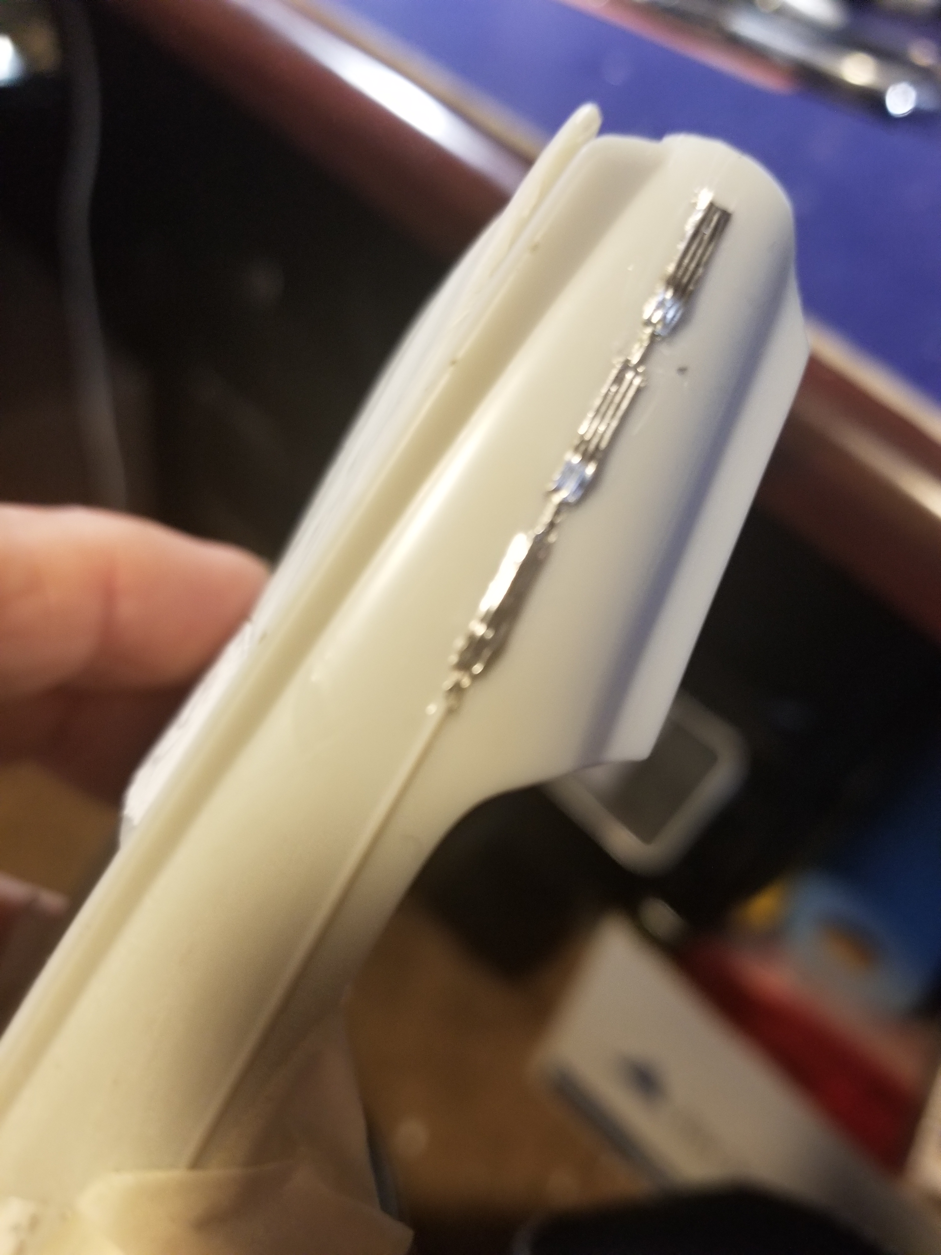

Looks great, but I lose clarity by the time I get to the final paint coat. Is this the way it should look?
Looks pretty good.
Just be certain that the edges of the piece of foil are burnished down well before paint application.
If the edges stick up a little, they could possibly show through the paint.

Another fun thing that can be done with this method is after cleaning off the foil, you can add detail paint to small emblems & clean it off the same way giving you some nice colored emblems.
This '61 Buick trunk emblem was the ultimate test of this technique.
It was a very faint detail, but it came out well.
Steve

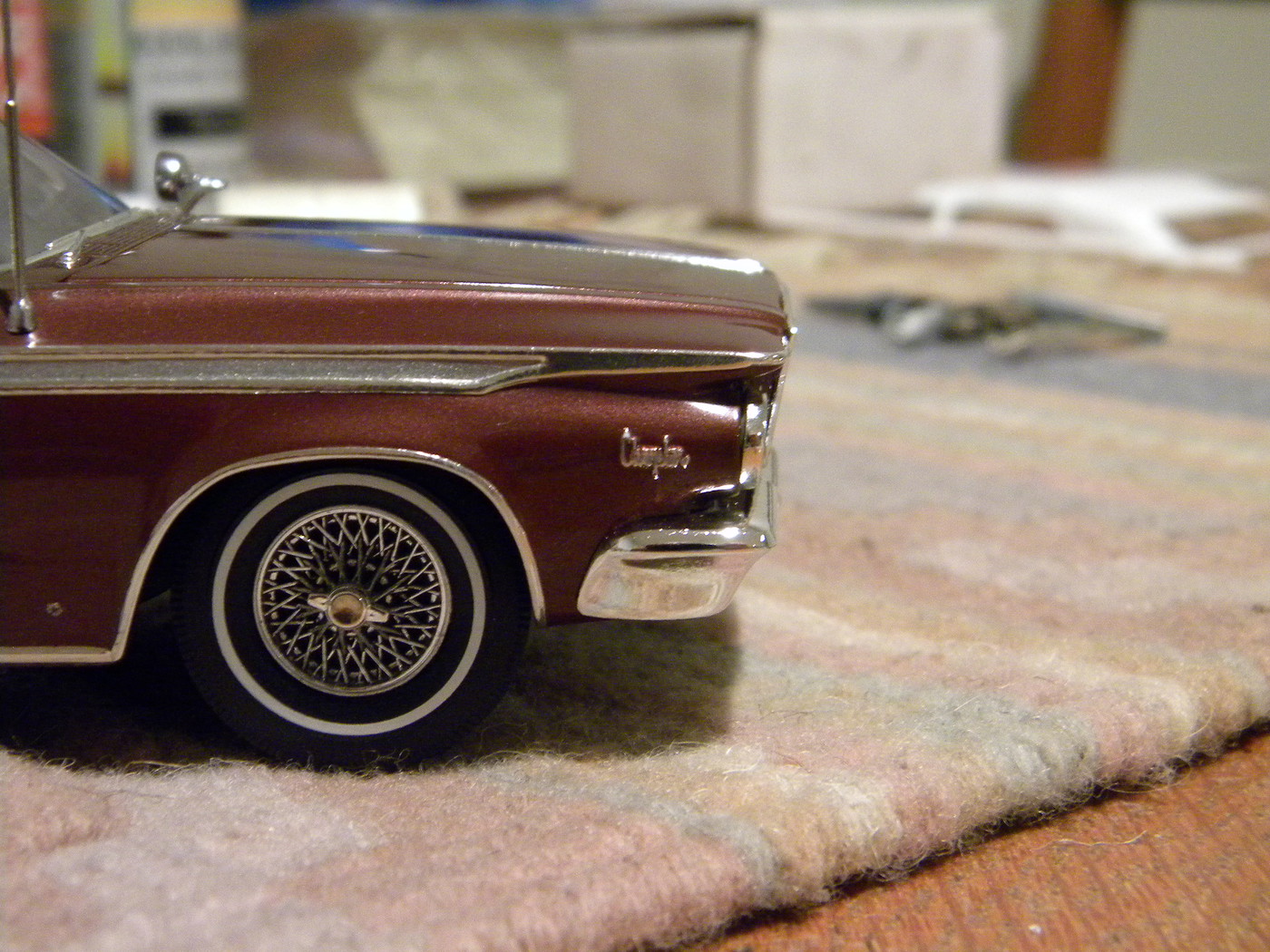

It should give you a nice affect on the fender badge.
Steve
