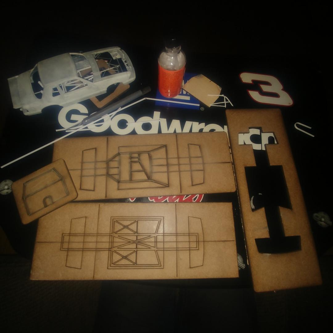

MachinistMark Posted October 15, 2018 Author Posted October 15, 2018 But here it is, made the templates on the cnc laser i run for work
