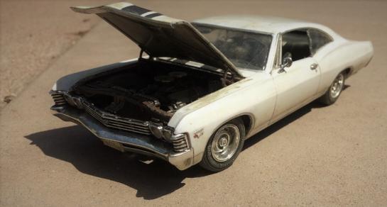

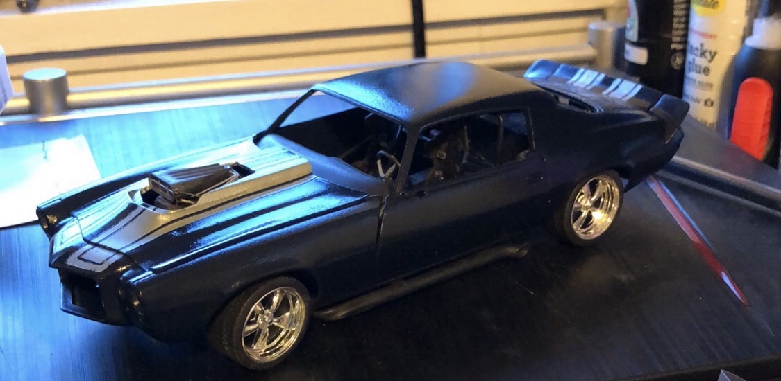

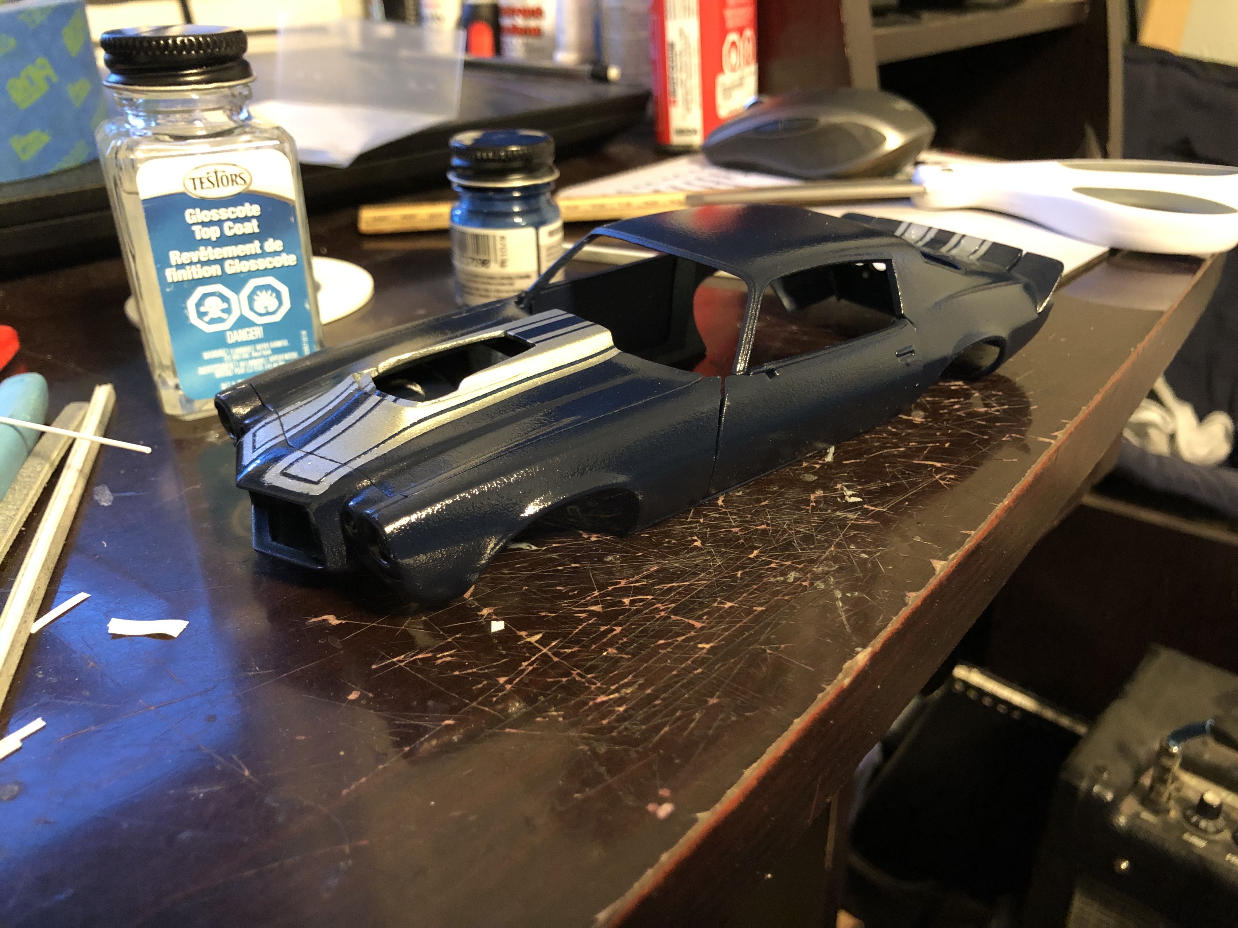

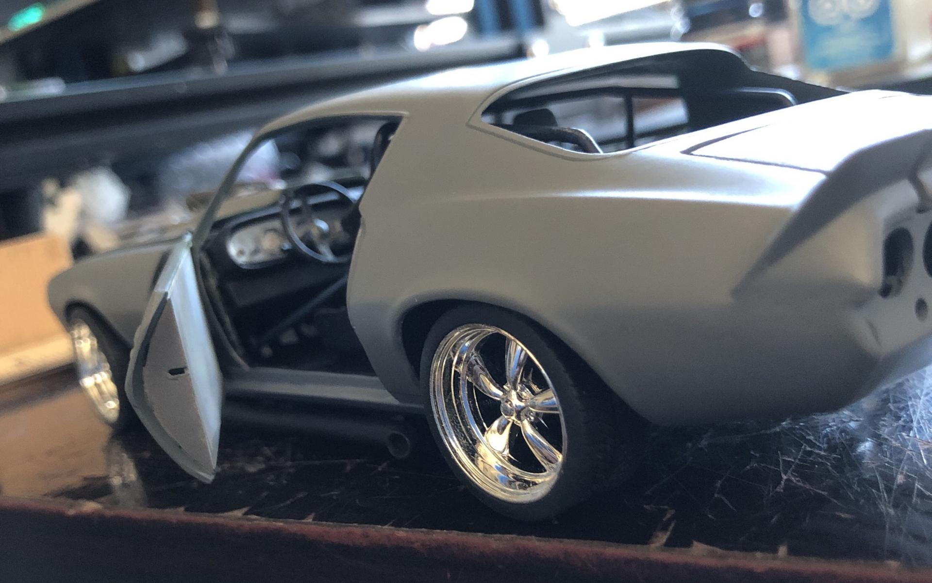

  1. Thanks, I think it’ll be alright. Got it painted and cleared, first time I’ve used an airbrush. Turned out okay, considering all the issues I had. Going to have to buff it to at least reduce that orange peel a bit. Personally I think the stripes look a little goofy up front...but it is what it is at this point.
  2. So, good news and bad news. Good news, I’m on track to have it painted over the next couple days. The car is in primer, gonna shoot the stripe color here shortly and probably base color tomorrow, followed by clear either tomorrow or Monday. The bad news is I had an unfortunate mishap where the model came between my phone and the floor. Broke both a pillars and the body half way under the passenger door. It’s fixed (or as much as it can be), but the passenger door doesn’t fit up right anymore and the exhaust hangs down in the front on both sides. I’ll try yet to fix the exhaust, but the door I think will be a permanent flaw in the car. The whole body is twisted. Still needs a few things, namely brakes and door panels, but we’re pretty close.

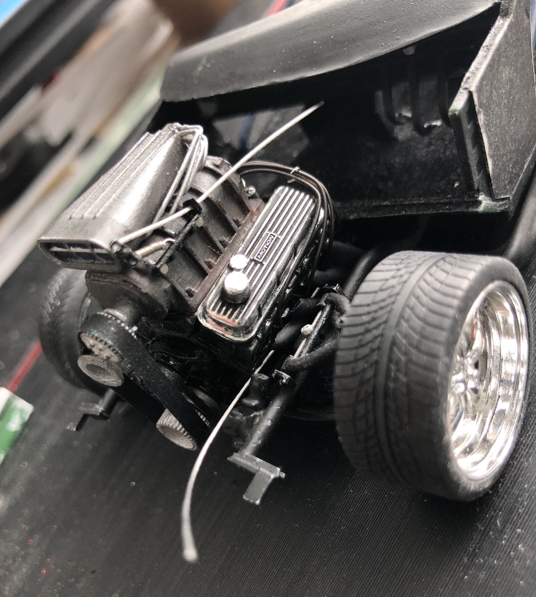

  3. Its been a little while, not a lot to show at the moment though. Motor is in and throttle linkage there, that’s about all I have to show for the moment. There are other things (fuel line, exhaust, stuff like that), but that’ll be shown later. That line coming from under the header is the clutch cable, it’ll get hooked up when the firewall is put in. Working on doors right now, getting them to stay shut with magnets. Hoping for nice weather this week and next weekend so I can get the body sprayed, we’ll see if I get there as planned.

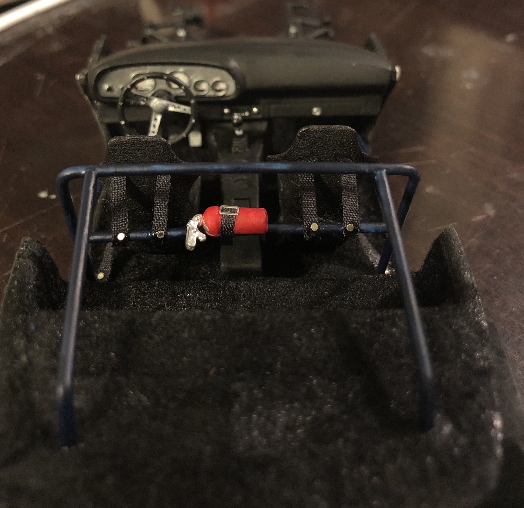

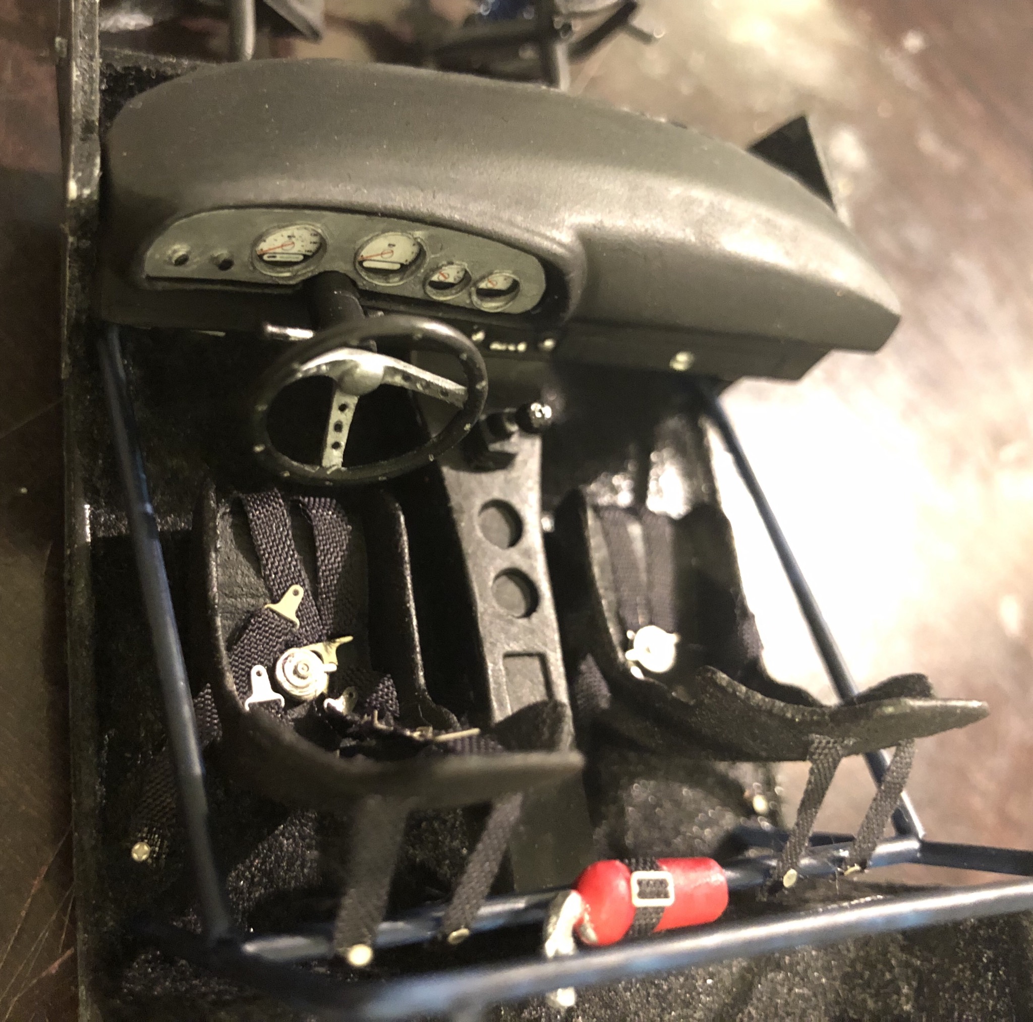

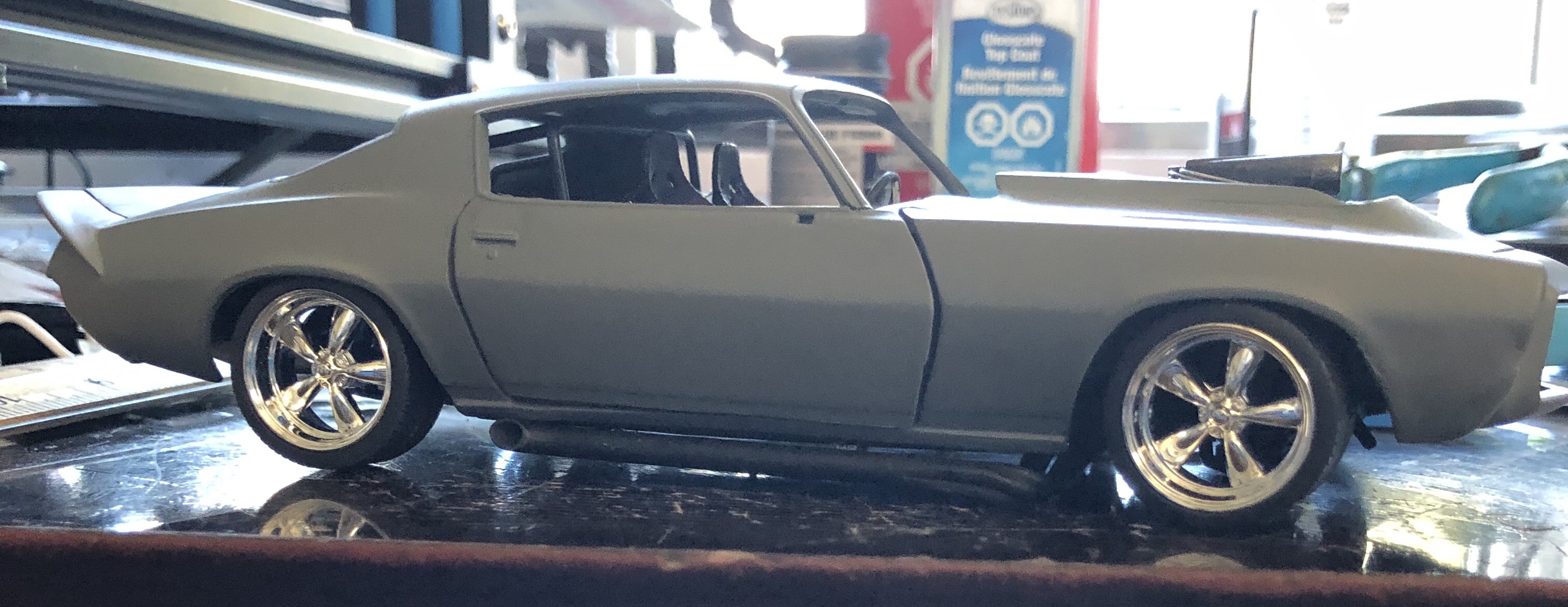

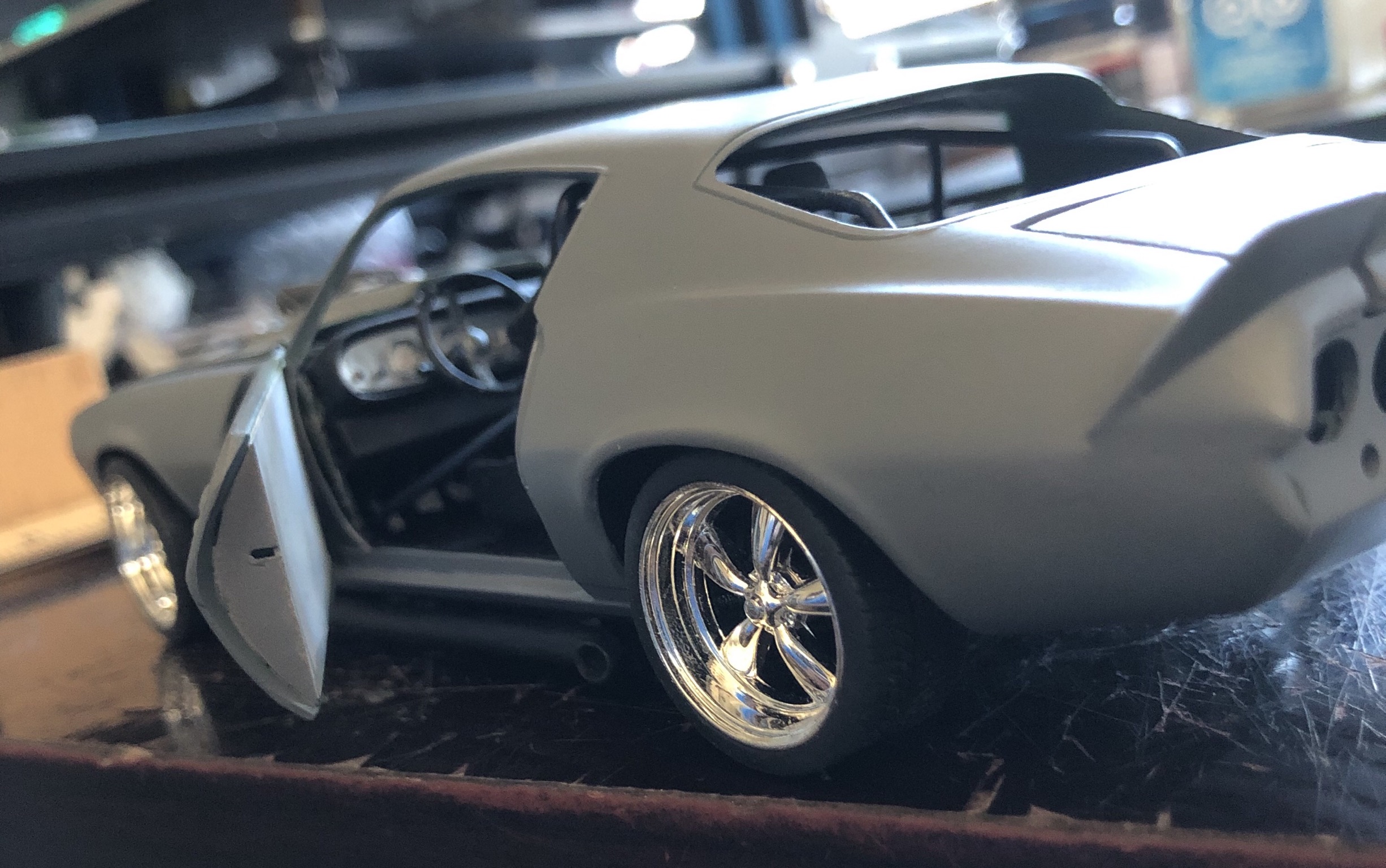

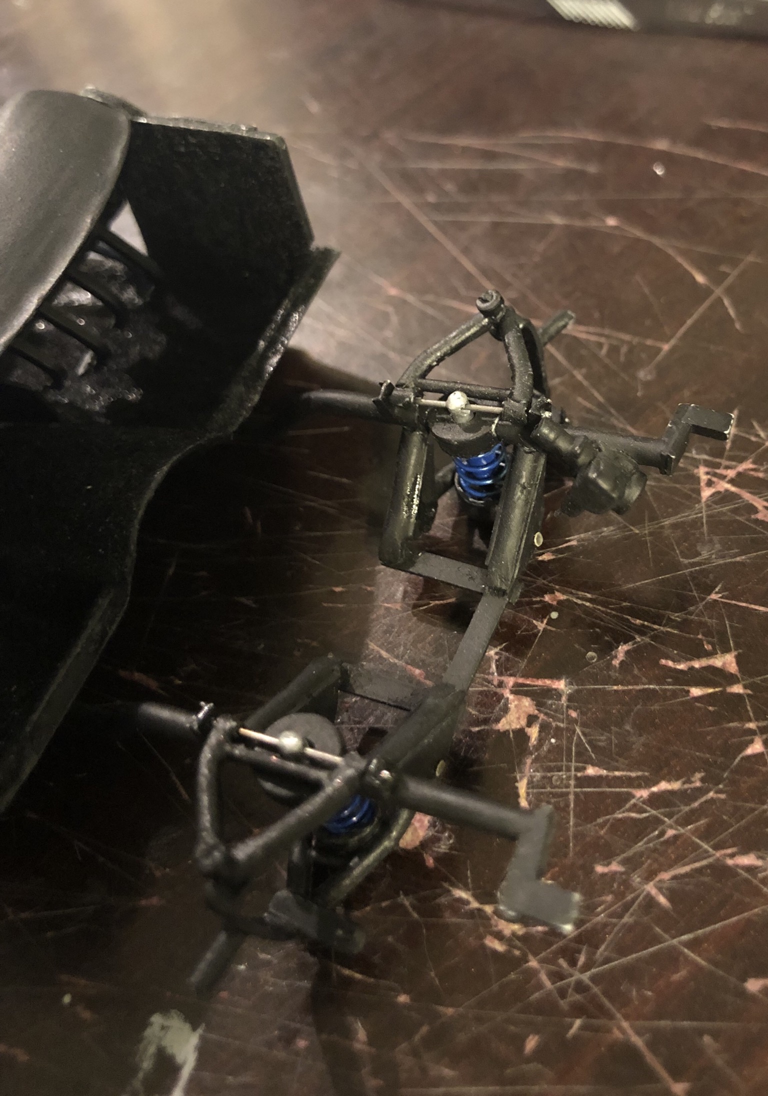

  5. Got the front suspension together, but broke one of the steering pieces. Haven’t fixed it yet, so it isn’t on the car. However, I did get the interior done. Still needs door panels, and then parts on the body itself (a pillar trim and such), but this part is complete.

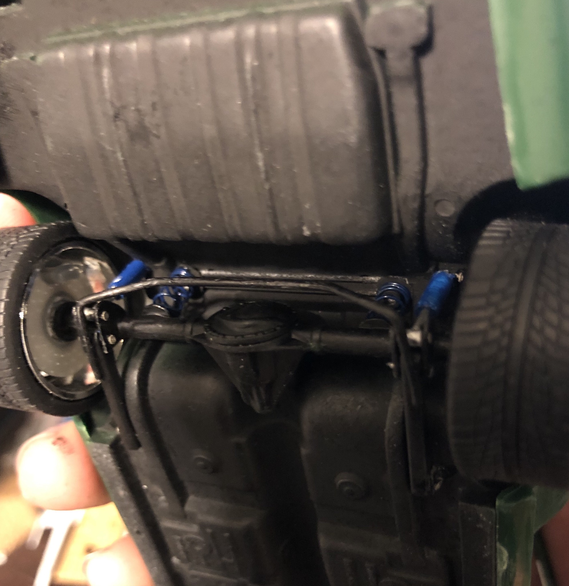

  6. Final assembly for the rear suspension. All works. Not a lot of travel and it’s fairly stiff, but that’s how it should be right?Front is probably going to take a while. Also got steering done (technically incorrect for the car, but there’s a lot on here that’s ‘wrong’), that’ll be shown with the front suspension.

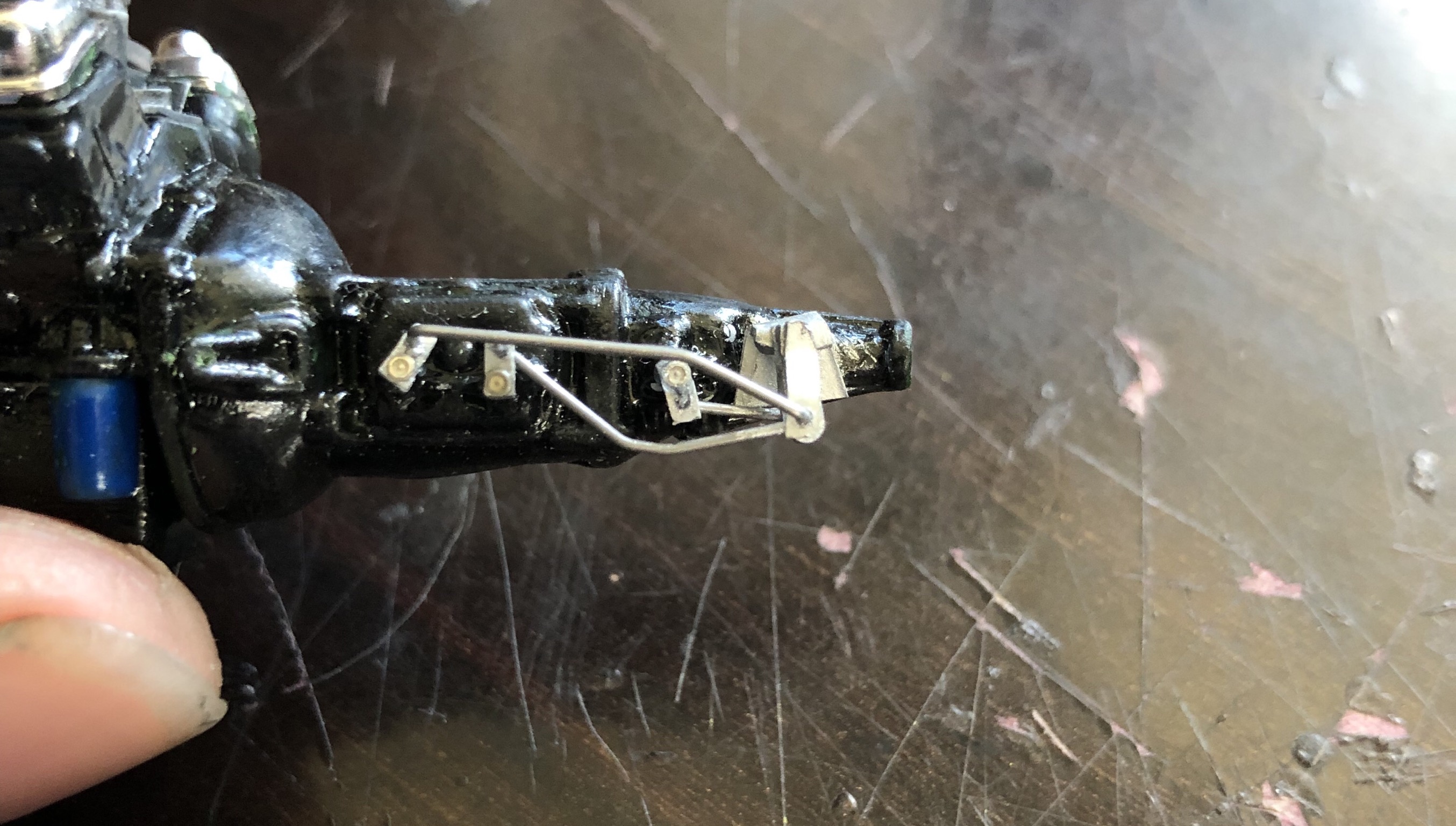

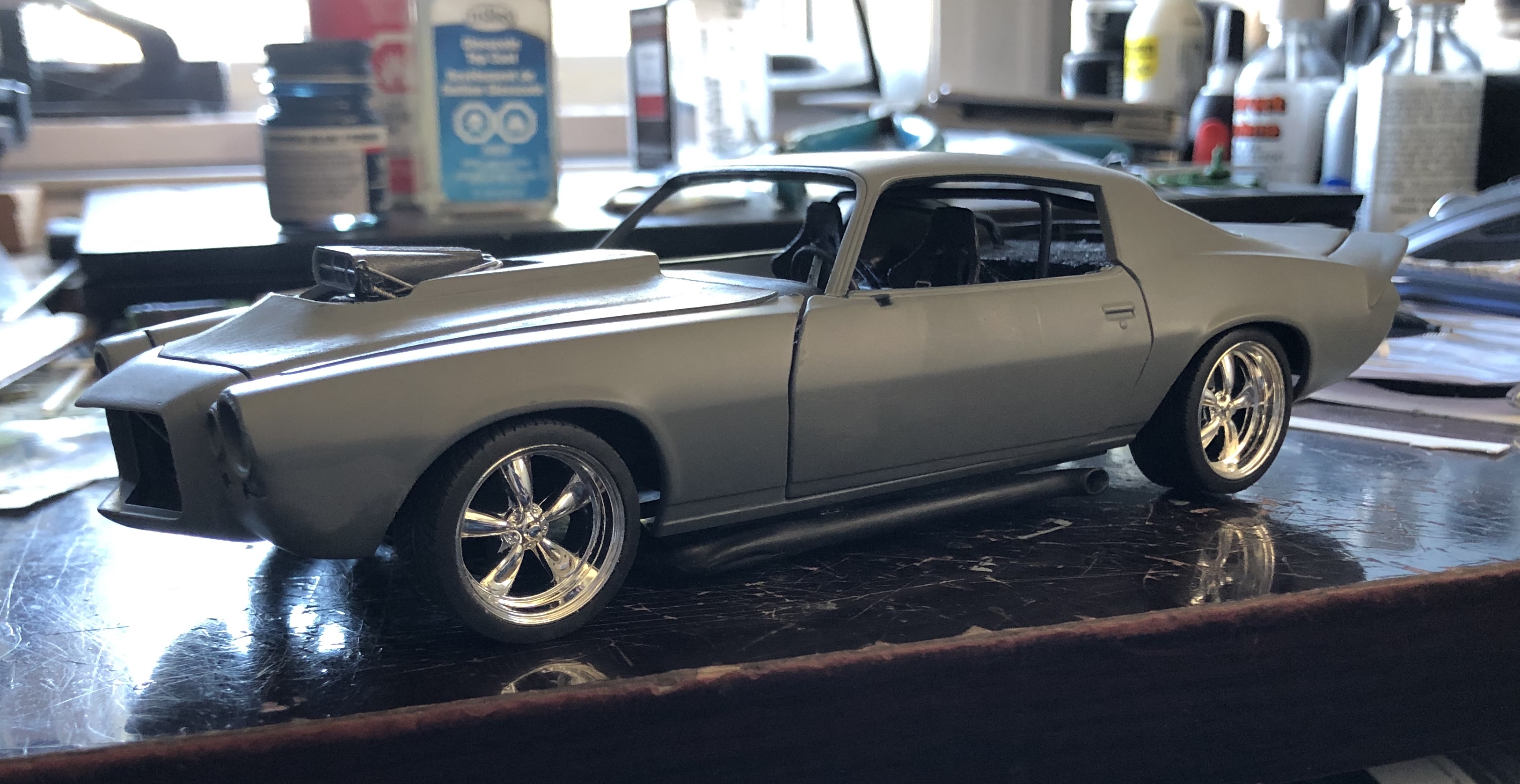

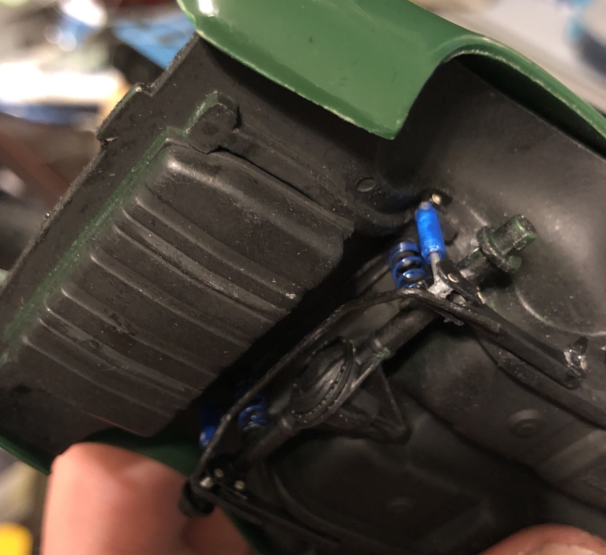

  7. Little progress. Still need to do shocks for the rear suspension, and then sway bars and steering. I’ll show what the rear looks like when that’s done. Here’s how it’ll sit, or similar anyways. And then I did the shifting linkage on the transmission, got bored one day and thought it would be fun. Didn’t do the shifter up, but that won’t be seen anyways. Also got the trunk cut out and the wing on, but needs work and hinging yet.

  12. I am 18, and my convertible is a little bit nicer than that lol So you basically made your own flocking with paper? That’s a smart idea

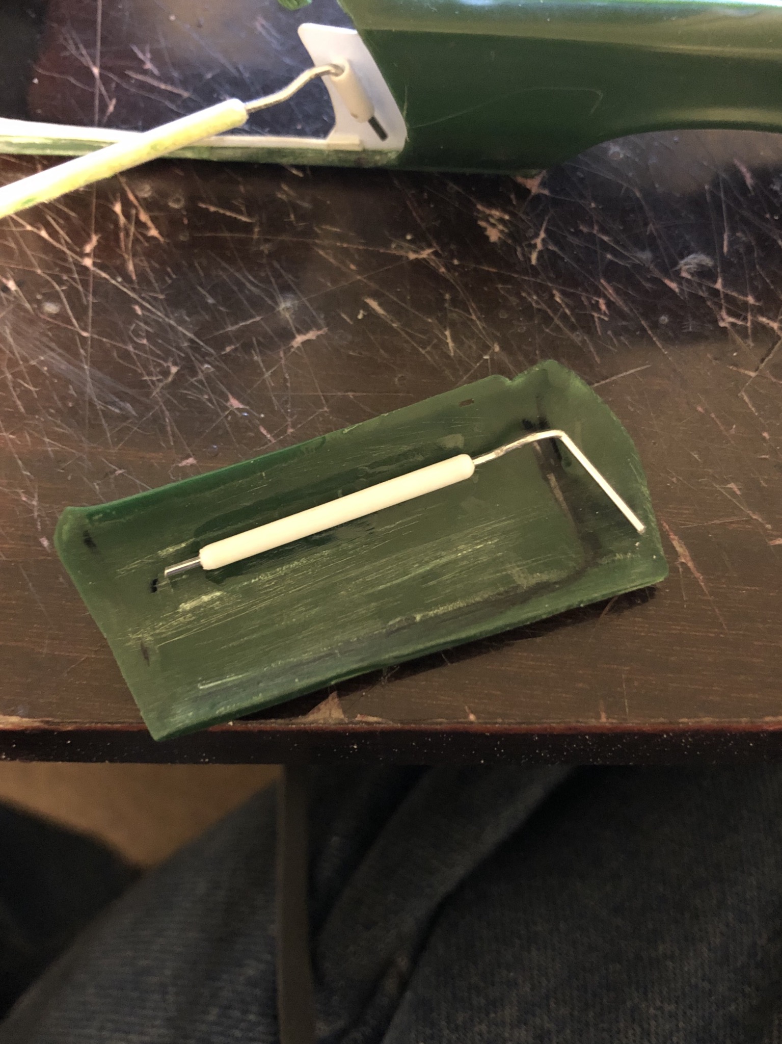

  14. I had to cut them to get the doors off. I’m thinking of finding a way to attach them to the same part where the door is hinged at, like the actual car, but that gives some clearance issues with the windshield. I’m going to have to make some modifications to the windshield (or make a new one) anyways, so we’ll see what I come up with. I’m wanting to do all the a pillar interior pieces and everything too, so I’ll find some way to make it look good.

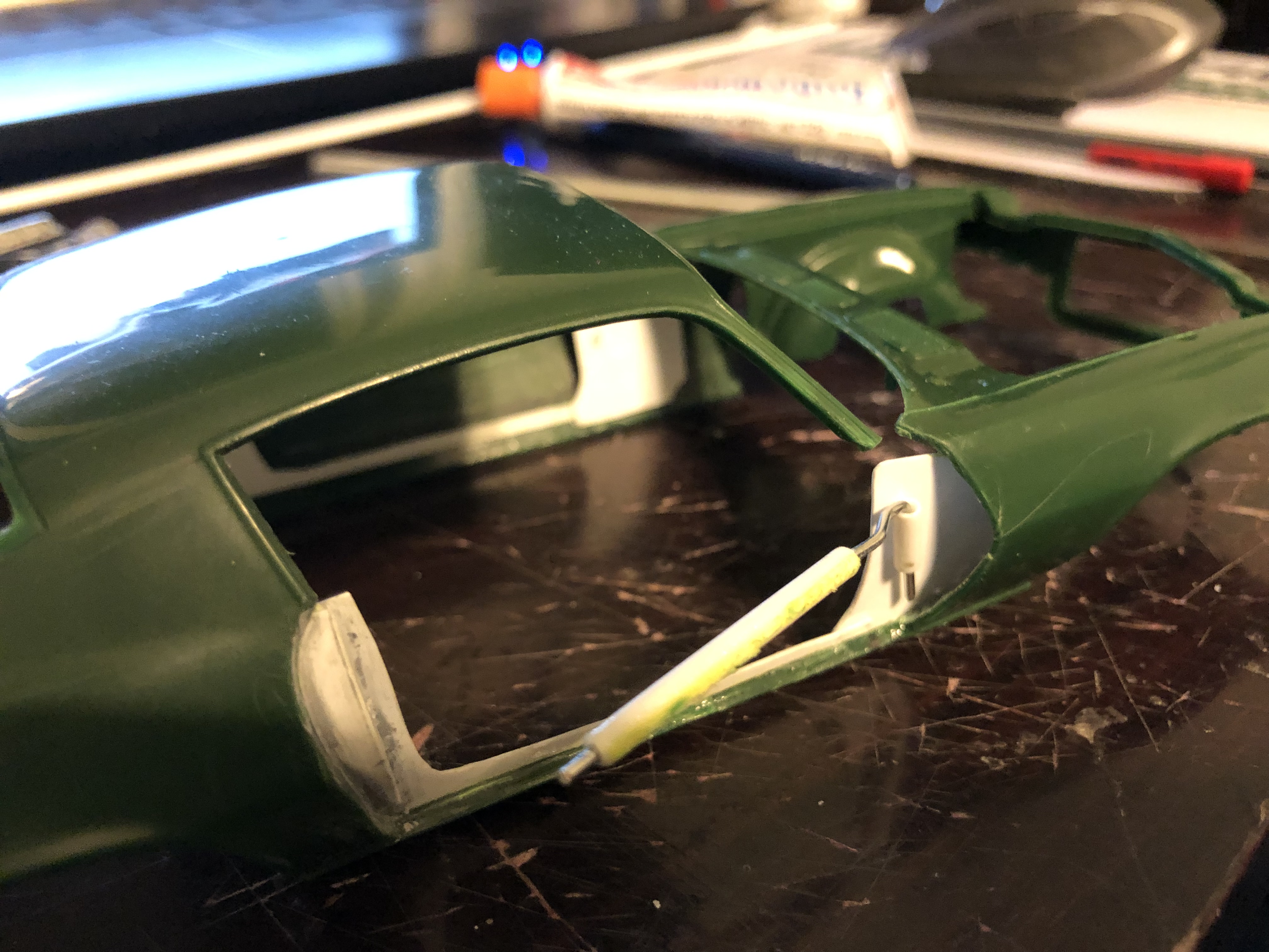

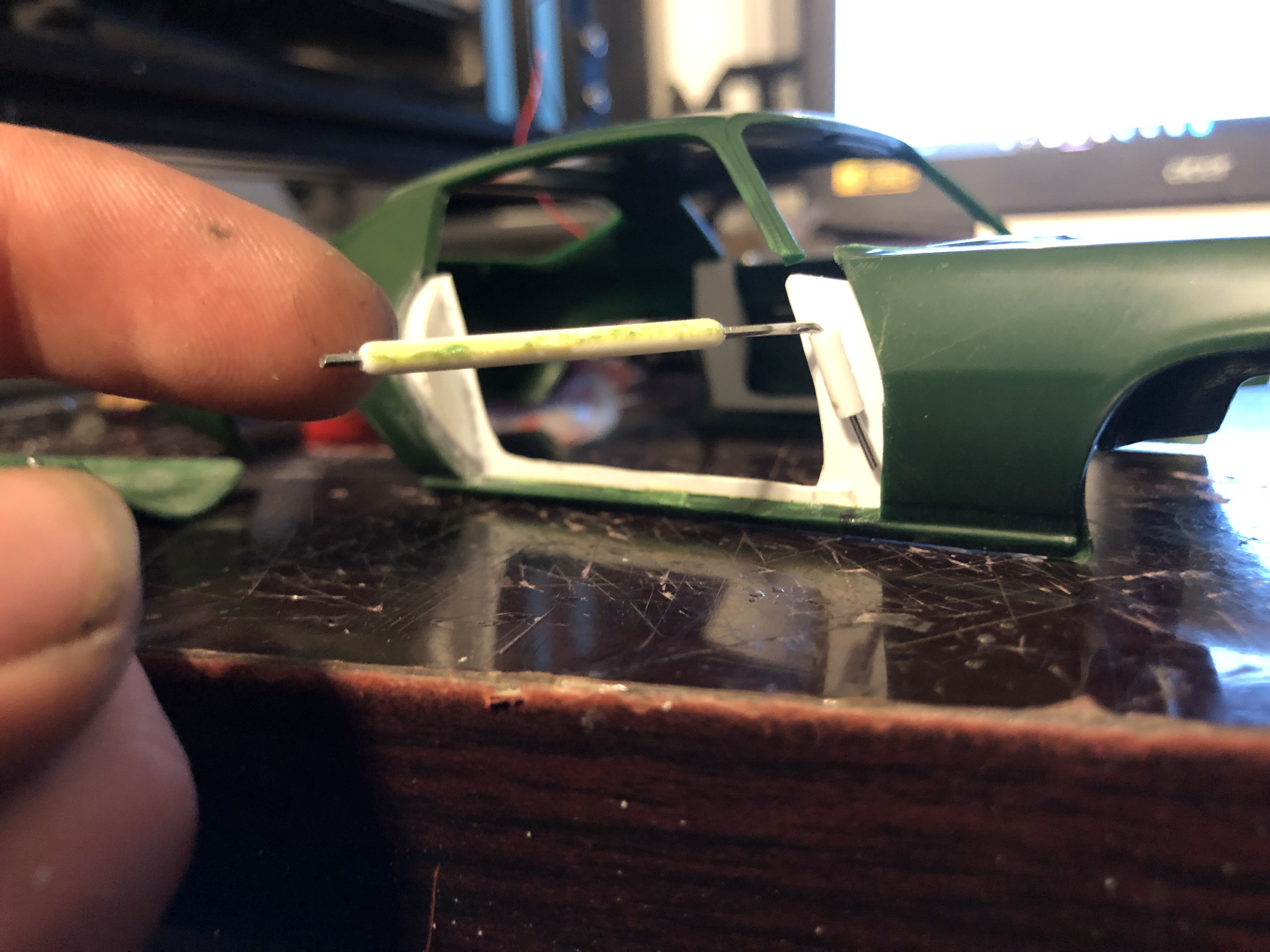

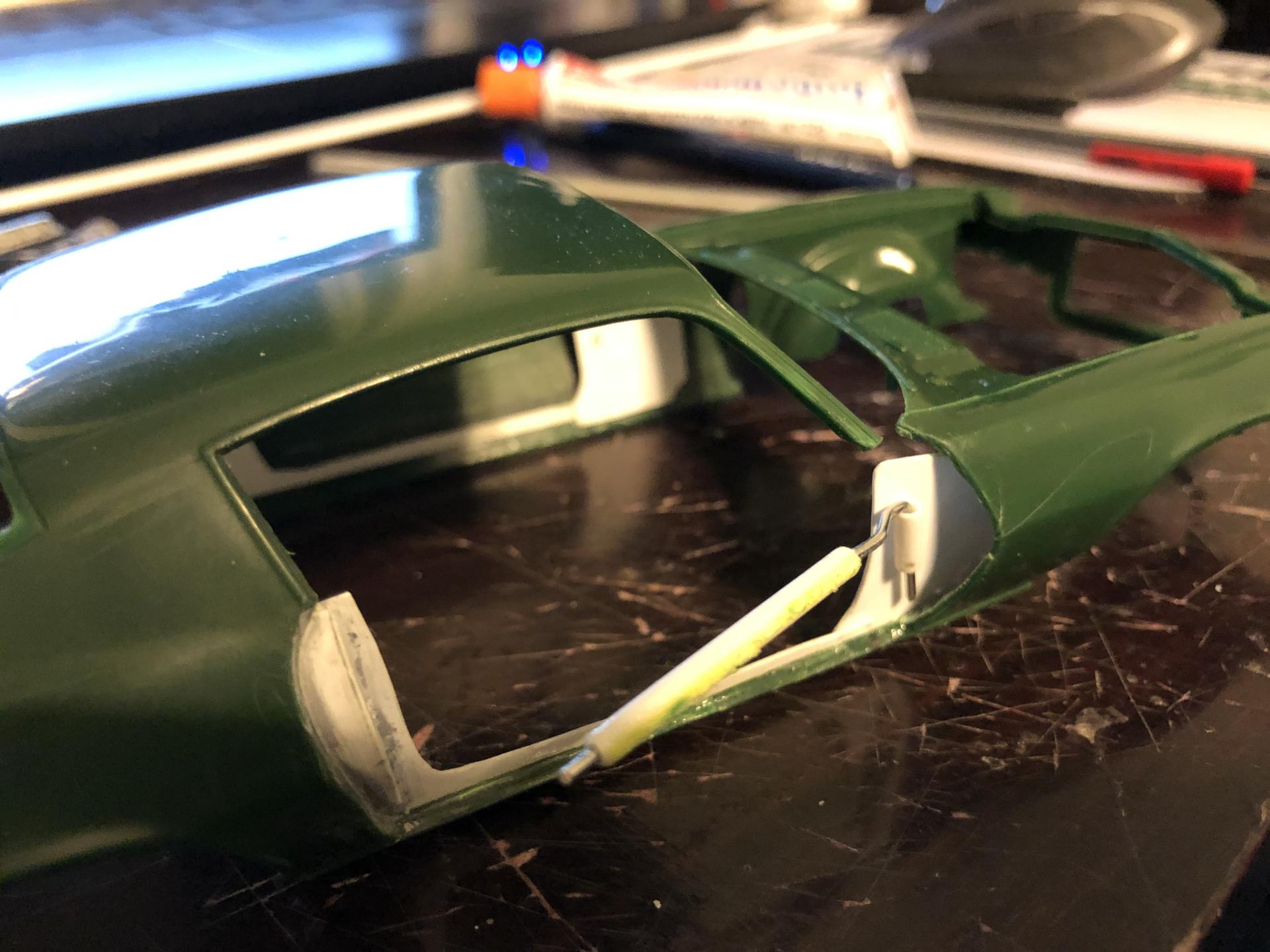

  15. So before, when I made the door jambs, I made those white pieces that match the interior tub towards the front. You’ll see what I’m talking about in the pictures. This is where hinges on the actual car would be. So I put a small piece of tubing there, which had to be angled since the piece it’s glued to is angled. That’s kind of difficult to explain, but without doing so, the doors opened more downward. I used a paper clip for the rod, and then the same tubing as before for where the door is attached to it. Of course I thinned out the edges of the door, and front of the door opening, before attaching it. Takes a bit of trial and error to get everything lined up right, but the results are, in my opinion, better than traditional methods. You could do the same thing just attaching to the interior tub if you wanted to, but I decided to have it just on the body itself. I found that it made it easier to work with. Hopefully that’s easy(ish) to follow

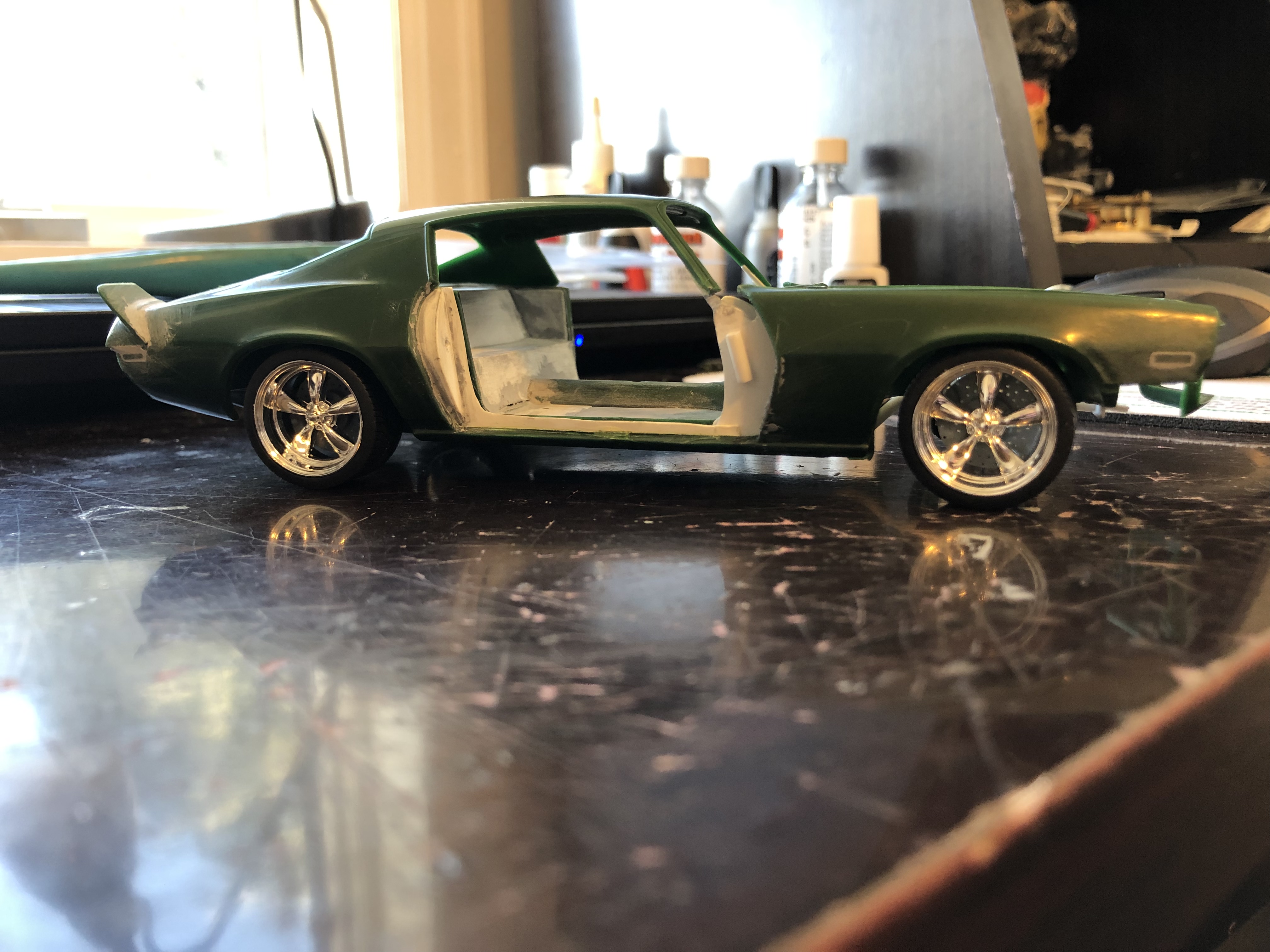

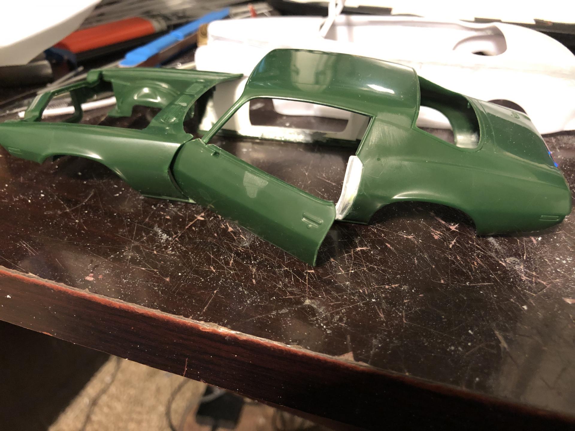

  16. I ended up spending the day helping my dad make a Carson top for his 1:1 ‘51 Chevy, so I didn’t even end up getting the other door hinged (though it’s most of the way there). Here’s the drivers door anyways. It doesn’t like to stay shut, but I think that having the body of the door done will help with that. I’m done working 12 hour days now, too, so I should have a little more time for modeling shortly.

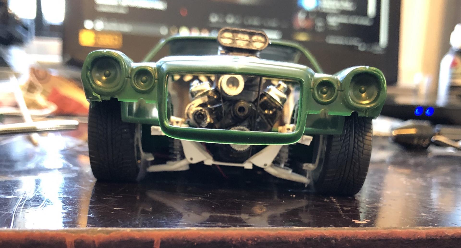

  19. That looks fantastic. Your suspension was working? How’d you get it? I wanted to use the factory stuff, but couldn’t make it work, hence the tubular stuff. What’s your plan for the hood, or are you going a different route? Looks like it’ll be a fun build. I’ve made a little progress, mainly just got one door hinged (almost done with the second). I’ll probably get around to that sometime this weekend, and I’ll get some pictures up of whatever I get done.

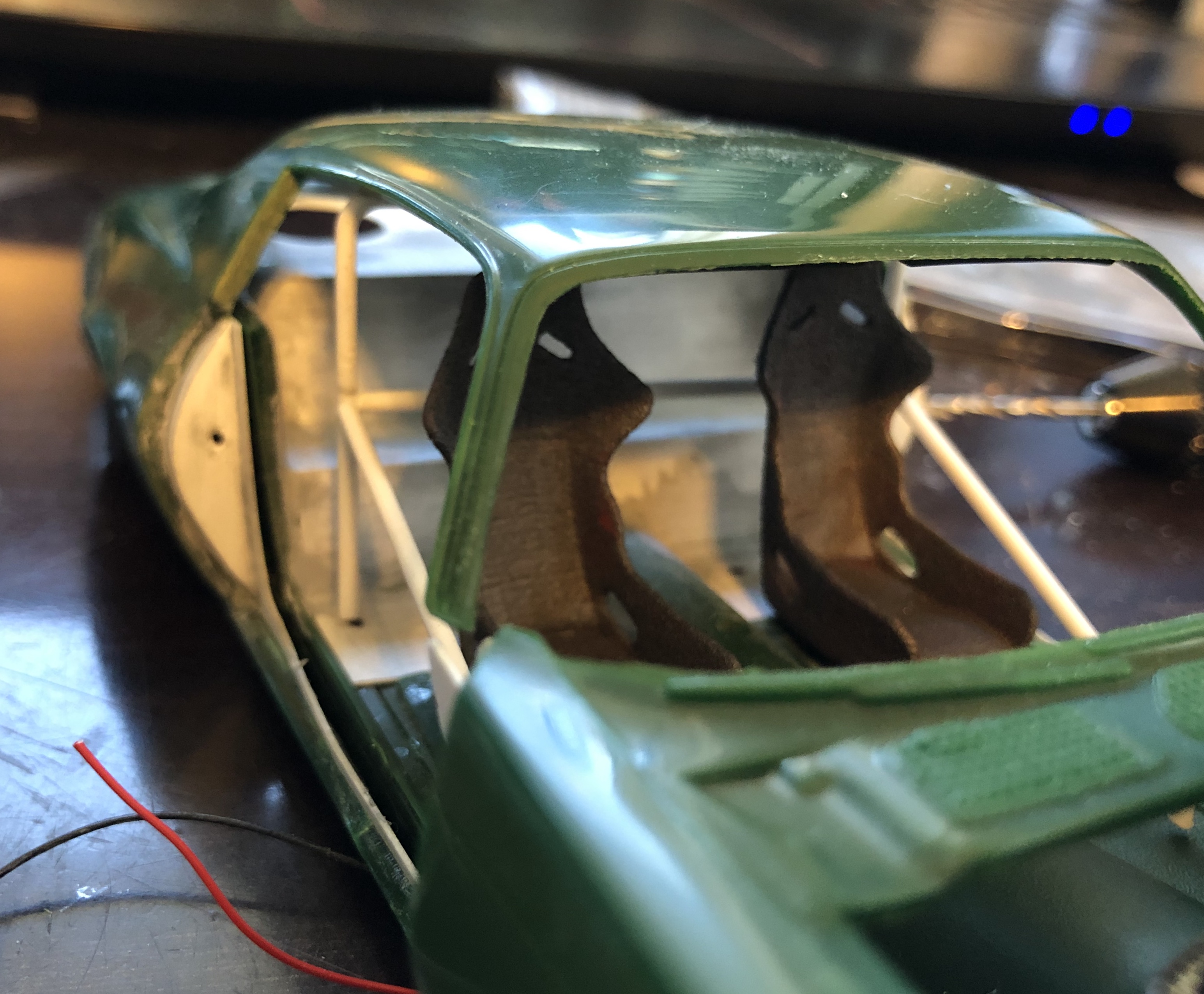

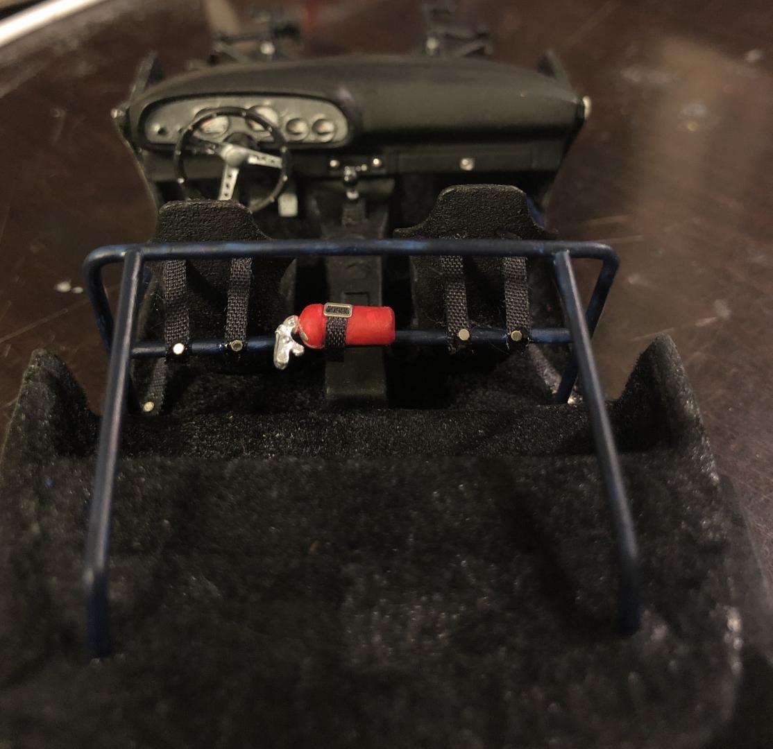

  22. Merry Christmas guys! Finished up the front suspension this morning. Needs finishing work to look good yet, obviously enough, but it’s actually all fabricated at this point. Still needs steering...but I have an idea for that. The motor is crooked in the pictures, I have yet to make motor mounts is why. It’s just kinda chillin in there. Also made the cage (just a small 6 point, I might add a couple bars yet to make it more like the 8 point in my foxbody). Made the other door jamb last week. More progress to come

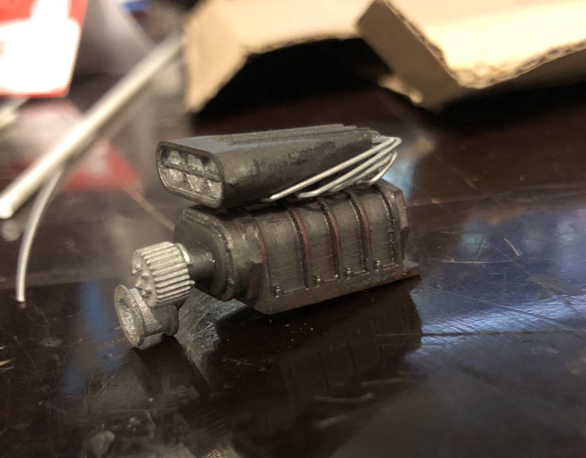

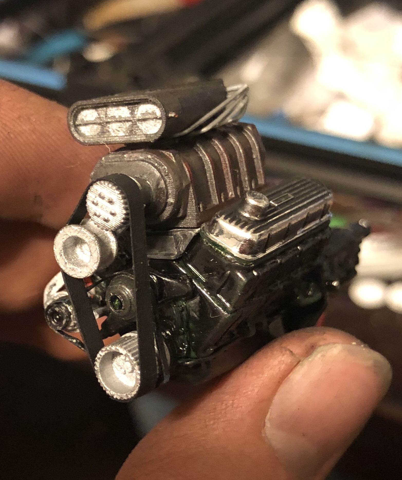

  23. Thanks Got the fuel lines on the injector hat done. Not much, but it’s something. Edit: found a little more time and got some more motor work done. Looking good I think. Need to touch up the butterflies though, trying to get those looking right is tough.
