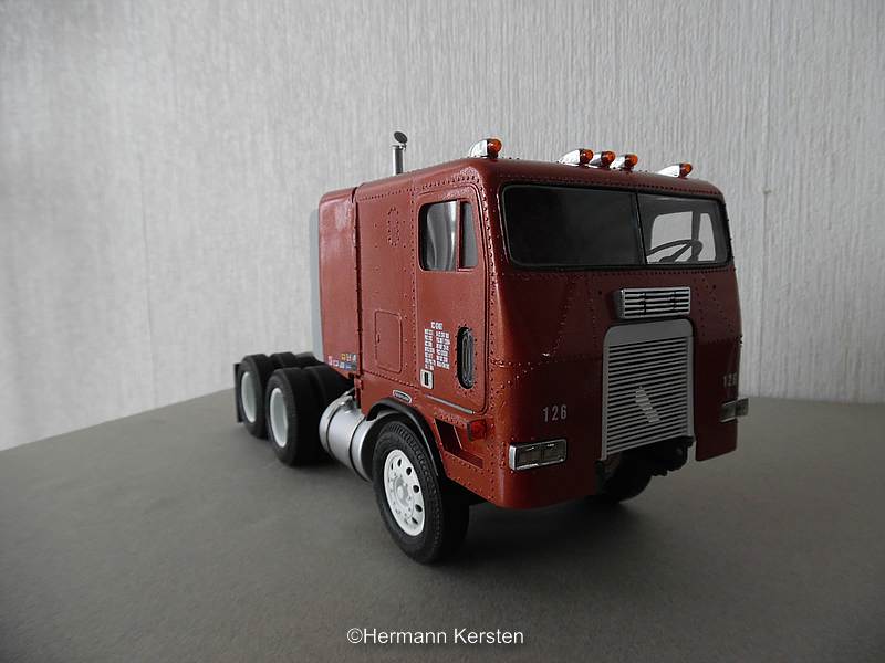

Ok guys,  the brass connectors of the trailer cables, and the grill are now also completed.
On the grill I have glued the 66 pieces of small styrene strips, 0,5mm x 0.5 mm x 10 mm ,  to the main strips of the grill.
After this job i made the grill chrome with a chrome marker and added a CTM Freightliner emblem , what was first blackened, and then later the paint, on the higher surface, was scratched away.
And an overall picture so far ....
Ok guys, thats it for today is till the next round!
Hermann.
Edited by Hermann Kersten
