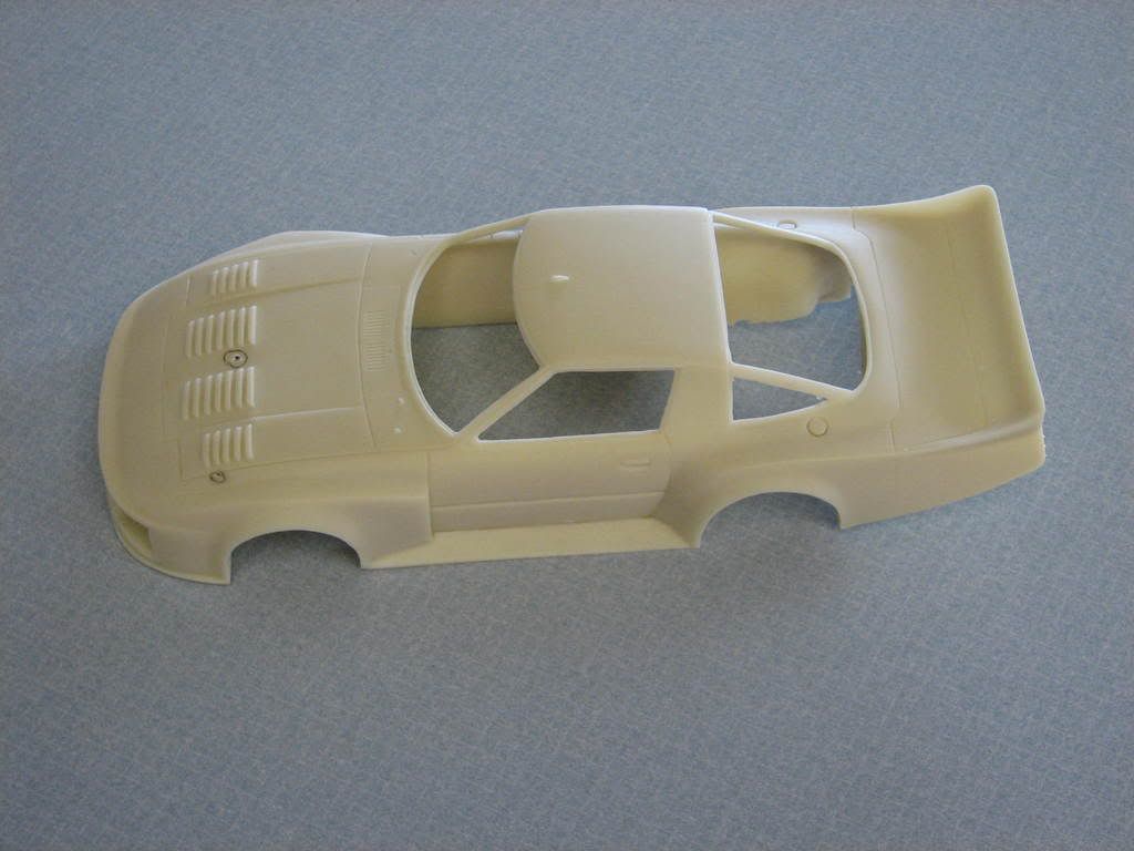

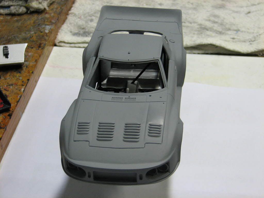

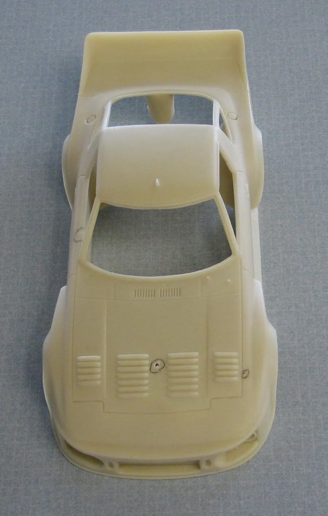

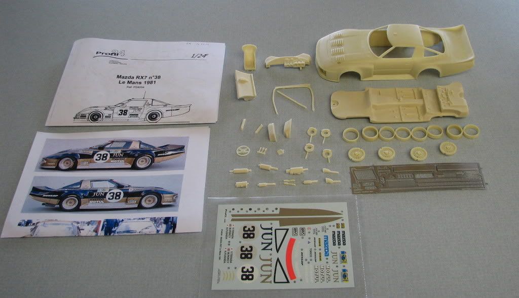

I'm working on a Profil 24 Mazda RX-7. First impression...kit seems to be a decent kit. I already see some fit issues with some parts (typical Profil 24). A lot of flashing on the body and some pinholes that need to be filled as seen in some of the pictures. Body shape looks correct from the photos that I have. This is the car that helped launch Mazda into prototype racing since this was the test bed for the 13B motor that later on in '91 ended up winning Le Mans over all.
Unfortunately this car didn't make it too far in the race, but its sister car did fairly well. The typical Mazda problem...having the transmission catch on fire from the tremendous heat from the motor. :rolleyes:

The bullet holes in the car are the pinholes I was talking about. I always circle imperfections on the body right off the bat so I know what areas to touch up on if I have to leave it for a period of time.
3men2s,
The resin wasn't really that clean. This is about after an hour and a half of clean up work already done to the body. This is pretty typical of Profil 24. They have a lot of flashing, but it's easy to remove.

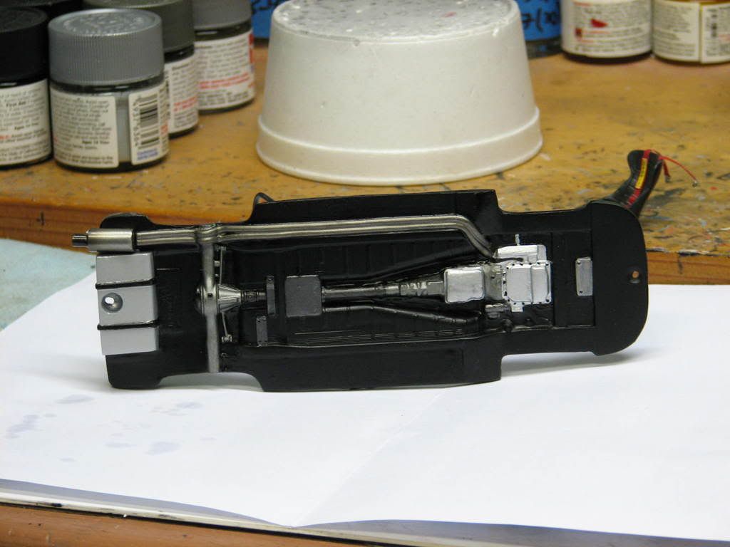

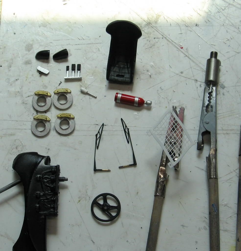

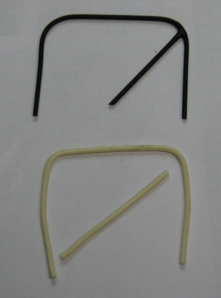

Got a little work done. Majority of the parts are painted. Not many parts for this kit. I'm going to have to fabricate a roll bar for it since the resin one is incorrect.
Interior parts
Exhaust and oil catch painted in Alclad

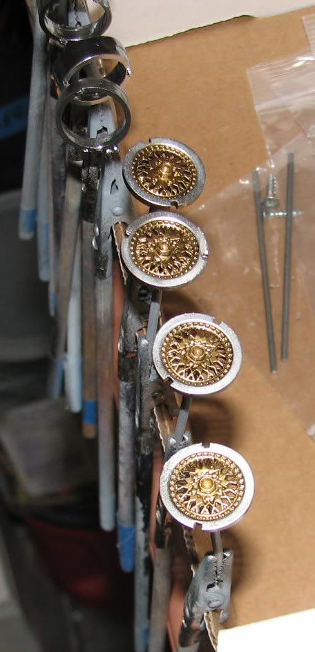

Center section of three piece rims painted with Alclad (rims could have been casted better)

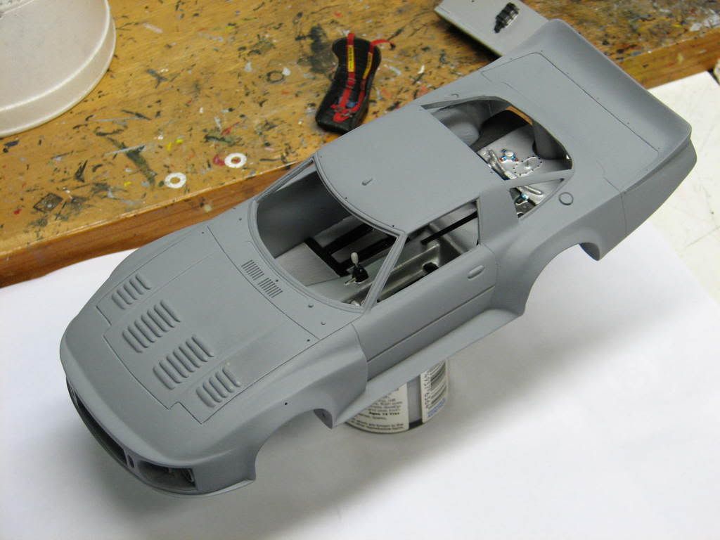

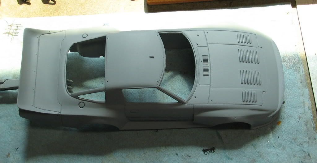

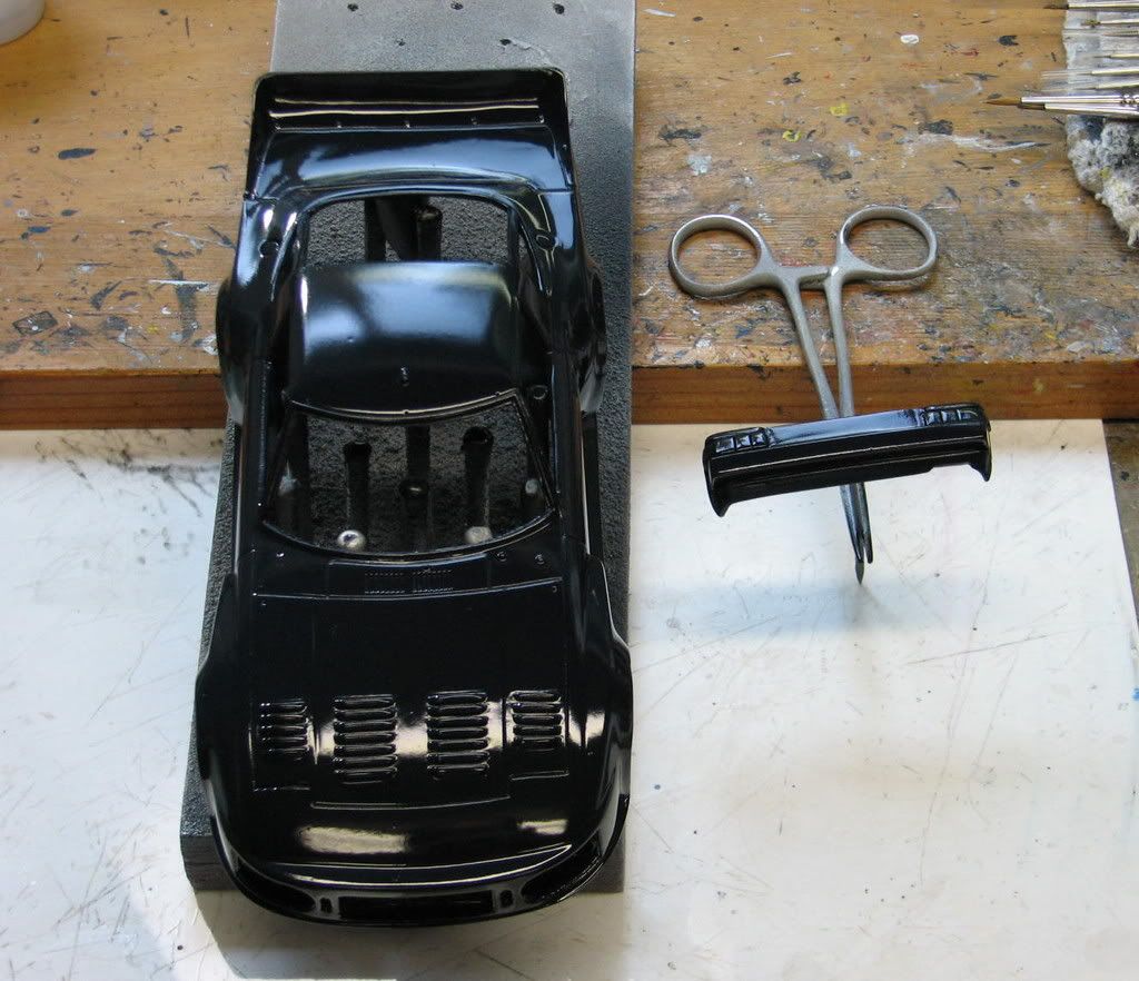

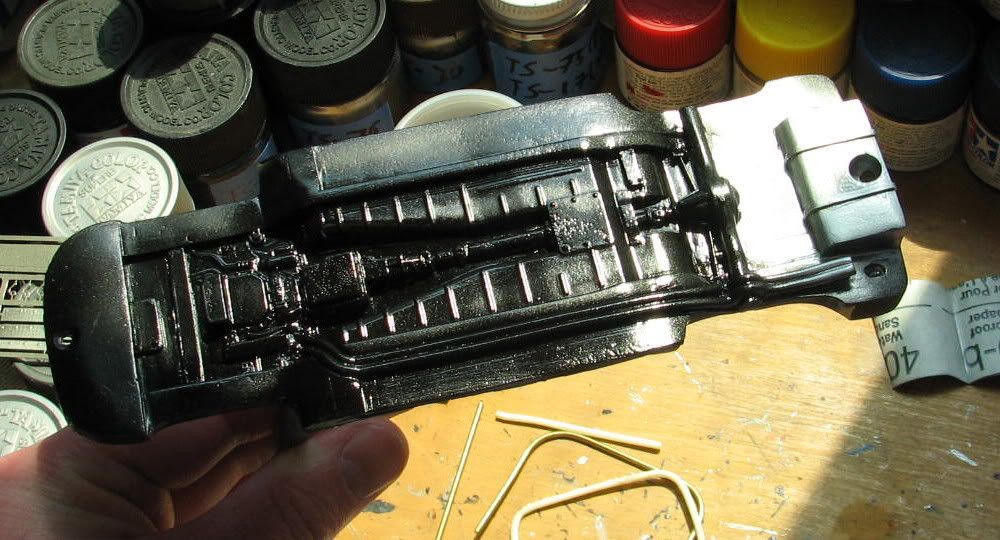

You can see the pinholes on the chassis. They didn't show up till after I put down the black paint. So now I have to fill them in and repaint.
Filled in some holes on the body, but there still are some smaller pinholes that I need to fill in.

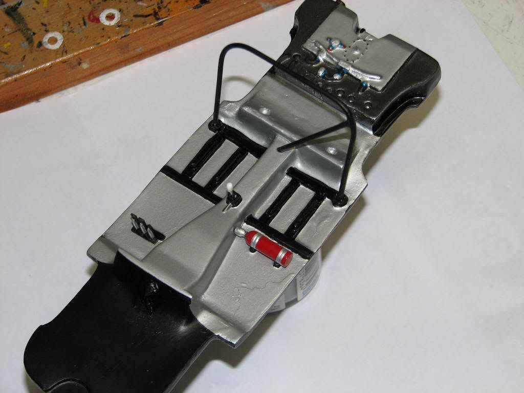

I got some stuff painted yesterday before my airbrush broke.
New roll cage fabricated.

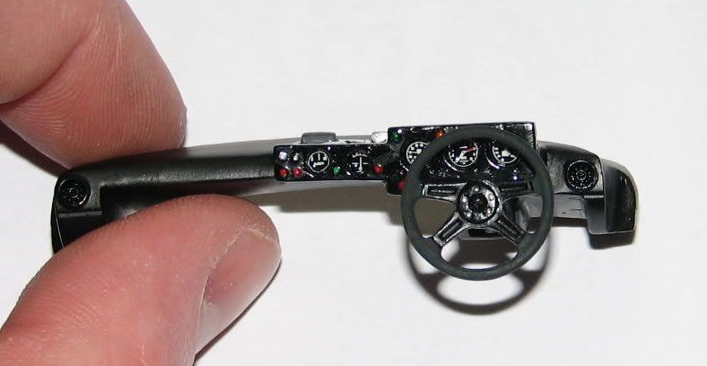

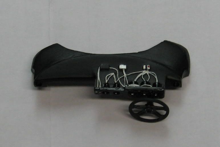

Dashboard with detail painting; gauges are decals.

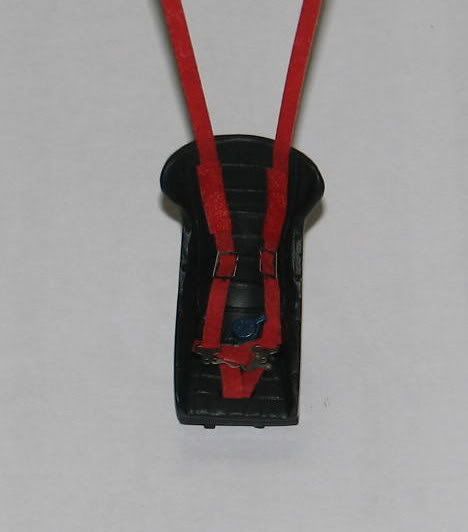

Homemade seatbelt material, using cloth tape.

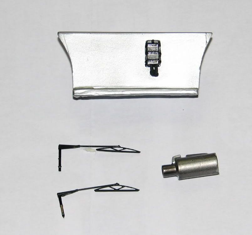

Rear firewall and exhaust painted with different shades of Alclad.

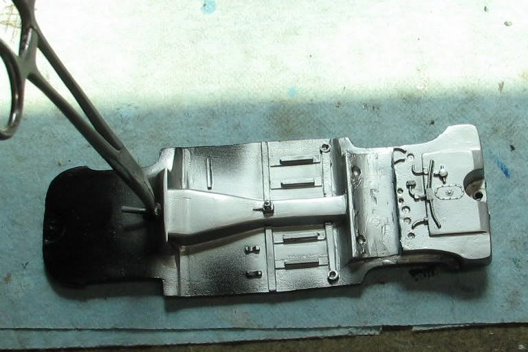

Finally got my airbrush this past week. Got a little more work done. Found a couple of better photos of the chassis which shows it being all aluminum on the inside. So I ended up repainting the chassis. Can't do much more on the interior until I get the body on since you have to attach the firewall after the body is on. A really big pain. One thing that really irks me is that on the chassis they show a partial motor and a transmission, but the tranmission is shown as an automatic instead of a stick. (See picture.) Still waiting on some blue for the car. I'm hoping to get it within the next couple of weeks.

Typical Profil 24. Hardly any detail on the interior. They have a tendency to concentrate more on the body, which is okay but sometimes I like a little more interior detail. Most of the Mazdas usually didn't have too much stuff on the inside so they could keep their car light.

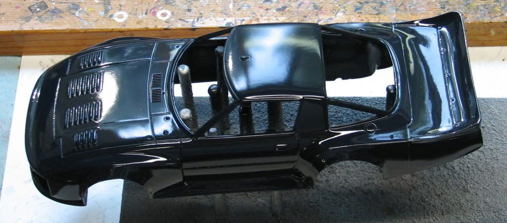

Well, finally got the body painted. Now I just need to paint the gold. It's a really, really dark navy blue. Couldn't find any paint that would come close so I ended up mixing my own. I used Tamiya's TS-14 Black and Tamiya's TS-15 Blue in a 2:7 ratio of black to blue. It's a little bit flat so after I get the gold laid down, I'll lay down several coats of gloss.
Here's some pictures.

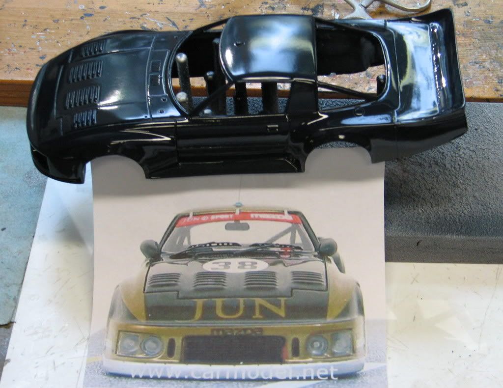

The picture underneath is one of the few reference photos that I have of the actual colors.

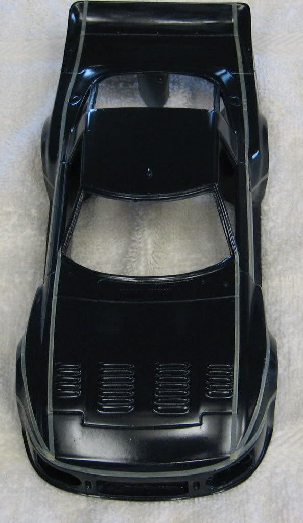

Got the taping lines marked down so I can figure out where the gold paint goes. Spent a couple of hours just on this. Not my favorite thing to do. One side of the car is a little off from the other side. They're not a mirror image of each other. One side is off by a .5 mm to 1 mm. I've run into this problem on other Profil 24 kits. Not an issue unless laying down striping. Here's the pictures of the body with the tape lines.

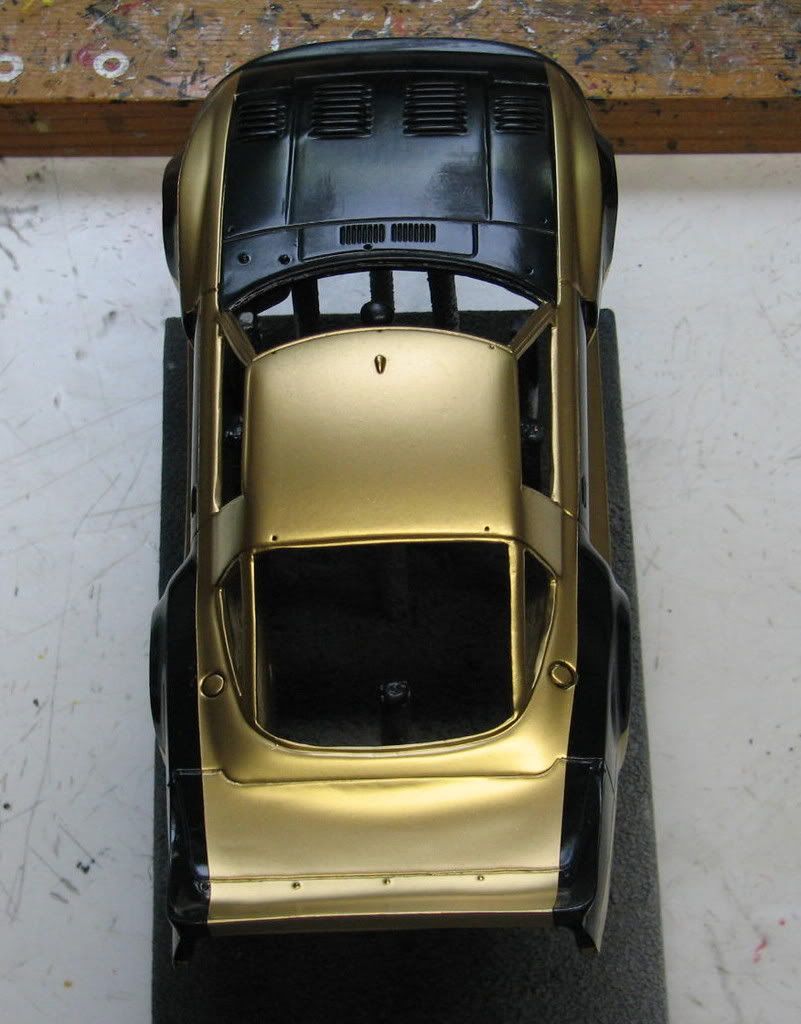

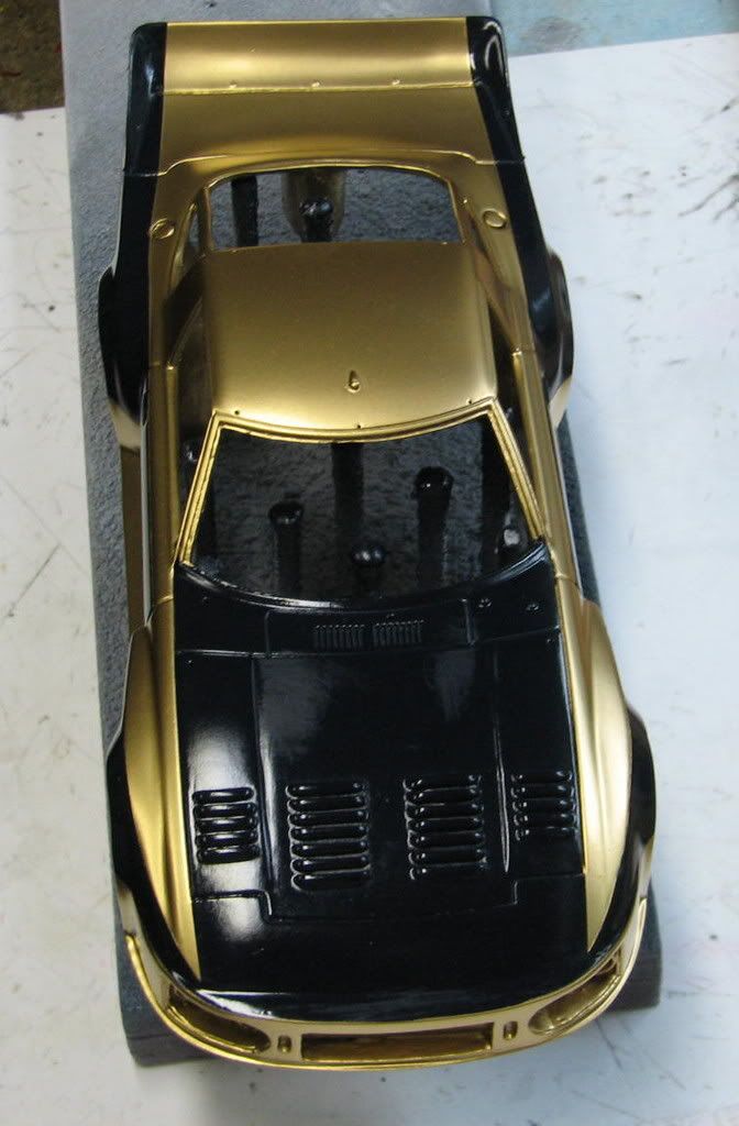

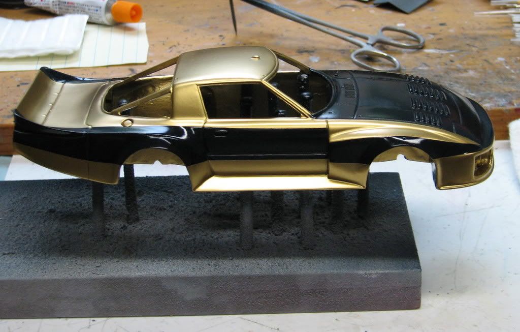

Well, it's gold! Little brighter than I would like. But I think it will tone down a little after I put a couple of coats of clear. Need to do a little bit of sanding; not much. Here's some pictures of the car.
Here's what it looks like with tires and rims on.
