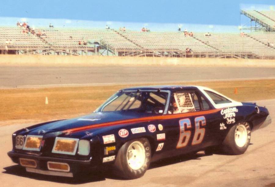

DoctorLarry Posted January 24, 2019 Author Posted January 24, 2019 Looked closely at the pictures. The car has stock frame and floor pans. It was not "clipped" in the front with a Holman Moody clip. Front bars and roll cage were added, shocks were added and the front sway bar was flipped and mounted above the frame. Looks like stock control arms and steering as well. This thing was REALLY low-buck! It was literally a STOCK car that had safety stuff added and then, as they say, went racin'. It has the stock cowl and firewall still welded to the body like it left the factory. The trunk was cut out and re-done for the fuel cell but this thing is really stock. How cool that they could run very competitively with professional racing teams with this car. Of course I will basically start over and save my current frame for another body. I made up a resin frame and floor pan for my Grand Am cars so I guess I will start over with that as well as my resin firewall. Good thing I made molds and copies of all the stock stuff! I have a new Pepsi Laguna that will sacrifice many of the other parts and another Elliot TBird chassis that will give up the truck arms and nine inch rear. Back to the table here. Interesting treatment of the rear spoiler as well. I always wondered why you saw squarish decals with 69 on the rear-the entire back of the spoiler was flat and covered up the rear tail lights. There is a shot with that panel off and you can clearly see the rectangular tail light openings. This is really cool and exciting (except starting from scratch, of course).
DoctorLarry Posted January 24, 2019 Author Posted January 24, 2019 It still has the stock steering column! The ignition lock is still in there. My respect for this team just went way up. No wonder people thought they were crazy.
DoctorLarry Posted January 24, 2019 Author Posted January 24, 2019 Can't tell from the pictures, but I would not be surprised if it had stock rear suspension as well. No evidence from interior shots of floor pan mods for truck arm mounts.

DoctorLarry Posted January 25, 2019 Author Posted January 25, 2019 (edited) Tim-any more pictures of that one? Mike-thanks for surfing the site and tipping me off. The pictures are amazing. There are over 100 shots and they show everything in detail except the undercarriage. My engine is inaccurate as well-their engine used a single plane intake like an Edelbrock Torker and a Holley Dominator. I had to order some resin carbs and will scratch build the intake. It looks like an earlier period car. I mean this thing is really stock-frame, firewall, suspension, dash, steering column and wheel, floorpans, everything. Edited January 25, 2019 by DoctorLarry forgot something

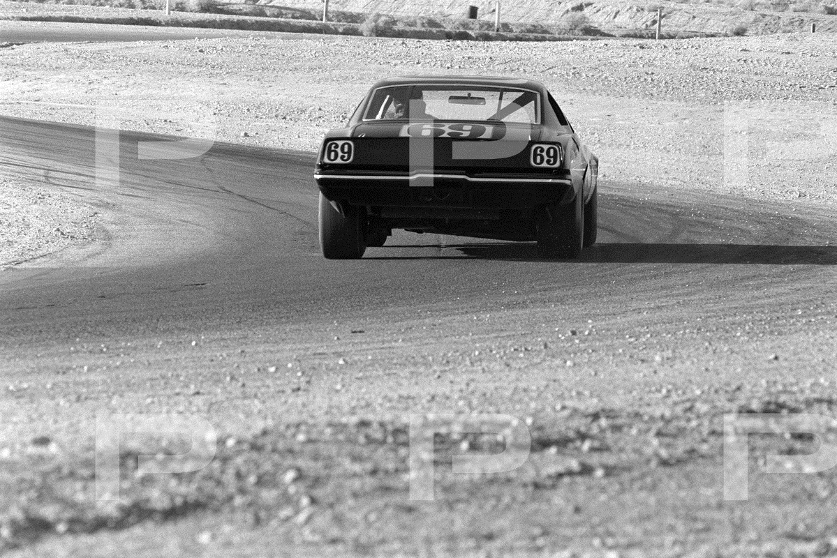

DoctorLarry Posted January 29, 2019 Author Posted January 29, 2019 I've been mining these archives and am still amazed at the "stockness" of this car. The only thing lacking is a detail shot of the rear suspension. There appear to be some sort of traction bars on the lower control arms and there are some reinforcing plates bolted to the rear seat area but it does not look like truck arms. Also can't see a Panhard bar or Watts linkage in the back to control side-to-side motion. I also can't tell whether it has a nine inch Ford rear or a GM rear so I will wing it on those details. The rest of the car has a ton of remarkably detailed pictures so I should be able to replicate it pretty faithfully.
DoctorLarry Posted January 29, 2019 Author Posted January 29, 2019 Photos courtesy of the Petersen Archives. Thanks to Swede 70 for the link as it has a ton of archival stuff.
swede70 Posted January 29, 2019 Posted January 29, 2019 Greetings Larry, If it helps, the Gray Ghost rear suspension was quite stripped down in relation to axle location beyond the rather standard looking four bar setup employed. Much stiffer bushings of whatever material employed took up a certain amount of movement or slop. No strict need for a Panhard rod, no additional trailing links, and certainly no Watts link was seen. A B.O.P. rear axle assembly was employed even as rules allowed the fitting of something other than this, hence it seems that it was both strong and reliable enough. Given the profusion of 'too stock to be believed' stampings and assemblies across the Grand Am in photos, I think I'd recommend the B.O.P. axle (being 'Buick, Oldsmobile, Pontiac') be employed. Some effort was made to alter the geometry of the pickup points of the arms heading back from my photos, while it seems by the time the Team Associates Grand Am effort was mounted, a diff. cooler was judged necessary. KONI shocks were seen then, but I'm really not versed or knowledgeable enough to suggest what was de riguer in Winston Cup NASCAR come 1973. I'll return to this post to plug in a few rear end images from the 1:1 unrestored car even as they might not communicate all you'd hope. Thanks... Mike K./Swede70
