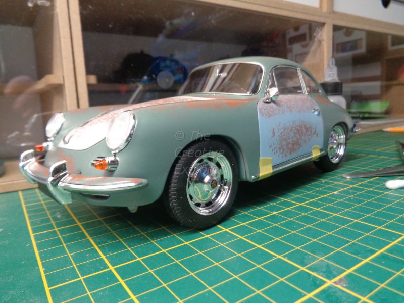

For the coupé, I use Vallejo Air rust as primary coat.
Toned with several shades of brown for some rusty effect.
For my very first time, I used the salt method to create some weathering.
But for the cabriolet, I used Zero Alpine blue for a nice sparkly paint job.
And the end-result, before the final coat. The Cabriolet will receive a 2K clearcoat and the Coupé a matt 2k clearcoat.
