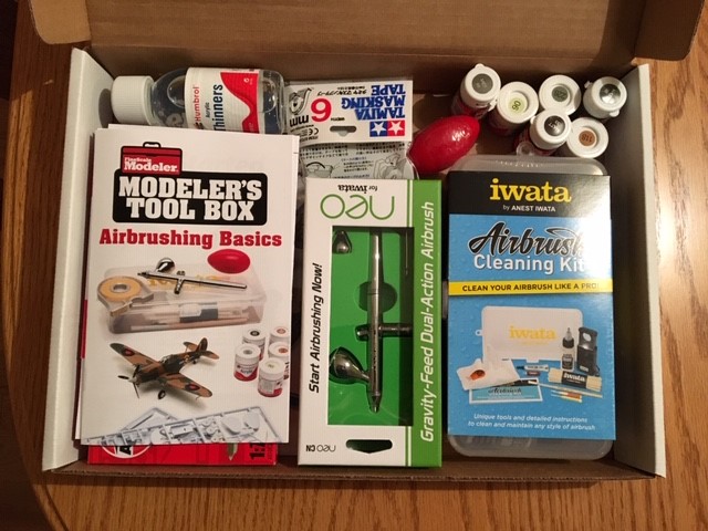

Well,  it showed up finally !
Nice package.   I'll be ordering the compressor this week so that hopefully this weekend I can start playing with it.
Good news ! Bet right about now you're wishing you already had that compressor.
