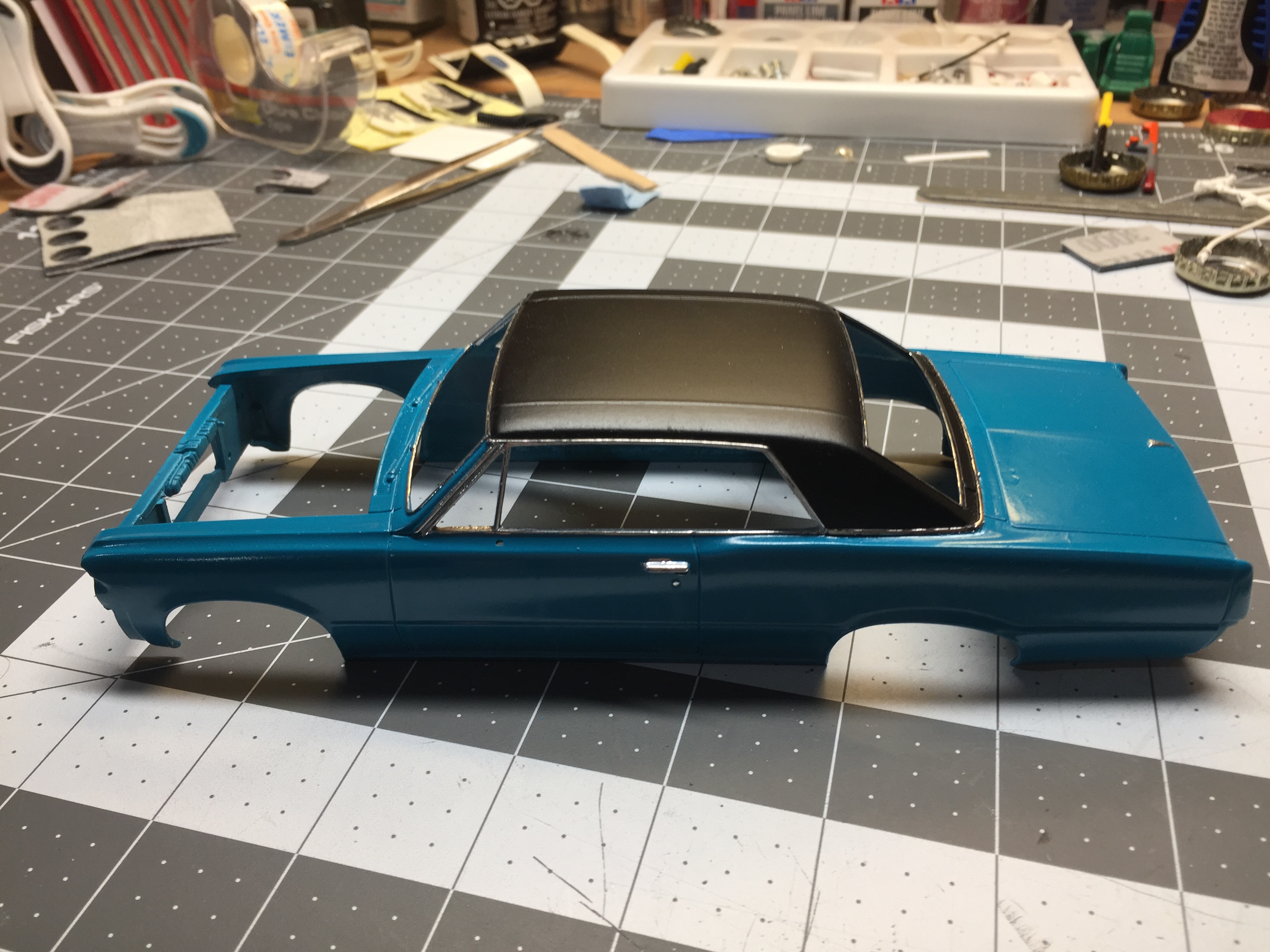

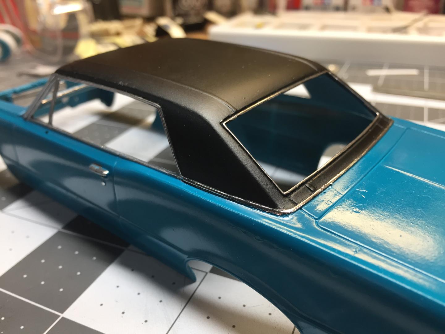

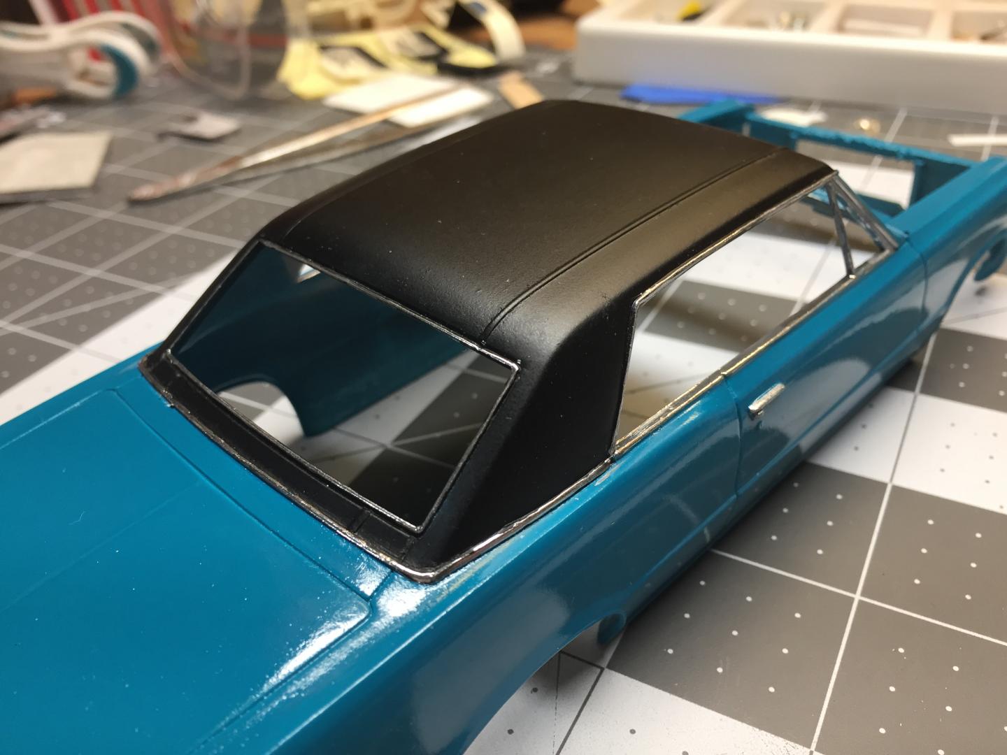

NOBLNG Posted February 4, 2019 Posted February 4, 2019 (edited) I have never done a vinyl top before, but I want to do one on a kit I am working on. I figured I would practice on this Polar Lights '64 GTO that I don't plan to build. It is now my test bed for new endeavors. On the driver's side I used .020x.030 strip, which I wound up sanding down to more like 0.010 thick. On the passenger side I used .030 half-round which I sanded down also (but not enough). The dividing trim is also .020x.030 strip. I first painted it with Tamiya semi gloss, but it was too shiny. I gave it a second coat with Tamiya Matt black, which I think looks better. It also picked up more texture with the second coat. The blue is just cheap Craftsmart premium acrylic with a coat of pledge over top. Edited February 4, 2019 by NOBLNG
Mr mopar Posted February 4, 2019 Posted February 4, 2019 Looks ok . try this use flat black in an airbrush and spray it 12" away from the model just to cover the roof with small bumps them use semi black , this is how I do mine .
ewetwo Posted February 4, 2019 Posted February 4, 2019 It looks great. I spotted a can of pick up truck bed protective spray and wondered how that would work.
Ich_Will Posted February 4, 2019 Posted February 4, 2019 6 minutes ago, ewetwo said: It looks great. I spotted a can of pick up truck bed protective spray and wondered how that would work. I'm guessing too thick. I thought about using a can of Plasti-dip for a vinyl top.
