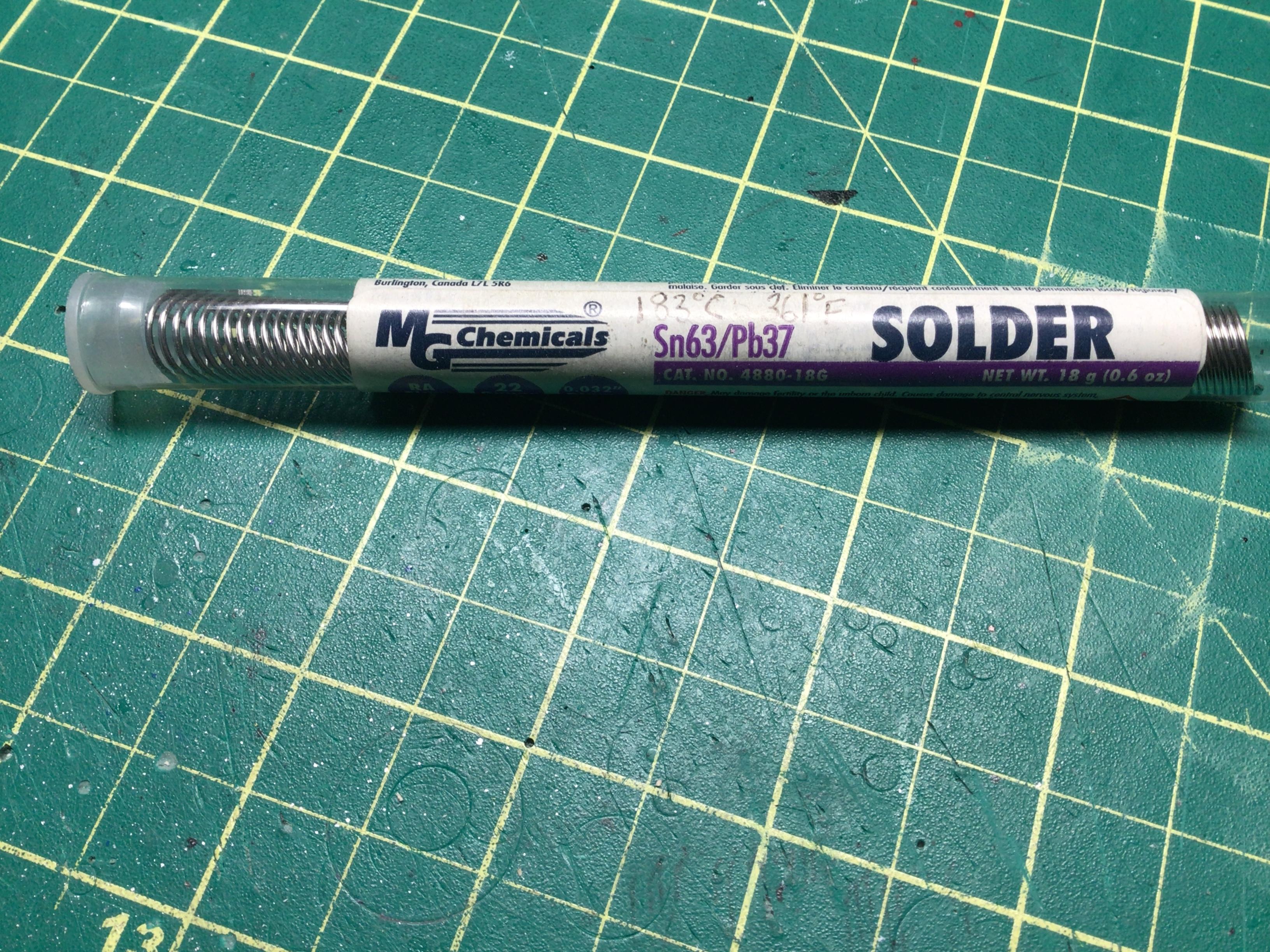

customline Posted November 26, 2024 Posted November 26, 2024 On 10/27/2024 at 4:27 PM, NOBLNG said: I have sharpened the trim scriber to a chisel point and used it to scrape a relief for window glass and posted it somewhere on here before I’m sure. But this is an easy upgrade. I took a short piece of coat hanger wire and sharpened it on both ends to a chisel point. Then soldered it to another piece of coat hanger. Now it can be chucked in a pin vise and used as an inside scraper or an outside scraper. Being chucked in a pin vise makes it far easier to handle. The width and profile can be filed to suit your needs.? Greg, what are you using to solder steel, silver?
NOBLNG Posted November 26, 2024 Author Posted November 26, 2024 (edited) 1 hour ago, customline said: Greg, what are you using to solder steel, silver? This. I clean (sand) the parts well and use a bit of flux. I think I used rosin flux. I was surprised how well it worked. Edited November 26, 2024 by NOBLNG
peteski Posted November 26, 2024 Posted November 26, 2024 The 63/37 solder is a standard eutectic solder which has been used for electronic component soldering for many decades (until the lead had to be eliminated from solder for environmental reasons). I still use it for all the electronic part soldering because it is eutectic, and has a relatively low melting point, but it is not a very strong solder. Silver bearing solder is much stronger. Flux is vital for good solder joints but rosin flux is not very aggressive. If it worked for Greg, that s great. For soldering harder to solder metals I use acid-based flux like Tix Flux which is based on Zinc Chloride. It makes soldering steel much easier. Of course the soldered areas have to be well cleaned first.
