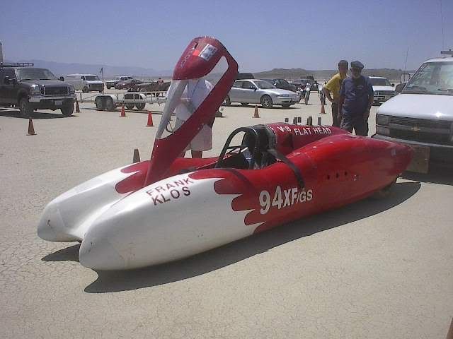

Awesome looking Scott! I love it. Chassis looks very good and the body, while not something I would have thought of, winds up very sleek and cool. It is similar to my buddy's streamliner with body by Jocko (see below). What is the canopy from? Is it of your sculpting?

Richard, Jocko is one of my favorite hot rod heros. The land speed car of your freind is killer! I occasionally take a trip to El Mirage. Maybe I,ll see that car. The canopy is my own design. The shell is two Aerotech fenders mated together and rehaped to reflect the inset "spear" on the side of the car. The black windshield is a buck used to shape the clear windscreen below. I made it from some old Squadron Thermoform. Heat until soft and pull down over the buck. This shot is before final trim and polishing it to clear again with a paint polish kit. I've been told that if you use a good hairdryer to heat the plastic it will not fog.
