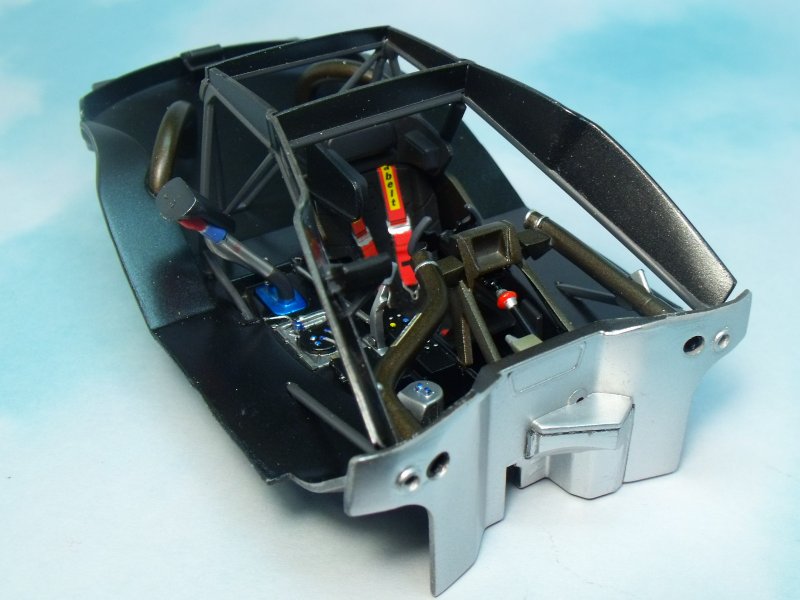

935k3 Posted May 3, 2019 Posted May 3, 2019 (edited) I have been using some of their metallics. There are very good and handle an mask well. I think they are lacquers. I thin them with acetone. I think I read they coming out with a line for model cars, they are mostly railroad colors. The firewall in the pic is their aluminium. Check out their website Tru-Color Paints Edited May 3, 2019 by 935k3
aurfalien Posted May 3, 2019 Author Posted May 3, 2019 Hi Dale and thanks for the reply. That pic is cool. I've been looking at there paint chips for automobiles which total about 144 colors in all. That's a combo of solids, pearls and metallics. However the paint chips are some what useless due to how a web site displays colors, how your screen displays colors and how a printer displays colors. So I've been looking up several images of cars painted with there respective colors to get a good idea of what they are supposed to look like. At any rate they seem very interesting.
