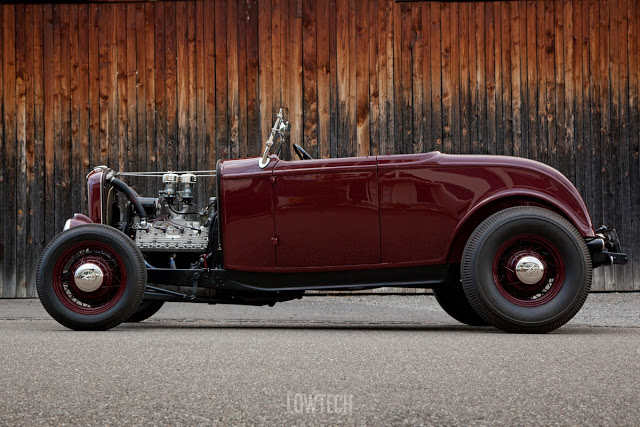

The forth, is the car I started with for photo shop.

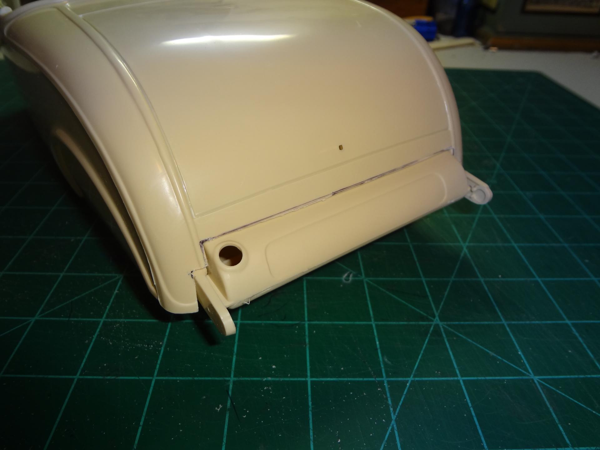

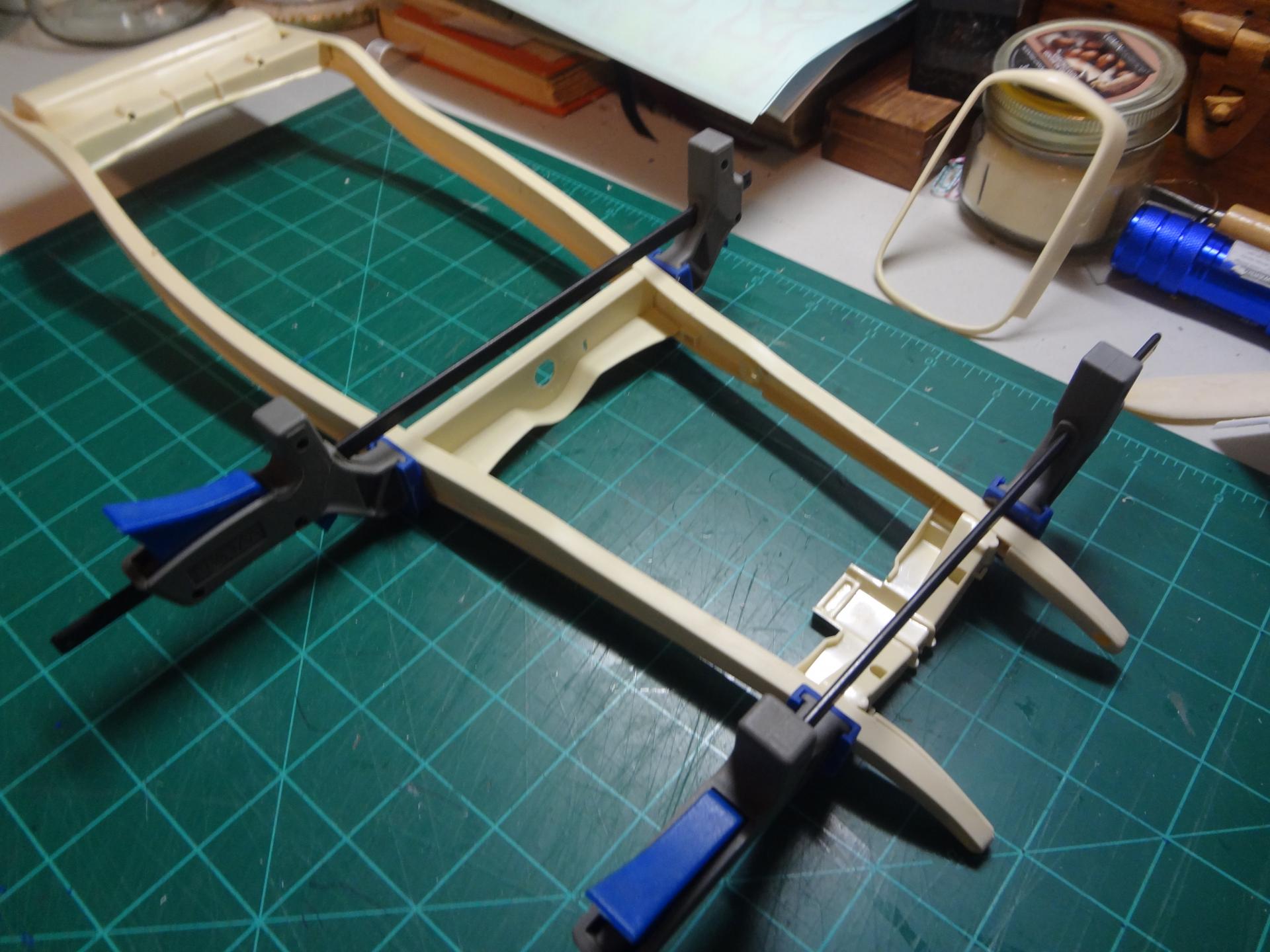

I have started with the frame , I am keeping the stock tank. Cut the rear to drop the body over the frame and tank. I got the idea from another member, I have forgot his name and can not fined the post. If it's you let me know so I give credit where credit is dew. Started removing chrome. on select pieces. I think all chrome suspensions to much, so just painting some parts to give it some contrast. Going with the stock wheels and caps, may us the moons painted I don't know.

Cool project. Just FYI...you're going to have to "zee" the rear of the frame considerably to get the stance in your rendering, and either fabricate a front axle with more drop, or raise the front crossmember, trim a few spring leaves out, and notch the front frame rails to clear everything.
Edited by Ace-Garageguy
Thanks for the info on the moons out they go. I se what you mean about the frame. I just grabbed a car the right color and dropped it not realizing they had dropped their frame. "DOP! " Well I am going to keep the frame on this one stock and just channel it. I have a tendency to over do models, get in over my head and put them in the closet. So it's "kiss "for the frame. The channeling I can handle.

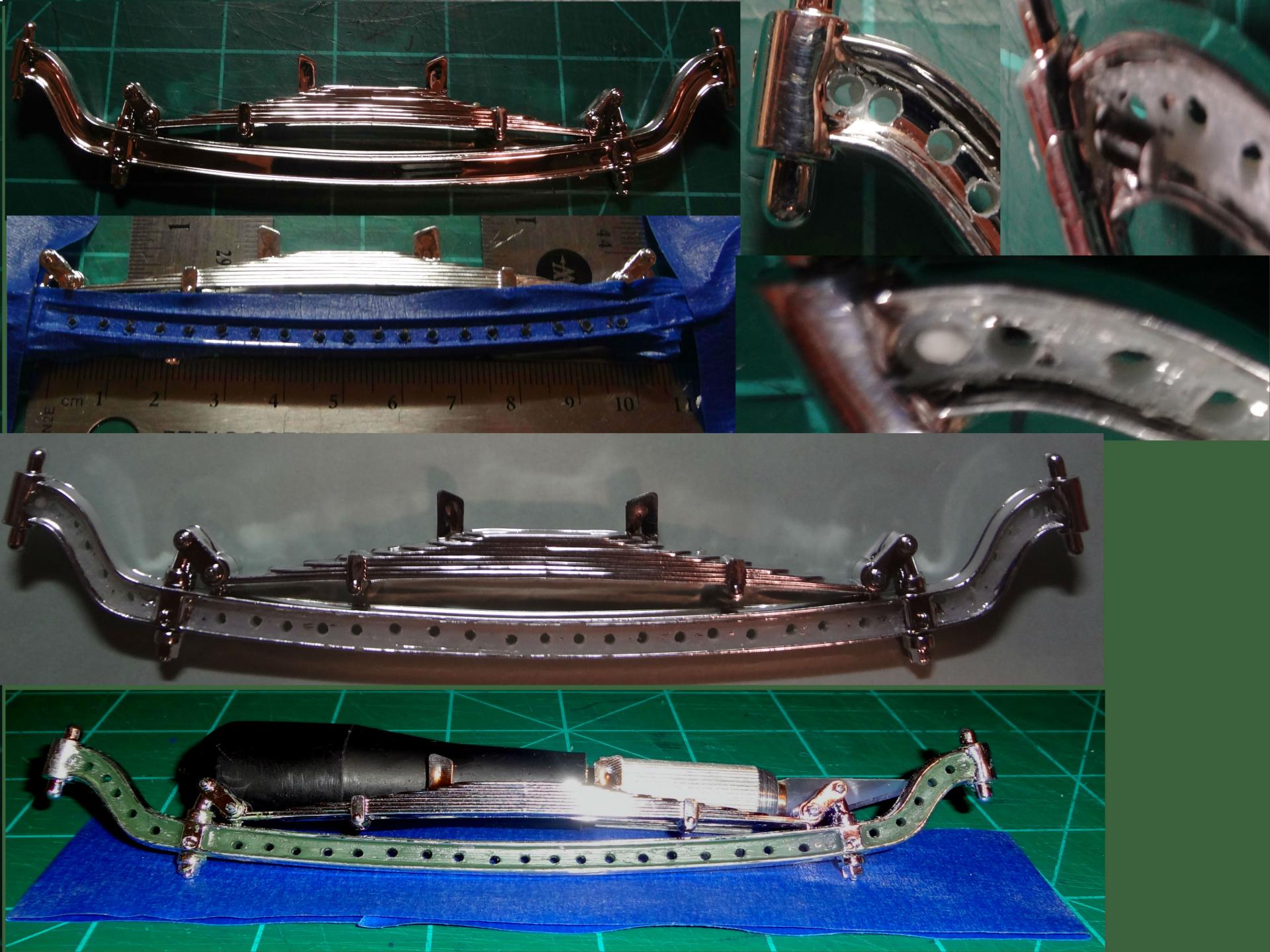

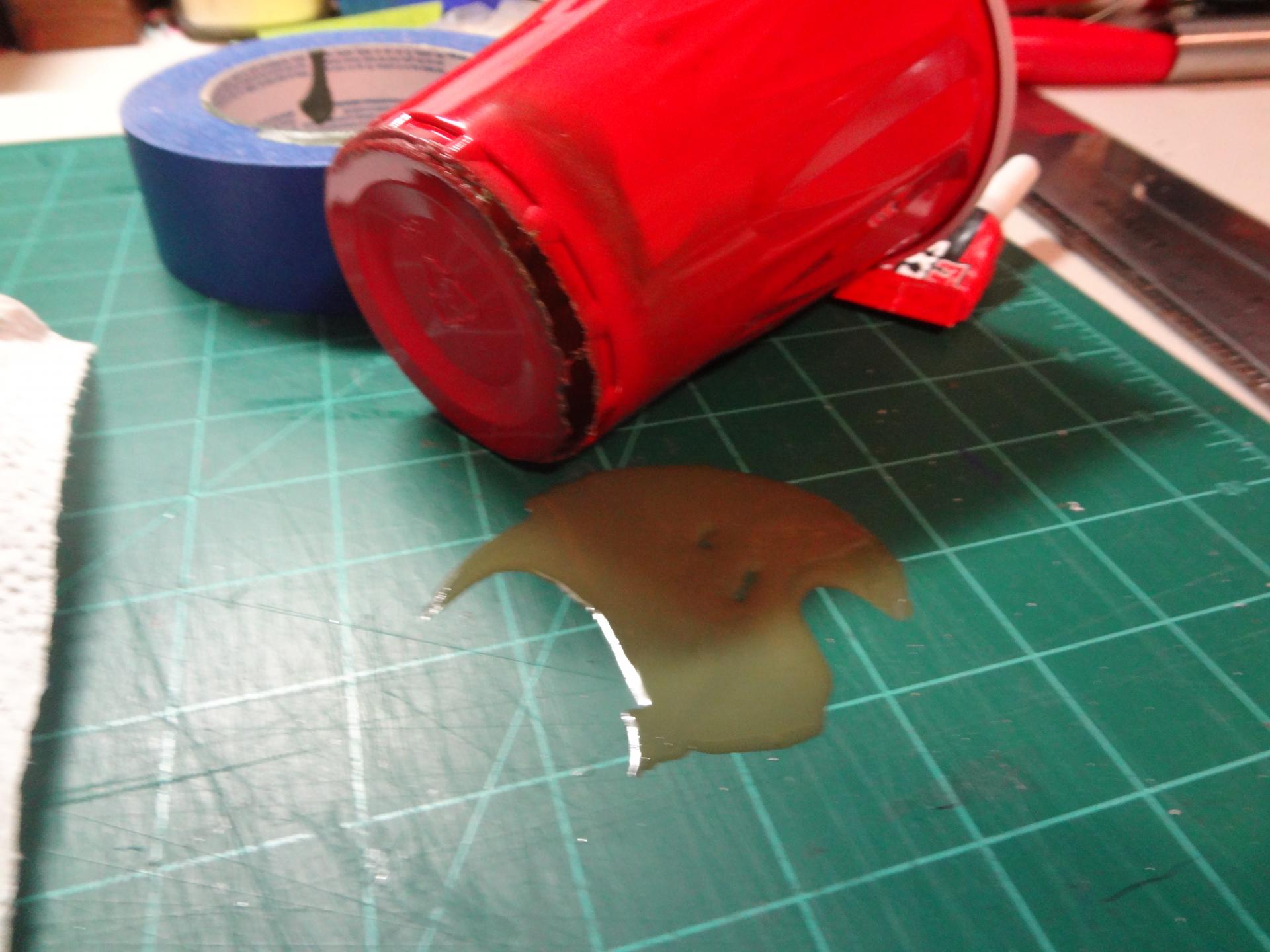

     I not going to post every little part I do, but I am pretty proud of this axle. The holes are not perfect but the center ones will covered by the lowered grill any way. Boo booed on the last hole on the end, started it in the right spot. Stop for the wife, then when I restarted I put the bit in the wrong spot. Had to fill and sand it, but it came out alright. And the last pic is a life lesson on krylon paint, I am a rattle can guy so I spray into a cup when I need body color for small parts I want to brush on. I had the cup sitting tilted in a tape ring, I thought the paint was drying fast, till I picked up the cup. DOP!!!
