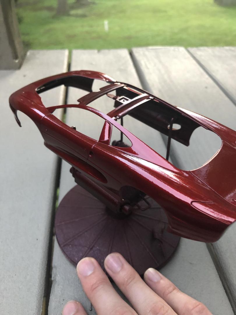

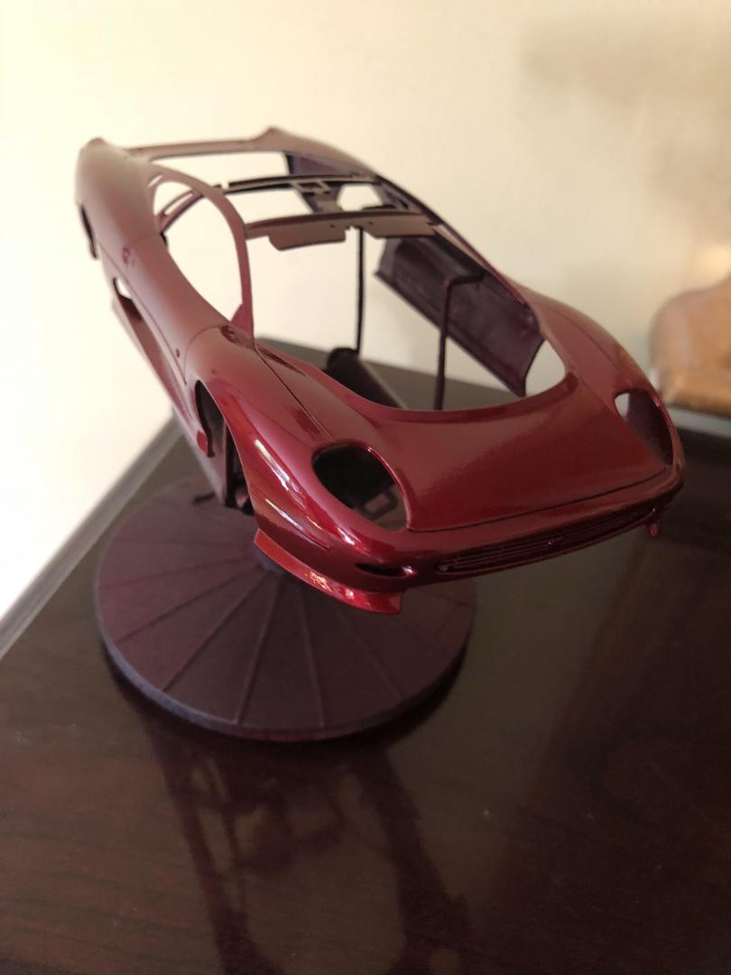

jjsipes Posted July 15, 2019 Posted July 15, 2019 What base color have you all used for Mica Red if any? I have tried a Bright Red base with good results. Black has worked good as well to darken the Mica Red some. But, was wondering if anybody has tried an Orange as a base color? I'm looking for something a little brighter for a project without going into the House of Colour paints. I know some colors are affected by the base color that you use.

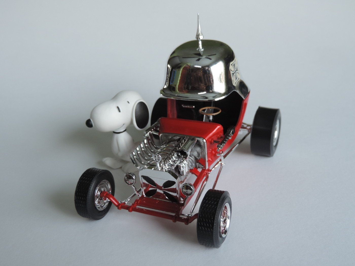

High octane Posted July 18, 2019 Posted July 18, 2019 I've used Tamiya Mica Red as a base coat for their Translucent Red and got a nice color for my Monogram Red Baron kit.
