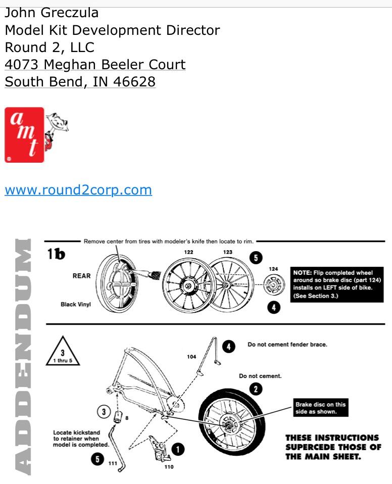

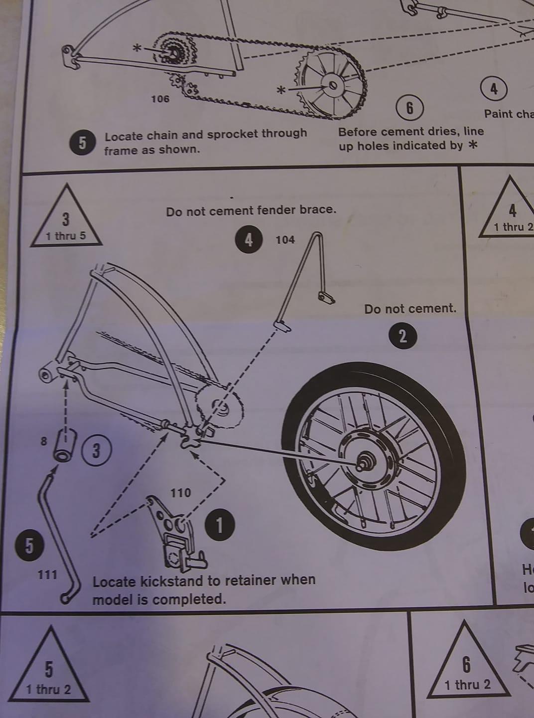

Ben Posted August 15, 2019 Posted August 15, 2019 Just a heads up if you’re intending on building any of the three MPC Classic Krate kits. The instructions show the rear wheel being installed backwards. The slotted disc (chain guard) goes on the right side of the bike. The solid disc (disc brake) goes on the left side.
Ben Posted August 15, 2019 Author Posted August 15, 2019 I contacted Round 2 to let them know and they drew up an addendum. It was incorrect in the original instructions as well.
tim boyd Posted August 18, 2019 Posted August 18, 2019 On 8/15/2019 at 1:58 PM, Ben said: I contacted Round 2 to let them know and they drew up an addendum. It was incorrect in the original instructions as well. Thanks Ben and John. That is a highly surprising and super-quick turnaround on John's/Round 2's part. TIM

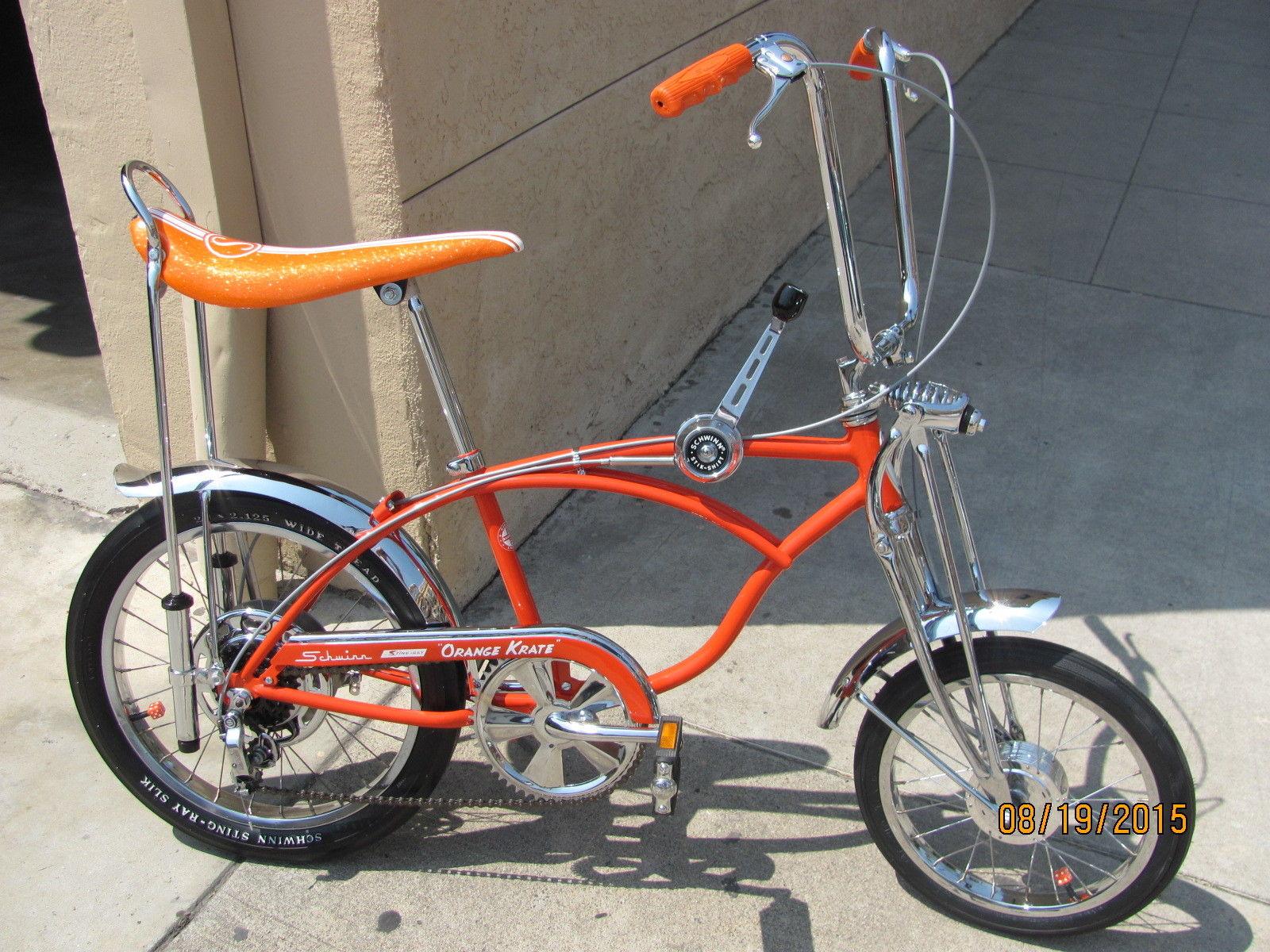

Trendsetta68 Posted August 23, 2019 Posted August 23, 2019 On 8/15/2019 at 8:19 AM, Ben said: Just a heads up if you’re intending on building any of the three MPC Classic Krate kits. The instructions show the rear wheel being installed backwards. The slotted disc (chain guard) goes on the right side of the bike. The solid disc (disc brake) goes on the left side. Awesome reference pic ... and great info, thanks !
