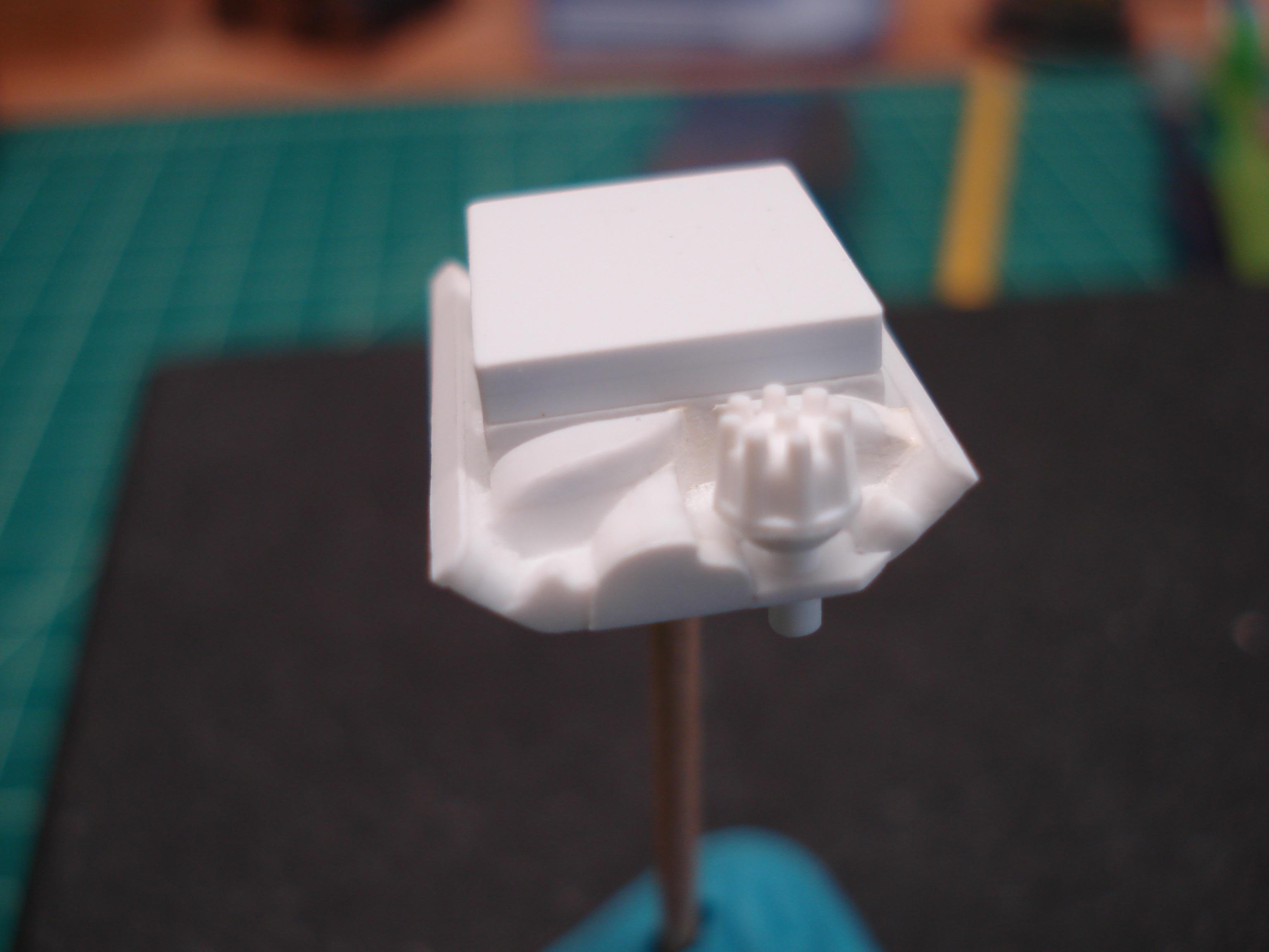

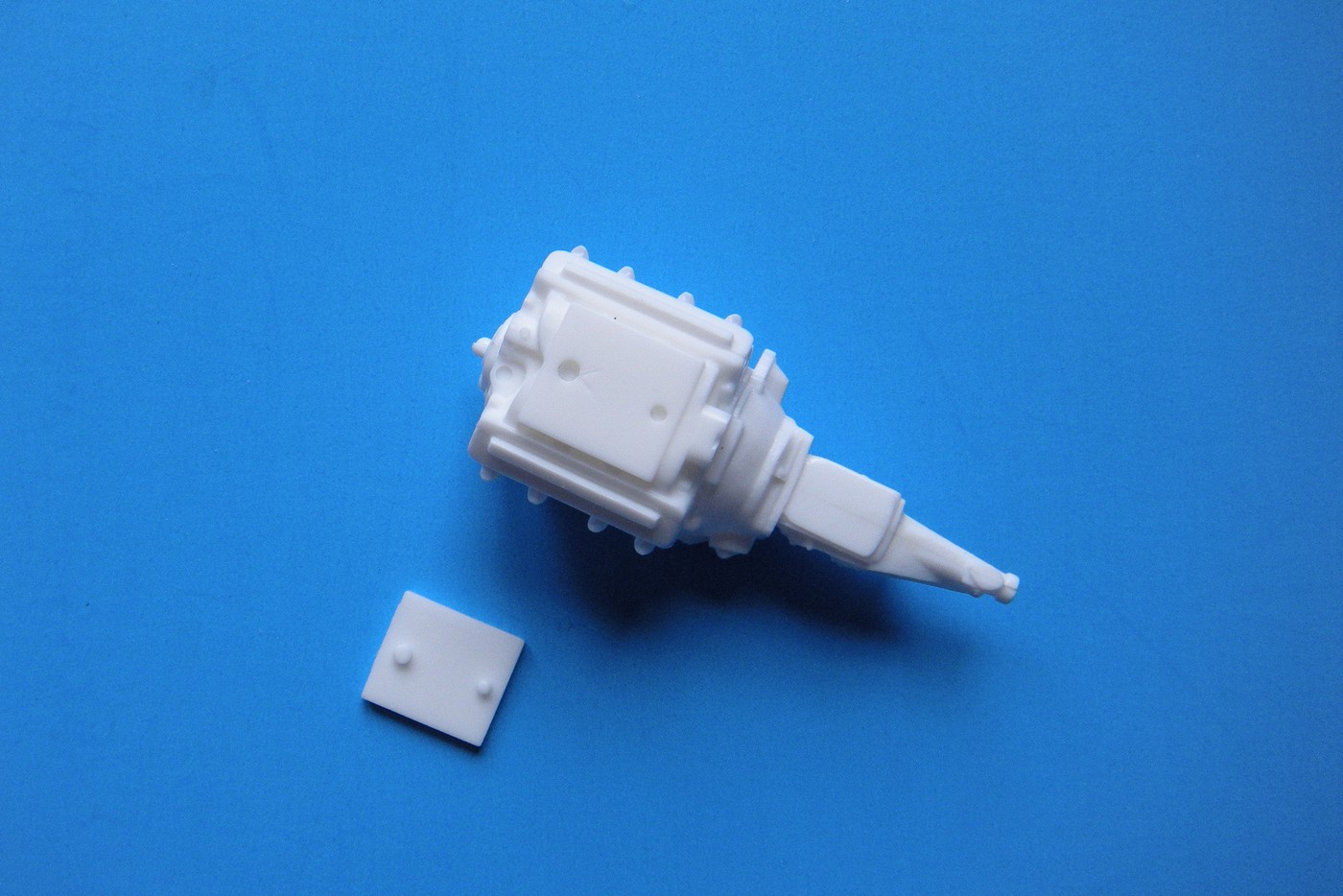

STYRENE-SURFER Posted October 23, 2019 Author Posted October 23, 2019 Still working on this M/T blower manifold. Still more details to add in. Just wondering if anyone with experience creating parts to cast could give me some tips. New territory for me. Ive been in contact with a resin guy you probably all know. He's willing to cast it for me and so far one other interested party here on the forum.

STYRENE-SURFER Posted October 23, 2019 Author Posted October 23, 2019 13 minutes ago, ScottH454 said: What are you needing advice on? It is a good idea to make resin copies with the amount of work your putting into this part. That in my opinion is why we cast parts. My tip from reading your last post is make sure who you get to cast this part is good at what they do. You can find action-modeler on facebook to see my experience. Scott... I do have a reputable caster that is interested in casting this. Probably one that most here know well. Although that is just for one interested forum member here so far. I'm trying to make this worthy enough that others might want one. That is why I've asked the questions I have,( still would like to know) in the hope that perhaps more knowledgeable/critical eyes can help. You don't have to be afraid of letting me know what you think might need some attention. Lay it on me. I am also wondering how it should be finished, Primed or just raw styrene. ?

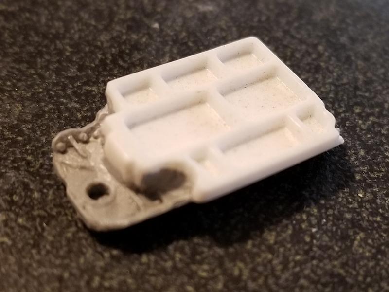

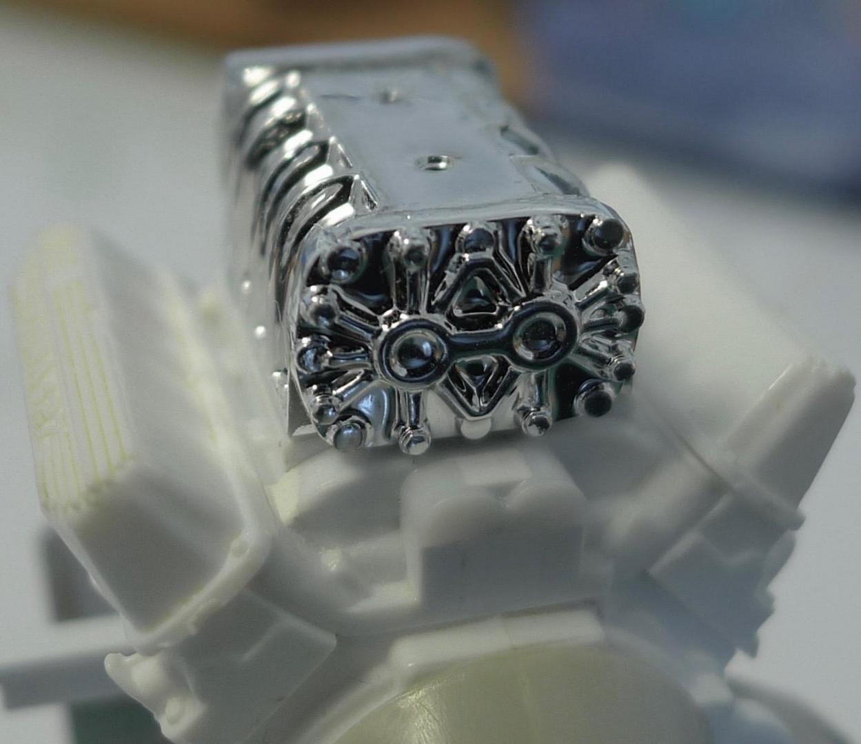

ScottH454 Posted October 23, 2019 Posted October 23, 2019 From what I could see in your latest picture your on the right track for how it's done. You still needed so smooth out the runners an other seems. Drill holes in the runners to slide rod polystyrene up from the bottom to create bolt tabs. I even drill into these to give the open bolt hole. Just find reference photos an mimic as much as you can. I use liquid Tamiya primer brushed over the seams to fill imperfections, never want to prime the whole thing at that point. Once everything looks ready then a light coat of Tamiya primer gives it a uniform an in this case a textured cast finish. I'll share a photo of my BBC intake master, the kit intake I started with is light gray so you should be able to see the white styrene that was added. Then a blower intake master I made for with two resin castings. One of the benefits of being a caster is making parts for the sole purpose of having an extra so you don't mess up your original.

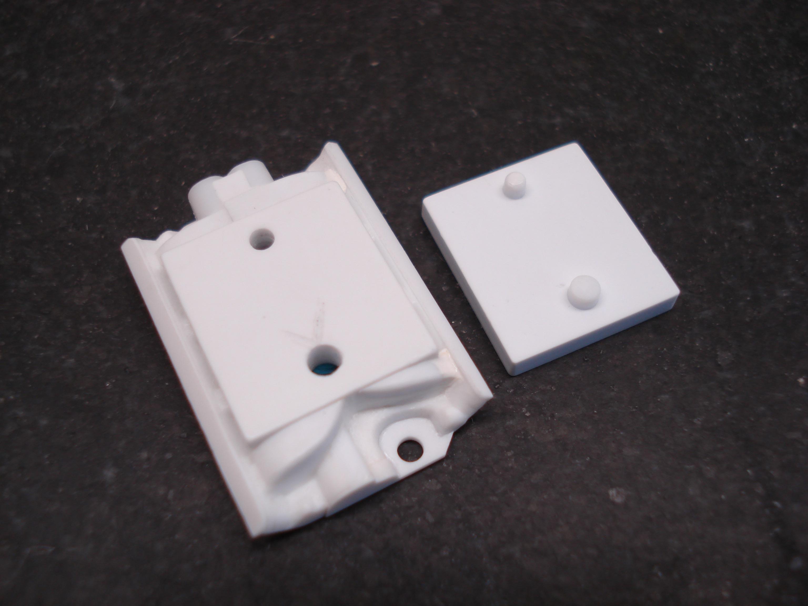

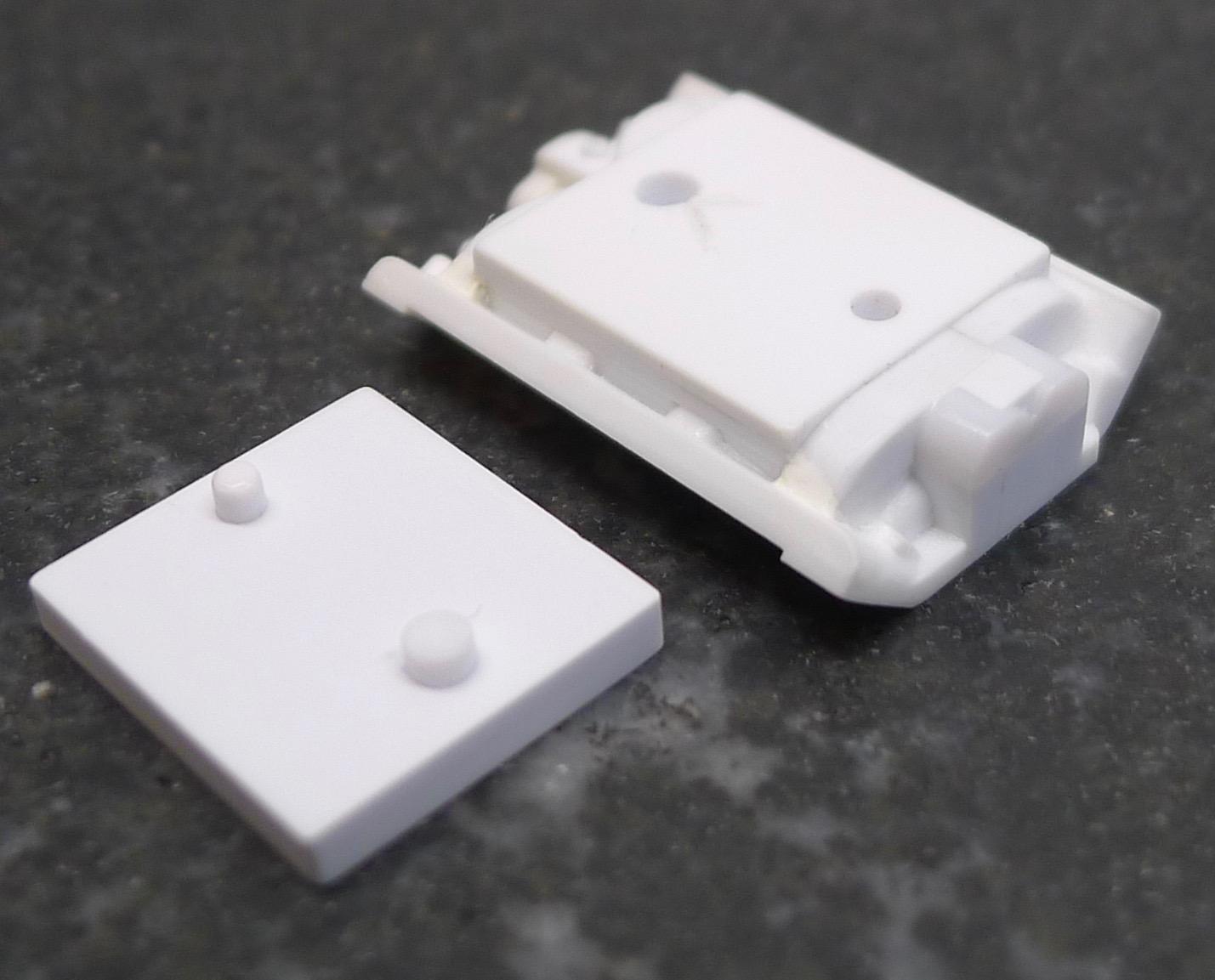

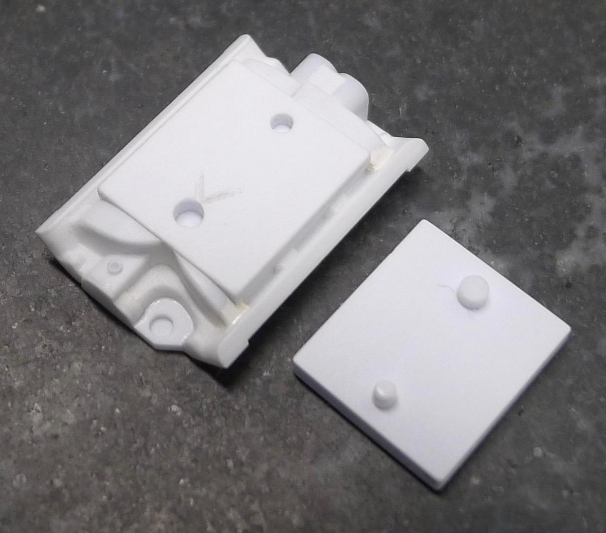

STYRENE-SURFER Posted December 3, 2019 Author Posted December 3, 2019 This manifold is just about finished, some final seam filling with thin CA applied very carefully and shaping where necessary. Made a 2" scale spacer so the distributer can be used in the normal placement. Have seen a couple of "pop off valve" set ups for this type of manifold so decided to leave that detail out. I was playing around with the thought of adding the FORD script. That tiny piece of photo etch I was attempting to use ended up lost for ever on my hobby room floor.

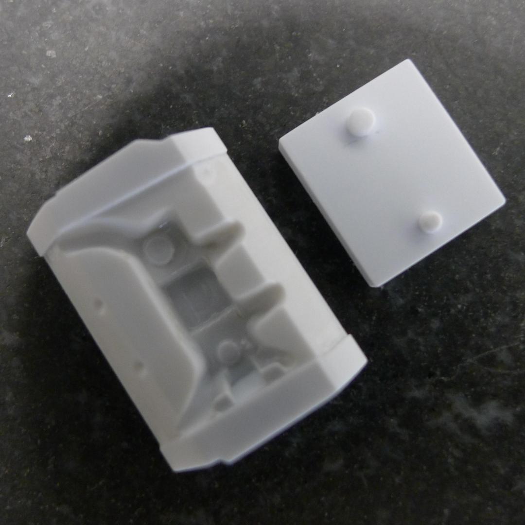

STYRENE-SURFER Posted February 15, 2020 Author Posted February 15, 2020 First parts have come out of their molds (not by me). Have been sent a picture of one of the first casts by a member here. I don't think I can post it here (didn't take the pic and not sure if it's ethical to do so at this time). Don't even know if there is any interest. It was a fun project and now have to start on that timing cover.
afx Posted February 16, 2020 Posted February 16, 2020 (edited) The first castings do indeed look very nice! And fits like glove. Edited February 16, 2020 by afx
