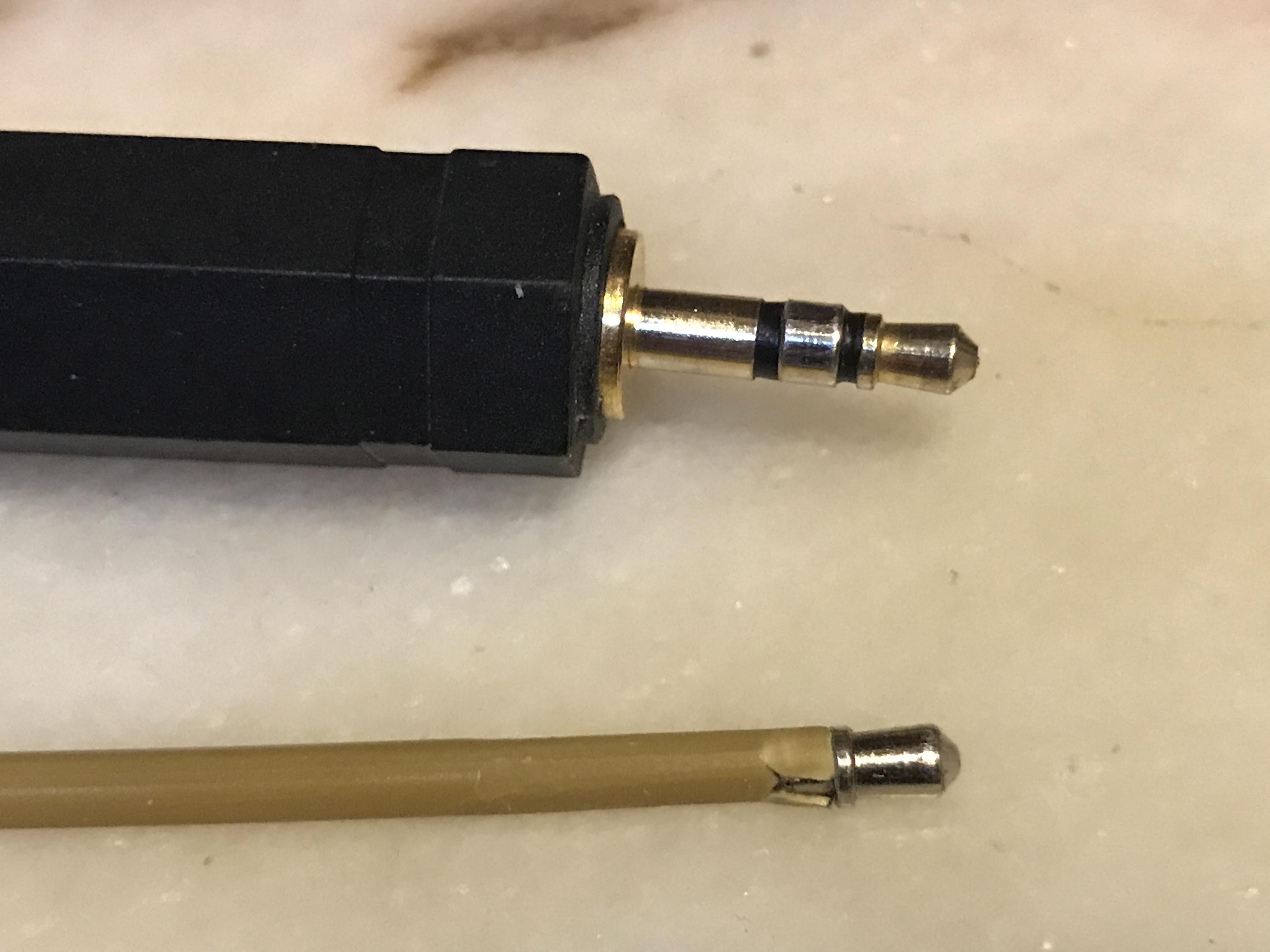

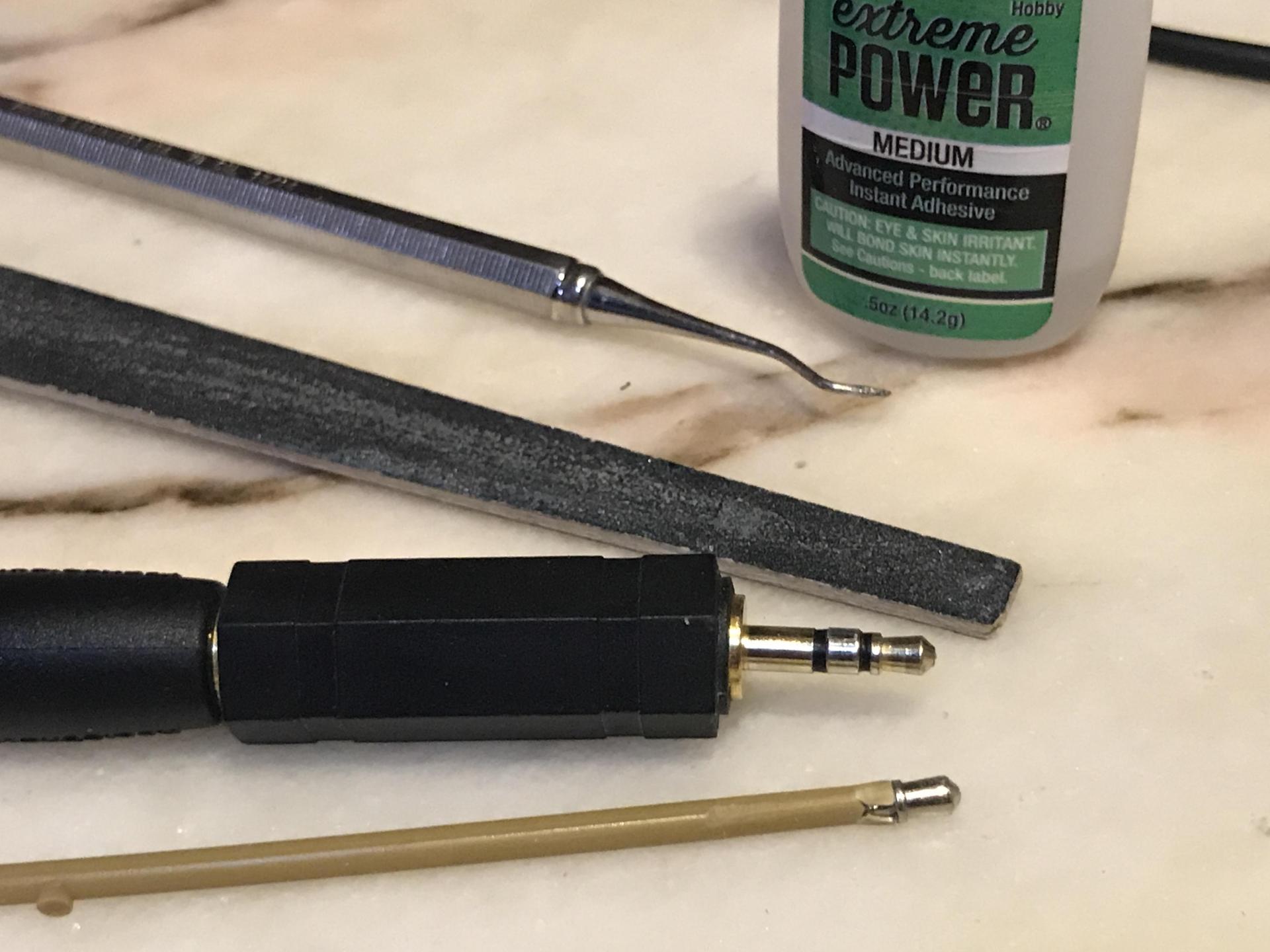

Wife said her laptop sound wasn't working, and couldn't plug in the cord for the speakers used for her job.  I tried to plug in my cord, obvious that it wouldn't.  Looked in the hole, looked in my laptop's hole, then I could see a tip had come off.  Eyeballed the size of the stub, went to the workbench.  Used a sprue, drilled a hole in the end.  Came back, dabbed some superglue in the sprue hole, stuck it in the hole.  At that point, wife said we better find a YouTube video about how to pull that out, found a dude who used a soldering iron and copper wire, said "it should be a variable voltage type" (yea everyone has one of those), "just get a little solder on the end, then carefully" ..... I'm sitting, giving her a funny look .... "oh yea be sure it's not under warrantee and turned off" .... I have one of those grins, she's looking worried ....... "and if it is, just have them do it" ........ she's looking at me, worried about the glue ......... "and if it doesn't work the first time, just add more solder on the end" ........ I start giving her $#i* and laughing ......... "but here is one that worked!"  Figured that was enough time for the glue to have set.  I rise from the Lazyboy, stroll over to her laptop, carefully grab the sprue with both hands, gently pull out (I couldn't cross my fingers, so had an exaggerated grimace ?), and what do you know!  ?
