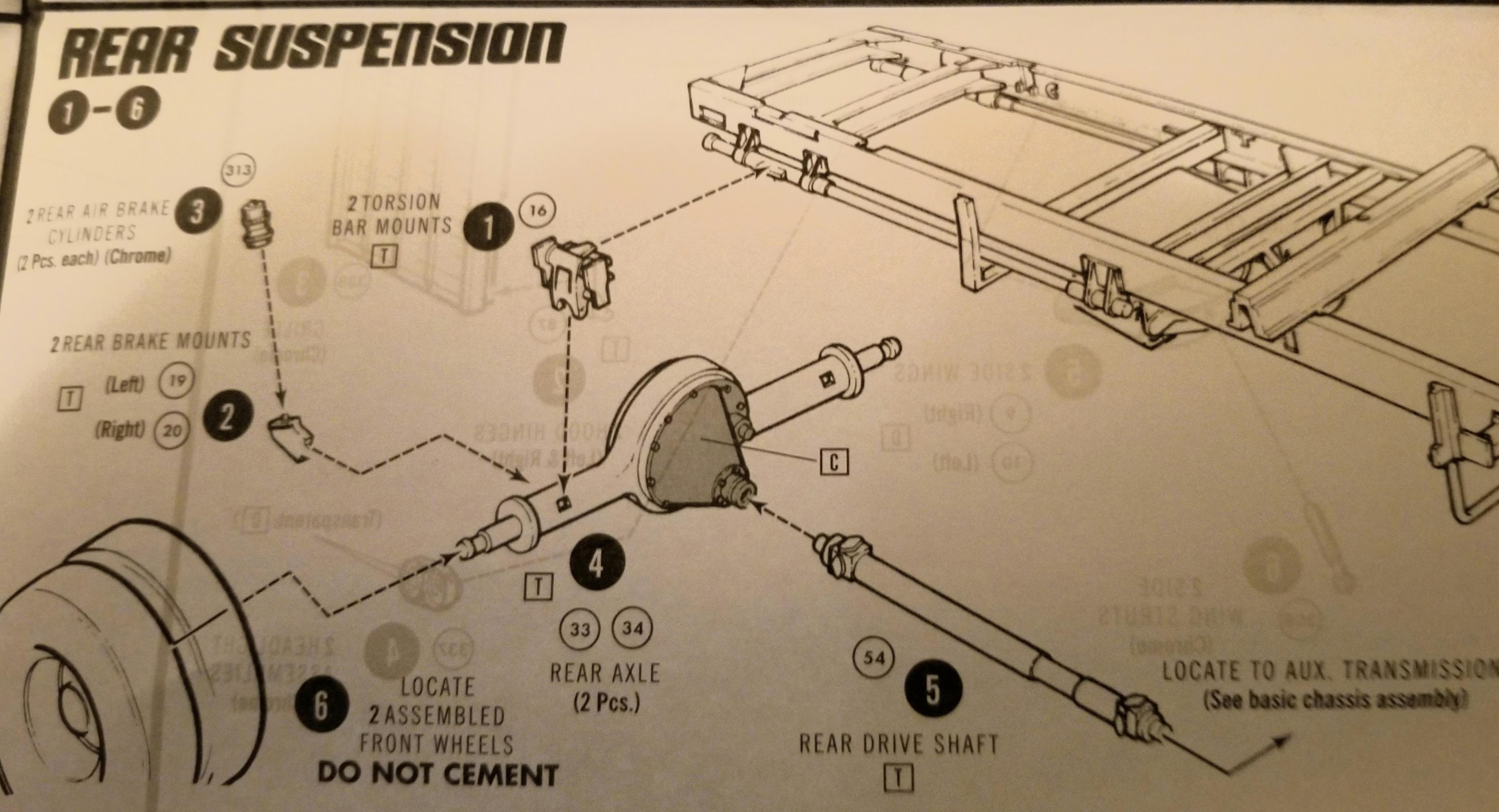

Fat Brian Posted September 22, 2019 Posted September 22, 2019 Here is the main panel of the instructions for the rear suspension of the Super Boss. The kit had the cranks on the outside of the frame toward the rear so you'll have to swap them to the inside and sand off the mounting tab. The axle is also round so finding a match for it with a power divider will be tough. Overall it looks pretty simple to do the conversion, you'll just need a spare set of matching axles or at least a leftover power divider and a driveshaft for the rear axle.
DrKerry Posted September 22, 2019 Author Posted September 22, 2019 7 hours ago, Fat Brian said: Here is the main panel of the instructions for the rear suspension of the Super Boss. The kit had the cranks on the outside of the frame toward the rear so you'll have to swap them to the inside and sand off the mounting tab. The axle is also round so finding a match for it with a power divider will be tough. Overall it looks pretty simple to do the conversion, you'll just need a spare set of matching axles or at least a leftover power divider and a driveshaft for the rear axle. Good info to use, I saved the pic for reference! I have a built Boss but don’t really want to pull it apart for parts. Mine is a salt flat rig I built over 20 years ago.. info below is what Hakan put up about the axles. They come out of KW kits and may not be to difficult to find! On 9/17/2019 at 10:58 AM, Force said: Yes that would most likely work for the forward axle, if you cut the second torsion bars and turn them around so you get the links on the inside for the rear axle it would probably look okay. If you have the AMT W925 or a K123 you can use the axles from them as they are clean without any mounting points, because you need a power divider for the forward axle and drive shaft between the axles. You can use the AMT W925 to do the movie truck, at least one of them was a 1973 so some slight modifications needs to be done to the cab such as door handles and vent windows, or you can use a Revell Germany W900 with a short hood and short sleeper, or modify the Revell snap W900 Aerodyne to a day cab with a short sleeper from the AMT kit. I think the engine in the movie truck was a Cat 1693.
