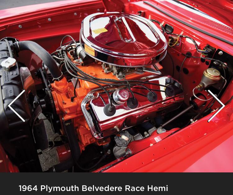

gtx6970 Posted September 29, 2019 Posted September 29, 2019 (edited) On 9/23/2019 at 11:26 AM, gtx6970 said: 1964 hemi hardtop. ,original car Edited September 29, 2019 by gtx6970

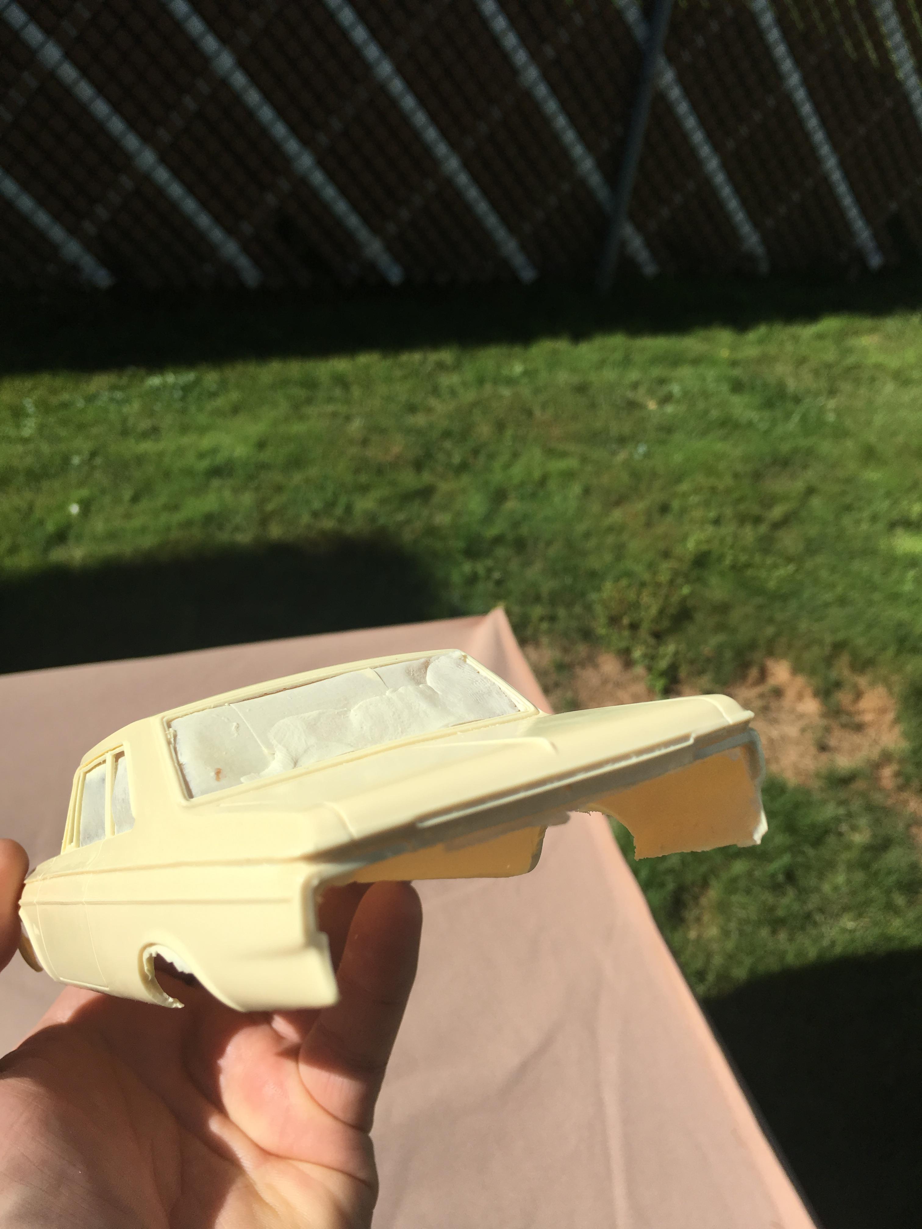

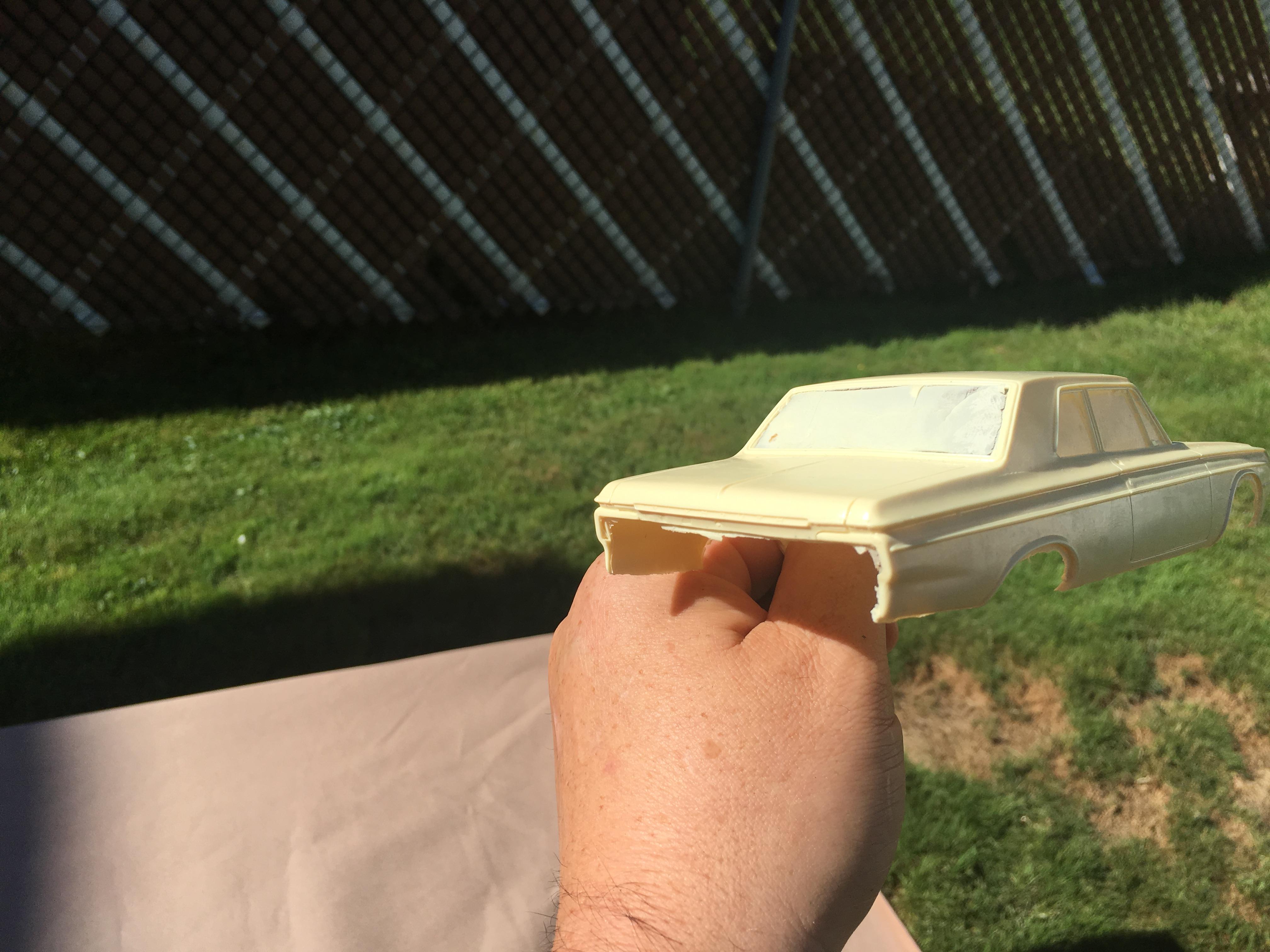

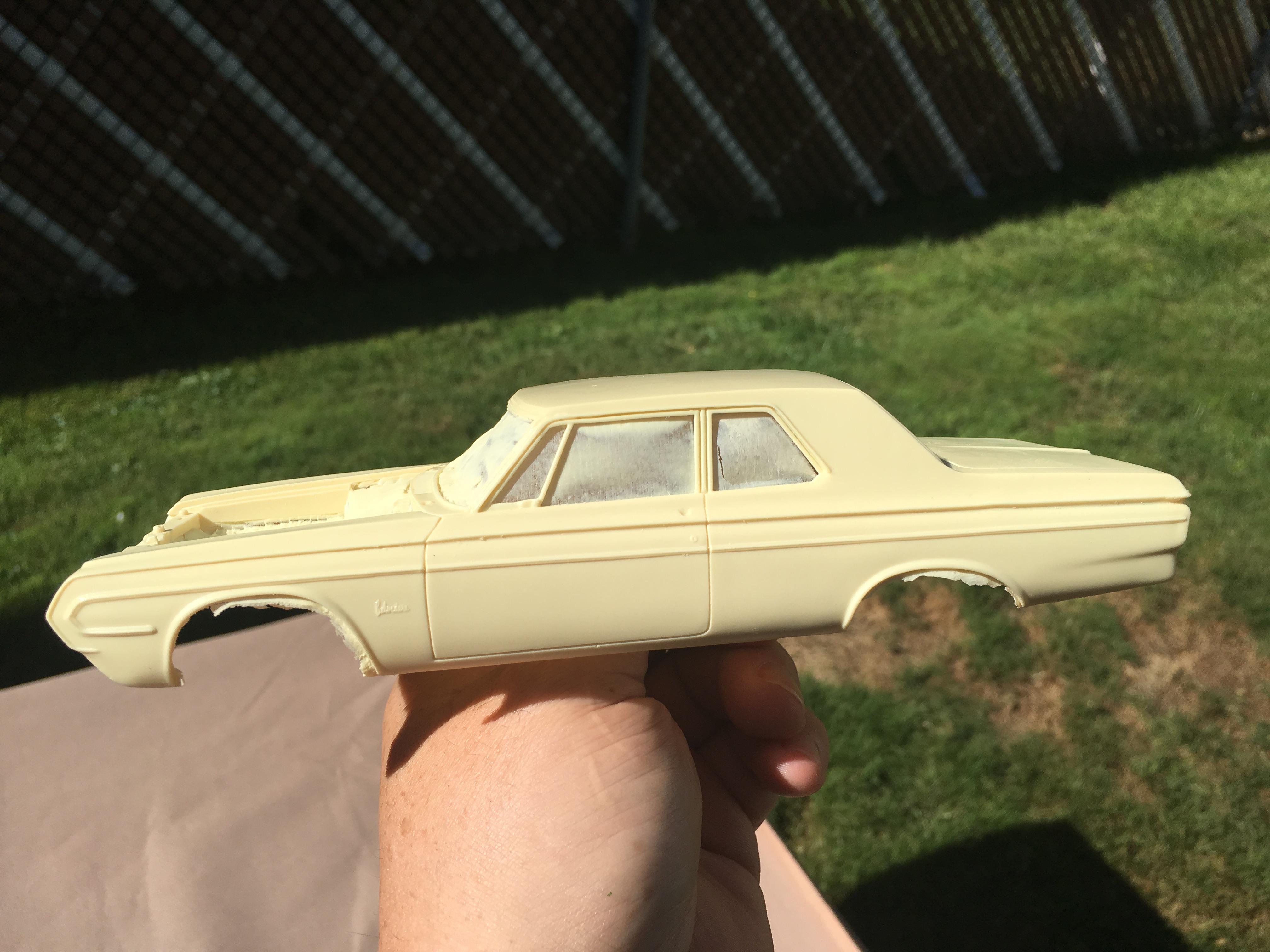

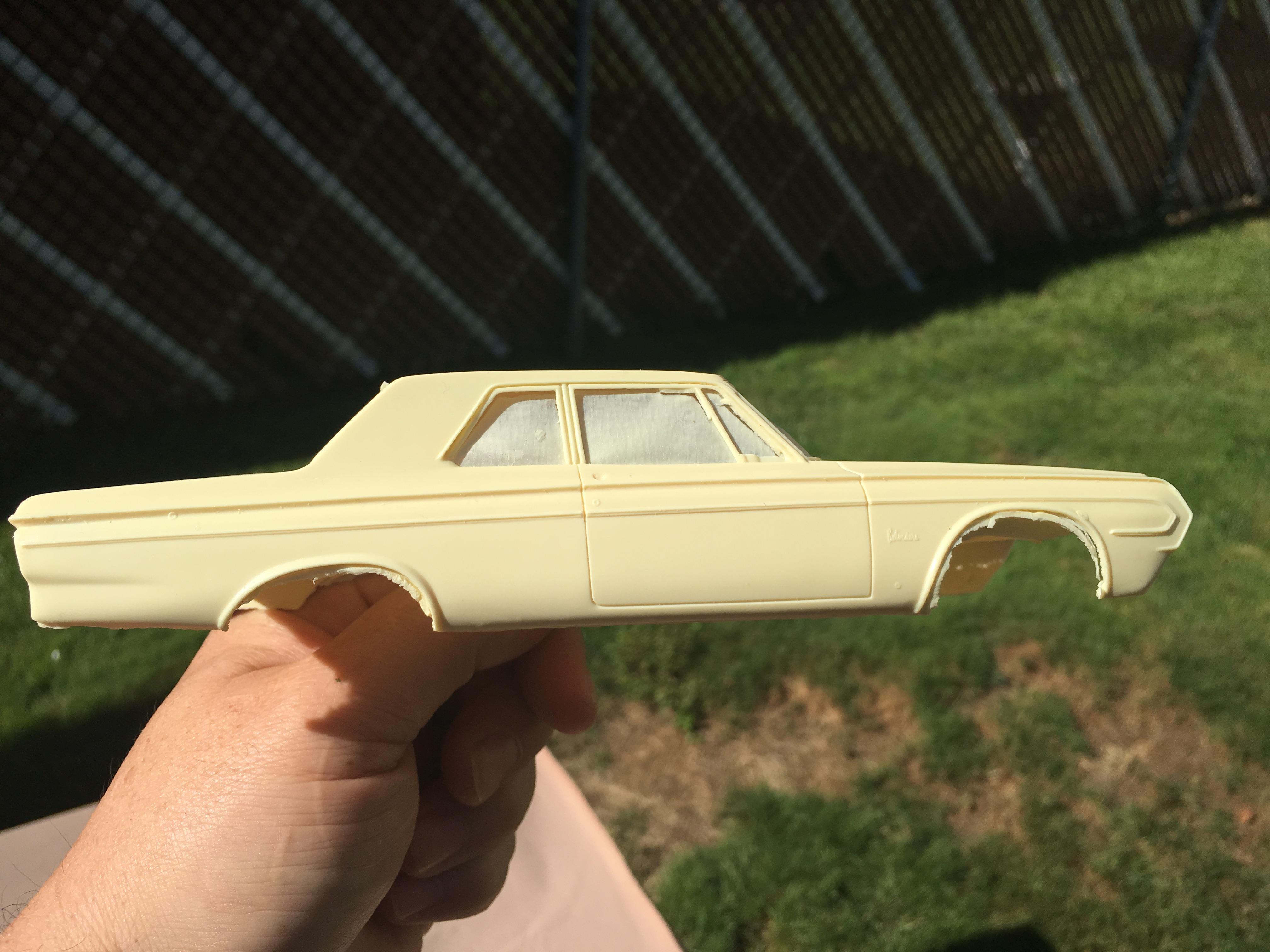

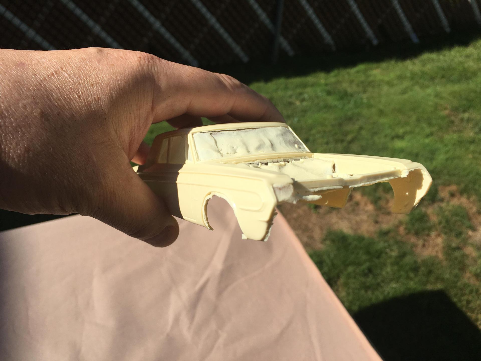

moparfarmer Posted September 30, 2019 Posted September 30, 2019 On 9/25/2019 at 6:46 PM, gtx6970 said: I don't remember anything else about it, and right now have NO idea where its at ( we moved across country last year and 90% of my model stuff is still packed away.) Best I can remember the lettering on the decklid trim across the back was so faint and/or full of pinholes . There was no way was it going to survive even a few coats of primer , paint and clear . I think I had decided my best option was just eliminate it altogether and move on . Then the make my own idea popped in my head . I started a conversion of my own using the Dodge sedan roof on the Plymouth hardtop body. . I got as far as a basic trim and fit then shelved it for some reason . No idea where even its at right now I'm in process of configuring the garage / making a model work bench area . But its at least a couple months away from completion due to I have other projects I have to complete before any model bench time can resume . Here is one that I did a few years ago..Dodge 330 2 dr sedan on Belvedere body..
moparfarmer Posted September 30, 2019 Posted September 30, 2019 Just now, moparfarmer said: Here is one that I did a few years ago..Dodge 330 2 dr sedan on Belvedere body.. Don't paint it in a light metallic color or use black primer..It shows awful and all the flaws..
Brutalform Posted September 30, 2019 Author Posted September 30, 2019 (edited) 9 hours ago, moparfarmer said: Don't paint it in a light metallic color or use black primer..It shows awful and all the flaws.. Nice work on that build, Wayne. If I decide to use the 64 Lawman chassis, I don’t think there should be any problems. I know I have quite a few un built Hemi engines in my stash. As soon as I get another car or two that are already started, I’m going to start this one. Btw that JF body cleaned up real nice. I think it’s a really nice cast. I’ll post a pic later. Edited September 30, 2019 by Brutalform

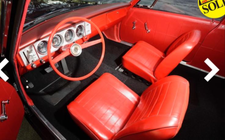

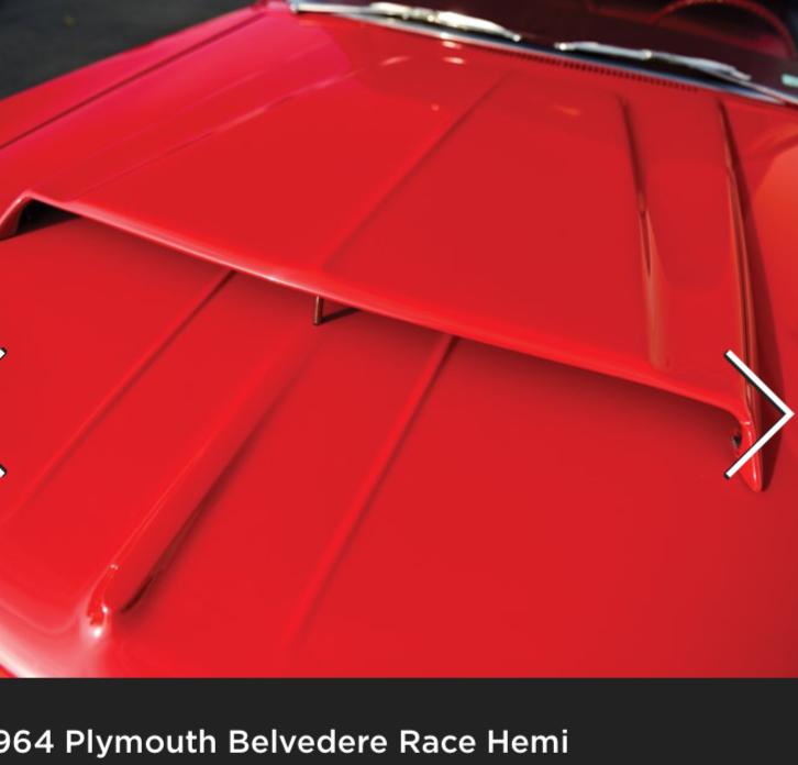

Brutalform Posted September 30, 2019 Author Posted September 30, 2019 (edited) On 9/28/2019 at 11:47 AM, gtx6970 said: I'll edit my original statement. There were in fact .,,facyory built hemi powered 2 door hardtops But they're were not light weights and had the stock 4 head light grille. Yet had the same wide flat hood scoop the hemi sedans came equipped with. Still digging for info on interior choices avail for these . Hemi sedans were all light weights.(aluminum front sheetmetal ) 2 head light grille. With the bostrom style light weight bucket seat interior. No back seat. Found a fairly decent pic of an interior from a Mecum auction. Plain door panels with no armrest, light weight seats, and a black floor mat. This is a Hemi car. Edited September 30, 2019 by Brutalform

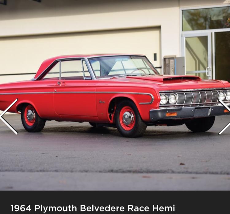

Brutalform Posted September 30, 2019 Author Posted September 30, 2019 (edited) Here is another Hemi car I found. Could this be a clone? Or just a non lightweight Hemi hardtop car that you mentioned Bill? Sorry for all the questions, but man, Mopar has a lot of stuff out there. Between Belvedere, Savoy, Fury, Scamps, Swingers, Dusters, Gold Dusters, Space Duster, Coronets, Roadrunners, etc. But I’m learning... lol Edited September 30, 2019 by Brutalform
BubbaBrown Posted October 2, 2019 Posted October 2, 2019 Dodge and comparable plymouth models had different wheelbases. Drove Landy crazy why his 63 plymouth was faster than the 64 dodge. figured the shorter wheelbase was hookin better. thus the first funny car 1964 awb dodge. in 1964 one could get a11.5 to 1cr 426 at 415hp, any full size body all steel full interior any color no hood scoop. the engine to race was the 09 code 425hp max wedge available any full size body all steel full factory interior no hood scoop. the lightweight package code y9 was only available with engine code o9 and had aluminum fenders,fender wells hood and scoop lower valance radiator support bumper and brackets, some parts acid dipped,no carpet insulation sound deadener heater radio battery moved to trunk 1964 interior color red only, hemi code A864, 1965 code changed to A990 with interior color champaign only tho Mopar did not call it that .1964 was the last year for aluminum, they then started acid dipping alot more in 1965. I hope I was of some help
