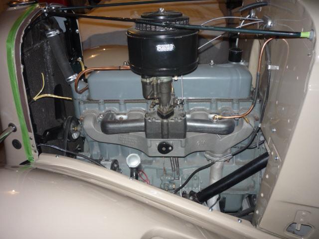

Ace-Garageguy Posted September 24, 2019 Share Posted September 24, 2019 (edited) Though there may very well be a ridiculous twin-carb adapter that bolts to the stock intake manifold, to get any meaningful performance increase, it would be necessary to provide more "holes" for carbs, rather than trying to flow them both through the flange intended for one on the OEM manifold. Welding on additional flanges was one way it was done in the early days before catalog-everything. A typical twin-carb cast manifold replaced the OEM, like this... EDIT: For lotsa alternatives in reality, Google image-search "twin carb adaptor stovebolt 6" or similar. Edited September 24, 2019 by Ace-Garageguy Quote Link to comment Share on other sites More sharing options...

landman Posted September 24, 2019 Author Share Posted September 24, 2019 11 hours ago, Ace-Garageguy said: Though there may very well be a ridiculous twin-carb adapter that bolts to the stock intake manifold, to get any meaningful performance increase, it would be necessary to provide more "holes" for carbs, rather than trying to flow them both through the flange intended for one on the OEM manifold. Welding on additional flanges was one way it was done in the early days before catalog-everything. A typical twin-carb cast manifold replaced the OEM, like this... EDIT: For lotsa alternatives in reality, Google image-search "twin carb adaptor stovebolt 6" or similar. Looks like they were trying to copy the Fenton type intake but didn't see the headers so they made it fit the original somehow. I already have a '37 216 in the collection so I thought i'd do the "hotrod" version but that intake somehow looked suspicious. thanks for the info. Quote Link to comment Share on other sites More sharing options...

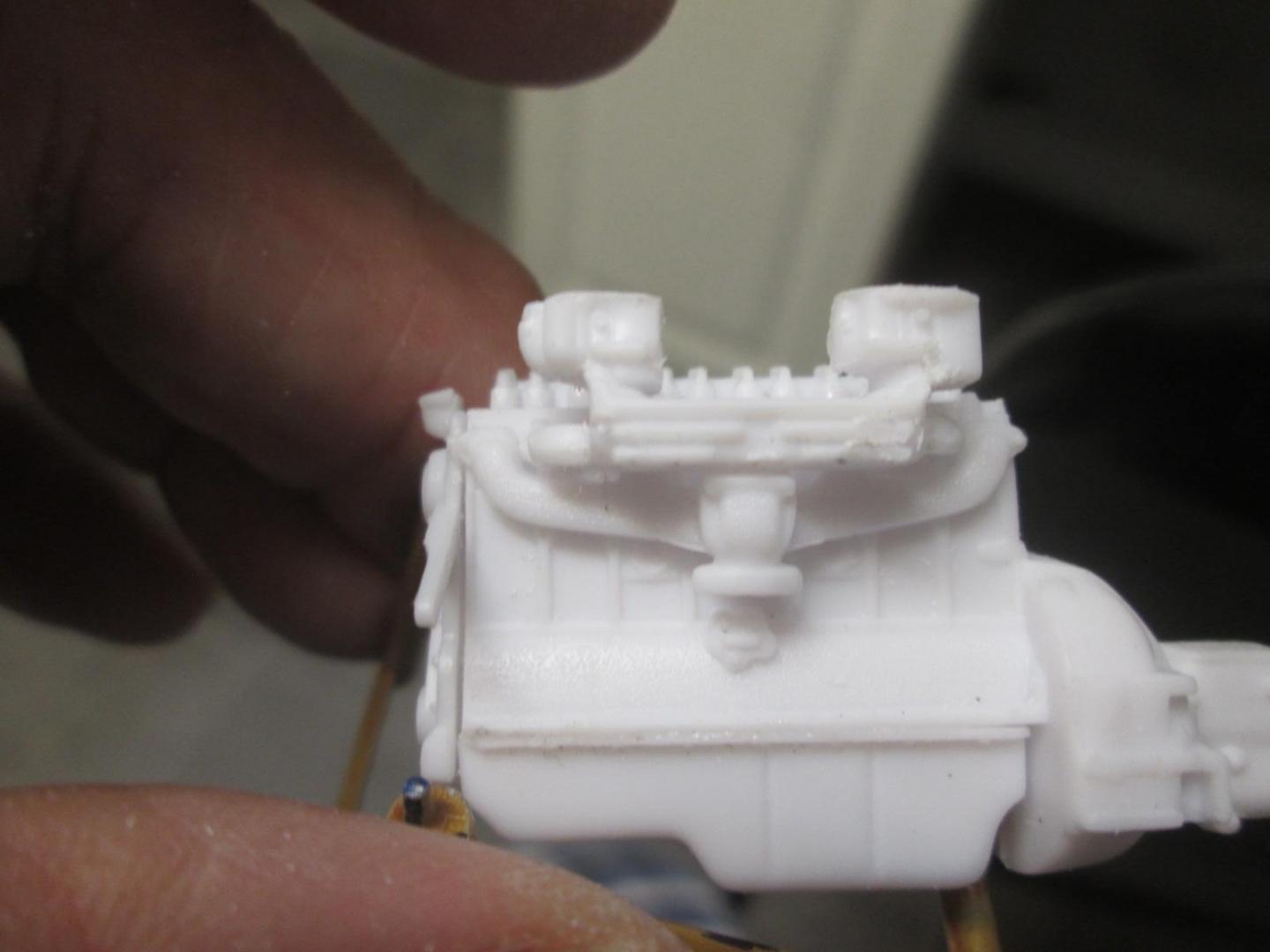

landman Posted September 26, 2019 Author Share Posted September 26, 2019 On 9/23/2019 at 9:02 PM, Ace-Garageguy said: Though there may very well be a ridiculous twin-carb adapter that bolts to the stock intake manifold, to get any meaningful performance increase, it would be necessary to provide more "holes" for carbs, rather than trying to flow them both through the flange intended for one on the OEM manifold. Welding on additional flanges was one way it was done in the early days before catalog-everything. A typical twin-carb cast manifold replaced the OEM, like this... Modified the weird manifold and mated it to the stock runners to give something similar to your photo. Now do the float chambers go to the back or front? Quote Link to comment Share on other sites More sharing options...
landman Posted September 26, 2019 Author Share Posted September 26, 2019 Just remembered, the one on my '34 had the float bowl in front. Quote Link to comment Share on other sites More sharing options...
Ace-Garageguy Posted September 26, 2019 Share Posted September 26, 2019 What you have now looks good. Nice conversion of something stupid into something workable in reality. Quote Link to comment Share on other sites More sharing options...
