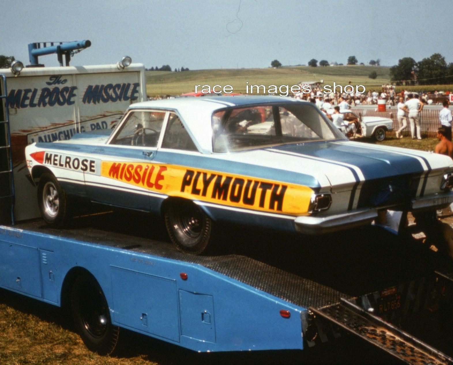

gtx6970 Posted October 3, 2019 Posted October 3, 2019 Original picture of the AFX car, which is what the original SS car became. and its DEFINITLY a tan interior
