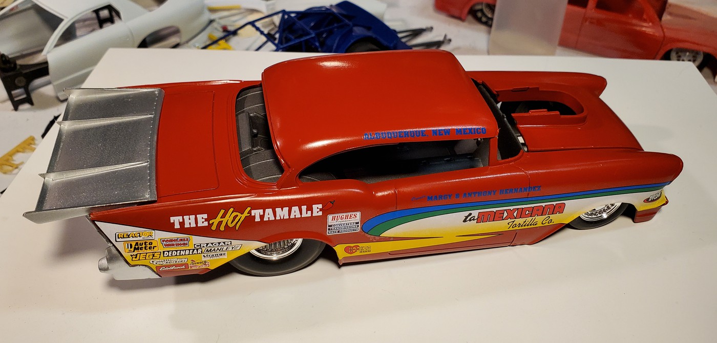

1320wayne Posted February 19, 2020 Posted February 19, 2020 When you have as many unbuilt models as I do not every build can be a 6 month, over the top, detailed build. You've got to build some out of the box stuff from time to time. My latest is a Revell 57 Chevy done up as a Super Gas class build using a set of decals that I've had for years. Started by mocking up the chassis with a lowered front suspension as these kits sat way too high in the front for my liking. Primer, paint and started adding decals. I've never used Upscale Graphics before this and I'm pleasantly surprised that these decals are awesome.
1320wayne Posted February 19, 2020 Author Posted February 19, 2020 Decals are done on both sides. I also lowered the rear suspension just a bit as well.

1320wayne Posted March 1, 2020 Author Posted March 1, 2020 Finished the hood and painted the bumper along with adding the remainder of the decals including the tire lettering. Started on the engine as well.
