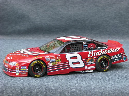

Jim N Posted March 2, 2020 Posted March 2, 2020 In the picture below, the black from the A pillar to the C pillar was done in Sharpie and cleared with Future. There were no runs or streaking.
Hotrod 97 Posted March 5, 2020 Author Posted March 5, 2020 On 3/2/2020 at 5:25 AM, peteski said: I have never tried that, but I suspect that it will be ok (not run). But I recommend testing this combination on a piece of plastic (sheet styrene, or maybe a plastic spoon), to be sure. Expand On 3/2/2020 at 6:14 PM, Jim N said: In the picture below, the black from the A pillar to the C pillar was done in Sharpie and cleared with Future. There were no runs or streaking. Expand Exactly the information I was after. Thanks much.
