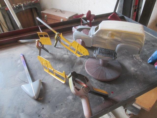

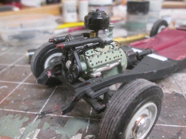

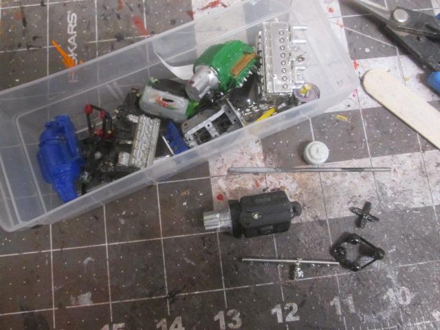

I was supposed to do the next one out of the box, go figure. Anyway, it turns out the donor car has no engine so into the bin I go. I thought of using the engine in the sedan delivery but I remembered I have other plans for it.

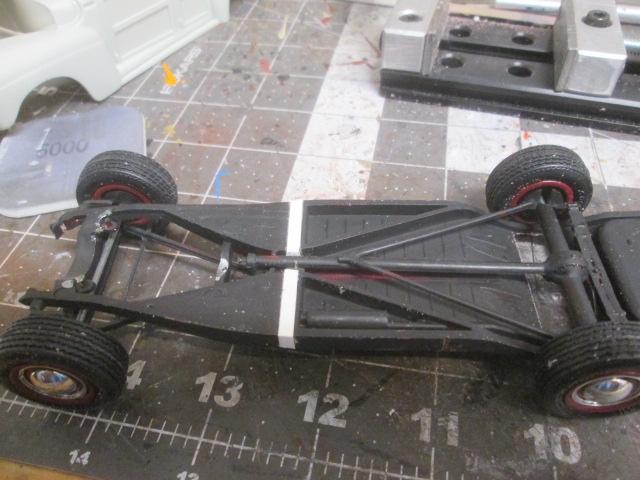

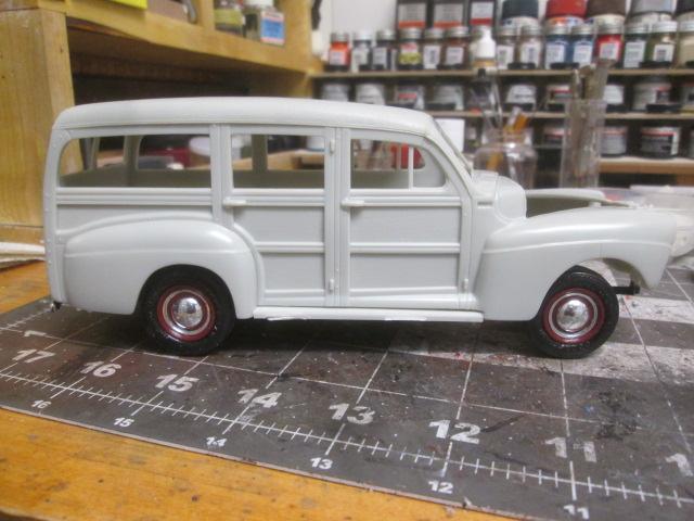

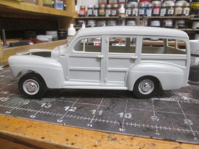

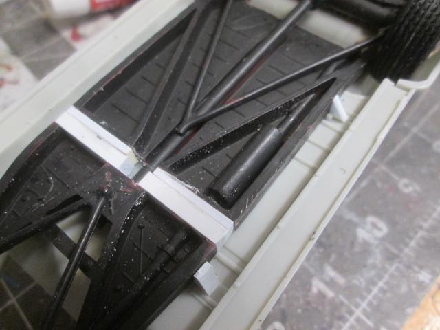

In real life, the 41 has a 114" wheelbase whereas the 40 has a 112" wheelbase. In AMT land it looks like a bit more. An adjustment will be necessary. Cut the "hump' to clear the wagon's rear cargo floor.
Cut along a flat surface to have a nice mating surface for the spacer. Tacked the first one on. It just might catch it. Maybe 2 more millimeters.

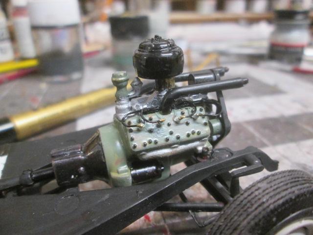

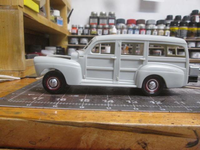

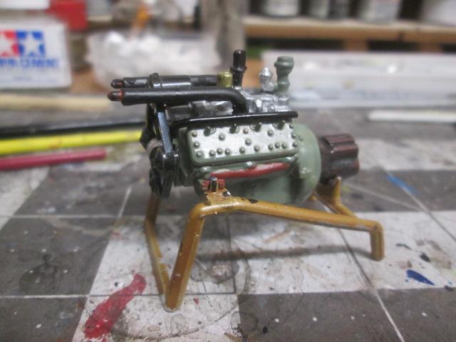

Changed the wheels for something more appropriate. the parts bin engine is taking shape. Meanwhile I am experimenting with different paints on plastic spoons to try to avoid the last ordeal.

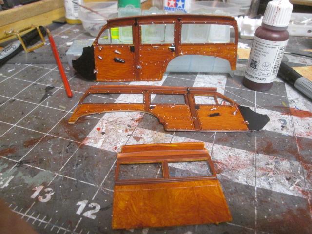

Look like the clear will do the trick. Painted the interior CAT yellow as a base for the Vallejo woodgrain stains.

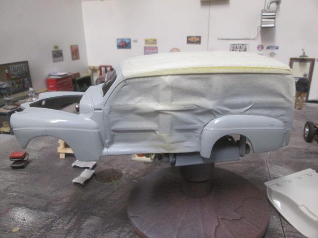

This is taking some srious masking. I had done the roof mask separately hoping to just peel it off but it didn't work. so I remasked to paint the roof.
34 minutes ago, espo said:
The interior wood grain looks great from here.
Thank you. I'll try those decals on the outside, see what happens.
15 minutes ago, Intmd8r said:
Nice job. Painting Wood grain by hand Almost always looks better than decals
Thanks. I'm starting to believe that.
