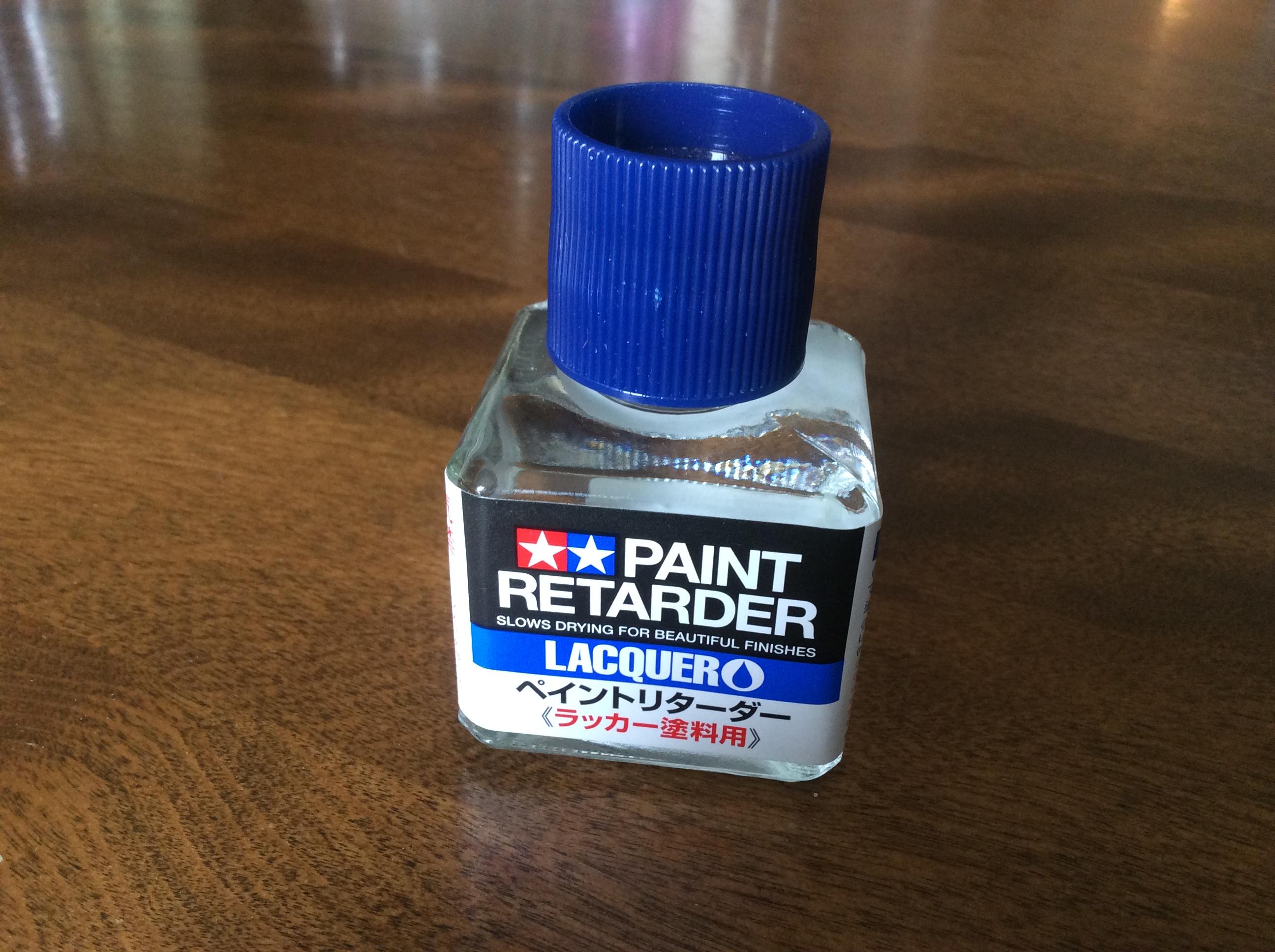

64Comet404 Posted May 25, 2020 Posted May 25, 2020 Tamiya does have a retarder available for its acrylic line, but I haven’t seen it out yet for lacquers. With the LP series out now, I wouldn’t be surprised to see a retarder in the line soon. Btw, what tip are you using on your H? If you are using the #3, you may want to change it to the #5 for better paint flow before the thinner flashes. Hope this helps.

64Comet404 Posted May 25, 2020 Posted May 25, 2020 7 hours ago, GeeBee said: No, for that, you need to bottle with the orange top I haven’t seen the retarder type thinner yet here. I was at my local shop today, however, and Tamiya does make a separate lacquer retarder. Item number is 87198**260
Don Sikora II Posted May 26, 2020 Posted May 26, 2020 Mr Hobby sells retarder for lacquer, and it might be slightly easier to find in the US. Haven’t tried it with Tamiya spray, but it’s magic with Mr Hobby lacquer brush paint.

martinfan5 Posted May 27, 2020 Posted May 27, 2020 11 hours ago, GeeBee said: I've not seen the retarder yet, I bought the Tamiya thinners in Hong Kong last year when it wasn't yet available in the U.K.at the time. I believe that is being done for the LP Series , its a fairly new item.
