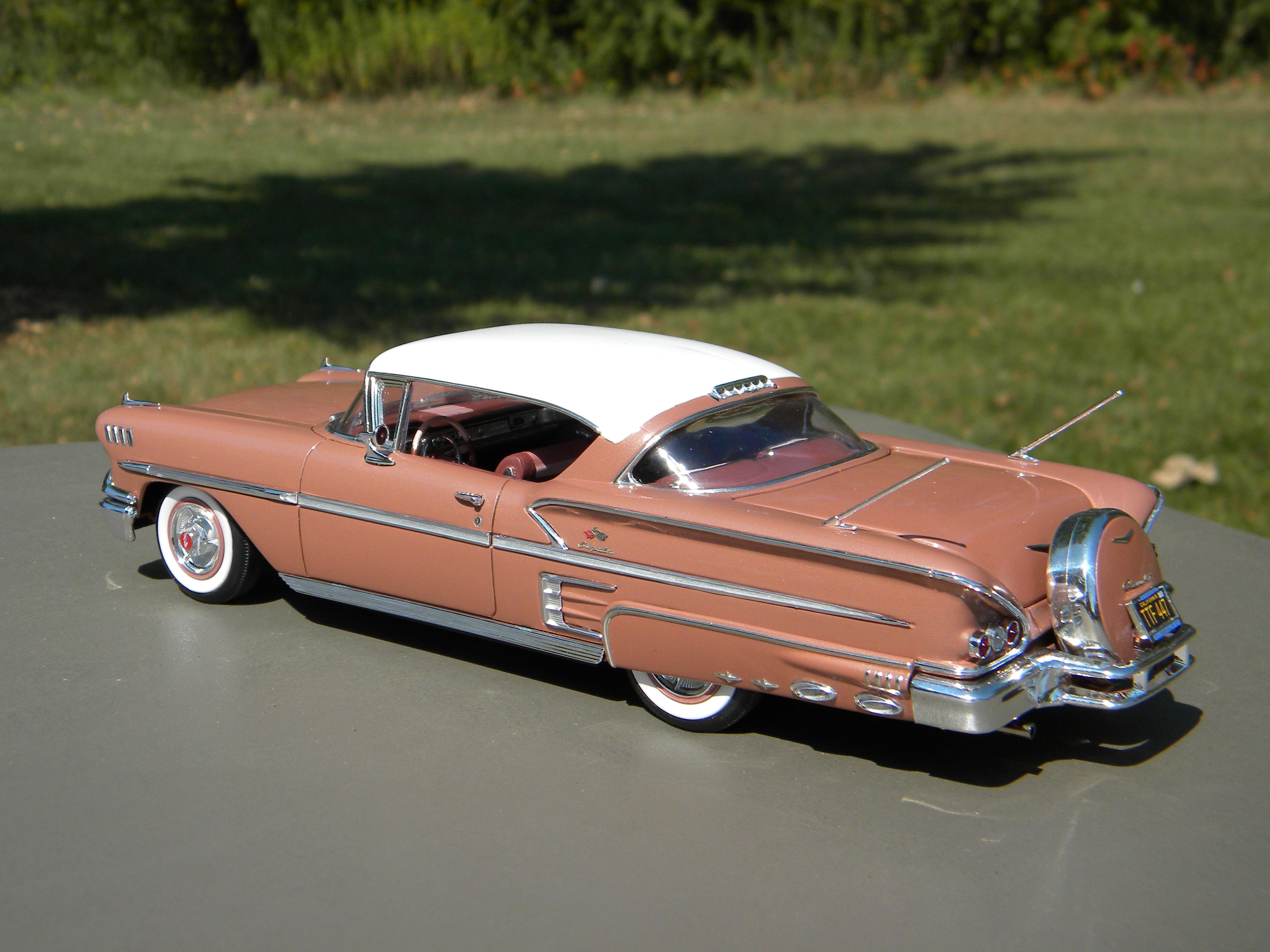

StevenGuthmiller Posted June 10, 2020 Posted June 10, 2020 On 6/7/2020 at 8:09 PM, Snake45 said: I painted a Charger 500 many years ago in MCW Hemi Orange. I didn't even realize it was "metallic" until someone pointed it out to me. Couple years ago I had to do some touchup on it. I used the Testor/MM Hemi Orange, decanted and applied by brush. You have to know where to look for it to spot the touchup spots, that's how close they are. MCW has some of the best metallic particle sizes in their paint on the market. If they have the color that you are looking for, you will not be disappointed. Just as an example, I painted this 1958 Chevy Impala some years ago with MCW metallic "Cay Coral". The metallic particles are nearly imperceptible with the naked eye, but it has the metallic sheen that an object of this size should have to look in scale. Beautiful stuff, and I would use MCW paints over Scale Finishes all of the time if MCW always carried the color that I was looking for. Steve
