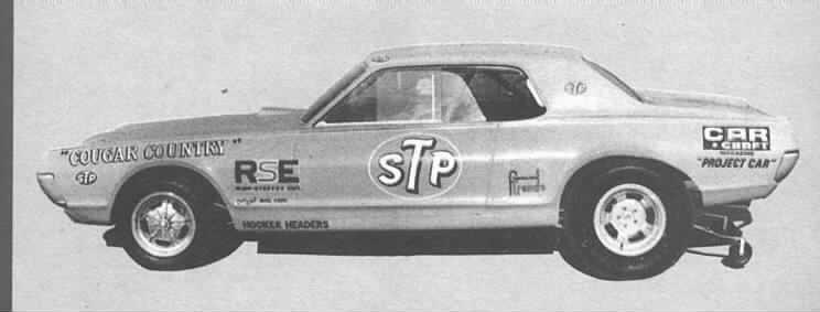

Snake45 Posted July 4, 2020 Posted July 4, 2020 4 hours ago, Mark said: I would suspect that the front wheel openings were moved forward on the Cougar body. Hmmmm, dunno. Found a couple fairly good profiles of the Rupp & Steffey car (which became the first Eliminator Cougar). What do you think? Looks to me like the rear wheel openings have been extended rearward a bit, but I'll have to compare these with good stock Cougar pics to tell what's going on.....
Mark Posted July 4, 2020 Posted July 4, 2020 Or just compare with an AMT body. I've got a couple of those, but after a half day at work, riding a bicycle 23 miles, then mowing the lawn and throwing the laundry into the washer, I'm sitting down with an ice cold hard lemonade...
Snake45 Posted July 4, 2020 Posted July 4, 2020 30 minutes ago, Mark said: Or just compare with an AMT body. I've got a couple of those, but after a half day at work, riding a bicycle 23 miles, then mowing the lawn and throwing the laundry into the washer, I'm sitting down with an ice cold hard lemonade... Well I have an AMT body, and the FC reissue body, but comparing them doesn't really tell us anything about if or where the REAL fiberglass Cougar FC body was altered. Lord only knows what liberties MPC took when designing and tooling it.
Mark Posted July 4, 2020 Posted July 4, 2020 I'd suspect the MPC body is at least somewhat accurate to the Rupp/Steffey car, since that was the first version issued. The chassis was shared with other kits, but was issued in different lengths for each. The MPC body has the front wheel openings in stock location and the rears stretched to the rear as you observed. What gets me is how close to stock the MPC body is. If I didn't already have three '67-'68 Cougars, I'd be tempted to try converting one to stock just for giggles.
Snake45 Posted July 4, 2020 Posted July 4, 2020 13 minutes ago, Mark said: What gets me is how close to stock the MPC body is. If I didn't already have three '67-'68 Cougars, I'd be tempted to try converting one to stock just for giggles. Yes, it's very close to stock except for the oversized (and possibly repositioned) rear wheel openings. I recently bought (in a junkyard lot) a glue bomb AMT '68 Cougar that's got great glass, interior, and even stock wheels but is missing the hood, grille, taillight panel, and front and rear valences. I'm watching ePay for parts but might end up sacrificing an MPC FC kit for the missing bits. I'm pretty sure they'll fit, or could be made to. How I miss Modelhaus!

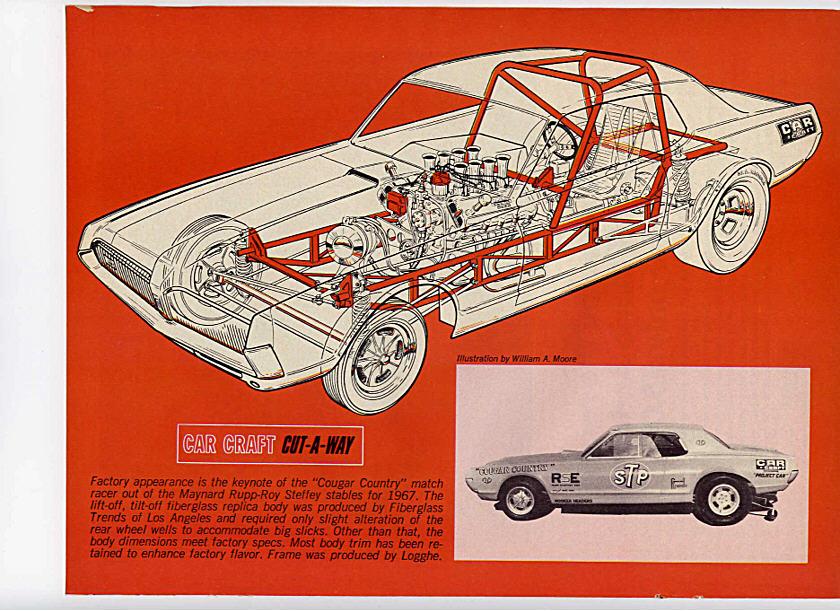

Snake45 Posted July 4, 2020 Posted July 4, 2020 Okay, looking at pics in the DD book, there are several where the front wheel openings look stock (although the wheels themselves seem to have been pushed forward an inch or two inside them), and others where the front wheel openings are clearly moved forward and the rear wheel openings don't seem to have been enlarged rearward, if at all. These would seem to be the first and second Cougars--very different. The MPC DD Cougar kit would then seem to be (mainly) of the first car. Doesn't bode well for my plan to put both bodies on that chassis, hmmmmmm. To really do it RIGHT, I'd have to obtain a Polar Lights chassis (assuming its wheelbase is somewhere in the 115-117" range) and then alter the MPC Cougar body. And then there's the fact that neither the kit nor the Slixx decals would be set up for the altered body. So much for a "quick and easy twofer" build.
TooOld Posted July 4, 2020 Posted July 4, 2020 6 hours ago, Snake45 said: Well I have an AMT body, and the FC reissue body, but comparing them doesn't really tell us anything about if or where the REAL fiberglass Cougar FC body was altered. According to the text the body was stock except for the rear wheel wells .
