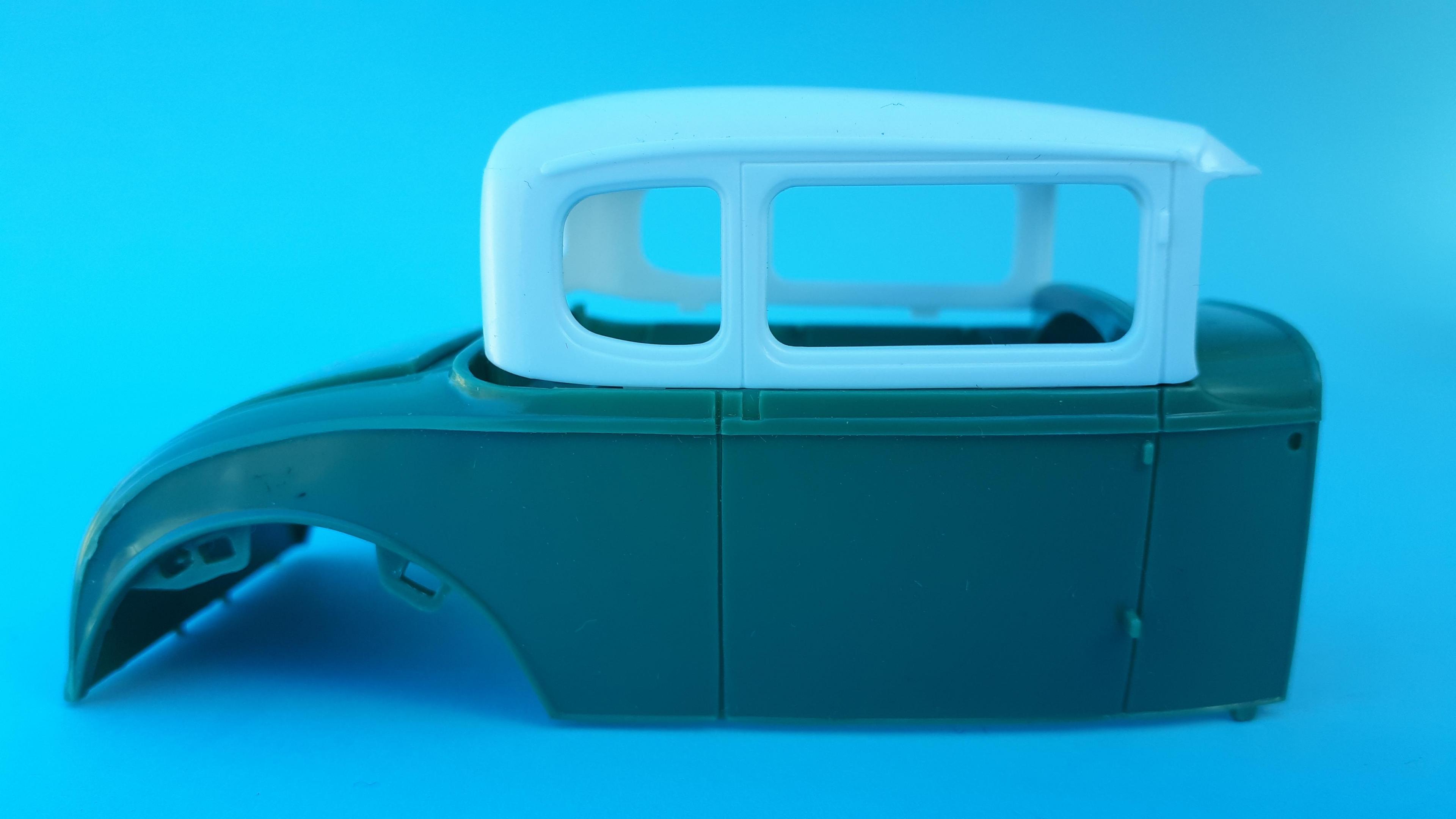

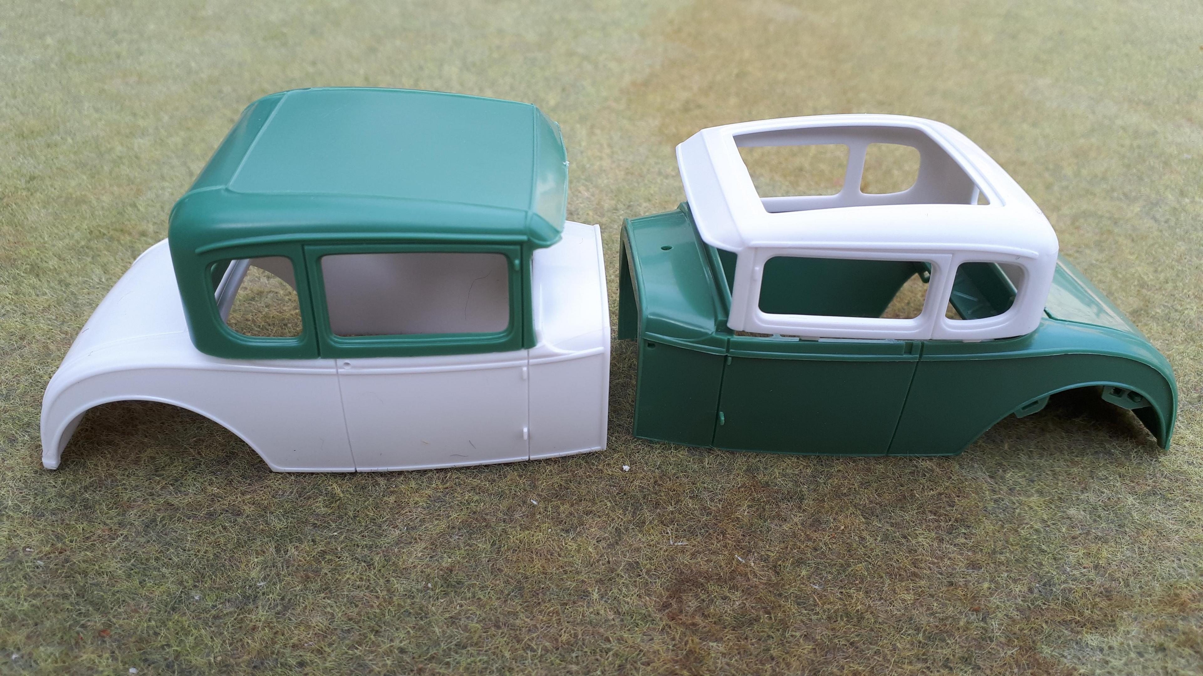

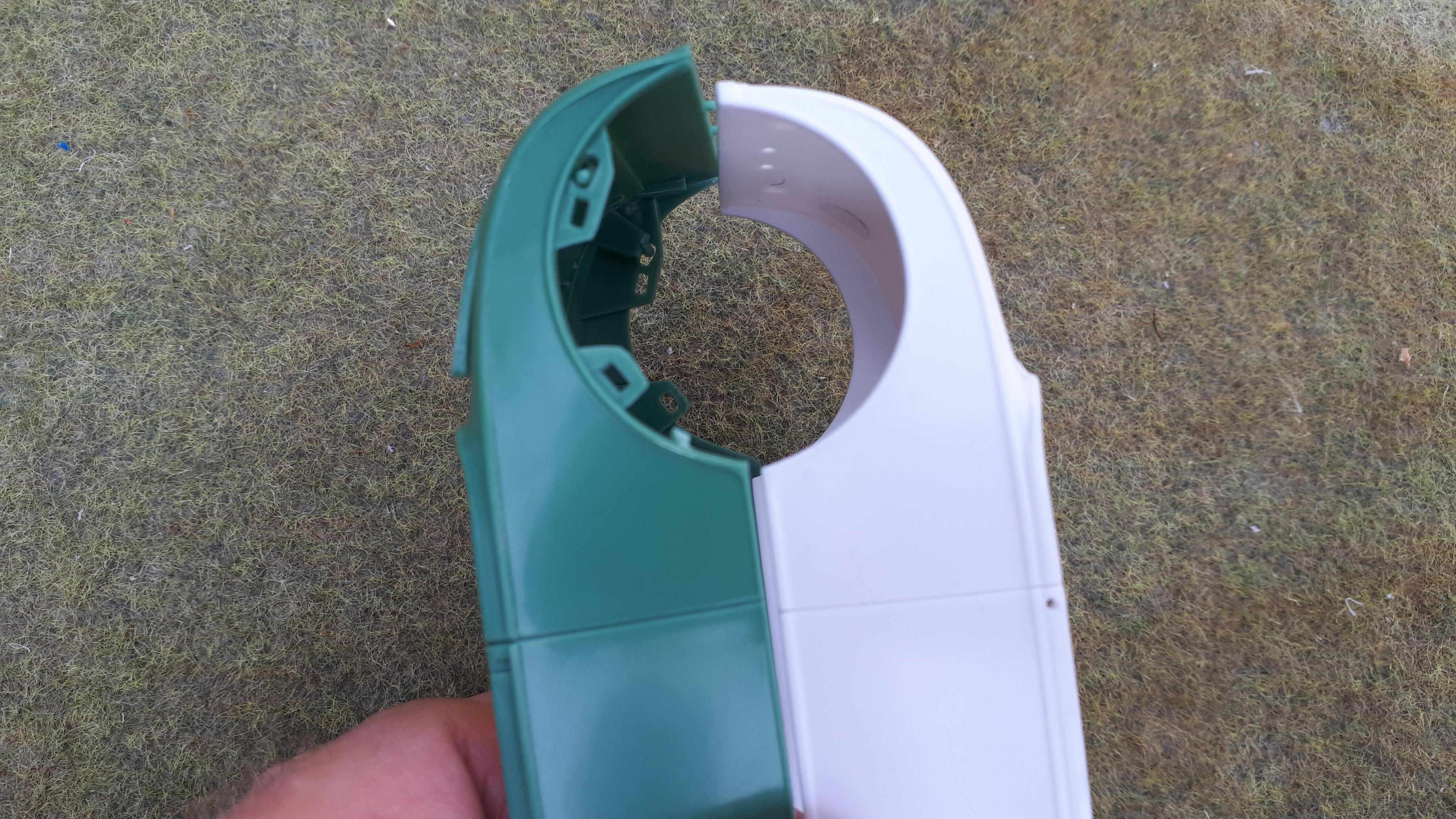

alan barton Posted July 6, 2020 Posted July 6, 2020 (edited) Hi all, this is my build post for my recently completed Revell Model A coupe. I wanted this one to be a circa 62-63 East Coast style showcar. Yeas, it would have been more period correct if it had a stock height roof but I wanted to steer clear of overcomplicationitis on this one. Speaking of roofs, if you have been wondering, here is how the Monogram stock height roof compares to the Revell chopped roof. Can you swap them over - sorta. Should you swap them over, nah, it would be a lot simpler to just chop a Monogram model and you are on your own if you want to unchop the Revell. The chopped roof is so different in every dimension to the Monogram body that it would be a nightmare to fix. If you were to fit the Monogram roof to the Revell body, you might get away with it IF you painted it a dark colour and IF you weren't fussy about door lines lining up. If I had countless spare Revell coupes I might try it just for giggles but I have two and they are both under construction so it won't happen. Oh yeah, the Revell body wont match up to the monogram fender unit either. My recipe for this car is as follows. Revell 30 Chopped coupe on the channelled Model A frame Pleated interior from the unchannelled version Nailhead Buick from the 29 roadster kit Rear end spring and radius rods form the AMT 25 T Pegasus front wheels and tyres AMT Parts Pack white wall slicks with deep chromies that I THINK were from the AMT 57 Chevy but I can't be sure. 32 Grille and radiator First step was to convert the channelled height firewall to RHD. A little trick I used to minimise glue squeezing through the roof seam was to use about four small drops of tube glue to locate the roof on the body and as I brought the two pieces together, starting on one side, I used Revell Professional in the blue bottle with the needle to wick between the two parts as they came together. I did get a tiny bit of glue damage on the right hand door but the seam is completely filled and the second one I did came out near perfect. Edited July 6, 2020 by alan barton

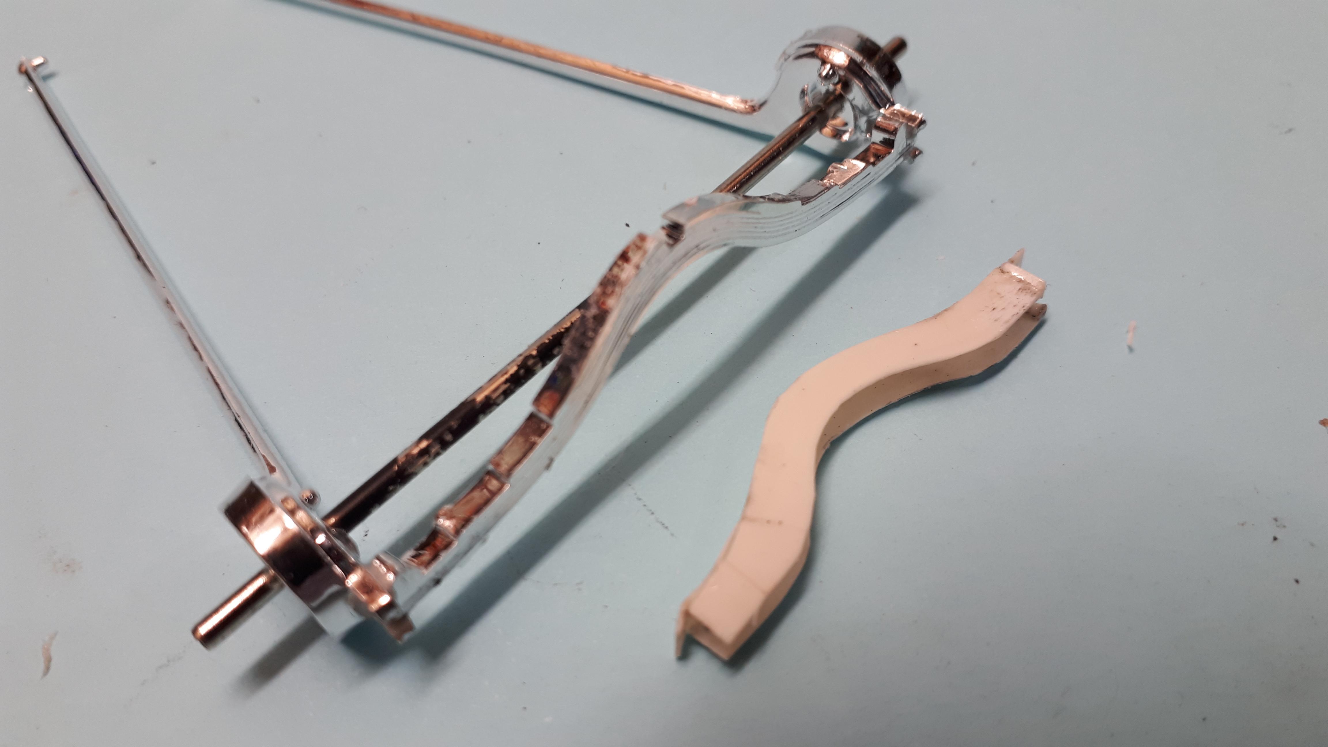

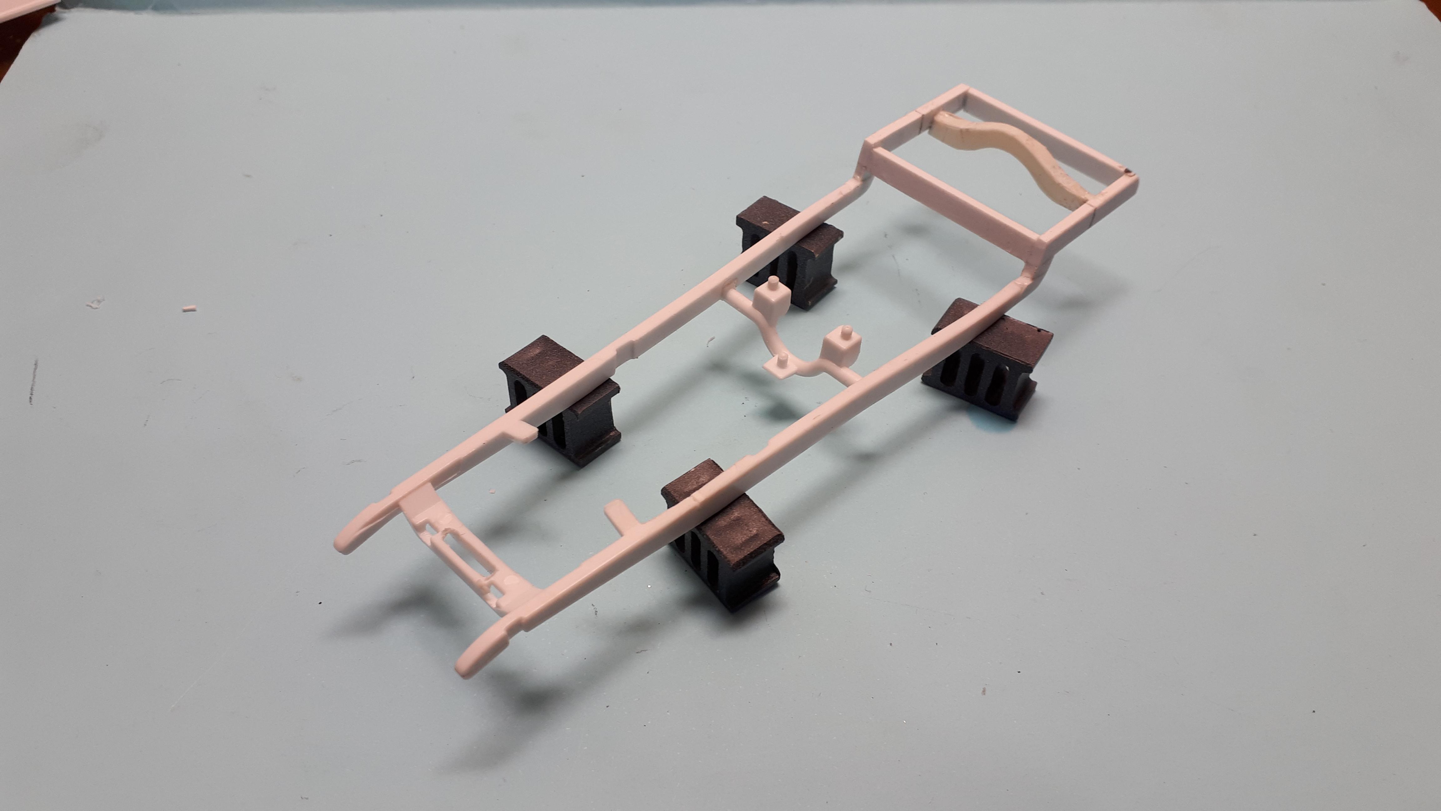

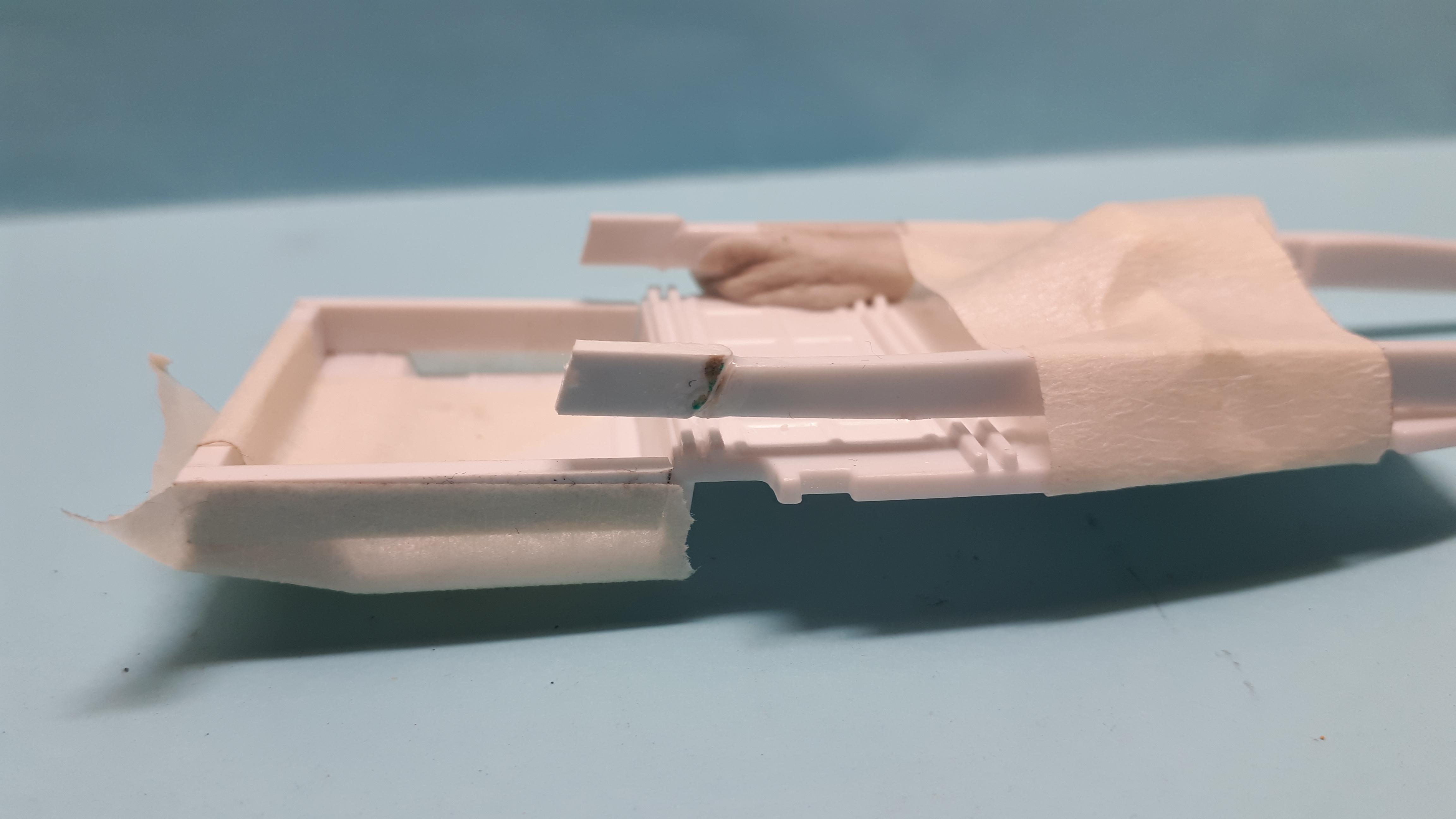

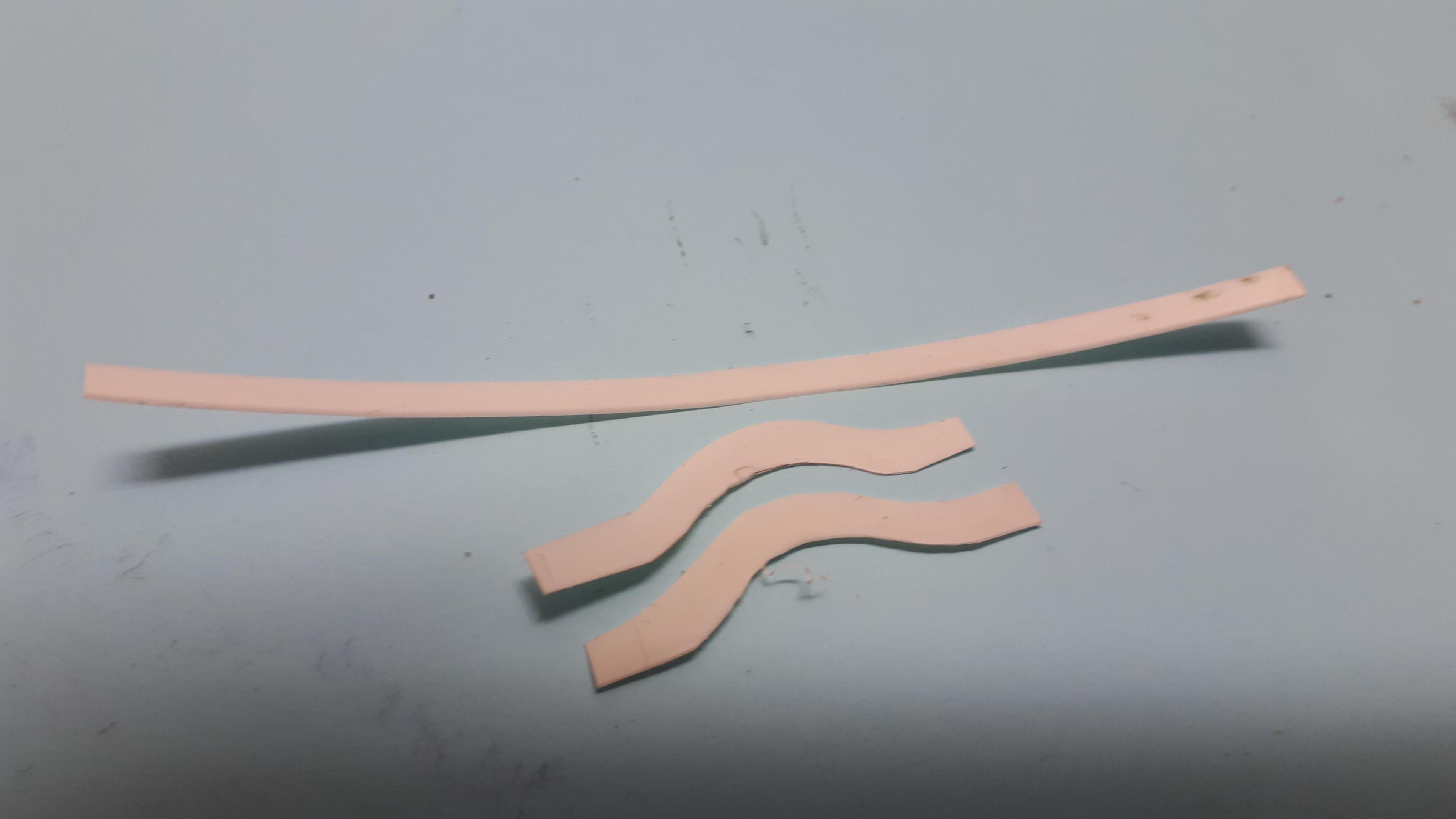

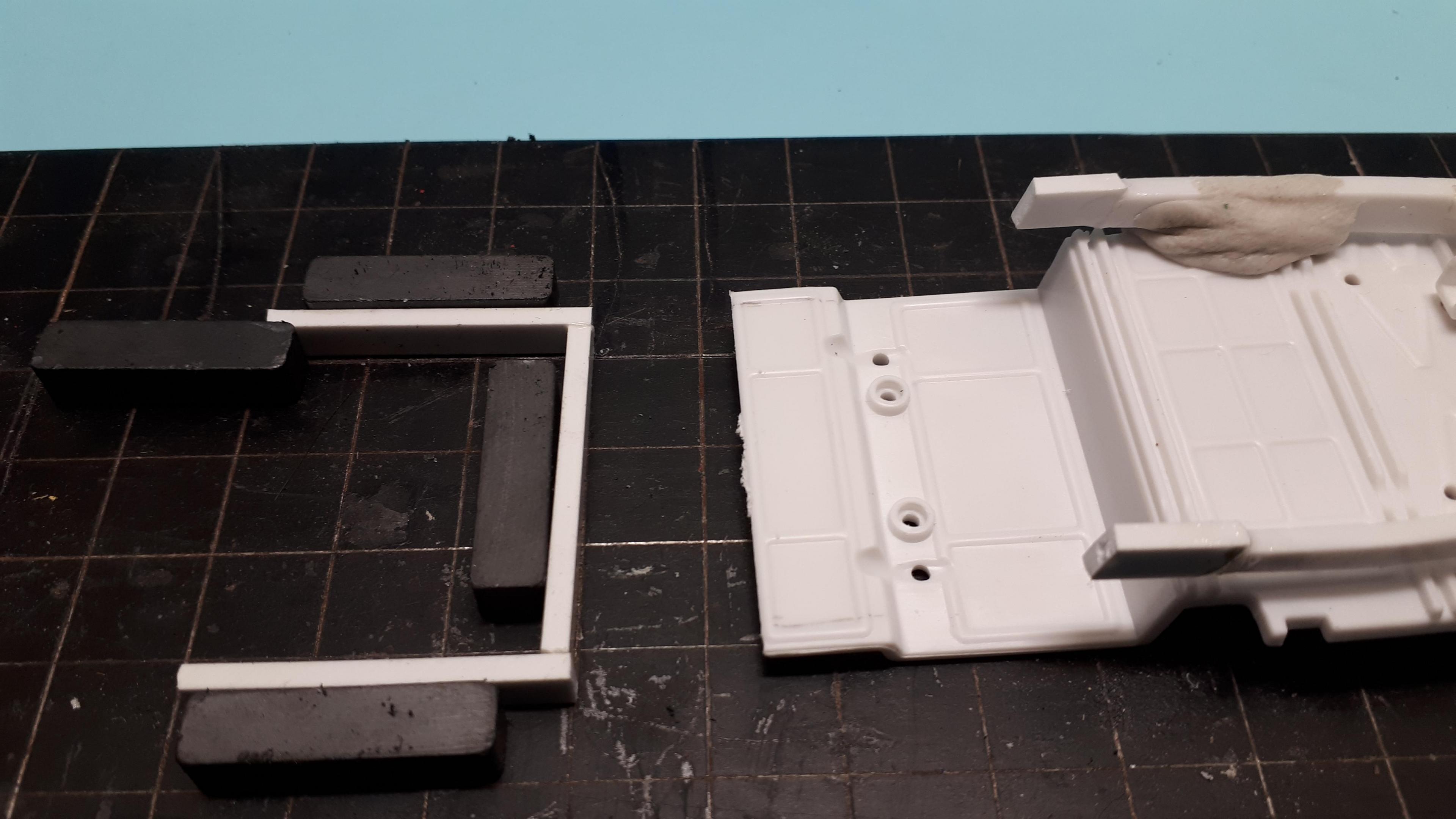

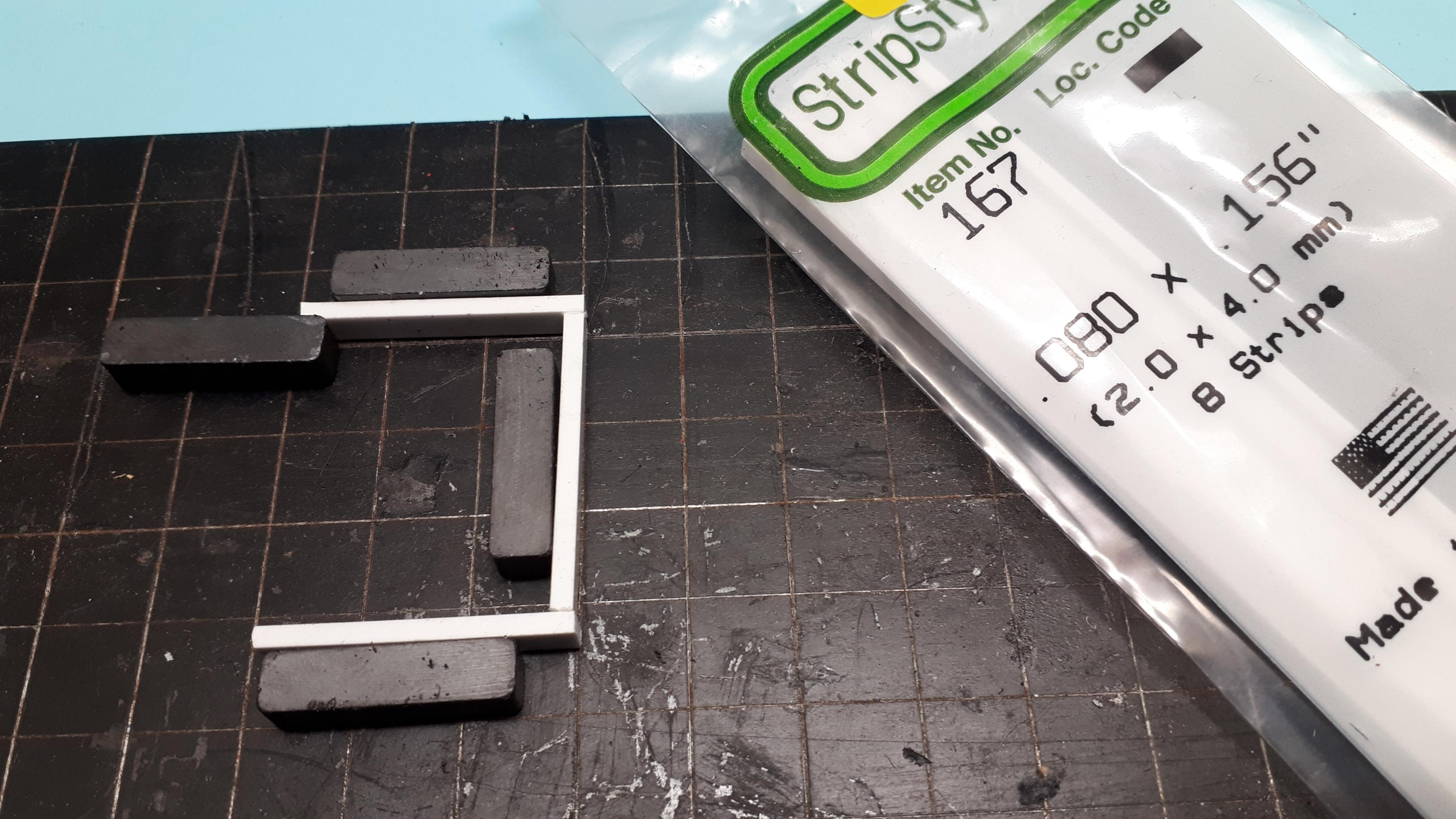

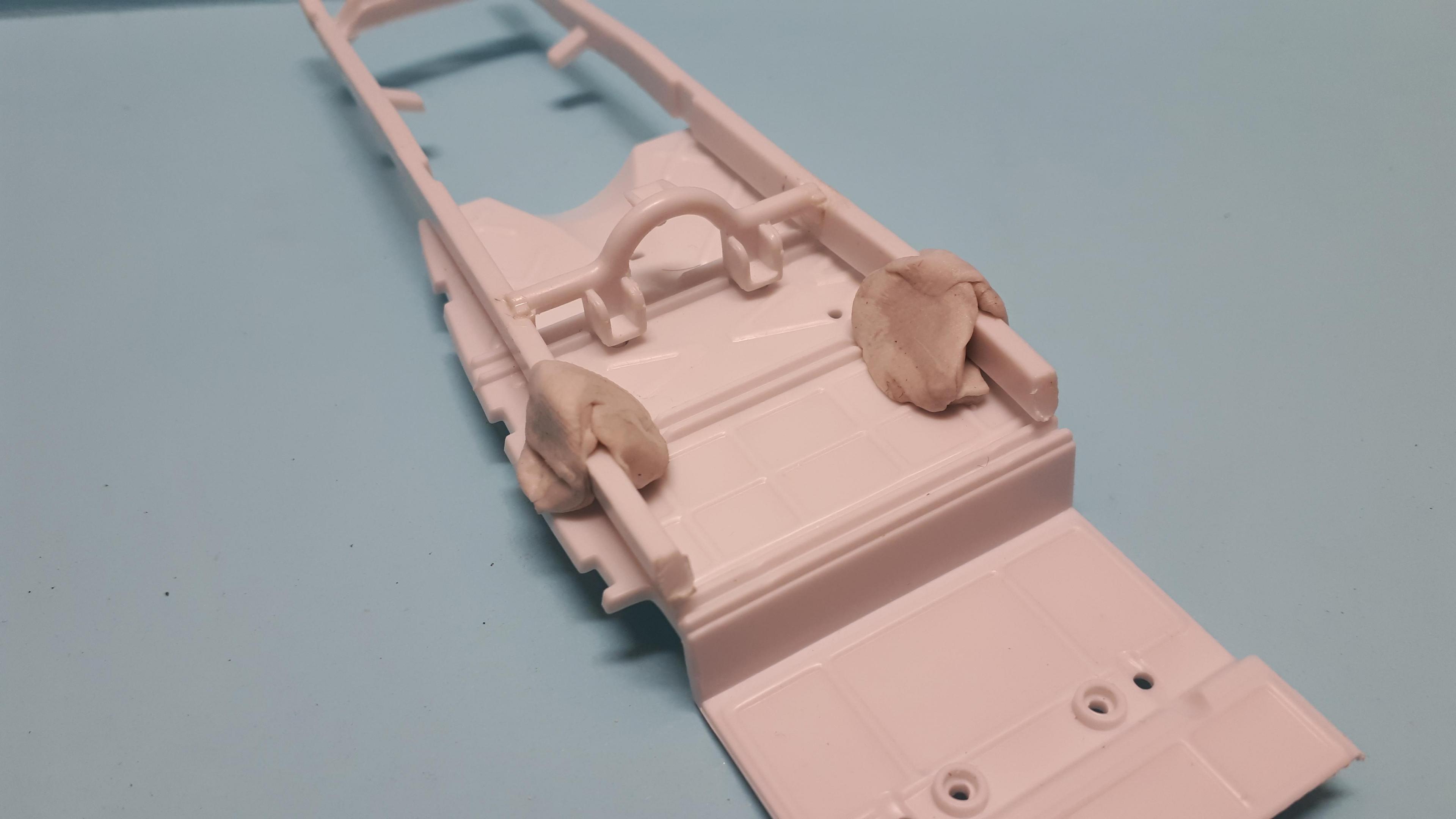

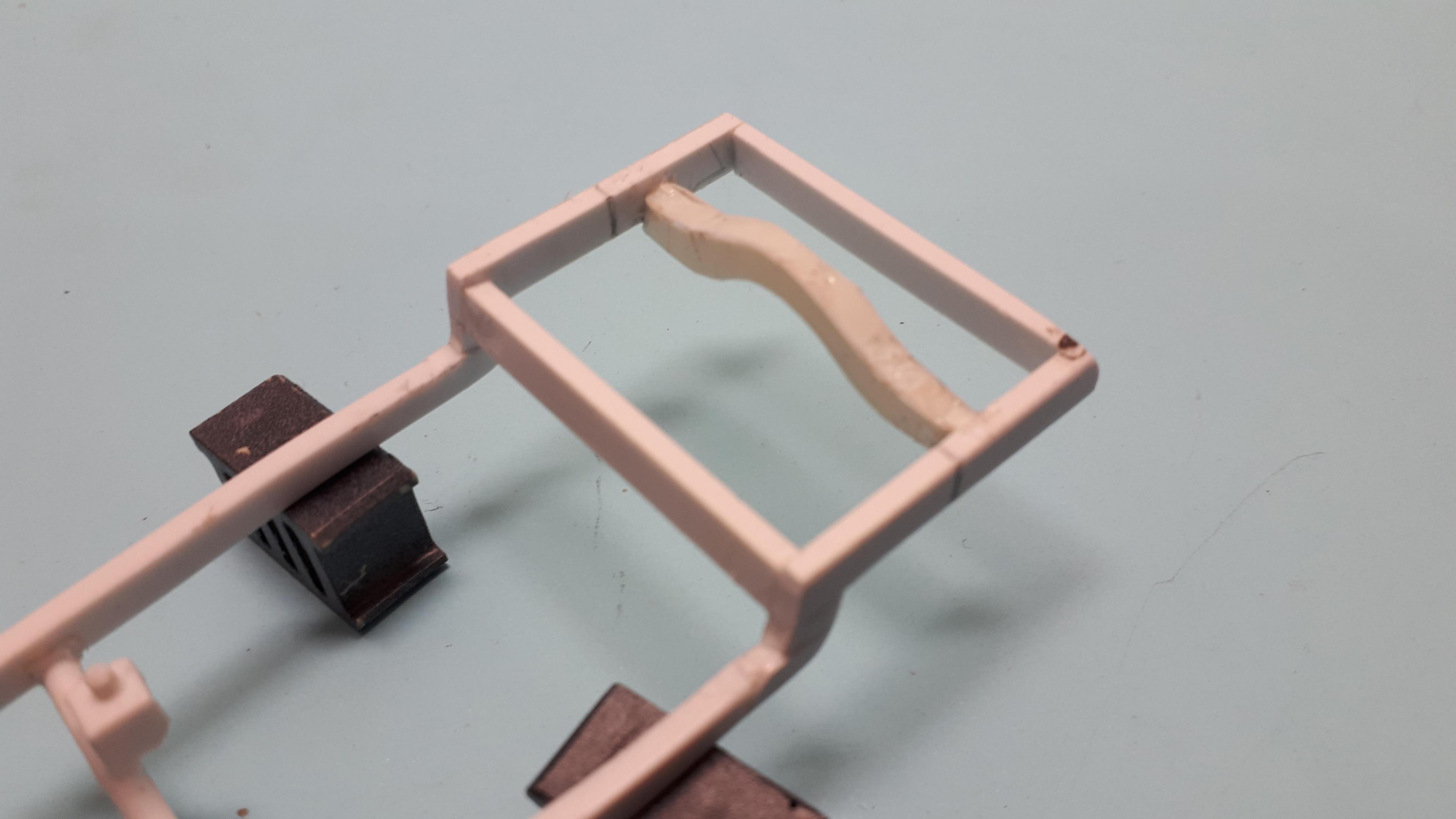

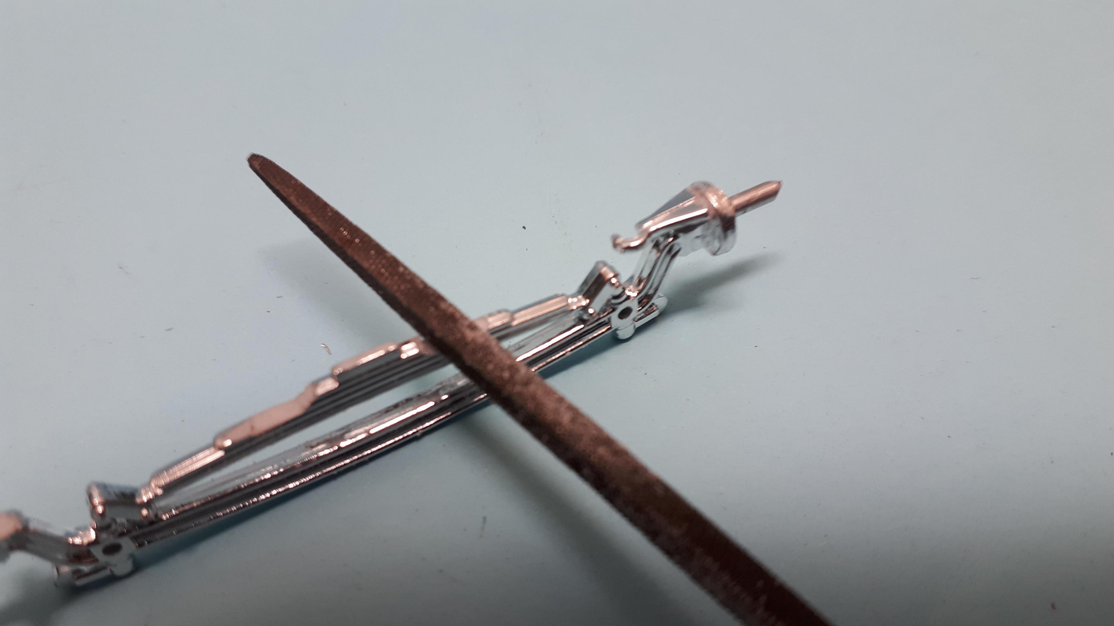

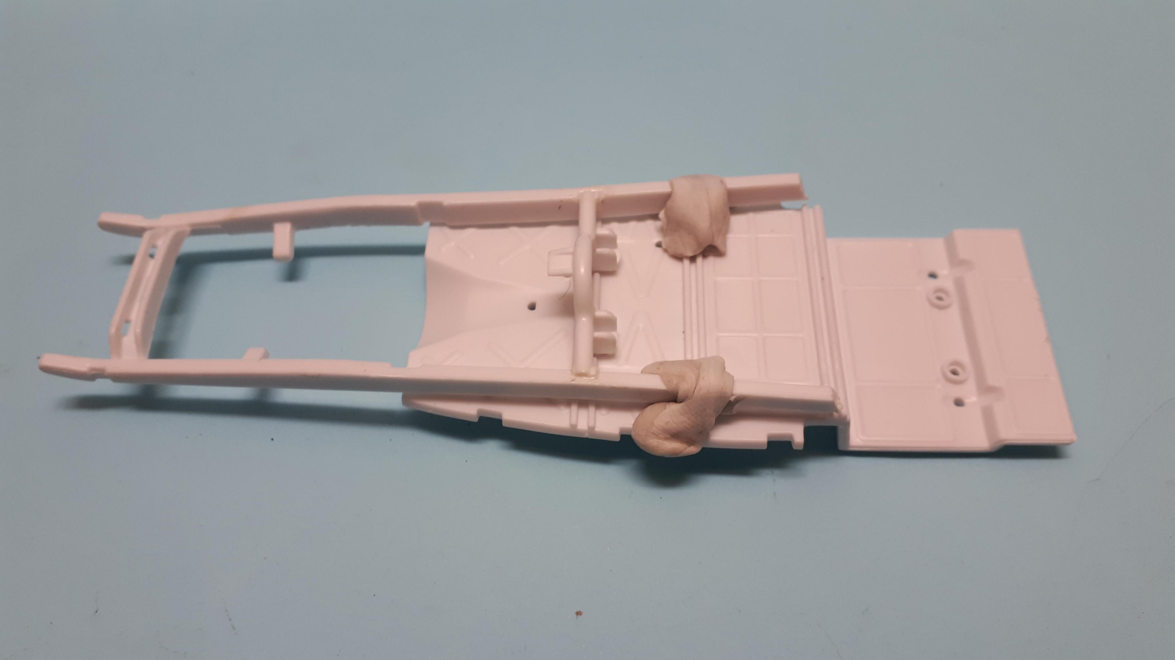

alan barton Posted July 6, 2020 Author Posted July 6, 2020 (edited) Just got the dreaded 200 error so I had to drop a few pictures from the last post. This was the very overcomplicationitis I was trying to avoid but it only took a few nights to fix and was definitely worthwhile. A bit of filing and sanding, almost no filler and I had a snug fitting frame ready for a period correct rear axle assembly. Edited July 6, 2020 by alan barton

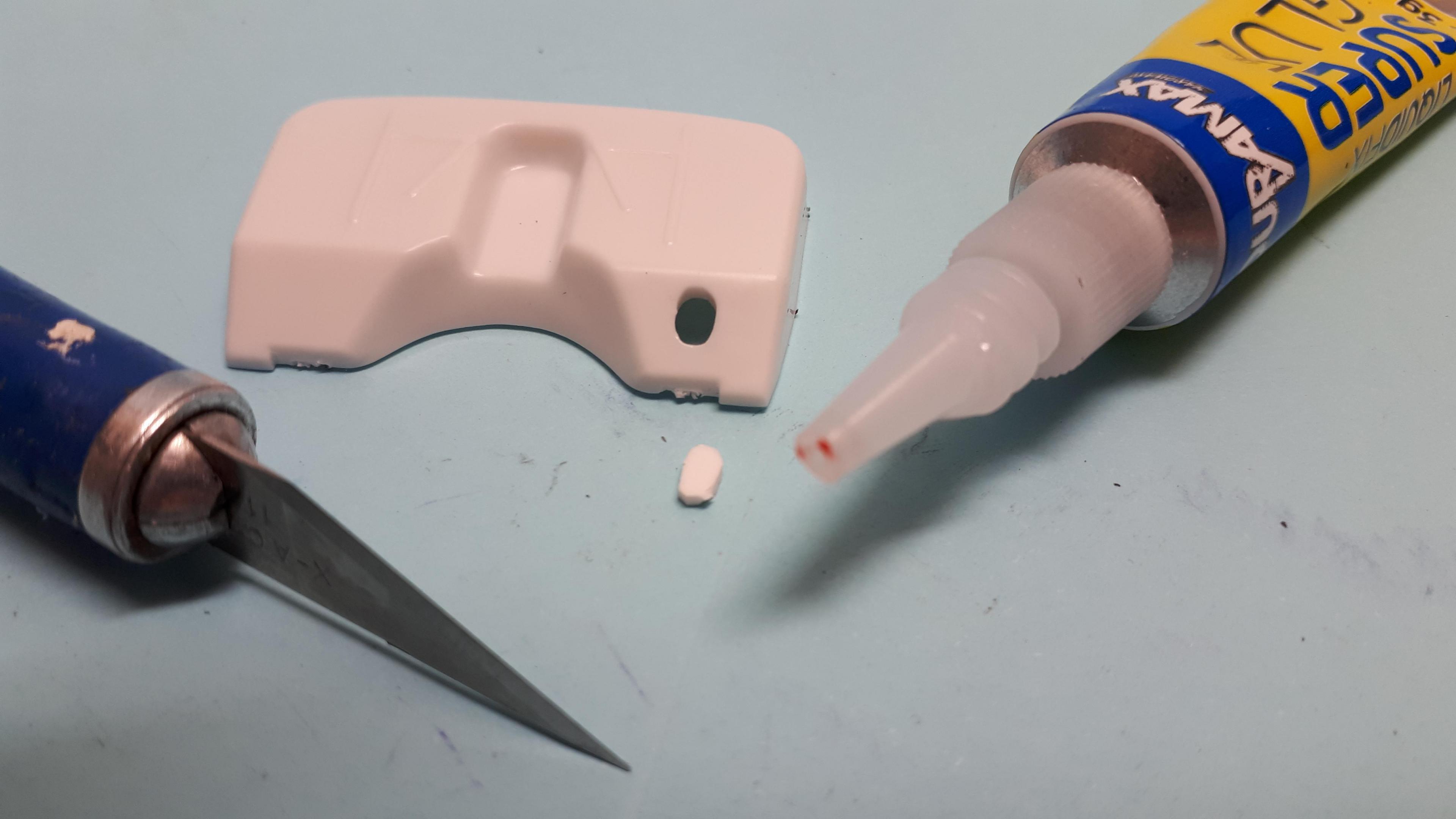

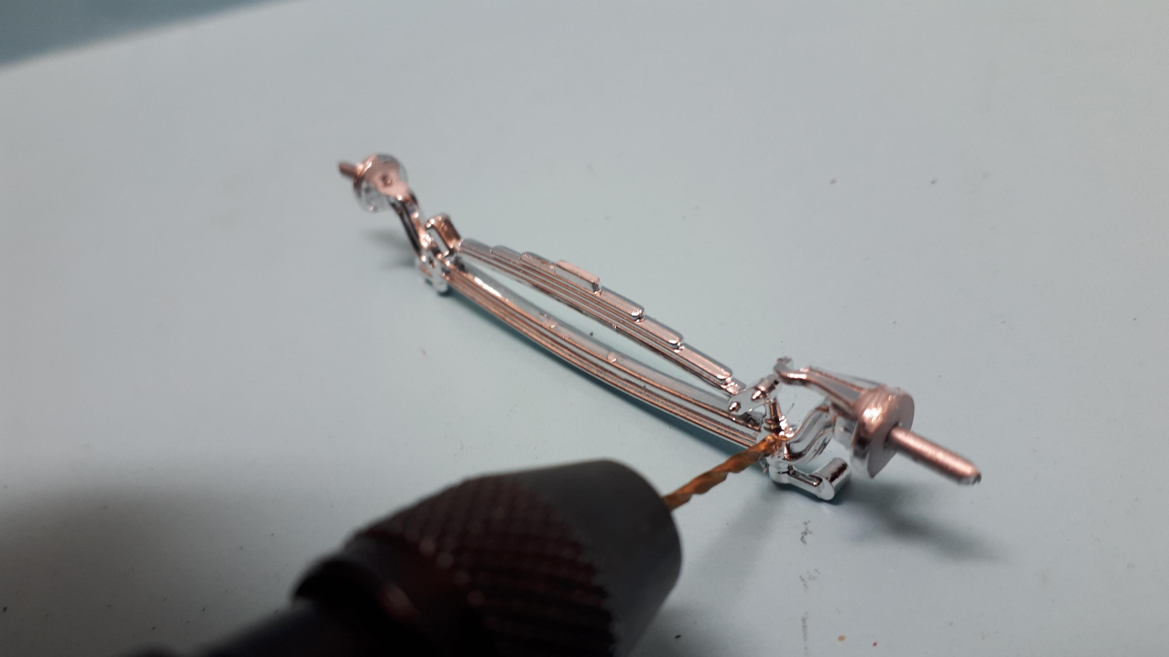

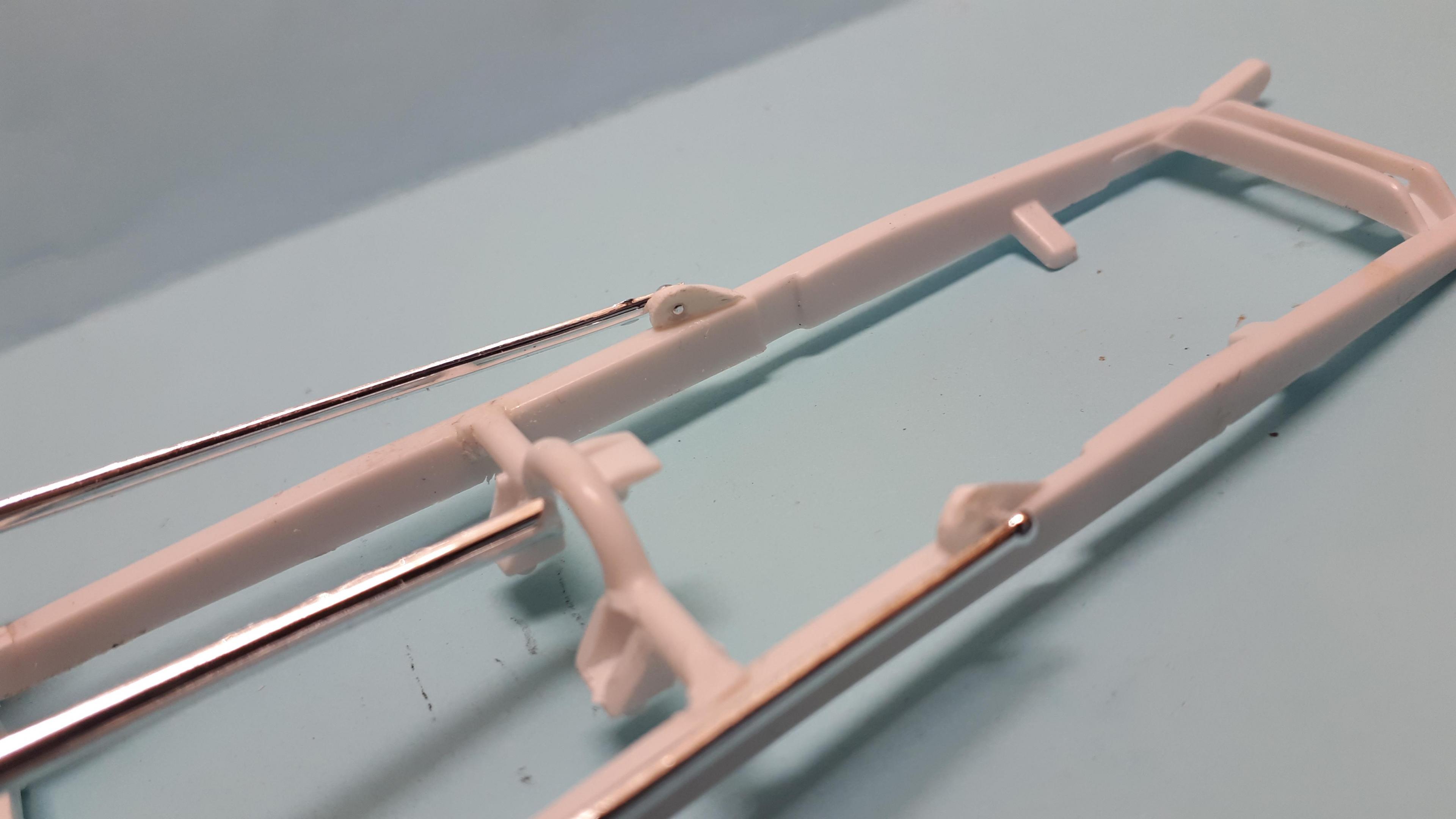

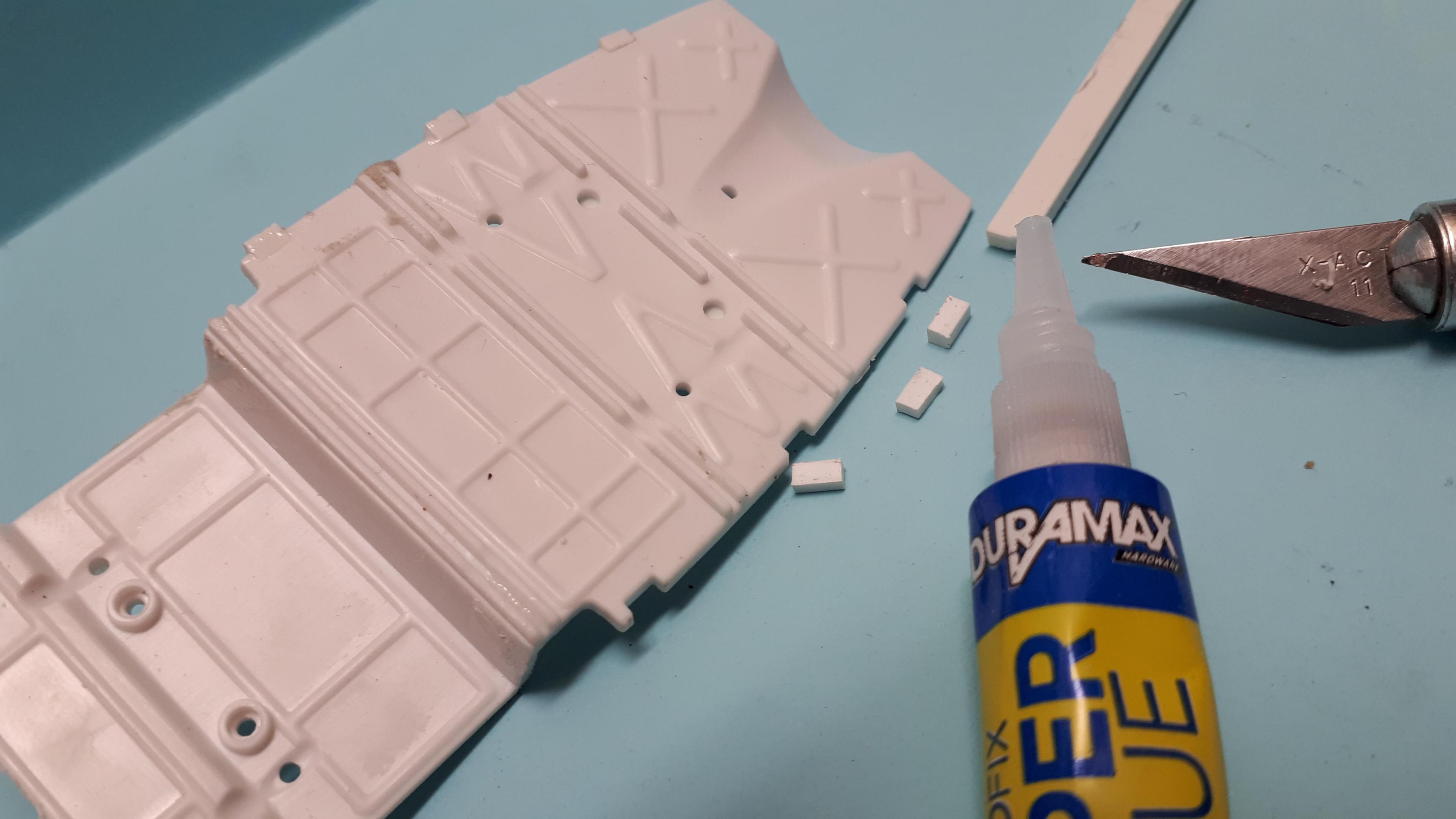

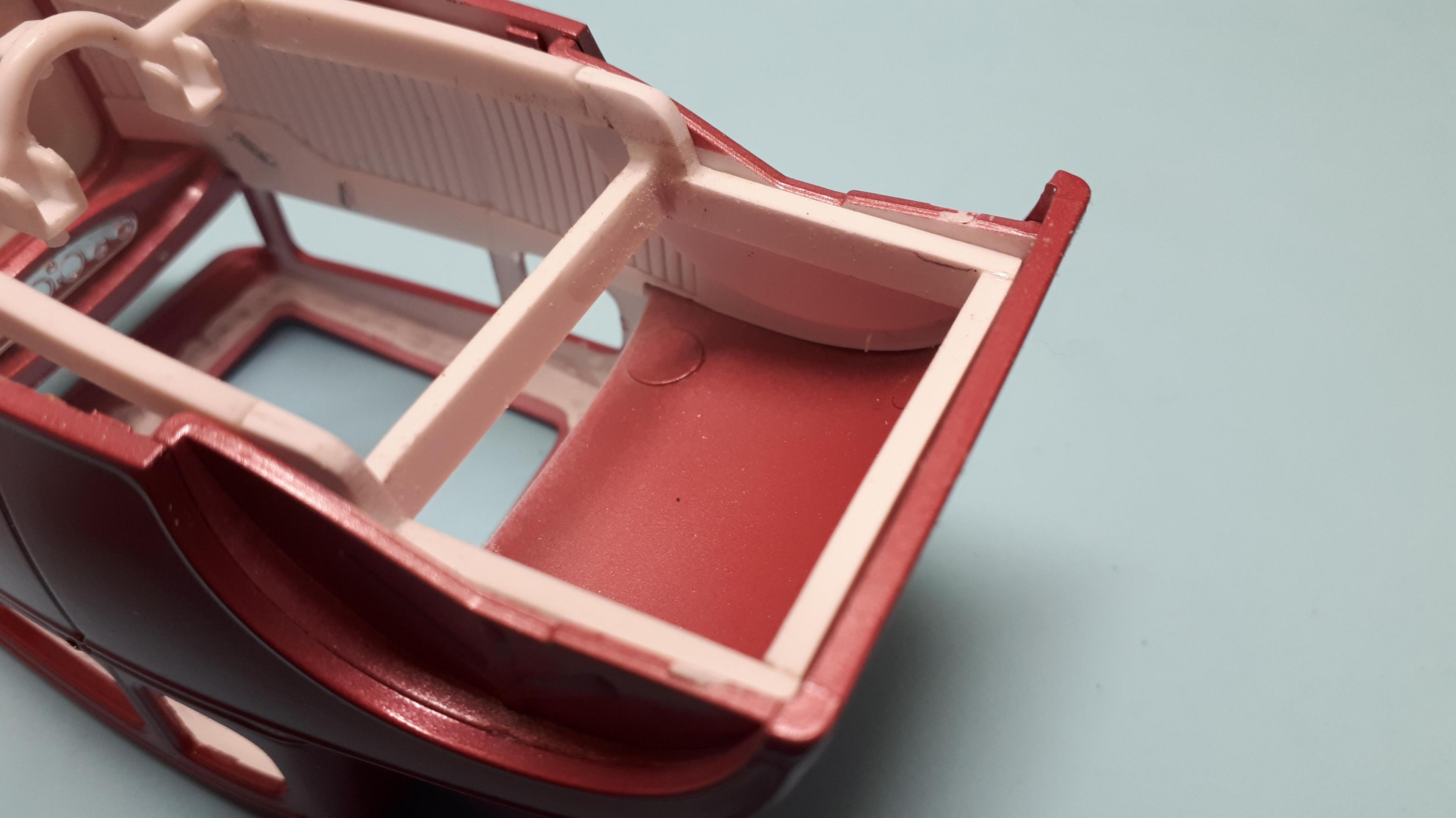

alan barton Posted July 6, 2020 Author Posted July 6, 2020 I trimmed the rear radius rod mounts because they weren't being used anymore but I didn't want to re-invent the body mounts. After mocking up the rear end assembly I was able to make some very simple radius rod mounts, just behind the locations for the kits front radius rod brackets. The other thing I thought about in advance, for once, was the floor. It has some notches in it designed to join to the lower edge of the of the interior panels but I had already filed them off. This would leave some ugly rectangular gaps along the edge of the floor. I cut some little filler pieces, superglued them in place , slightly proud, and then filed everything smooth. Easy peasy and the work was invisible when painted. In the last shots you may have noticed I had already drilled and filed through the top of the front crossmember to make sure I could get the front down far enough - it is pretty much a given in any early Ford hot rod. Having built two roadsters already I also learned that it pays to use a small drill in clean out the inside of the holes in the front axle to ensure I get a solid joint when I attach the radius rods. While I was at it, I filed down the top edges of the spring - every millimetre counts!

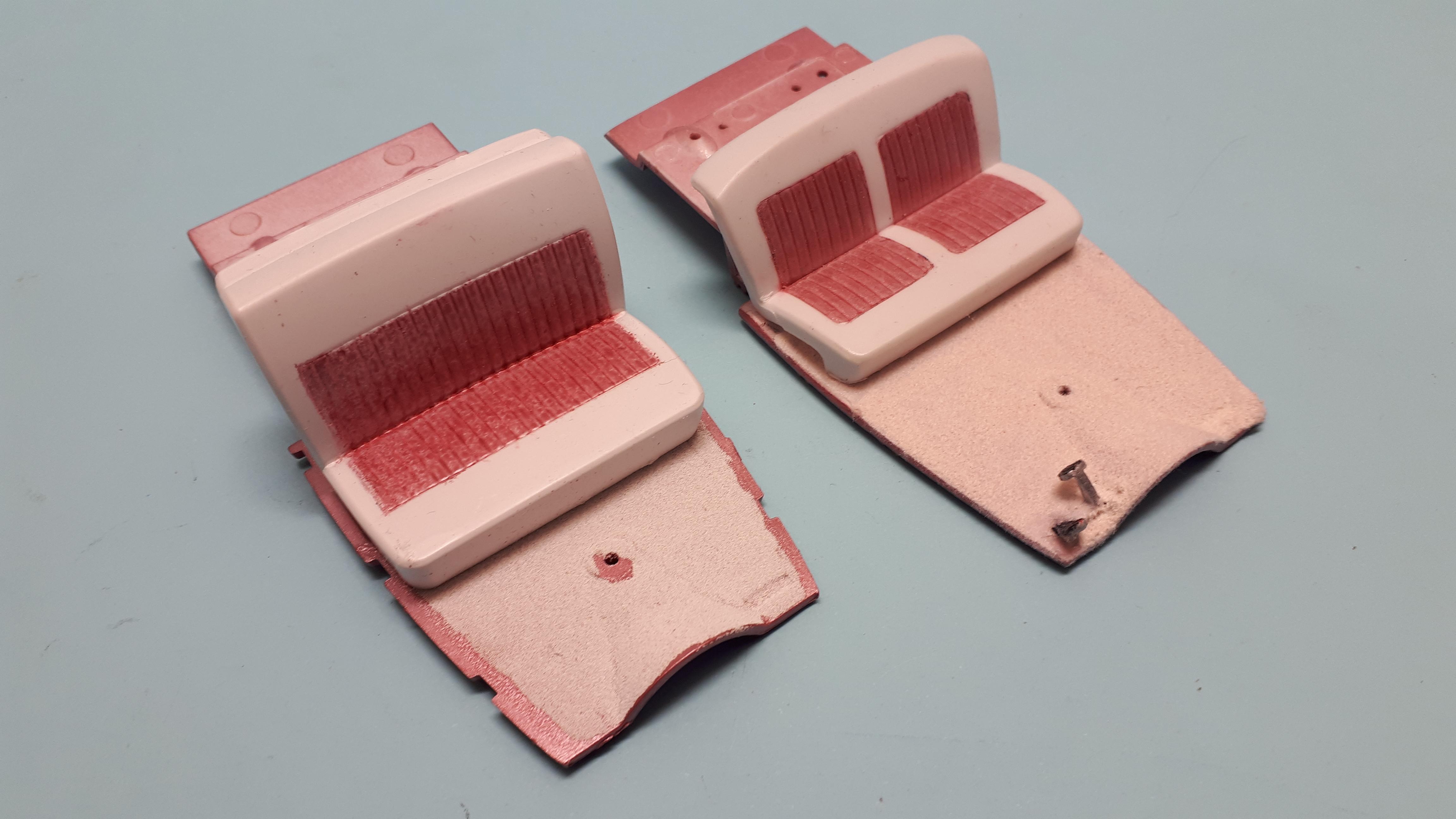

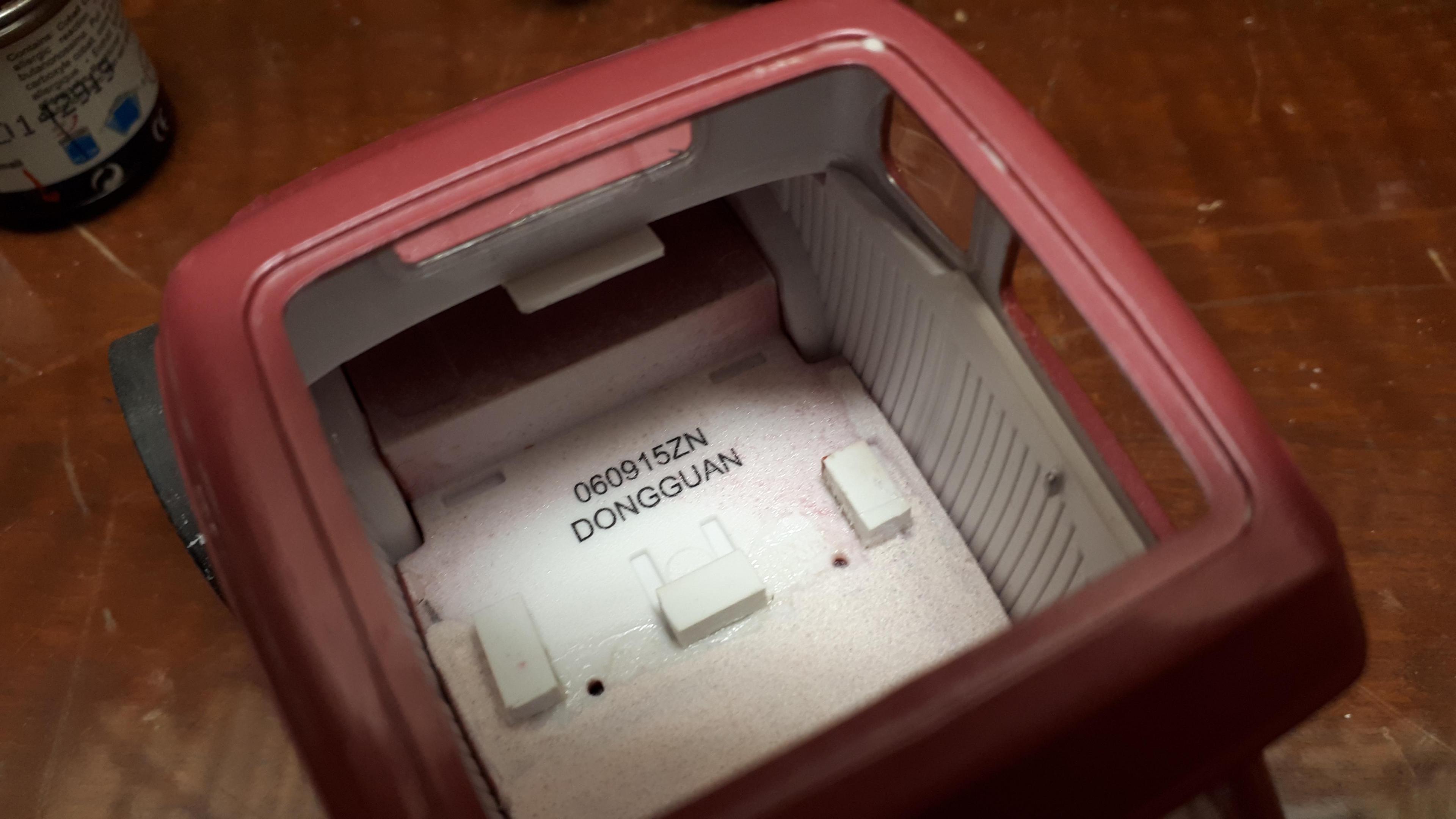

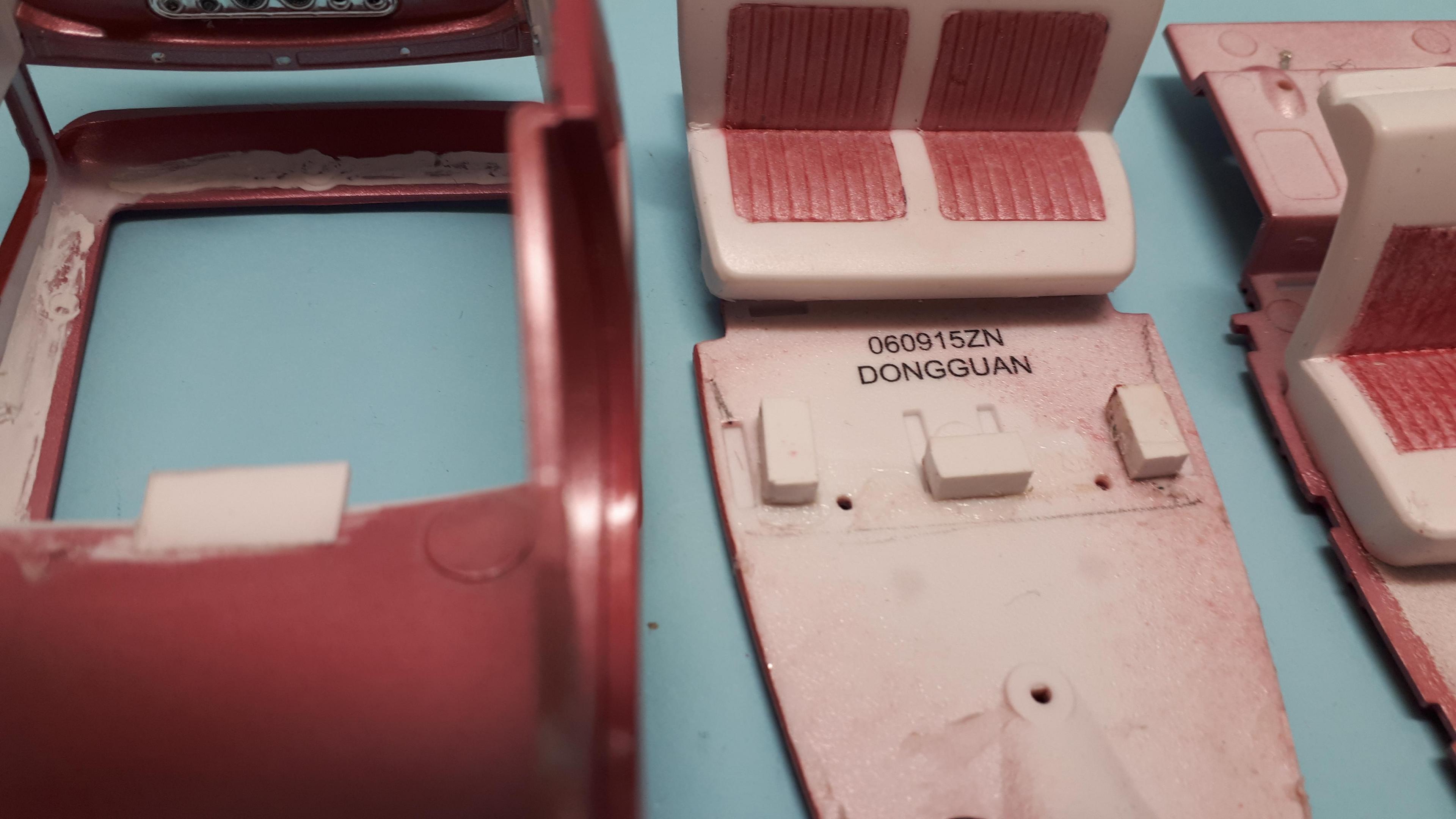

alan barton Posted July 6, 2020 Author Posted July 6, 2020 So the last bit of construction I need to show you affects the seat installation. Because of using the tall interior, the floor could not be glued to the frame first. Instead it had to be pushed up through the bottom of the body at an angle and then gently lowered back into its original location. This precluded gluing the seat in place because it would prevent you from tilting the floor to get it in. Initially I was going to trim down the bench seat from the coupe but then I realised I would be better off using the channelled roadster seat. You can see here where I glued a few blocks of plastic to the floor to give a precise location. I also glued a small tab under the rear edge of the roof so that the seat wouldn't fall away spreading glue all over the place. You can also see how I used white embossing powder for carpet and tried different base coats underneath to get a very subtle pink shade. So that's about it for the construction phase of this model. After the cut and shuts were complete, it was simply a matter of painting and assembly, which is just plain fun on a model of this quality. Kudos, Revell, this is a great model I hope you sell a zillion of them when they come out again.
