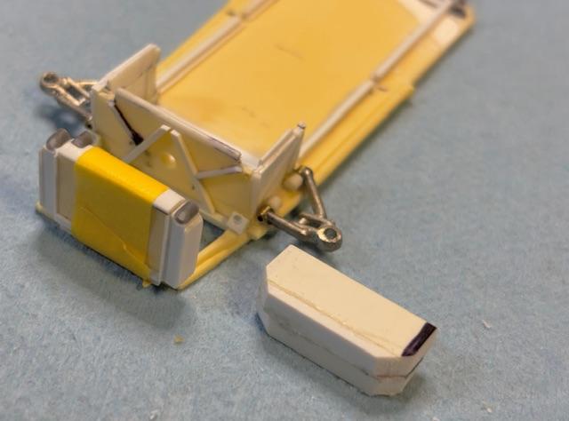

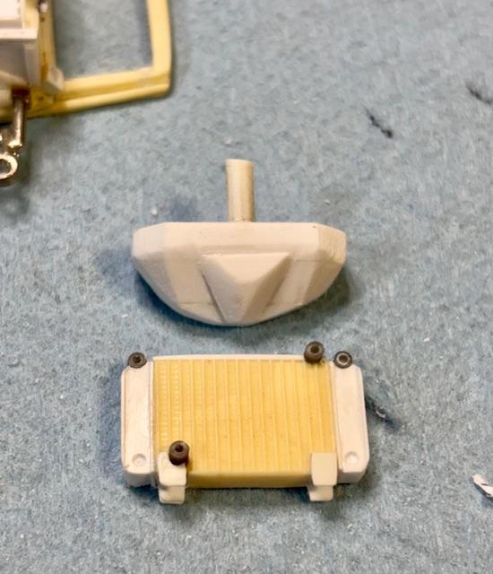

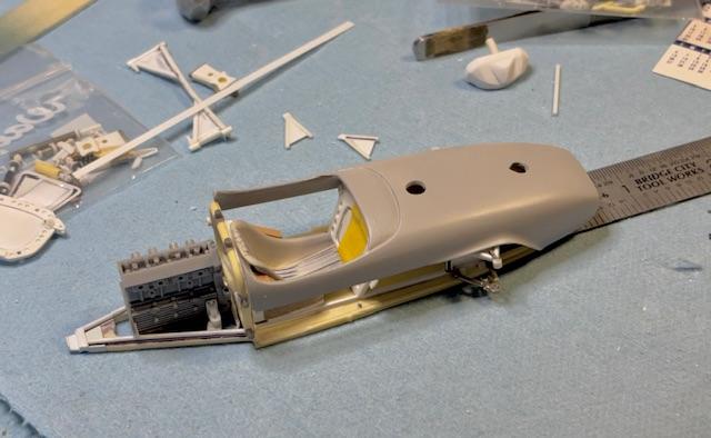

The Joker kit has an insert for the radiator - this needs modification since the nose will be removable on this 18 …
The 18 radiator had a center section for water that was flanked by two smaller oil radiators …. As usual - Evergreen strip and short sections of H strip for the brackets at the base …

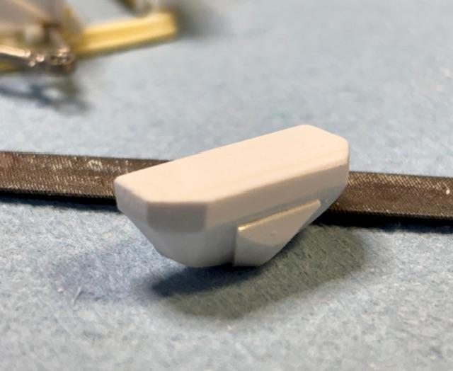

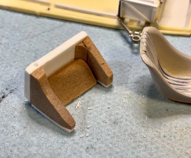

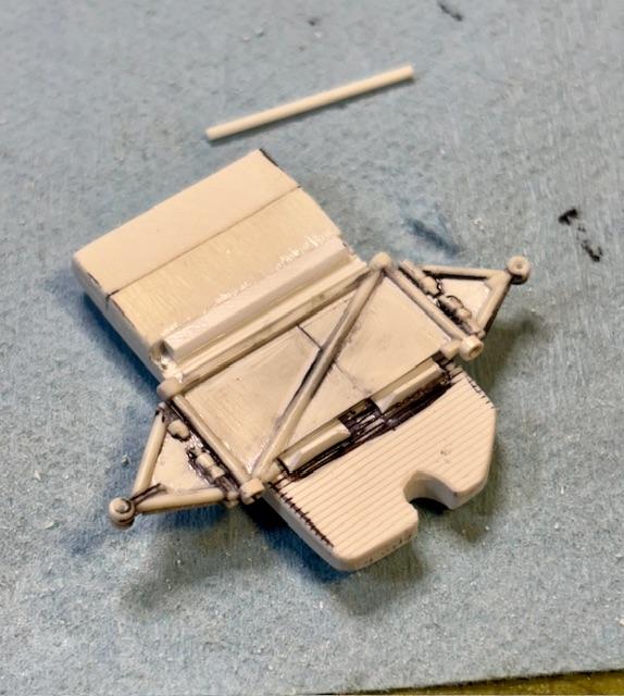

Between the footwell bulkhead and the radiator is the oil tank - which has a taper - the taper directs air exiting the radiator down and away from the nose of the car - early aero - designed by Lotus by instinct -

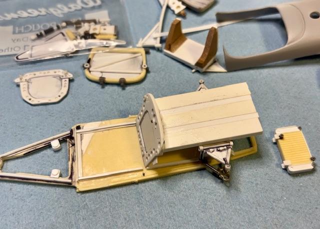

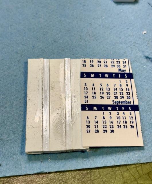

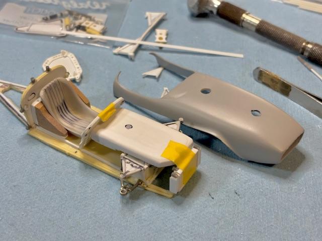

The main fuel tank on the 18 was mounted saddle style over the driver’s legs - team Lotus tanks were full length from the instr gauge bulkhead forward to the radiator - with cutouts for the oil and water hoses …
With the nose removable you’ll still be able to peek under the tank to see the footwell features, suspension, radiator and oil tank detail -

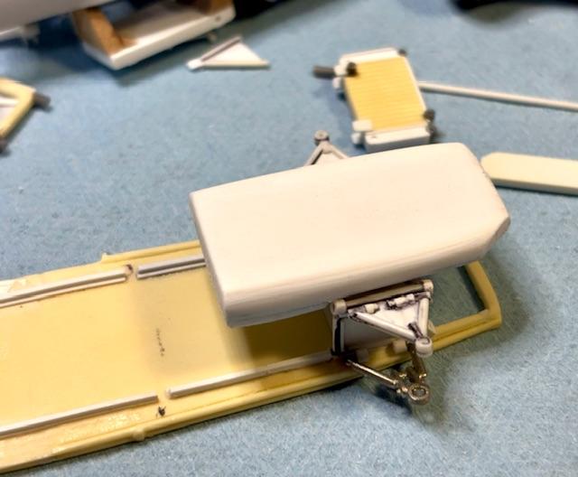

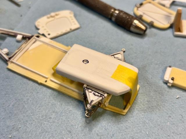

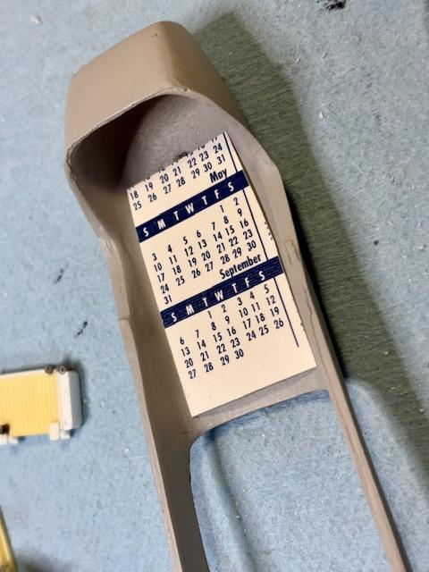

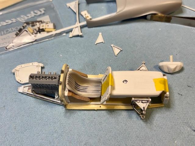

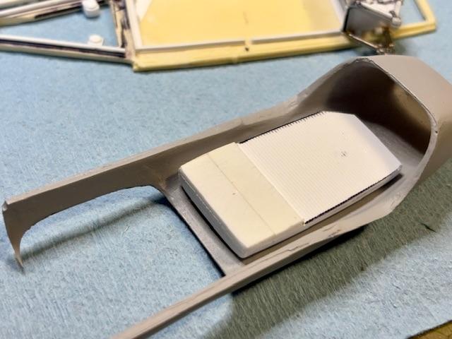

Time to check the fit of the fuel tank - so far - so good - the 24th scale body shell is relatively thick - about 1 1/2 inches - that effects the shape and make-pretend capacity of the tank - but thats ok …
Remember - fuel tank placement was a huge challenge for early rear engine GP car design because cars had to race with race distance fuel until - when? - the end of the 3 litre formula era ?
Gracias Pico
Porsche stuck the fuel tank in front on their 804 too - actually - there wasn’t a good place for the tank until Chapman drew the Lotus 25 … the behind-the-seat tank on the 18 was too small for most races but serves the survivors well - so none of the remaining 18s have the full up-front tank -

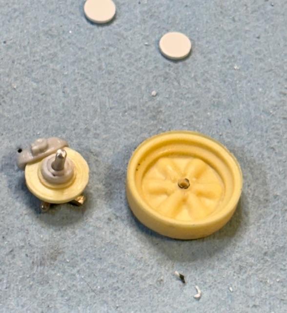

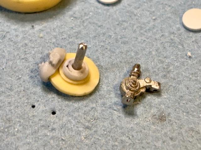

Castings of the Girling disc brakes that Norman Veber did for me - the rotor is modified from the kit part - the white metal fr uprights are modified Joker kit parts … Joker cribbed them fr the Tamiya Lotus Seven kit - i won’t tell - oops …

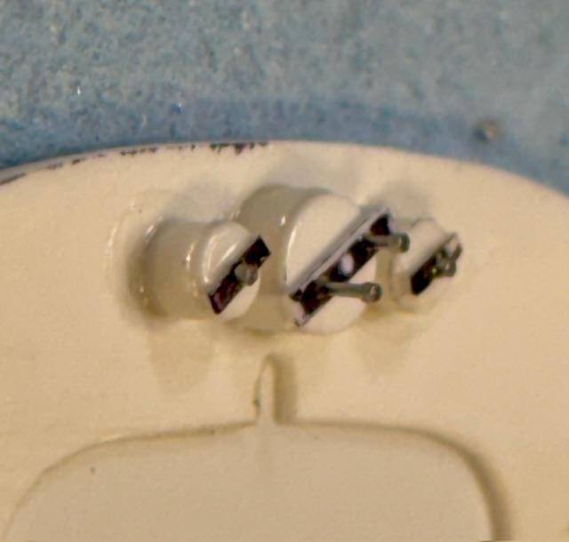

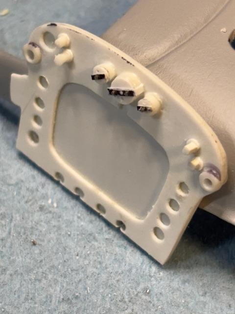

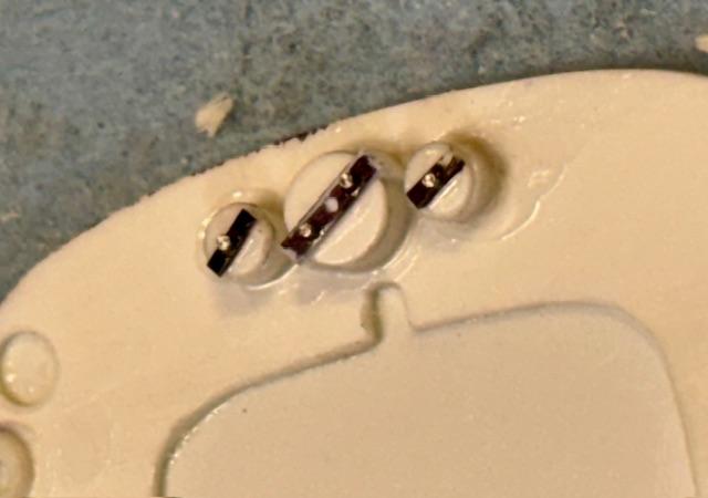

Madness has many guises - tunermodelfactory briefly offered up these .018 bolts a numner of years ago - 3D printed bolts are not yet made in this size - although thats probably coming - in the meantime i’m adding some detail to the back of the dash bulkhead … it will be visible w the nose removed …
