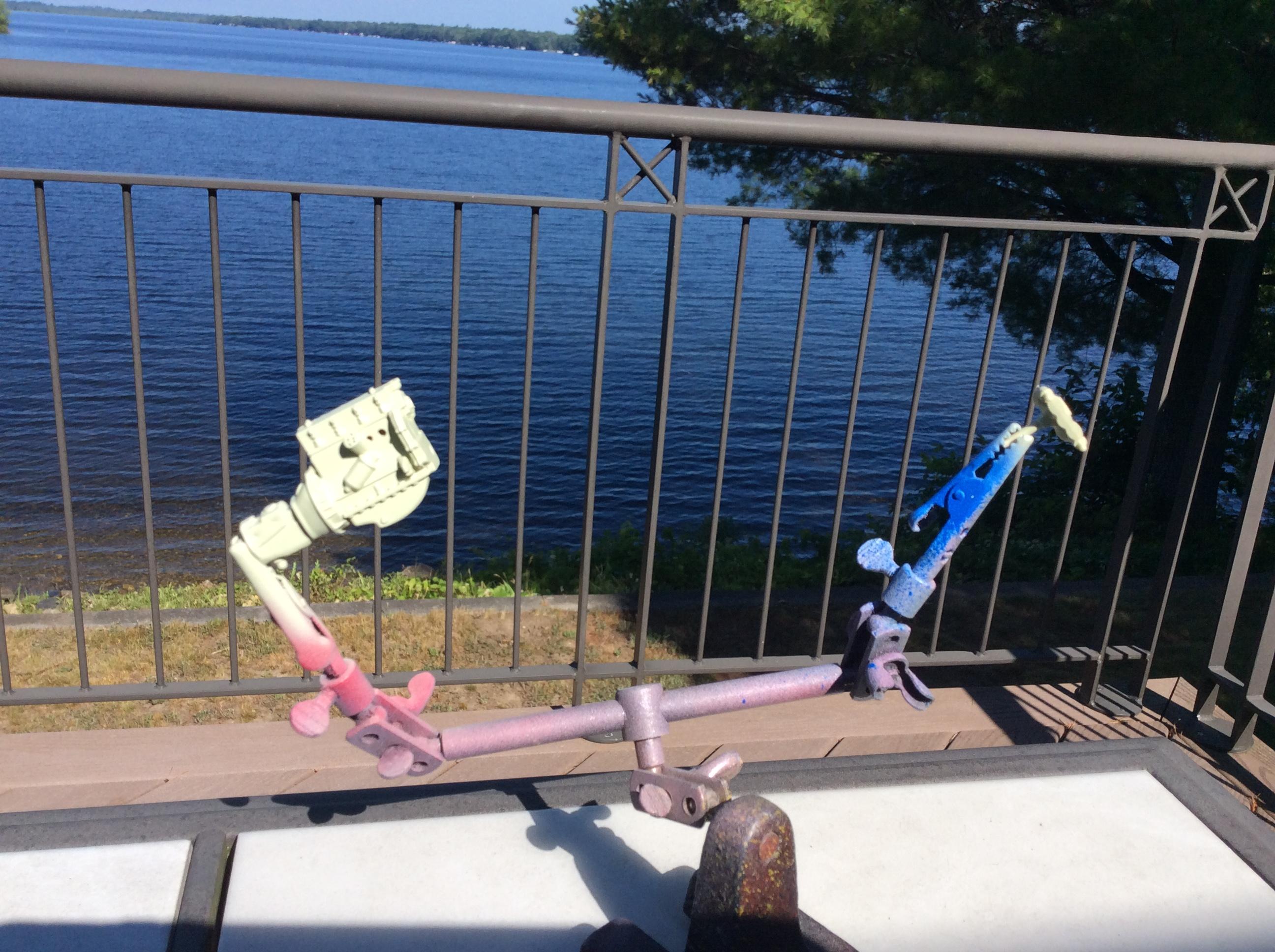

64Comet404 Posted July 11, 2020 Author Posted July 11, 2020 After sanding the putty on the engine and removing the seams, it was time to lay down some paint. The factory engine colour is a pale light green, so I airbrushed Humbrol 90 Matt Beige Green, cut with lacquer thinner. Before painting, I realized one missing piece was a distributor. Since the real part is buried underneath the air cleaner ducting, I cut and drilled a piece of sprue to act as a wire holder. It's now in the dehydrator, so it will take a couple of days of baking before it's ready for handling.

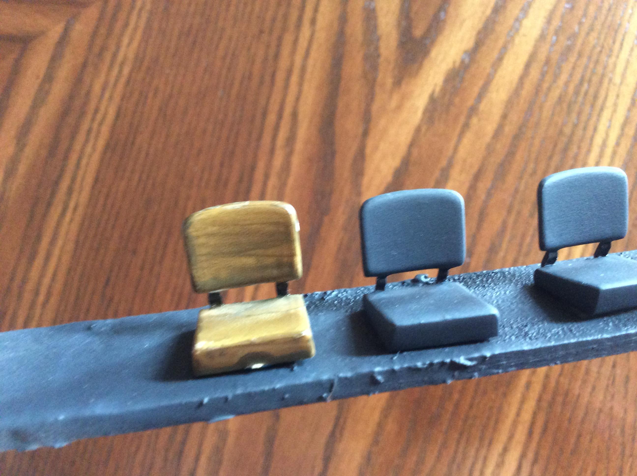

64Comet404 Posted August 11, 2020 Author Posted August 11, 2020 I've been busy with some other projects, so haven't been posting as much on this build. I will be posting some newer photos soon. Here are the rear seats, painted and detailed (the colour is a bit washed out due to sunlight, but it is dark). The seat on the left is from my last Land Rover build back in the early 1990's.
slusher Posted August 12, 2020 Posted August 12, 2020 Nice work so far! Always wanted to score one of these kits...
