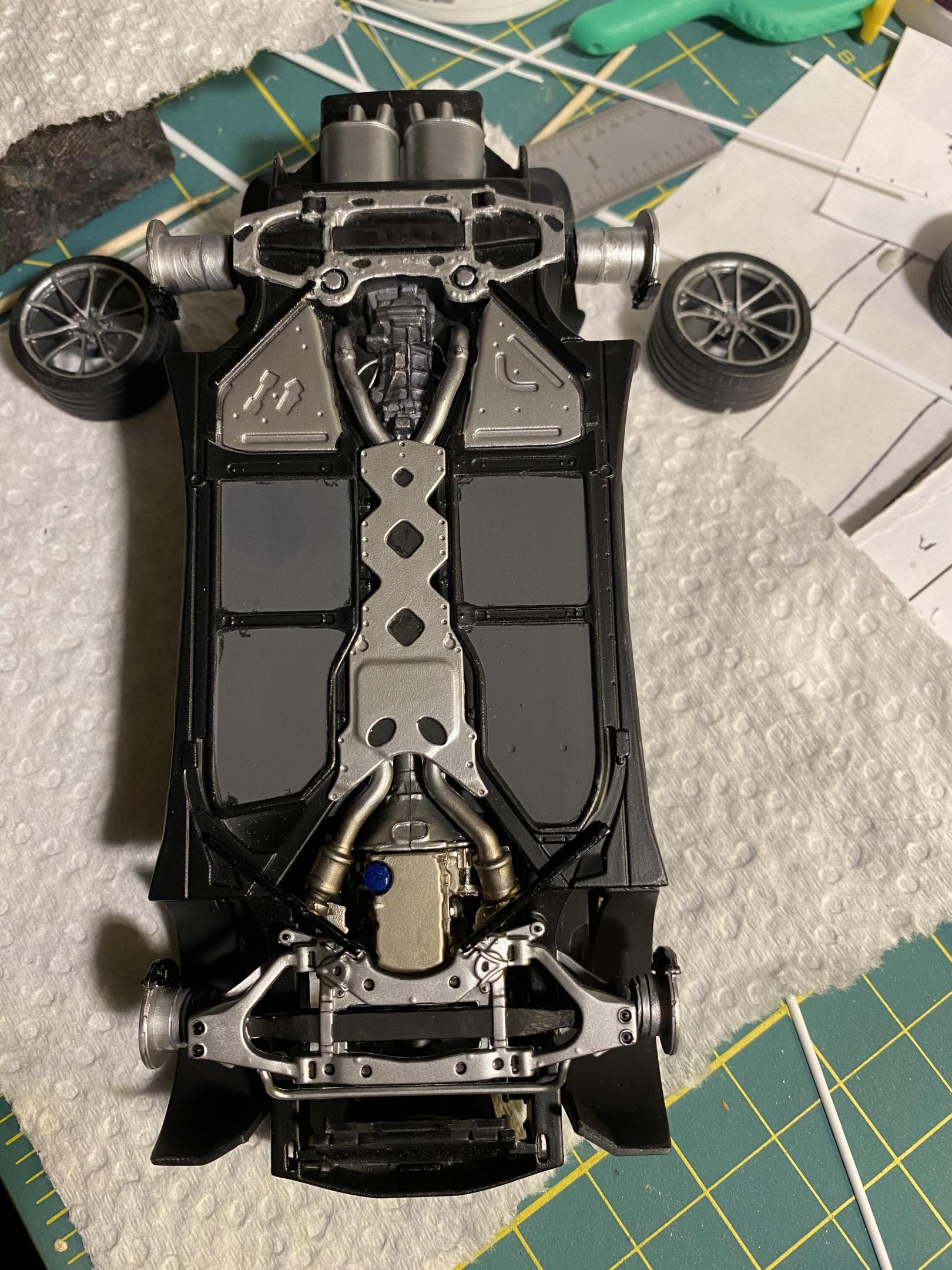

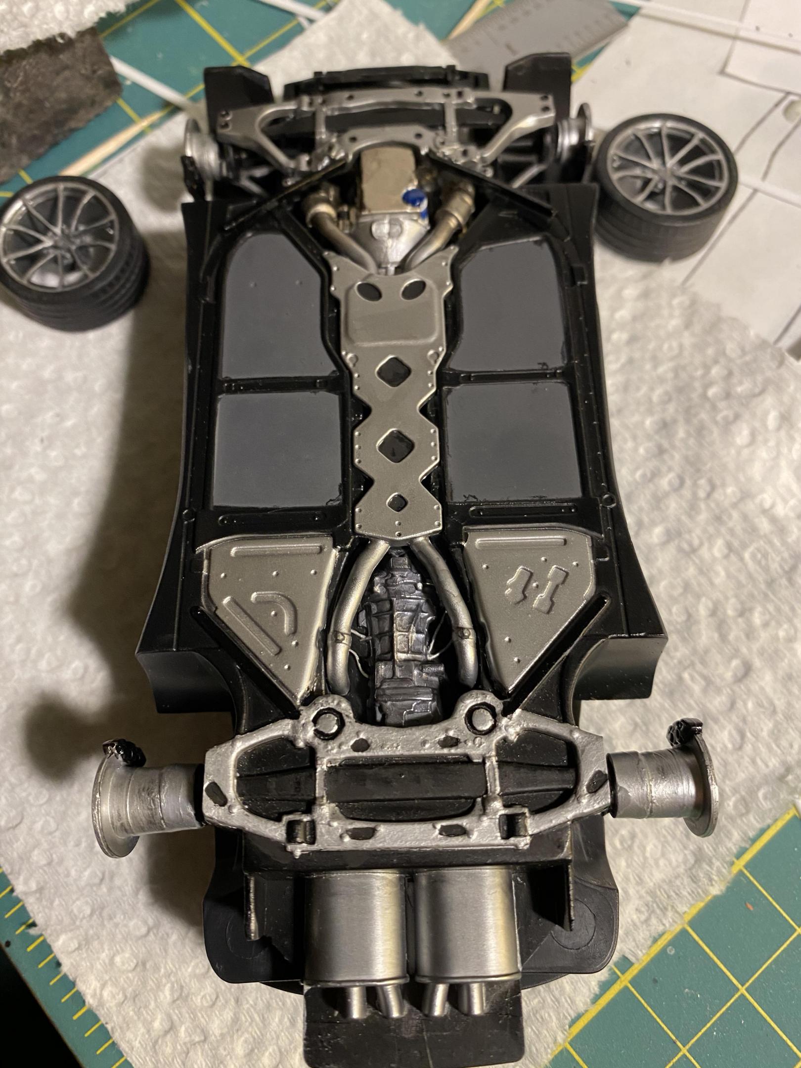

AJM Posted July 20, 2020 Author Posted July 20, 2020 Bottom view of the chassis and engine, a lot of detail painting makes this come alive, even though the suspension is simplified. I wanted to be sure that I had the correct 'stance' and track width of the wheels on the car, especialy with the wider rear fenders, and therefore needed to mate the chassis/interior assembly up to the body to see what modifications were needed. I cut slots into the locating points on the rear wheel hubs and also added spacers to the disk brake hubs to get the correct track of the wheels and also to get the correct centering of the wheels within the wheel wells. I used 5 min two-par epoxy to give me time to ensure that the wheels were correct --did this process for both the front and rear wheels. Looks a little messy with the extended hubs, but these will not be seen with the big Michelins mounted.

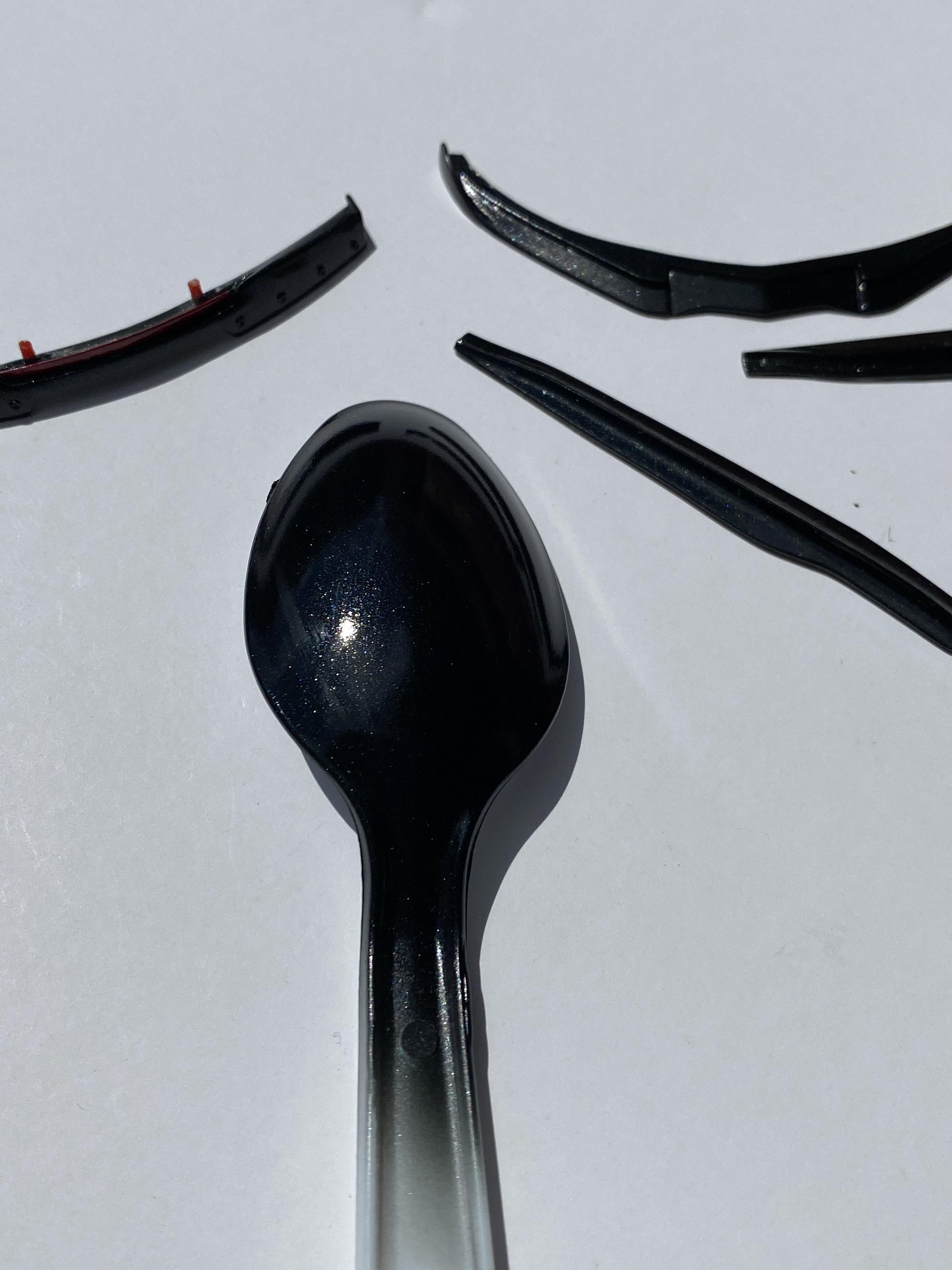

AJM Posted July 22, 2020 Author Posted July 22, 2020 Used a suggestion from Bob Downie from the excellent article that he recently wrote in SAE, about using Automotive Touchup line of automotive paints -- they have an excellent web site, you can look up a vehicle by year and order the specific paint codes for the car. They have touchup paint in bottles or spray can and they have have a clear coat for the basecoats. As suggested by Bob I mixed the bottle paint 1:1 with Mr. Color leveling thinner and AB onto a spoon for a test. the carbon flash was cleared with Mr. Color Super Clear and the I then painted the Gurney flap spoiler, rocker skirts, mirrors and front splitter. You can see some of these parts below -- I put the spoon in for reference --you can see the metal flakes in the carbon flash --which does not look out of scale.

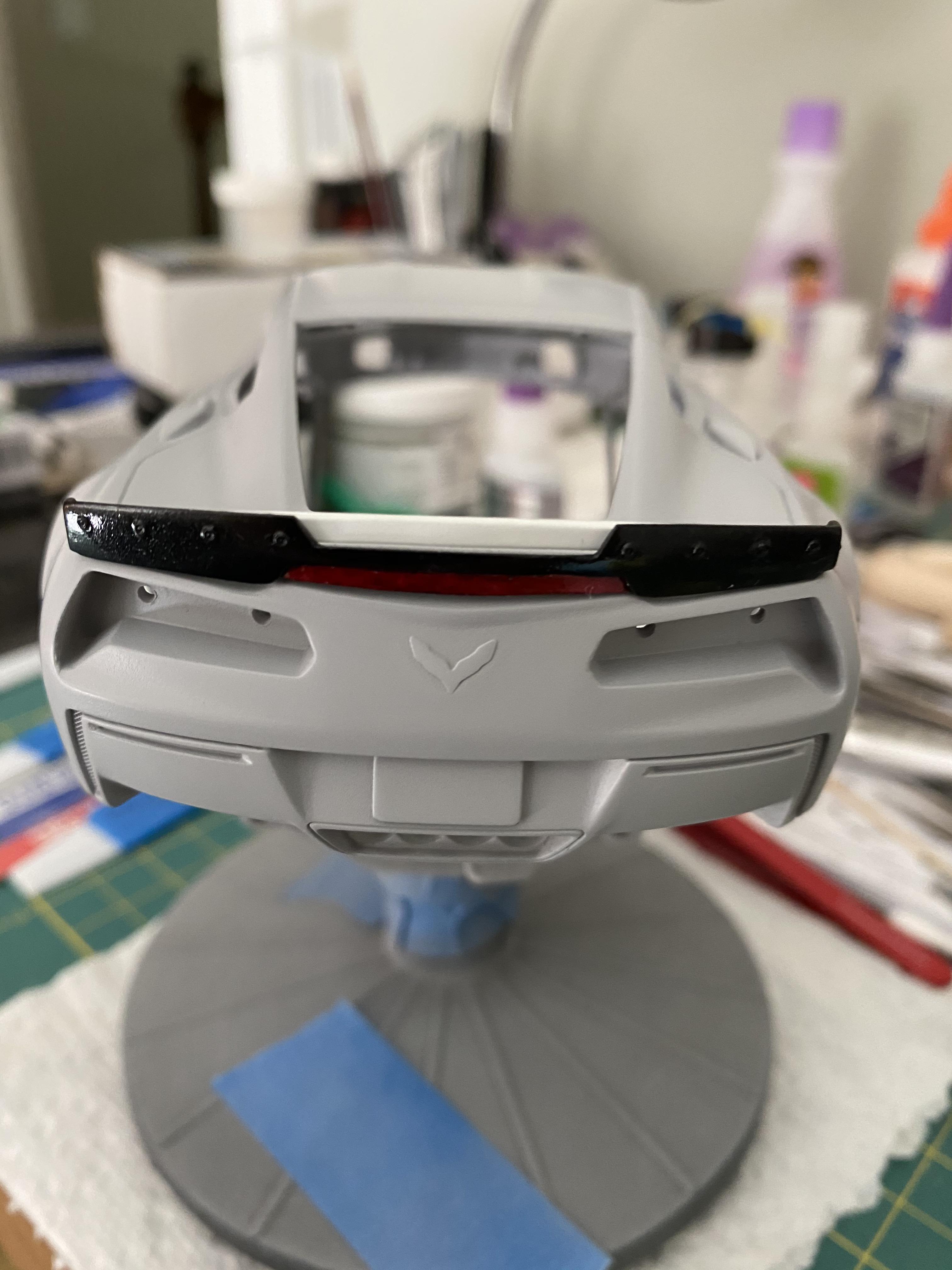

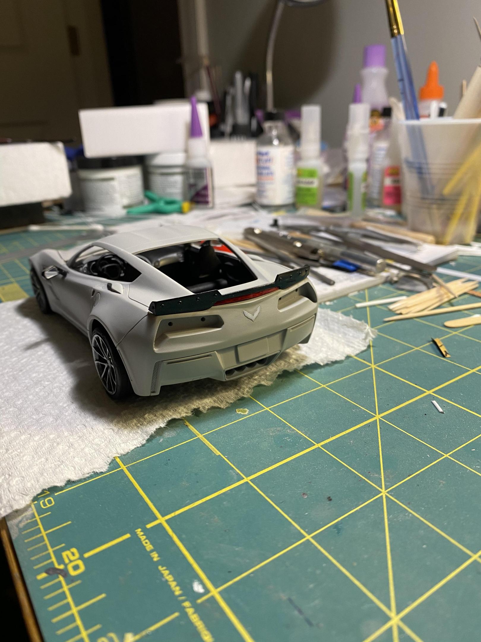

AJM Posted July 22, 2020 Author Posted July 22, 2020 Couldn't resist test fitting a few of the carbon flash parts and also to check the stance/look of the body/proportions --i think it's getting close --here's a few other views ---

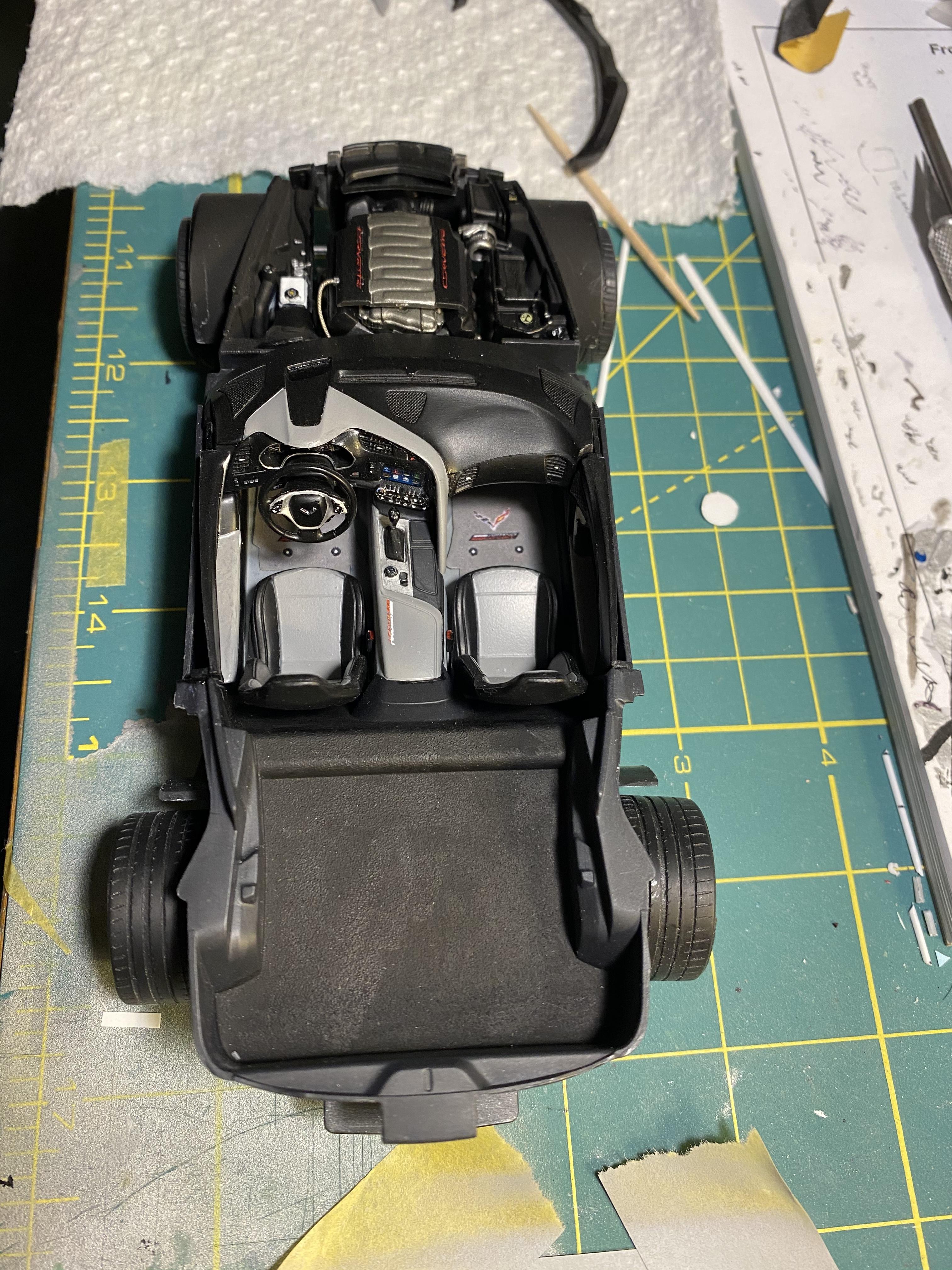

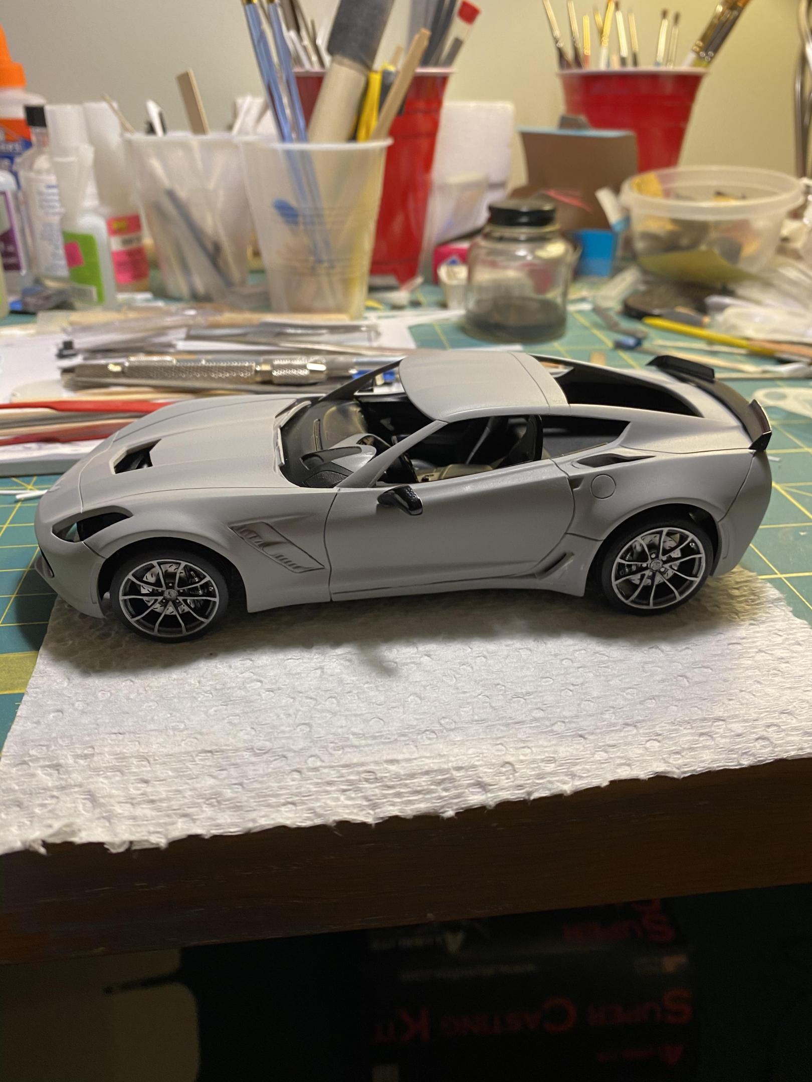

AJM Posted July 22, 2020 Author Posted July 22, 2020 Well the chassis/engine/ interior and wheels are completed. The next things left to do are to fill a couple of spots on the body, a final round of primer and wet sanding. Then onto color coat/ clear decals etc -- this is the part that I'm most anxious about not screwing up -- I'll update a s best I can, Thank you for watching, and let me know if you have any comments or suggestions/questions. i've learned a lot from this build , but much was stimulated by the excellent craftsman that I see on this forum --thx to all!

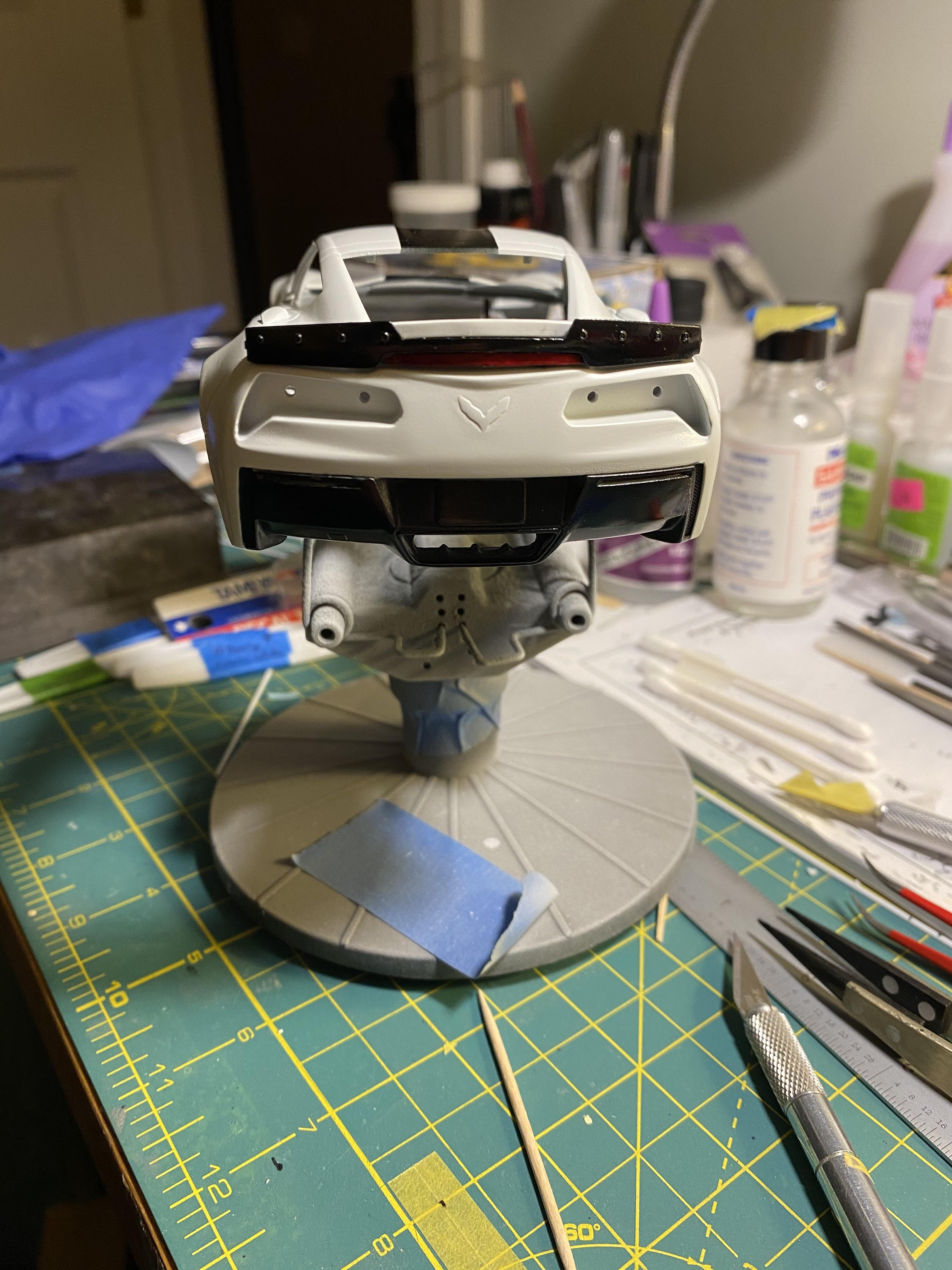

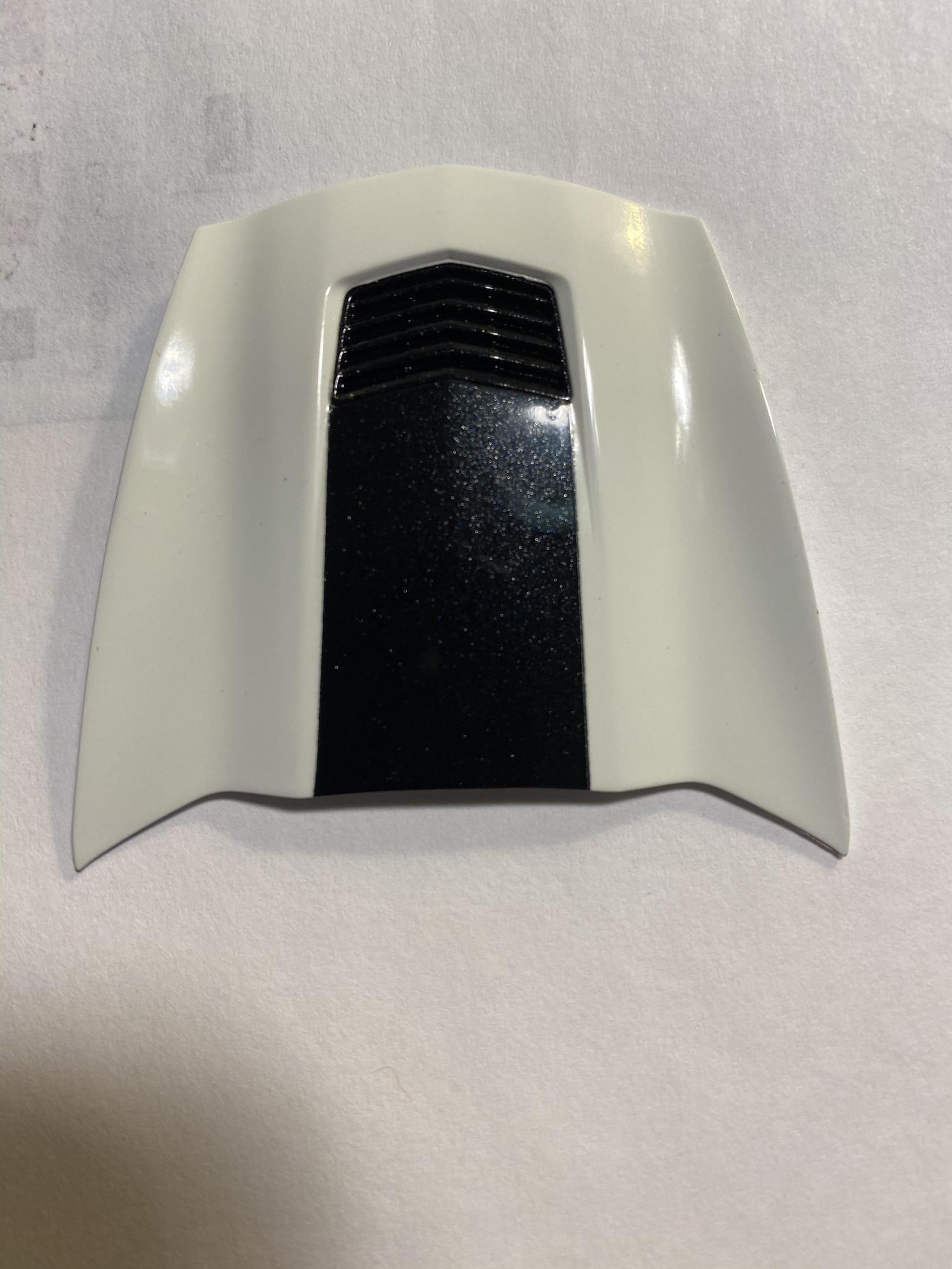

AJM Posted September 8, 2020 Author Posted September 8, 2020 Made some progress on the C7GS, finally got some Arctic White(Automotive Touchup) AB'd onto the hood and the spoiler. The Stripes on the hood and the spoiler were measured and laid out -- then painted with AT Carbon Flash; these were then cleared with AT single stage Clear --this was then rubbed out and polished. I then test fitted the hood and the spoiler/Gurney flaps to the body. The spot you see in the Carbon flash stripe is a reflection in the Clearcoat --my photography skills are not that great. Let me know what you think....
AJM Posted September 8, 2020 Author Posted September 8, 2020 I attached the hood front grill air vents --this was also painted AT Carbon Flash. The body has it's final coat of primer and is ready to be painted; this is the part I'm most anxious about, but can't wait to have this done. Fingers crossed!!

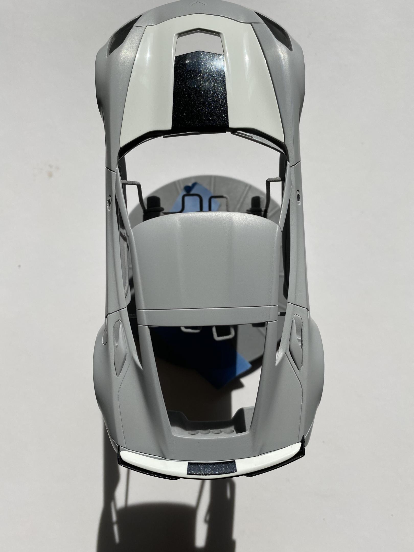

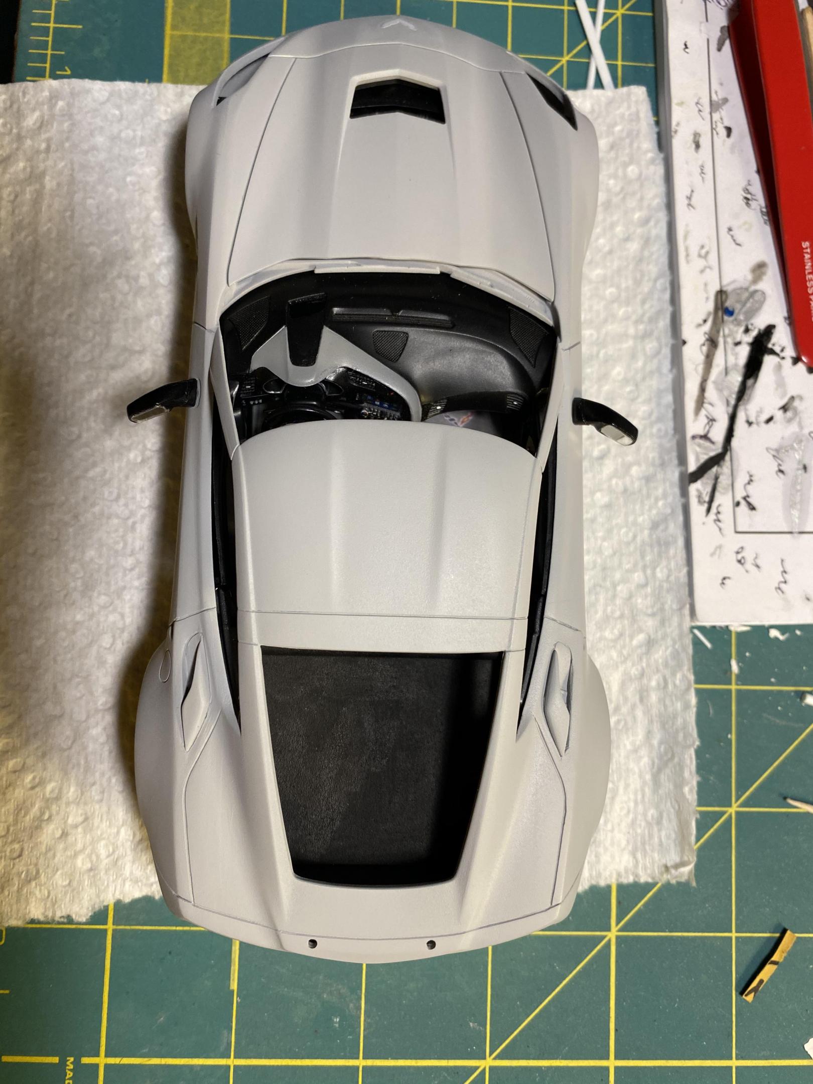

AJM Posted September 15, 2020 Author Posted September 15, 2020 A little more progress on the C7 Grand Sport, measured and centered the hood and rear deck carbon Flash stripe -- added the hood and rear spoiler which i had painted separately to ensure that the stripes aligned, looks pretty close,

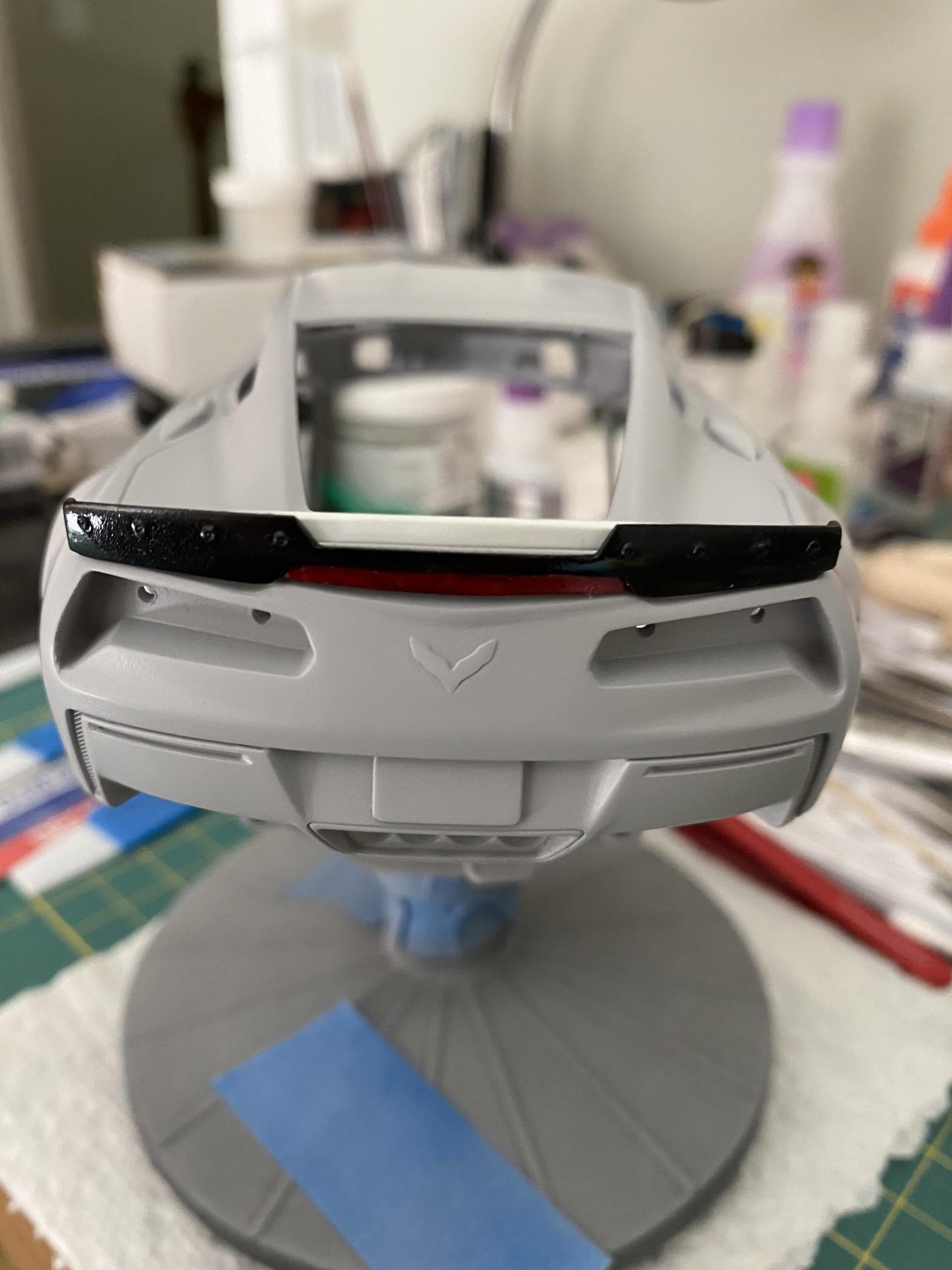

AJM Posted September 15, 2020 Author Posted September 15, 2020 Also painted the rear valence and the side coves, AT Carbon Flash, getting closer to the end --still need to paint the 'A' pillars, the rear brake scoop trim, then add the decals and clear coat. It's starting to come alive!! thanx for following!
