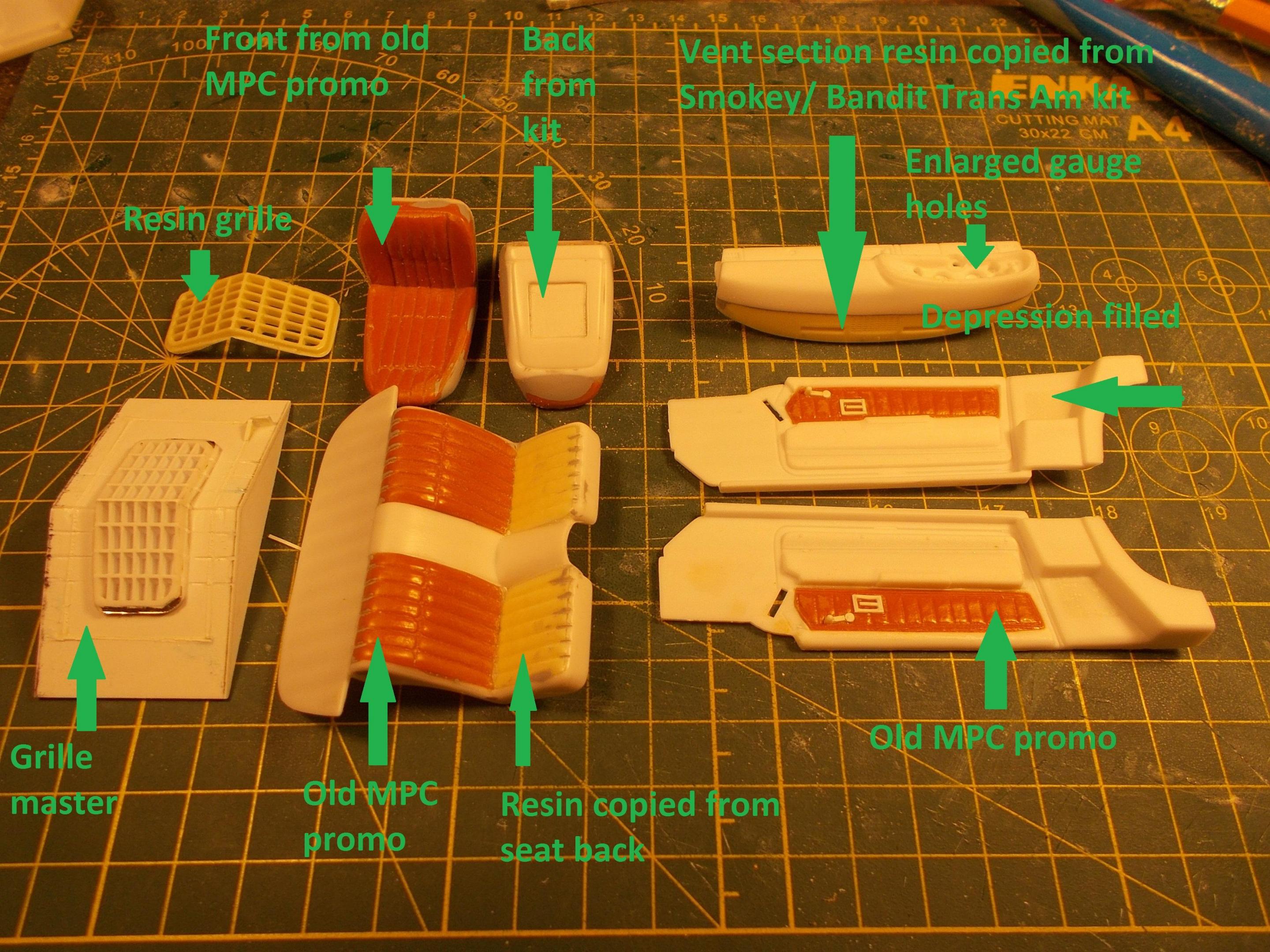

Repstock Posted September 20, 2020 Posted September 20, 2020 (edited) I'm converting the new AMT full-bumper Camaro to a 1973 car from my youth. It was a 350 2bbl, 4 speed car with added headers. I hope the pictures describe things well. More to come as I get things done. The front area below the front bumper does not fit well, and takes some work to get it installed. In my opinion, the front and rear areas MUST be attached to the body before paint. I'll figure out how to get the chassis in later. Edited September 20, 2020 by Repstock

Dominik Posted September 22, 2020 Posted September 22, 2020 this work Looks really good. Interesting steps on the interior. the grill casting is perfect!
tooltime-fan Posted September 22, 2020 Posted September 22, 2020 Interesting project. I also like what you did to the interior. Which year is the promo you took the interior parts of, they seem to suit my bumblebee project quite well
Superbird McMonte Posted September 23, 2020 Posted September 23, 2020 (edited) What kit did the grill come from? I love this project and will be following intently! I have a Baldwin Motion 73 in the works. Edited September 23, 2020 by Superbird McMonte
Tungen Chiek Posted September 23, 2020 Posted September 23, 2020 22 hours ago, tooltime-fan said: Interesting project. I also like what you did to the interior. Which year is the promo you took the interior parts of, they seem to suit my bumblebee project quite well The promo was from a '73 Camaro (MPC) 5 minutes ago, Superbird McMonte said: What kit did the grill come from? I love this project and will be following intently! I have a Baldwin Motion 73 in the works. The grille was scratchbuilt using the kit grille surround.
Superbird McMonte Posted September 23, 2020 Posted September 23, 2020 So you sourced the insides from something else?

Superbird McMonte Posted September 23, 2020 Posted September 23, 2020 2 minutes ago, Tungen Chiek said: The promo was from a '73 Camaro (MPC) The grille was scratchbuilt using the kit grille surround. I also see that the 74 Camaro has the same interior pattern. And I have a couple of those to use on my project.
tooltime-fan Posted September 23, 2020 Posted September 23, 2020 Thank you two So I will try to find one of those
